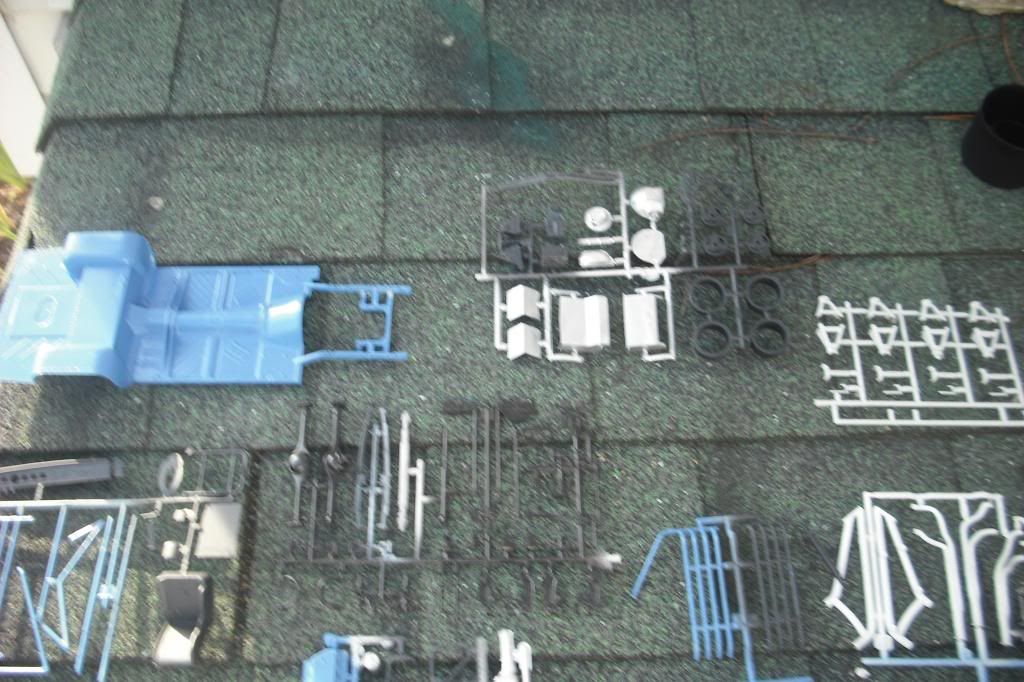

I am going to show you what steps I take while building this car, Its going to take time , I have waited a year already for this kit to come out
here it is cant wait to dig in
all of the parts are here

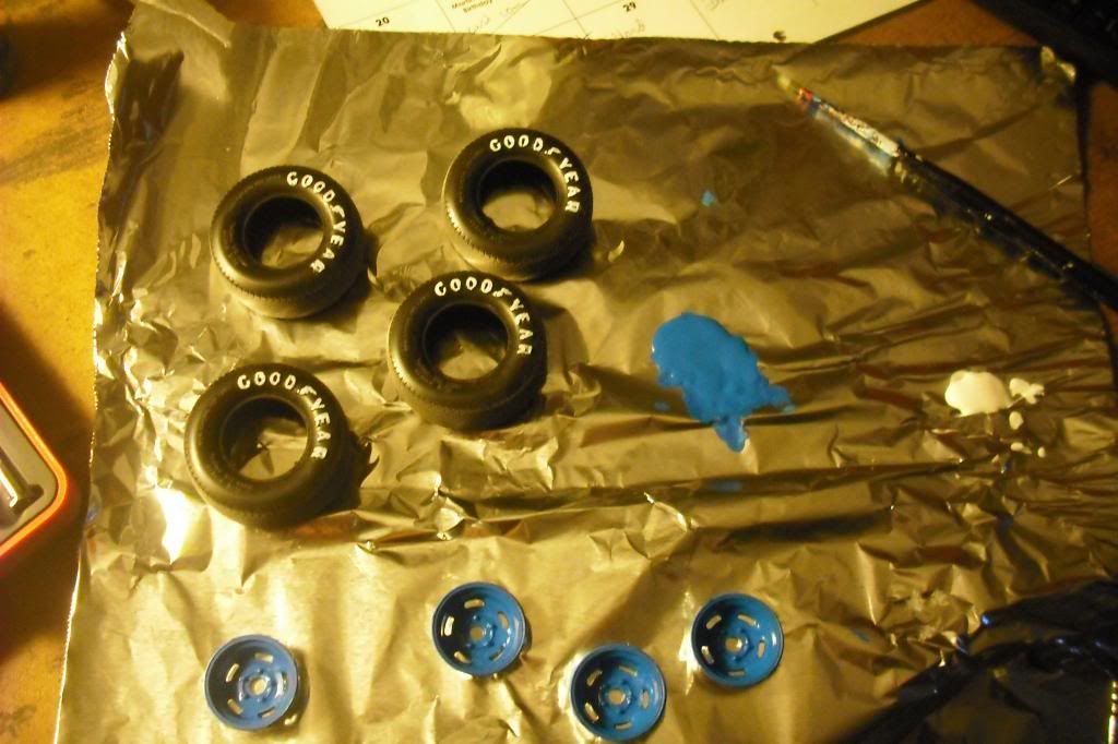

The first step I always take is the wheels, since this kit has chrome wheels I will be making a change. Everyone is going to build this with chrome however every 73 i see has blue except for the daytona car , so i choose to be different.
time to soak in clorox
cut out the centers and sand the treads
time to paint good year
after adding wheel weights detailing lugnuts and painting on some markers such as LR, LF these are the finished tires

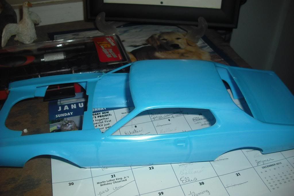

Paint Prep
I always paint my bodies before starting the actual build up- I do this because it gives the body plenty of time to cure before trying to rush it over a complete chasis
I am very happy with the color of this mold so there will be no need to repaint the petty blue unless you just want to, once the clear coat goes on it will look like fresh paint.

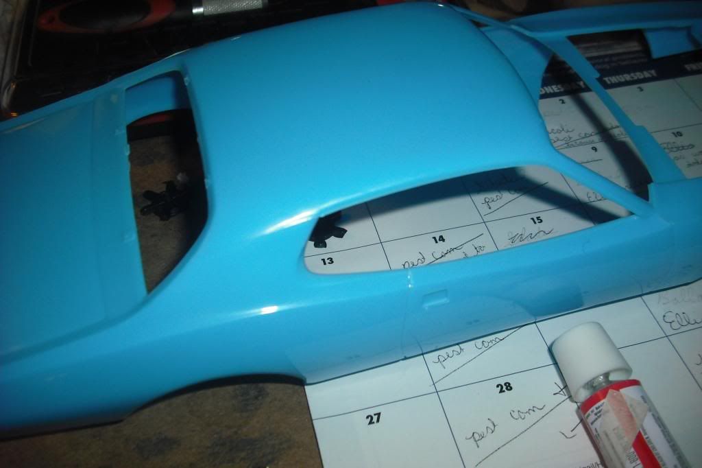

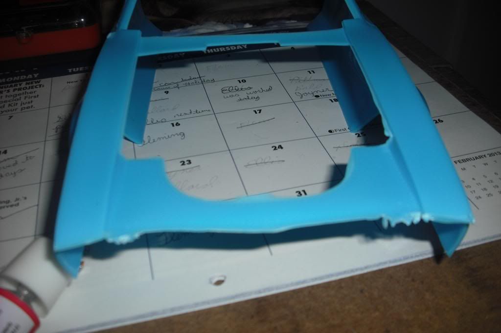

first thing is to work on the flashing , this kit has lots of excess flash , I used a hobbie knife to shave of big access and wet sanded the rest
The next step is wet sanding - for this i used 600 grit and palmaloive dish detergent. I wet sand the whole car even though I am not repainting the blue, this will allow All paints and clear ro bite. Use dish deterent while sanding, I have found that round 2 kits have lots of oils on their bodys which can play fisheye havock when paint is applied

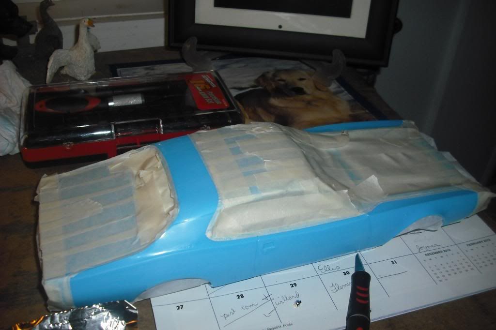

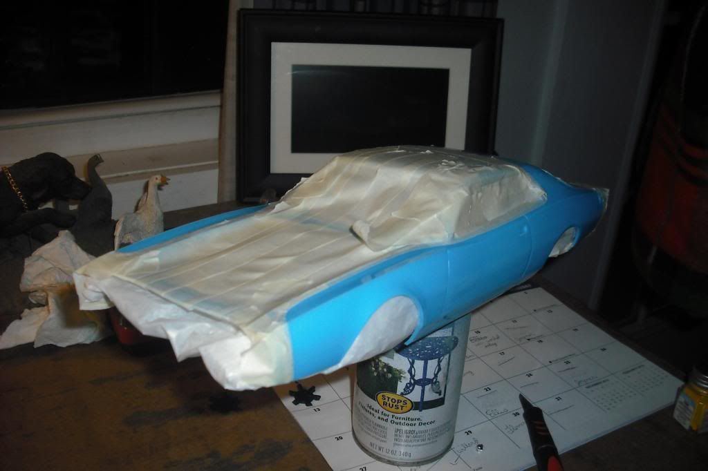

DSCF4228_zpsd0a38dc7.jpgDSCF4228_zpsd0a38dc7.jpgmasking

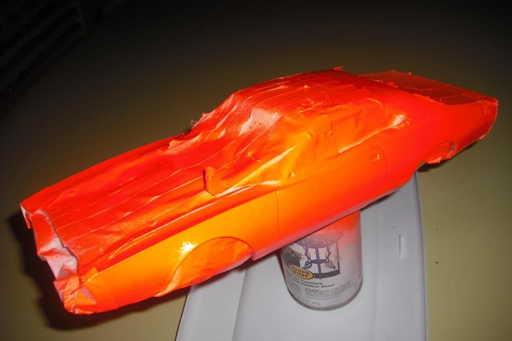

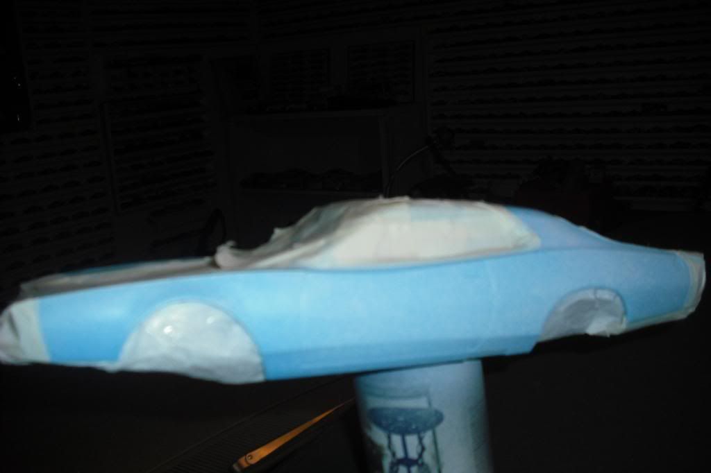

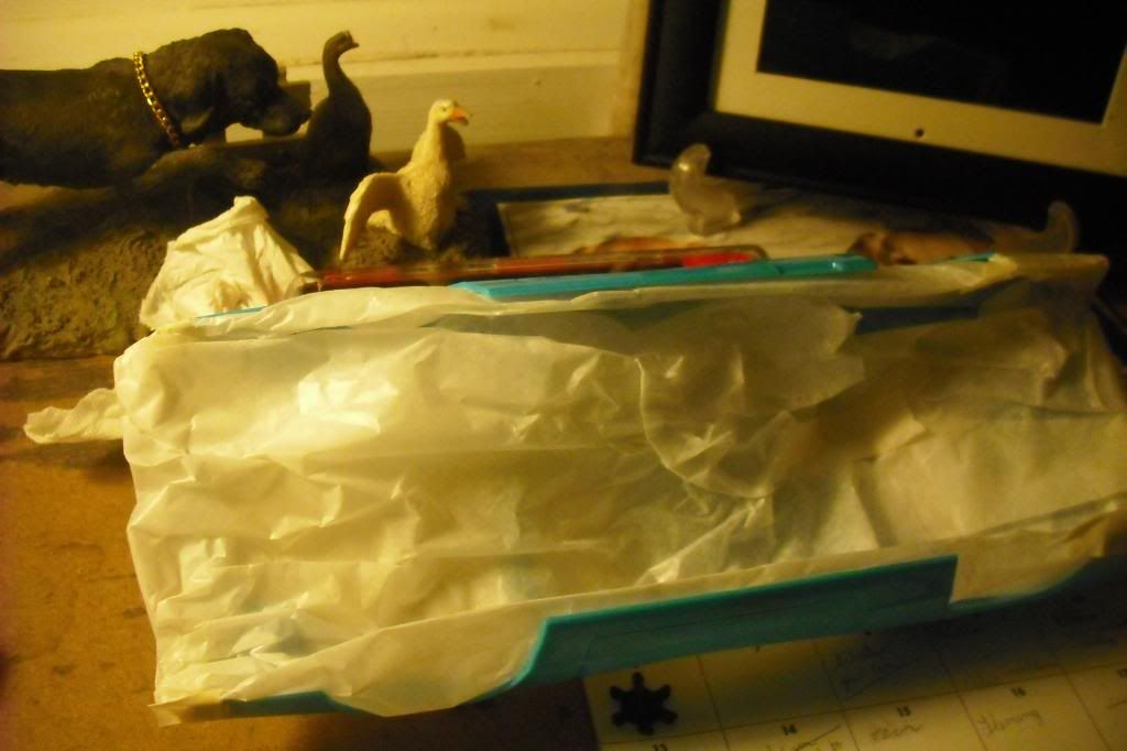

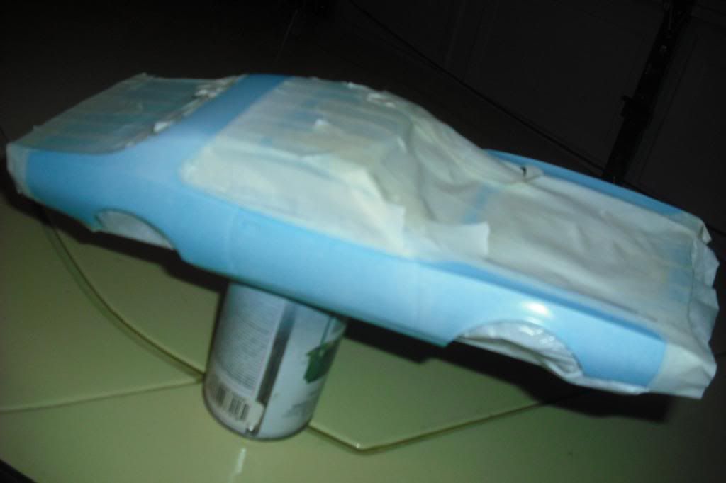

I cut my maskiing tape in strips along the edges of the roll, the thinner strips allow me to make crucial bends needed to create this paint scheme, next use wader tape to finish mask up of body. I used parchment /wax paper to cover the inside.

using the floresant orange required for this kit means that the under coat must be flat white. I achieve  this by layering several thin coats, trying to lay the flat down heavy will cause cracking issues when you apply the orange
24 hours later - lightly wetsand and then spray the orange
this is what I had the next day
Before the decals go on i will wetsand the orange very carefully for a smooth finish

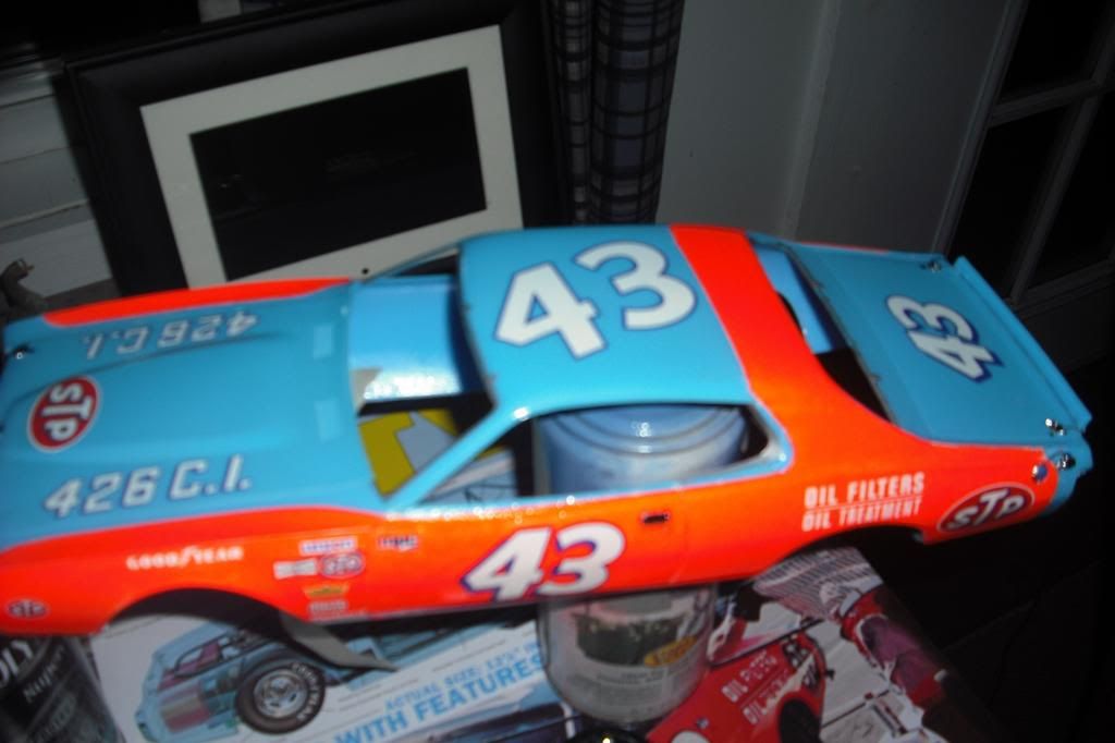

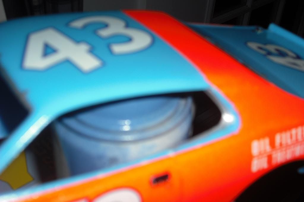

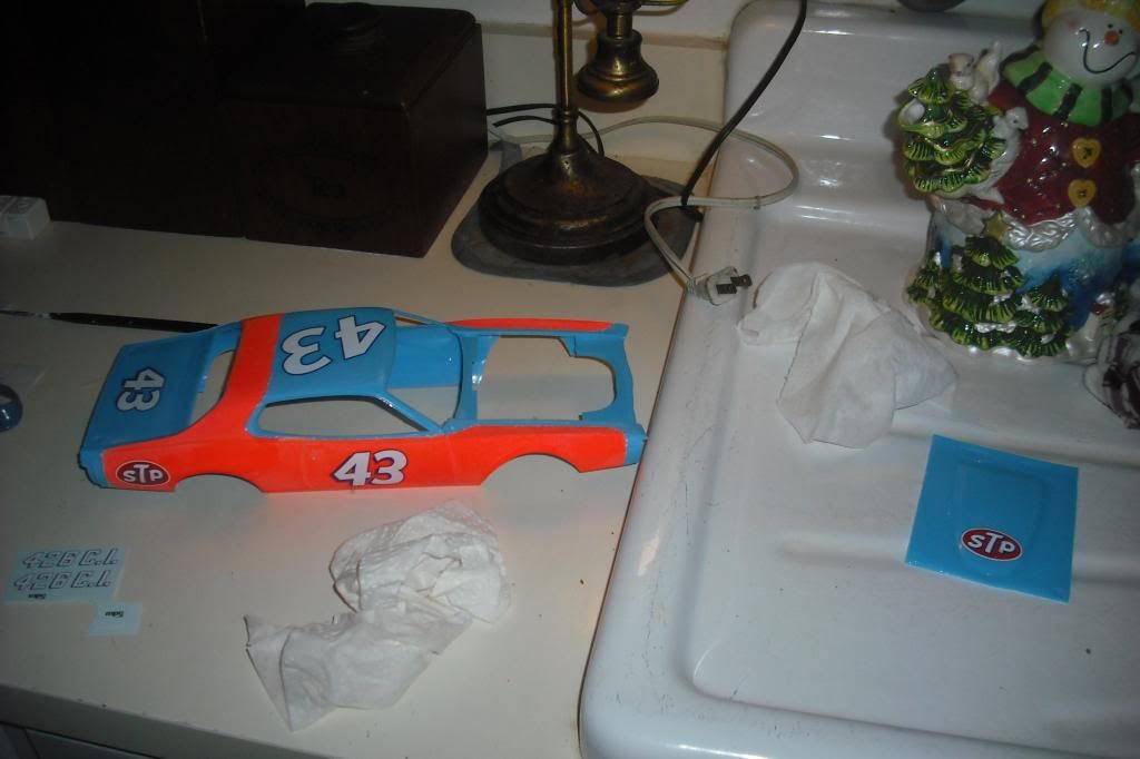

starting on decals
this shot shows the scheme after the first coat of clear coat has been applied

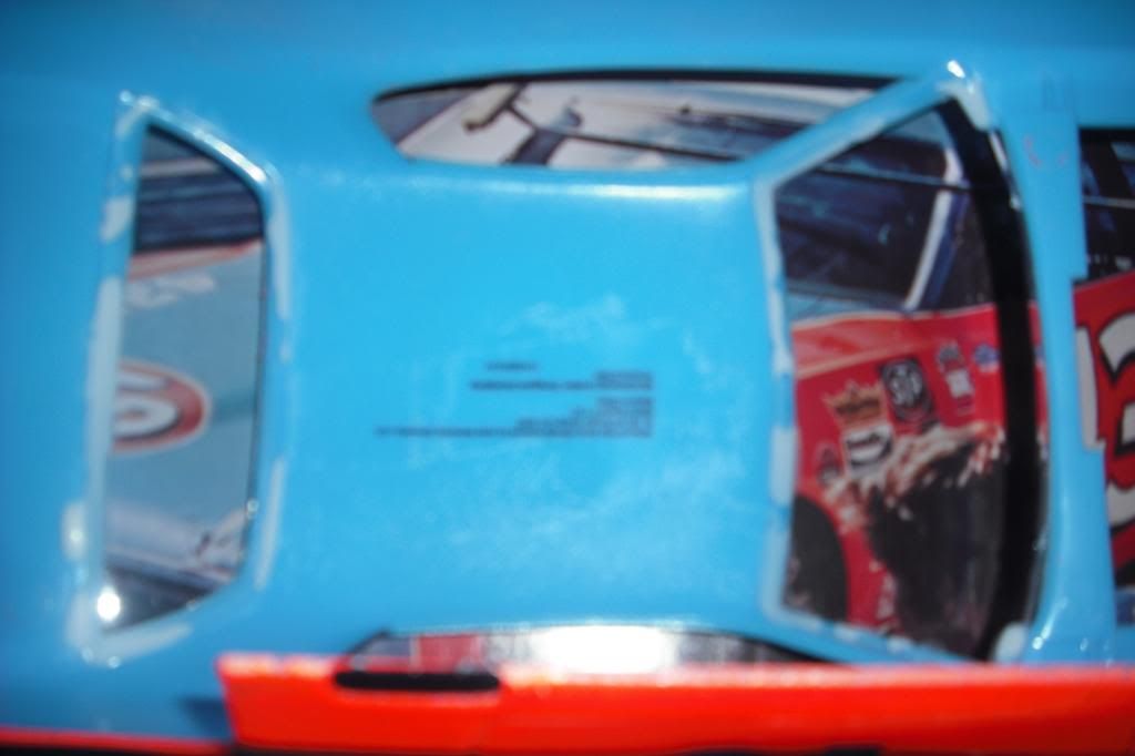

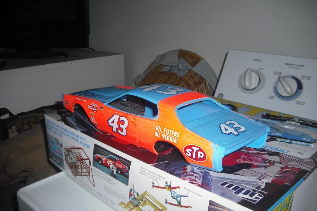

I am digging this build already, but what happen around the corners at the rear side windows with the paint? I notice the same on the front fenders.. or am I just seeing things? (I am tired right now) but good job on the build so far, I'll be watching this project of yours.
not to fear , just some overspray wait til you see the fix , besides if i make it too perfect it will look storebought

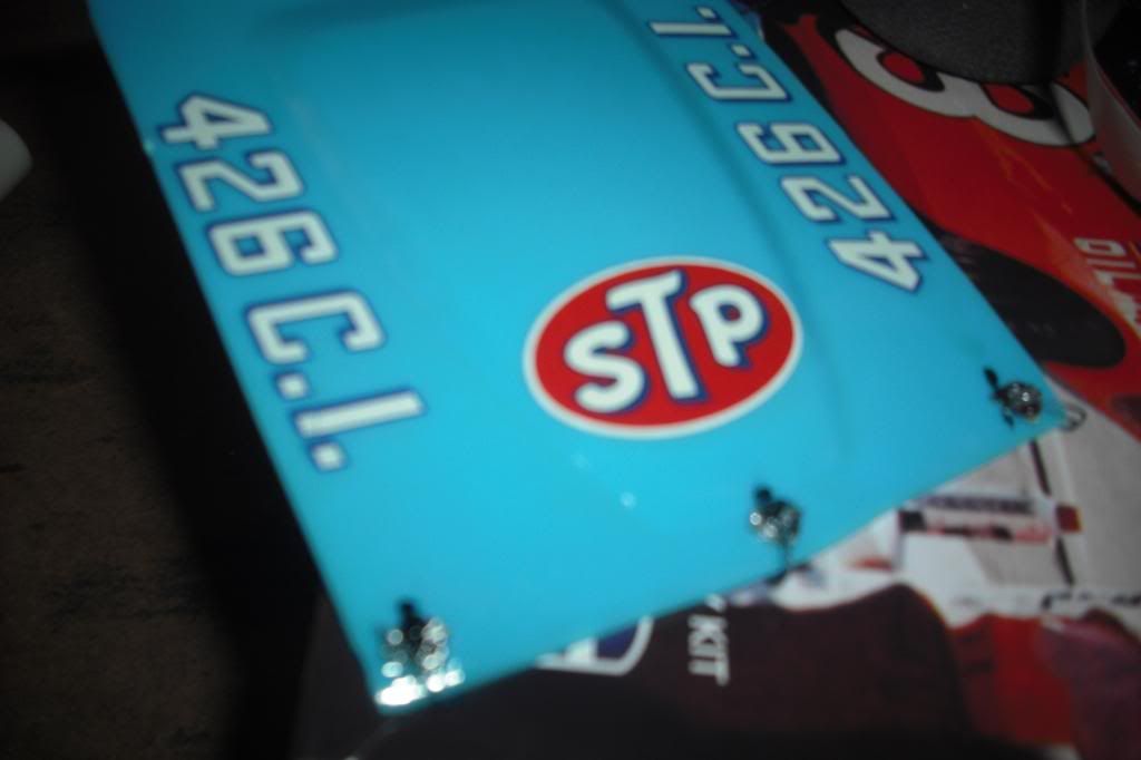

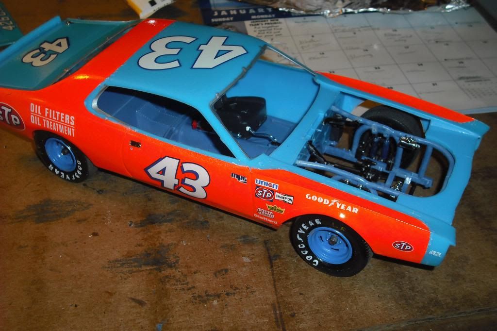

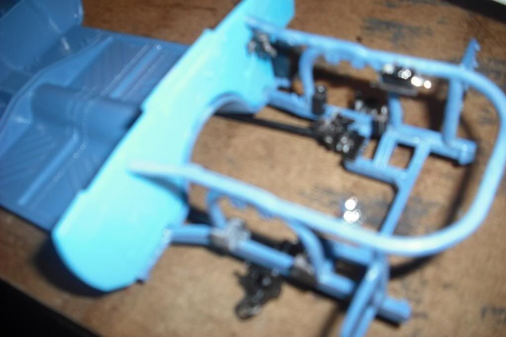

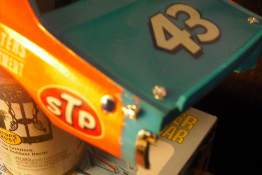

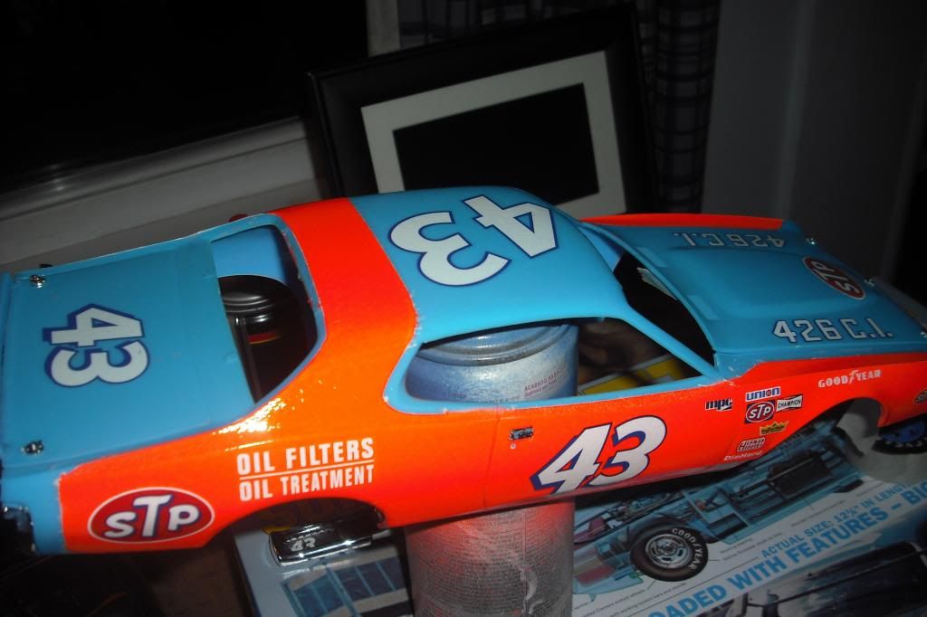

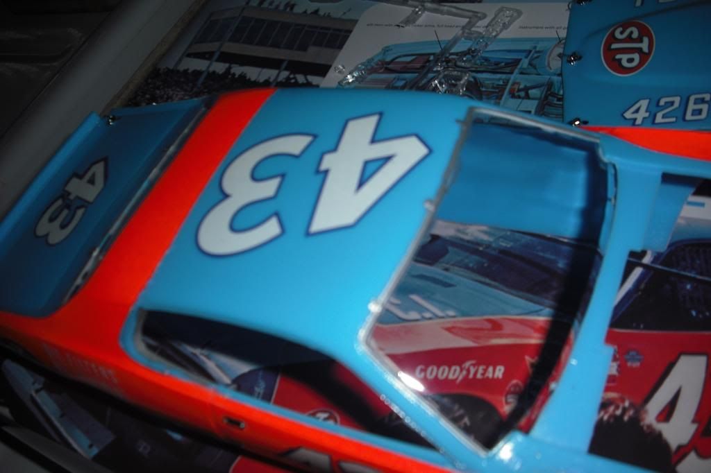

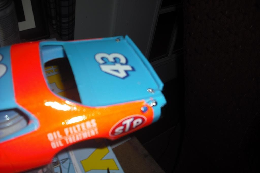

Posted 26 January 2013 - 05:14 AM

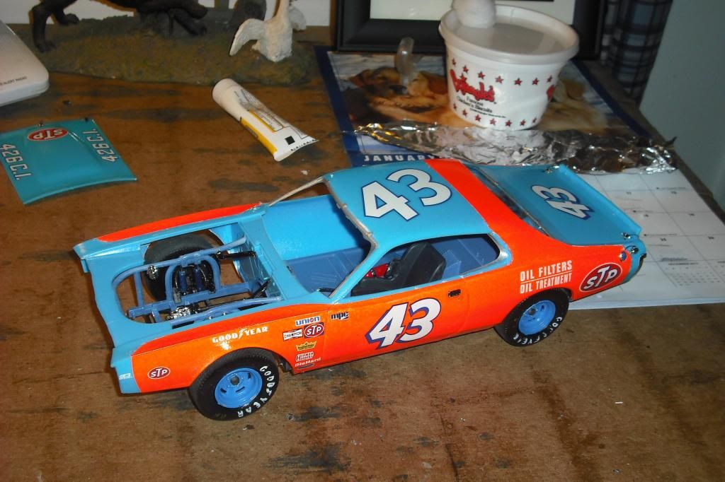

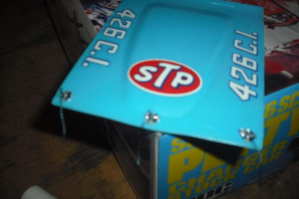

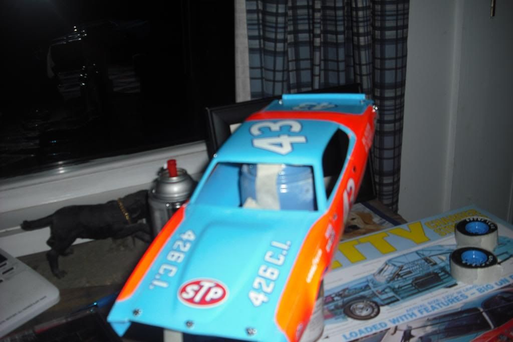

It has been kinda icy around here, currently I am continuing to work on the body - it is too cold to paint parts for roll cage assembly. pictures below are the kit with 2 more coats of clear for a final shine, you will notice I added some of the chrome parts, spoiler, and painted the window trim. I raided my wifes cross stich stash to make cables for the hood/trunk pins and fuel cap. After which a smal black line was painted to simulate the tape keeping the pins in place. Around the rear quarter window , I brushed it some aluminum silver to make the look of the bare metal that is usually on this car.
