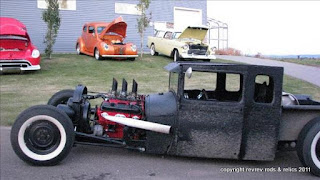

#5 blazefox
blazefox
  • 849 posts
  • Location:vermont
  • Full Name:Steve Gilmore
Posted 28 January 2013 - 04:49 PM
018_421067.jpg36Chev-1.jpgdude+truck.jpgtumblr_lqiveazxQI1qiawrdo1_500.jpgsomething like these
#6 Ace-Garageguy
Ace-Garageguy
  • 9,704 posts
  • Location:Down two, then left.
  • Full Name:Bill Engwer
Posted 29 January 2013 - 08:00 AM
Ummm, these are all different for the specific application. Carefully fabbing them out of brass or aluminum tube will be your best bet. You can solder brass, you'll most likely have to CA aluminum, although there are solders made for aluminum.
Brass tubing usually has thinner walls than aluminum and looks better on the open ends, but if you lightly file the ends inside aluminum tubes, you can make them look right.
Common primary pipes are 1.5" in diameter. That scales out to .060" tube in 1/25 scale.
Bending tubing without crushing it and looking dorky takes practice.
