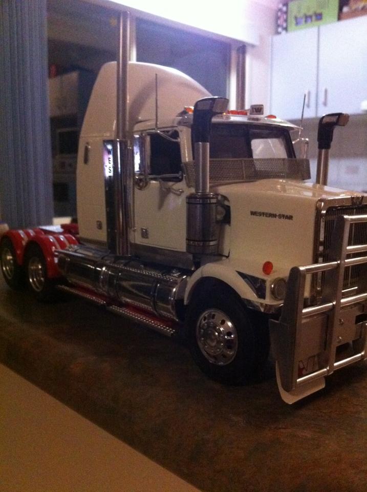

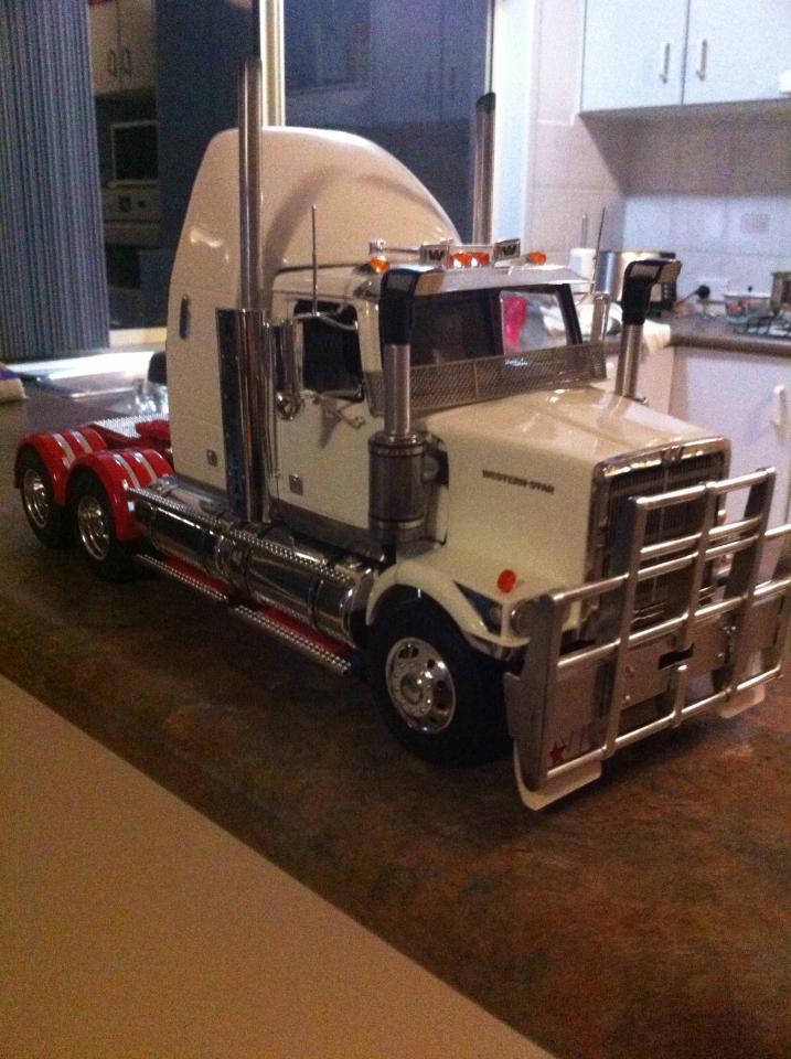

Photos not the best but give it a Attached File  IMG_0451.jpg   97.28KB   176 downloadsAttached File  IMG_0453.jpg   91.88KB   208 downloadsAttached File  IMG_0455.jpg   81.45KB   189 downloadsAttached File  IMG_0457.jpg   84.1KB   147 downloadsgo

Really nice! Looks like an SAR. Which Western Star Italeri kit did you use to make your conversion?

I cant tell in the pics but whats under the hood? Looks good tho!

The donor kit is Italeri Western Star 5964 ConstellationTRUCK KIT- 3874
The engine is Auslowe resin series 60 Detroit
Hood is Auslowe 4900 conversion shortened 17mm then widen 2.5 mm each side then recast
Front of cabin and air cleaners Auslowe 4900 conversion
Converted to right hand drive
Cabin floor modified to accept engine under cabin new engine tunnel fabricated and moulded
Rear of cab and front of sleeper cut to make full walk through
Sleeper cab shortened 25mm
Front steer axle moved 4mm forward
Auslowe mudguards,bull bar and windscreen stone gaurd
Skirts on bottom of cabin photo etched
