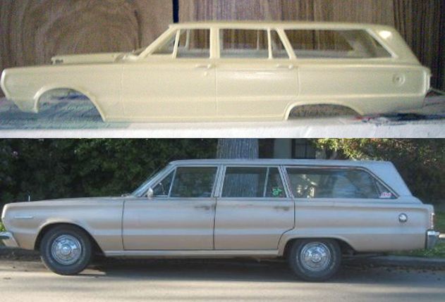

Yes, B pillar needs to go back, rear door is too long, and look at the body at the base of the C pillar.

Maybe this will help.

Ok, you can really see the work needed now, so how do I fix it? Going by the pics moving the B pilliar back on it's own isn't going to work. The C pilliar should be a fairly simple to fix.

The B pillar needs to be angled the opposite way that it's angled on the resin body-it should be angled back, not forward. The C pillar looks passable, bit that thin glass divider strip just ahead of the C pillar is also angled the wrong way on the resin body... it should angle back, not forward. The vent window divider strip, the B pillar and the divider strip just ahead of the C pillar should all lean back and lean at the same angle.
The D pillar is also going to need attention. Notice how on the real car it starts out much wider at the roof, then tapers and gets much slimmer at the bottom; on the model the pillar sides are almost parallel. Also, that little "kick up" where the D pillar meets the body is completely missing on the resin piece.
Door handles are in the wrong place, too. Easy enough to cut off, but still...
