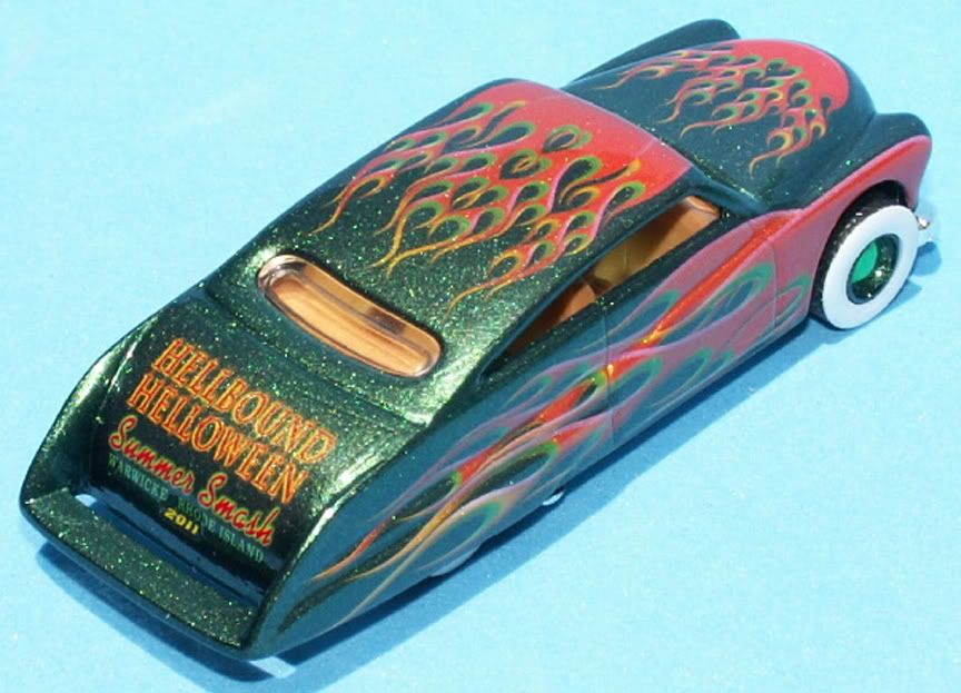

Here's a Black car with some of my Flame Decals that is ClearCoated using a little Emerald Green Pearl.
The Decals are hardly affected but the Black background suddenly changes completely to an Electric Emerald Green.
Here with the Purple version using Lavender Pearl Powder over a Black background,
And another Emerald Green Convention car I created,
A little Pink Flamingo Pearl in the Clear over Purple,
Shimrin Gold Pearl in Clear over HOK Tangelo Pearl,
You can see how the Pearl show more intense at different light angles,
The same Gold Pearl in Clear over Tangelo Pearl combination showing how the colors shift,

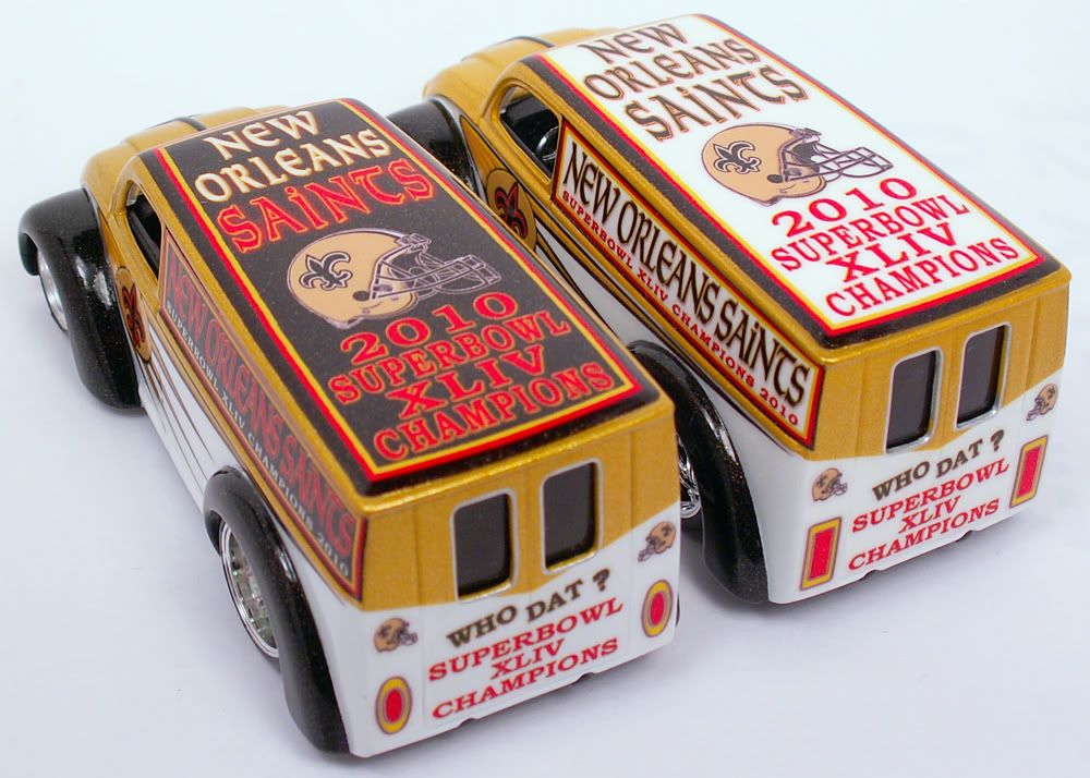

This little buggy above with Dallas Cowboys decals and the Dallas Cowboys pearl colors your mentioning would be a superb build for anyone :D
#12 CadillacPat
CadillacPat
  • 771 posts
  • Location:Houston
  • Full Name:Pat Parker
Posted 31 March 2013 - 11:21 PM
Yes Hooter, I did a Cowboy Dairy Delivery Custom for a guy in Dallas.
The Silver and Blue colors are okay but they just don't have enough contrast for that Wow factor.
CadillacPat

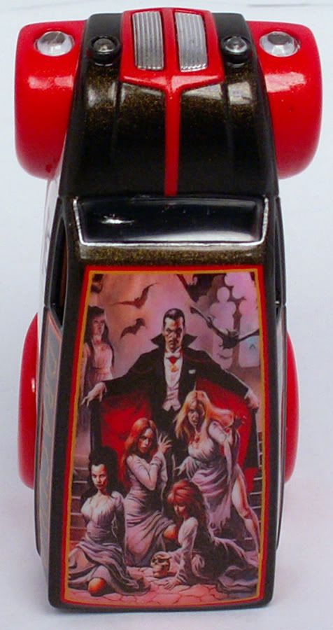

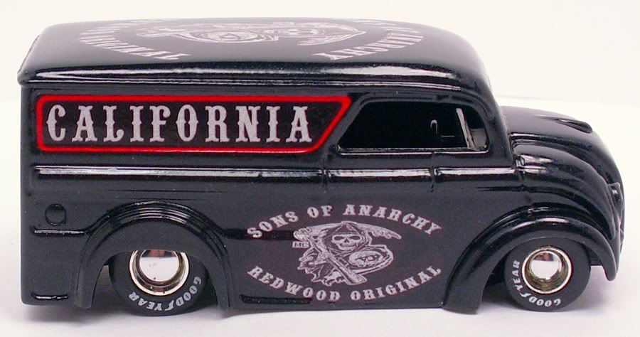

Pat, what process do you use to make your decals? White letters on black indicate they're not ink jet.
Don, those are!!!!!   They're made on Clear InkJet Decal Paper from Papilio.com
I don't use the White Paper because it is so much thicker than Clear.
When I first got online DieCast Customizers for the large part could only use a homemade Decal on a light color of car.
While most of my Promotional Customs at that time were made using SnowWhite Pearl HOK I also wanted to put graphics on cars of any color.
So, I came up with this process,
Above,
After Primer the fenders are shot House Of Kolor Black,
Fenders are dusted with InterCoat Clear for Taping, then taped and the whole thing is shot HOK Shimrin White and then HOK SnowWhite Pearl,
Upper left and right side Panels are taped ujsing Tamiya Tape and a Frisket mask, made from one of the roof Decals themselves, is attached to the roof and the whole thing is then shot House Of Kolor Zenith Gold,
The nose is dusted with HOK InterCoat Clear for taping, taped, and then the grill outline is shot,
All tape is removed and then the Decals go on.
So, when I want true color InkJet Decals on dark colored DieCast, I just AirBrush a White surface that will fit behind the Decal image.
It's the same with many of the flamed HW Passions I have in threads.
