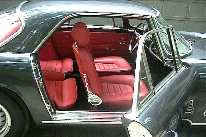

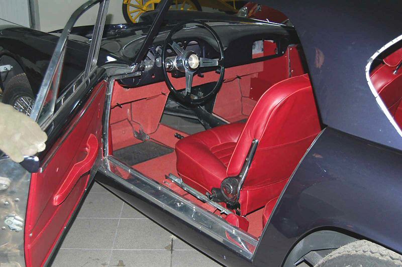

Posted 25 February 2013 - 11:58 AM
Alas, I have to rely on aerosol spray cans.
To be totally anal about this, there should be a thin strip of body color between the vertical part of the windshield chrome and the door window chrome.

Posted 25 February 2013 - 12:07 PM
You're right, of course. I need to have a look at how the chrome on the door parts work, but it looks to me as though I need to scribe down the pillar (that thin, fragile pillar), and also carve the windscreen lower corner trim up into a curve to meet the vertical. And I can see, now Paul mentions it, that the base of the windscreen is too rectangular, But I'me really not going to try to fix that!

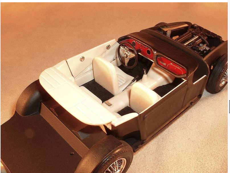

General note: simonr did a fantastic build of the Aston DB5, which is a sister kit to the Maserati -- many of the same issues, including fixing the hood scoops. Might check it out. It's somewhere on this forum.
About the valances: The tricky part about mounting the body, as you slide it on from the front, is making sure that the front fender liners (attached to firewall and front of chassis) tuck inside the fender tops. It's tight, and I highly recommend that you do a test fit here.
As you mentioned, the rear valance leaves a big seam along the rear quarter panels. That type of seam is typical of every XKE model. Here's one approach to covering it up after assembly on the 1/8 E-Type, using a masking/feathering paint technique...
http://www.modelcars...showtopic=64075

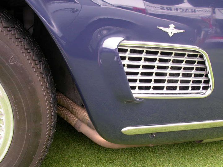

As long as you're doing the bodywork, and in my annoying quest to add considerations to the build, you might want to think about adding a small louver in front of the inaccurate side vents.

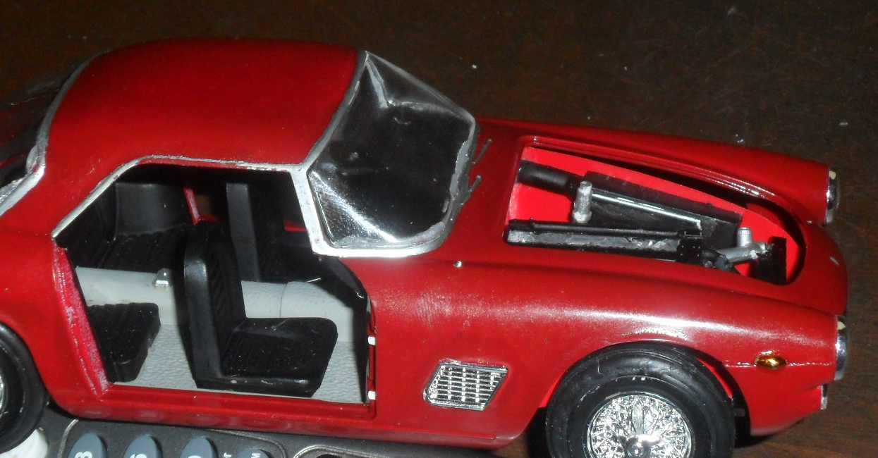

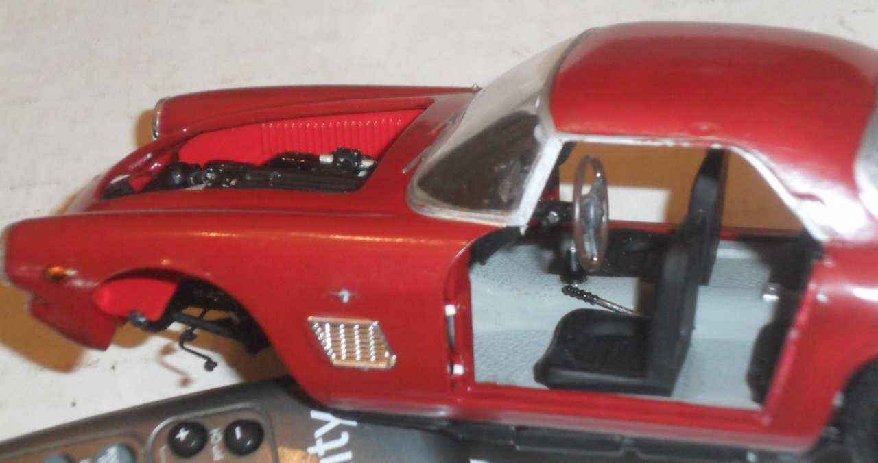

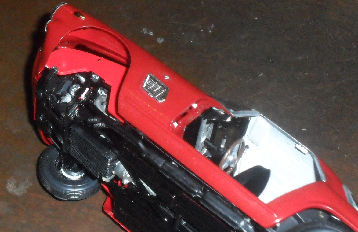

I have 3 of these kits, I was surprised to see yours in white plastic since the one I have opened is molded with red plastic.
I have see a separate grill offering from Detail Master SKU: dm2585, in case you don't want to buy a whole detail set just for a grill.
I haven't opened my kit of this for a while but you might be able to resolve the rear valance problem by separating some of the parts from the chassis (that make it impossible to get the chassis in with the valance attached) and attaching them to the body.
this kit looks like it may have been an produced by aurora originally, I have a DB4 that has many of the same build/assembly features.
