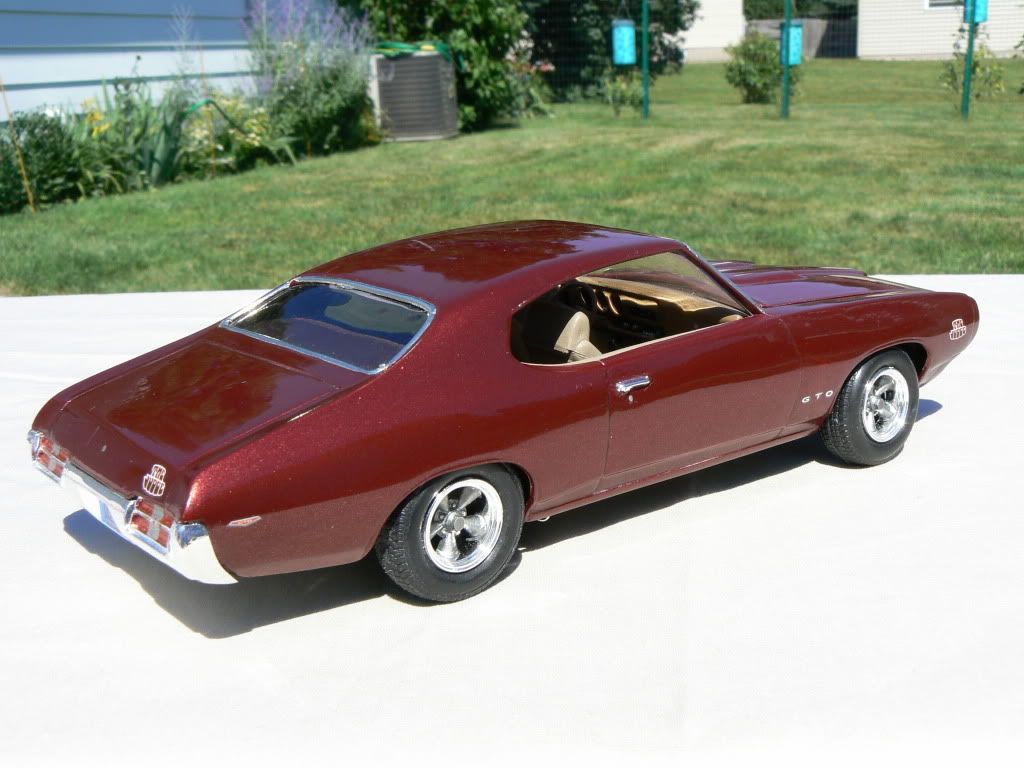

I've used tint film that I picked up at Walmart (still have a ton left on the roll)...the biggest challenge is to keep from getting air bubbles underneath it.
The rear window of my GTO is tinted with the film, on the inside as it would be on a 1:1...
