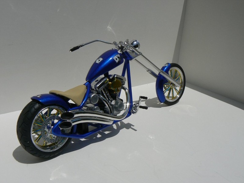

Anne
I prefer to use both.  I like spray cans for the bodies.  Cans give you a nice big spray pattern to help keep from building too much paint in one spot.  Tamiya spay paints are my favorite.
I then use a single action Badger airbrush to piant samll parts, interiros etc.  Here spray cans put out too much paint too quickly and make it difficult to get good paint coverage without drowning the part in paint or getting runs in the paint.
Here is an example of the results I get with this method.
Hope this helped.
