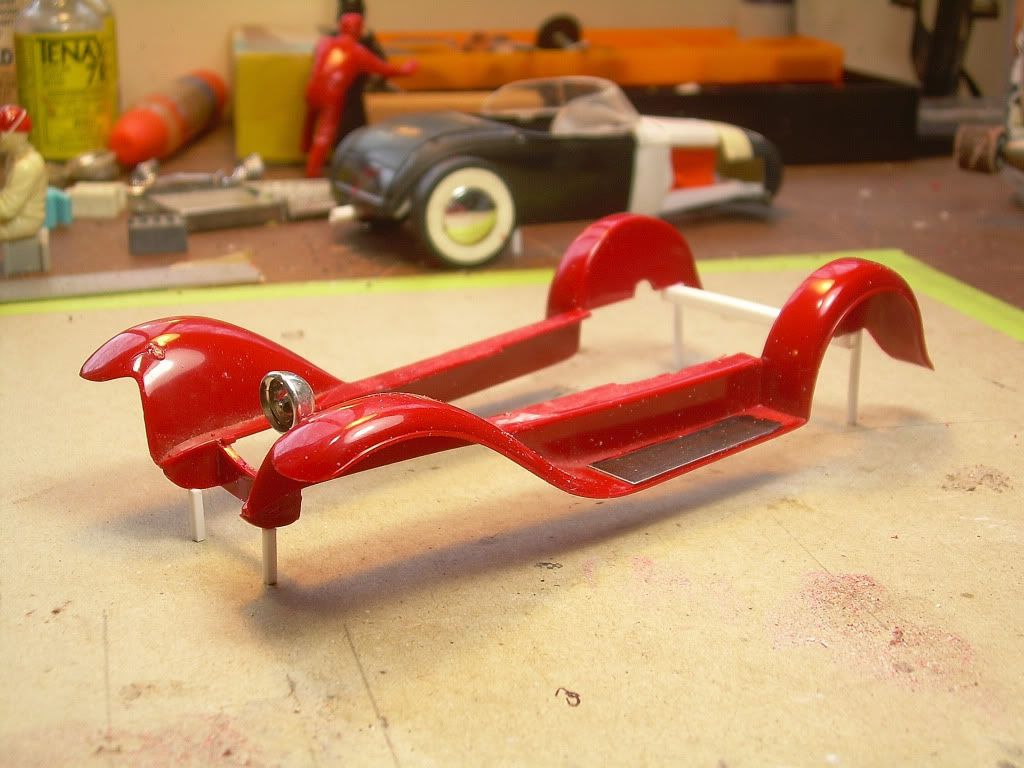

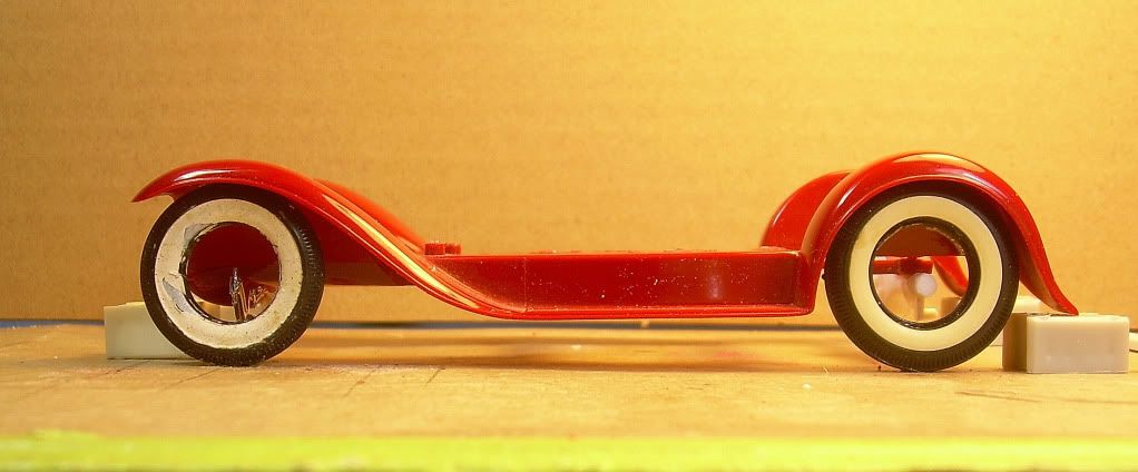

First order of business was to set up the stance. The relationship of the tires to the fenders shown here is about as low as you can go in 1:1 and still steer, and have sufficient suspension movement. Look in the center of the wheels, and you see I'm establishing the axle center-lines with available parts. Stance is everything, and the suspension will be built to keep the design-stance exactly.
To lock it in, I made up temporary stands from 1/16" square stock.

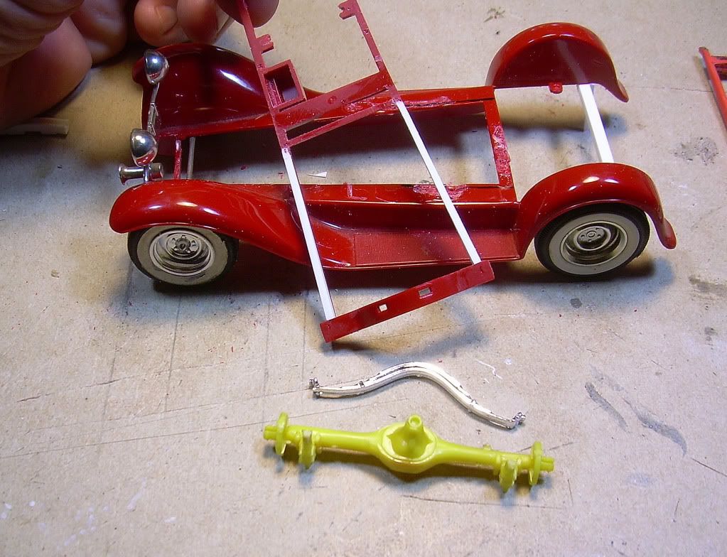

To lower the rear of a Ford Model A (1928-1931) you usually have to raise the rear crossmember relative to the frame. Easiest way to do this, after carefully cutting off the crossmember, is to add wedge-shaped pieces to the existing frame rails...

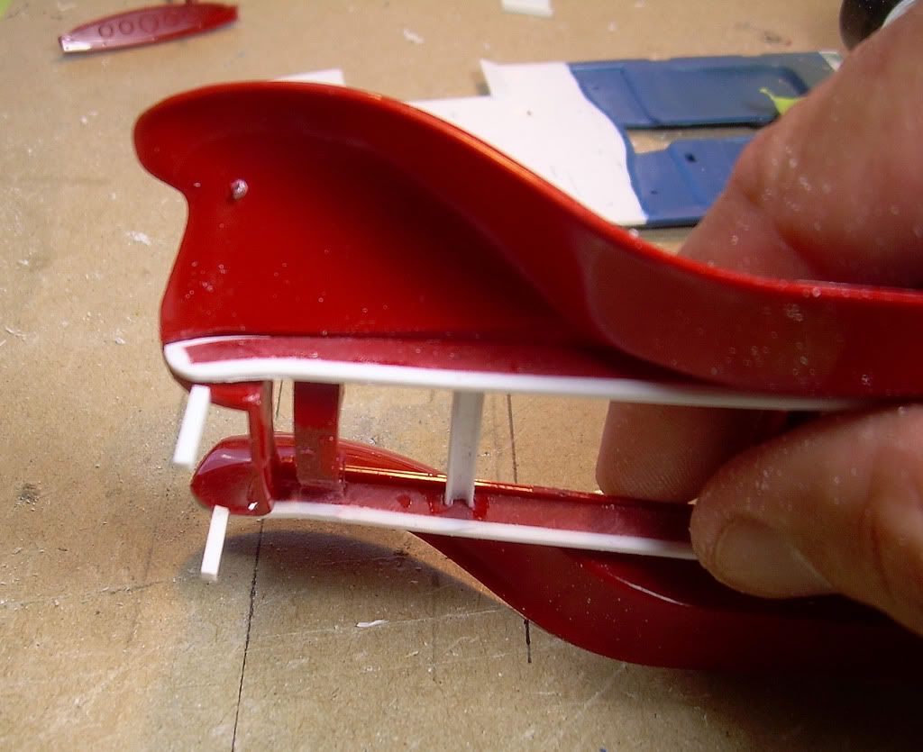

Then re-attach the crossmember in the new, higher position. This works on any model A kit, and the real cars. I've also reinforced the underside of these brittle old rails with 1/16 styrene square strip, and am reshaping the front of the rails to fit inside the fenders better.
Nice fit...
One thing to remember is that when you put the wedges on top of the frame rails in the rear, you have to make clearacce in the floor for them. This build will probably get a looks-like post-'57 Olds / Pontiac rear end, with scratched brackets to attach the buggy spring at the correct ride height.
With a little work it should be quite presentable.

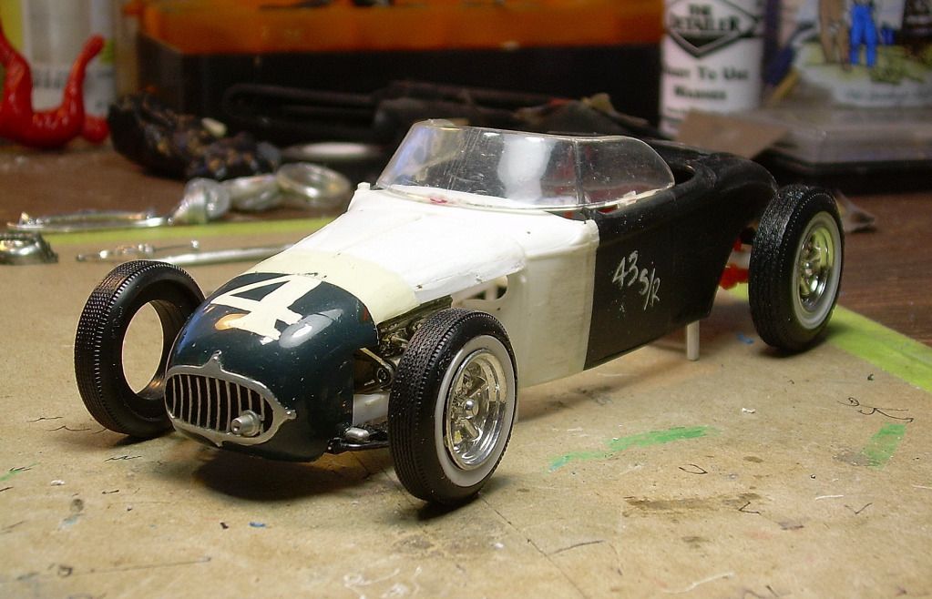

Lorena is lookin good, but what I want to know is what is that lil' black roadster in the back ground???????

.....but what I want to know is what is that lil' black roadster in the back ground???????
That's my Ace-Garage Special. It's actually a build for a 1:1 I'm doing for myself. I thought I had a thread going for it on this forum, but I can't find it.

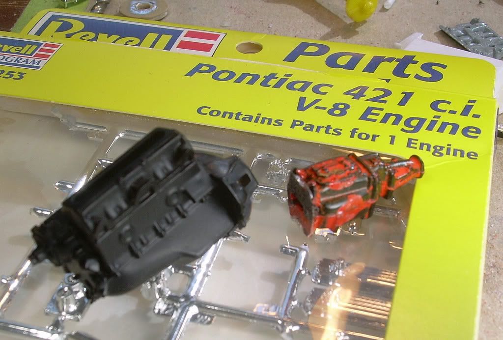

The engine will be a Pontiac from an old Revell Parts Pack kit. These build up beautifully with care.
