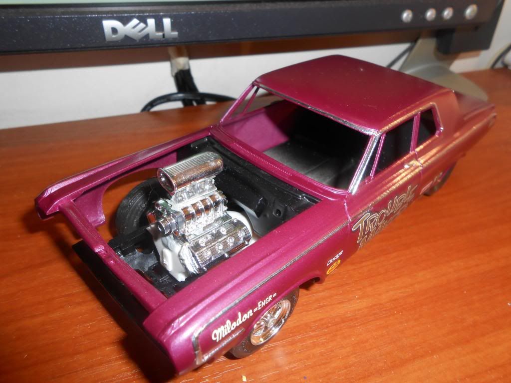

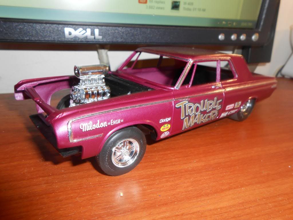

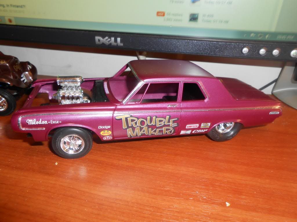

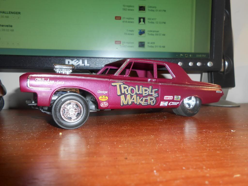

Been working on this gasser for a couple of weeks now trying the right rim, tyre combo and the decal placement and think i have found the right combo. Also swapped the 426 hemi for a 392 hemi for something a little bit different. Painted in mulberry from dupli-color rattle can. Still have a way to go yet so will post updates as i go along. Cheers and thanks for looking.
015_zps8b32c624.jpg016_zps2335d12f.jpg017_zps380a7631.jpg018_zps4a158248.jpg019_zps0957d13b.jpg

Which frame did you use dont look like the kit frame.

Cool idea going with the 392.

Hi Steve did use the original chassis setup but removed everything from the front end except for the k member then used the leaf springs from the amt willys kit and had to lenghten the front axle to fit the body. This way i was able to delete the inner guards which gives me a better choice of what headers i want to use, Also mini tubbed the rear end and installed a 9 inch from the parts box and moved the rear springs inboard for it to all fit. Hope to have a few pics up soon. Cheers
