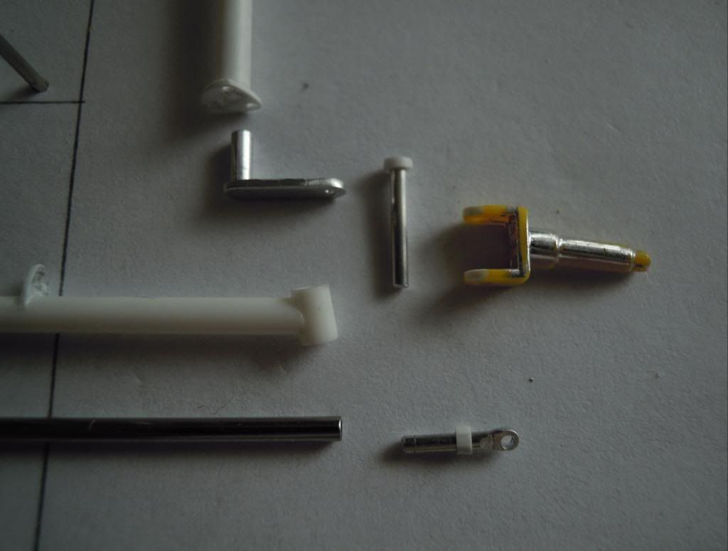

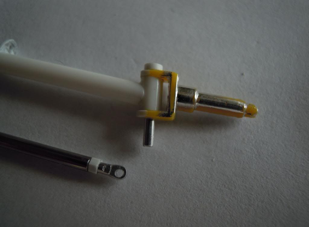

Various parts for the front axle assembly. Use of .045 aluminum rod, .032 aluminum plate, .062 stainless tube, .060 plastic hex rod, .020 plastic sheet, .080 & .100 plastic rod.
Spindle assembly & radius arm
Torsion bar connection and first spindle assembly

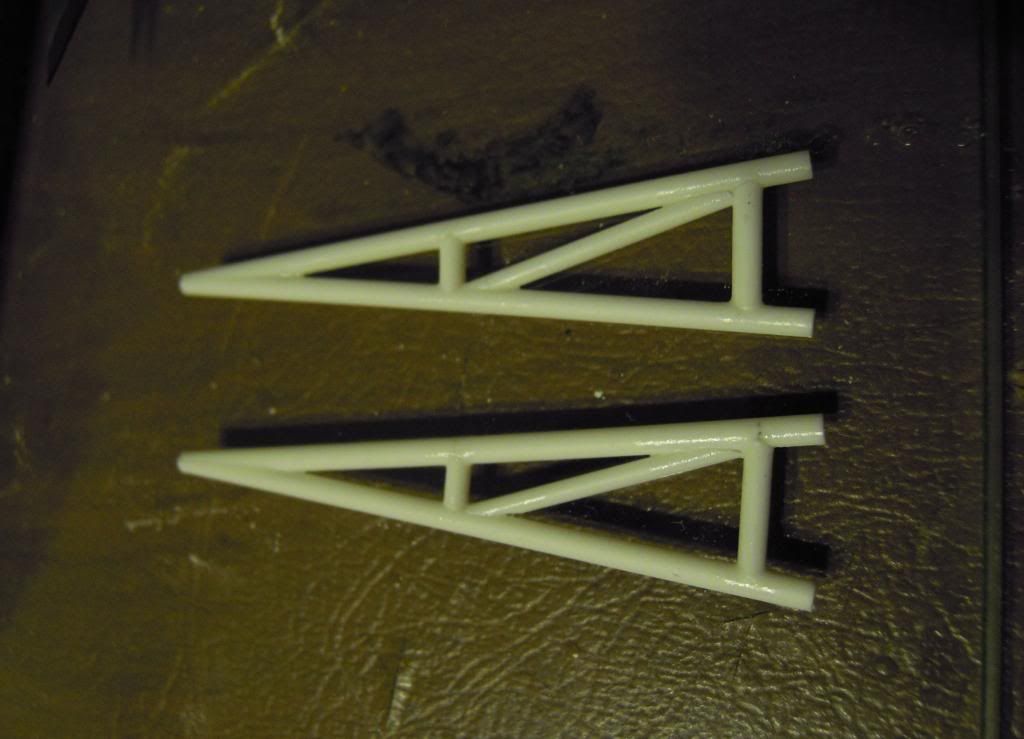

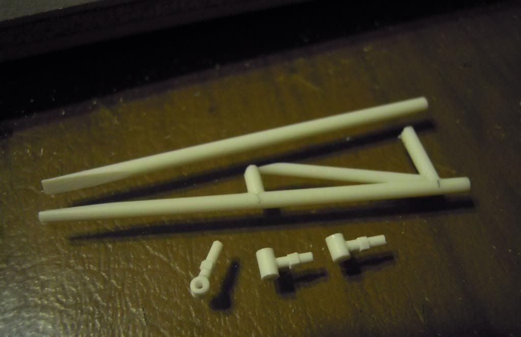

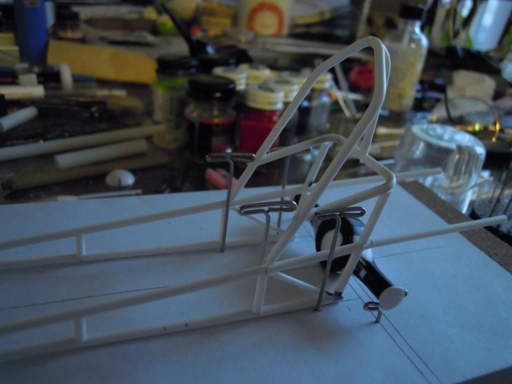

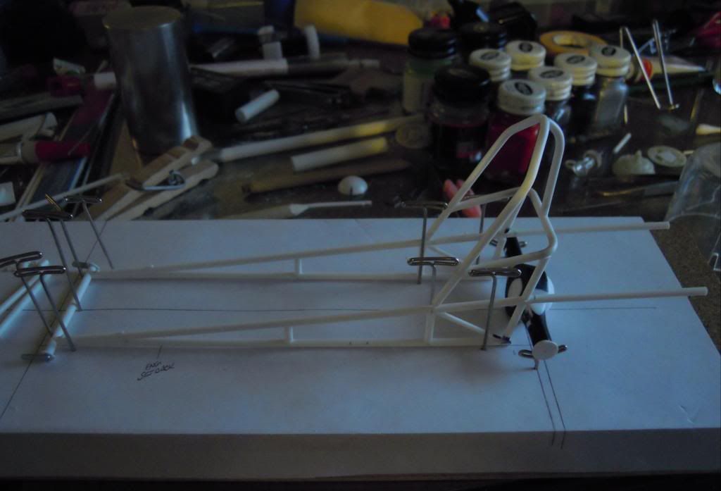

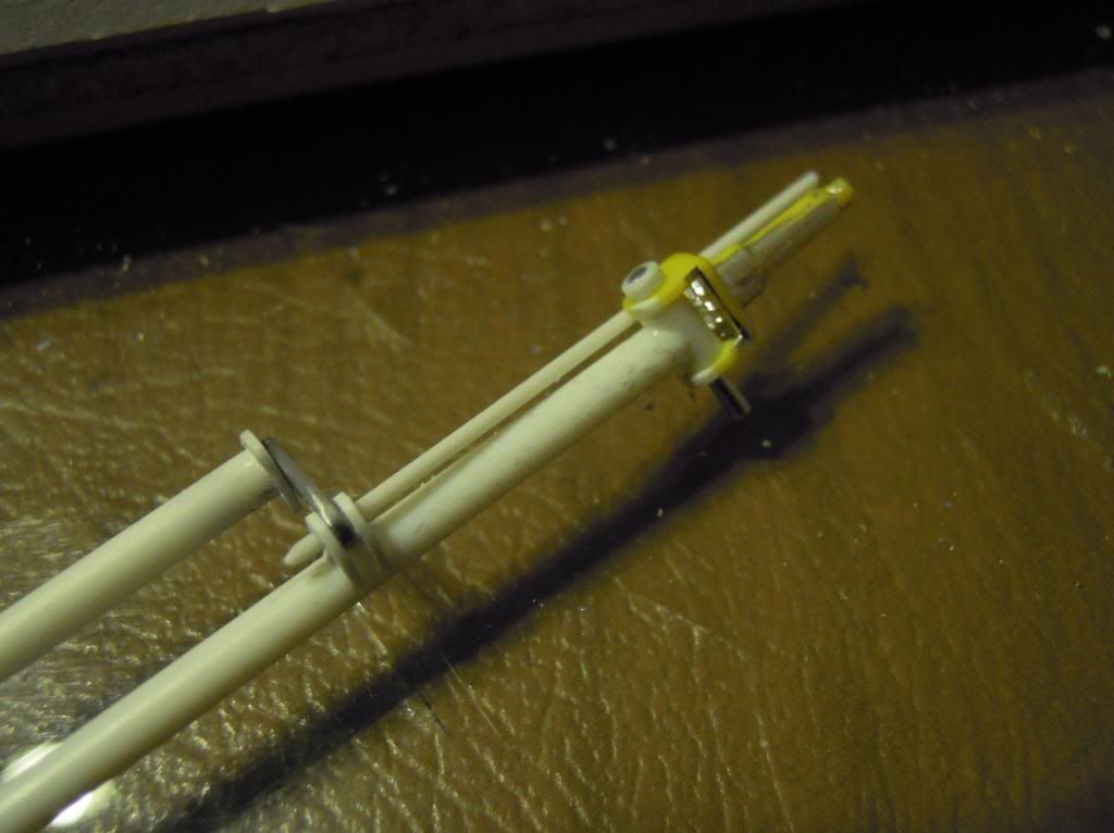

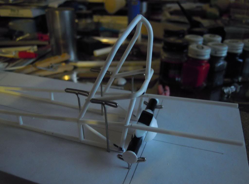

Working on the Olds rear end and this is the ladder bar that I plan to use. Trying my hand at plastic rod ends with another attempt at aluminum ones next; then to decide which to use.

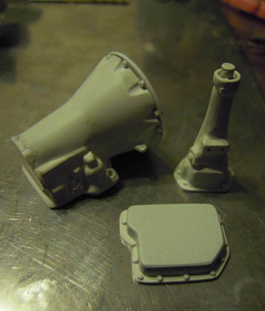

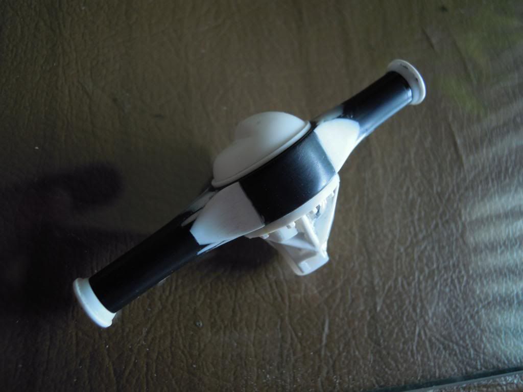

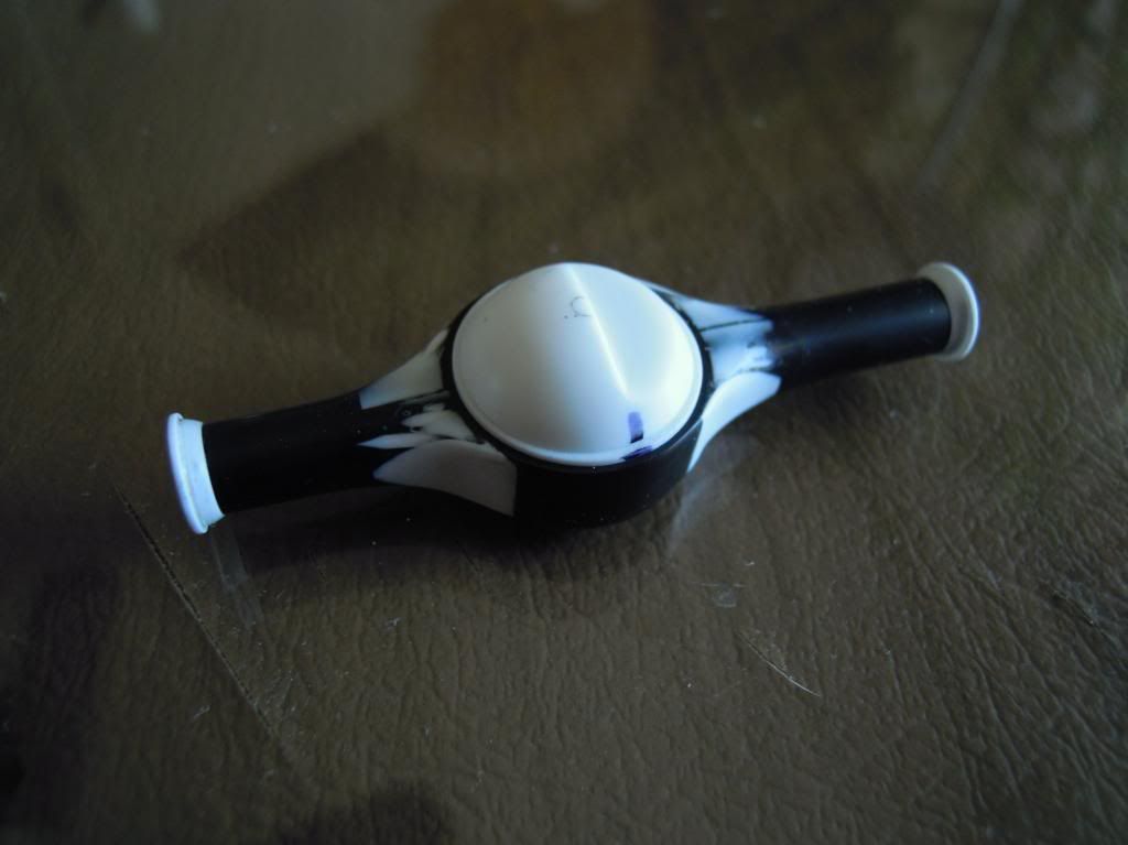

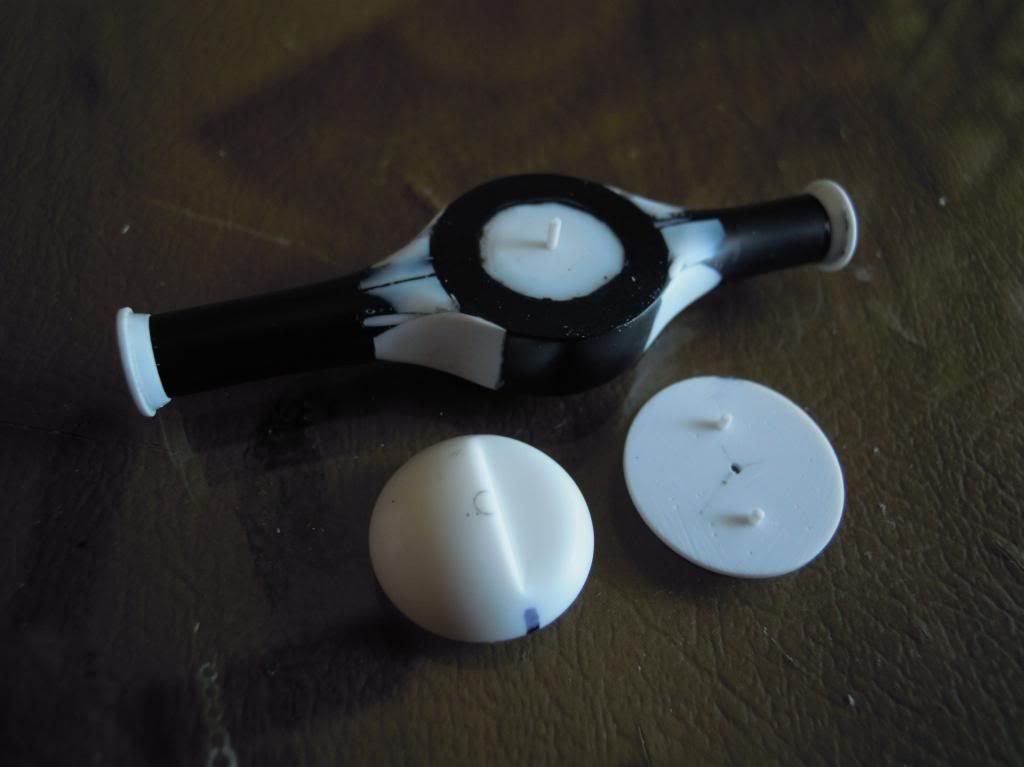

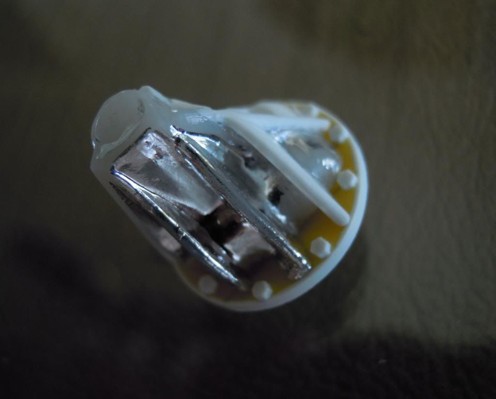

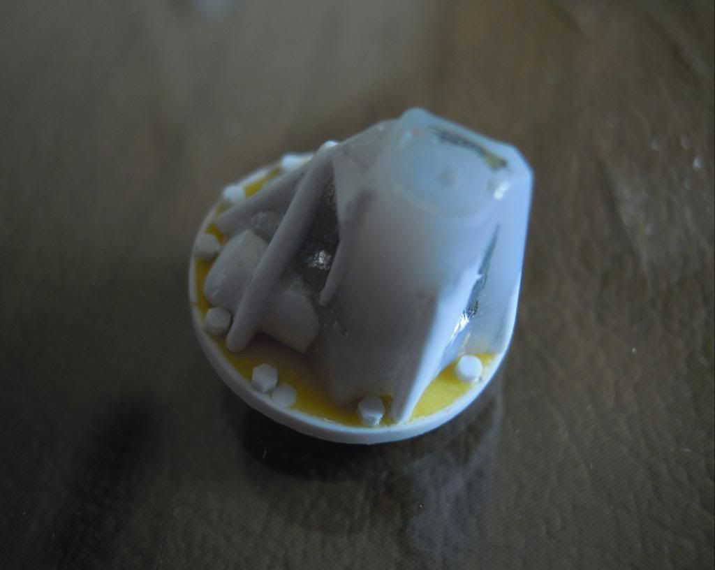

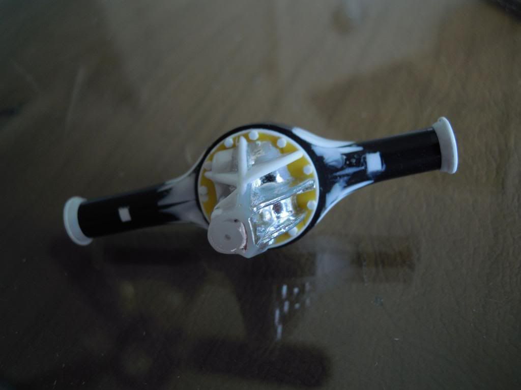

Early progress on the Olds rear end needed for this build. Started out modifying the Revell kit rear end and third member (not shown yet) and will be adding drum brake parts by the time it is complete.

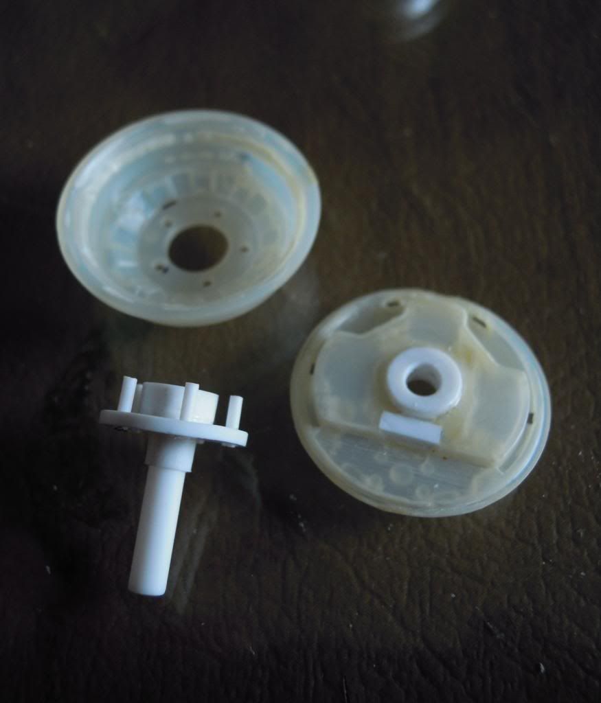

Casey, I will be scatchbuilding the front 12-spoke wheels. Going to make them to fit the existing tires for Revell's FE dragster kits. After I do one spoke, then a mold will be made to copy it and then pull six good ones for the wheel assembly. I will be posting pix of that soon.

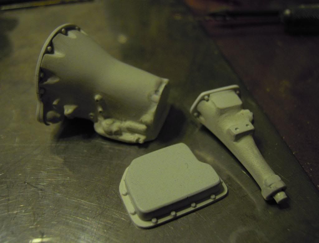

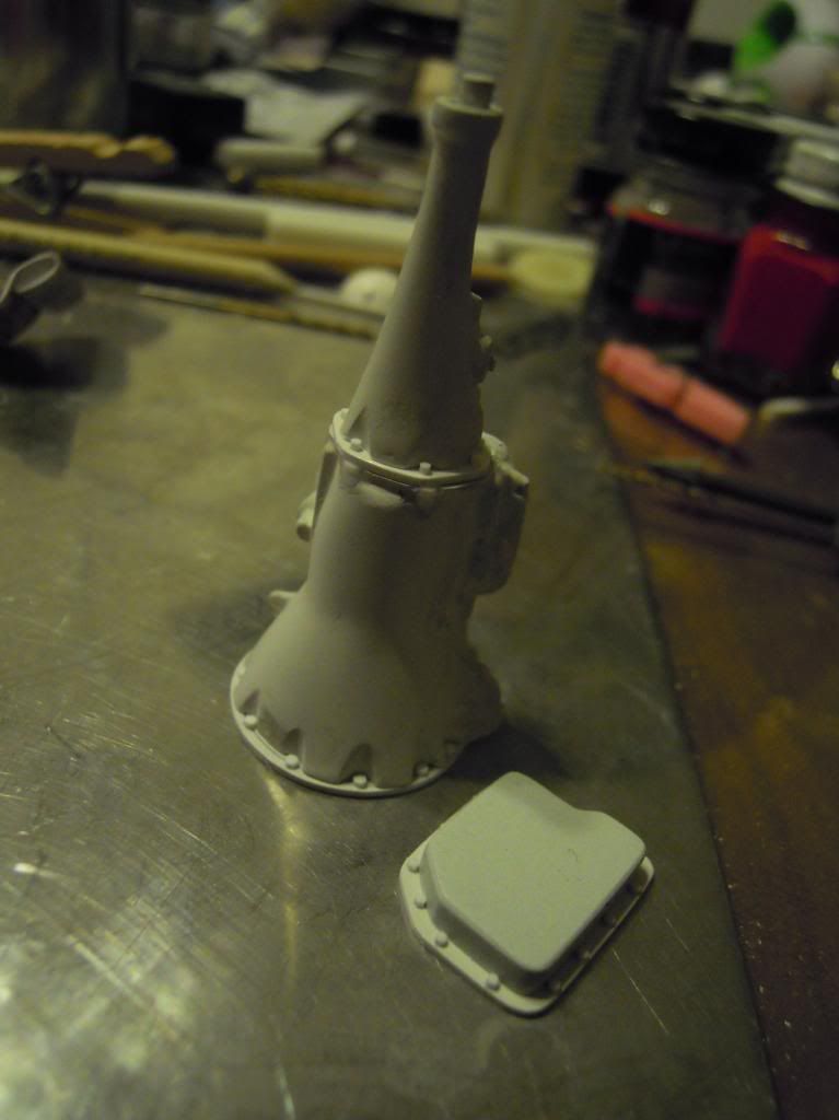

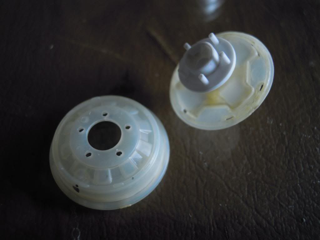

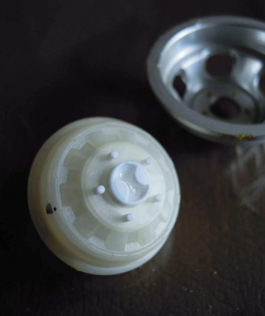

Finished the third member for the Olds rear end. Now to get the backing plates and drums for the brakes done. I can proceed to make the attachment ears for the ladder bars and get the frame on wheels.
