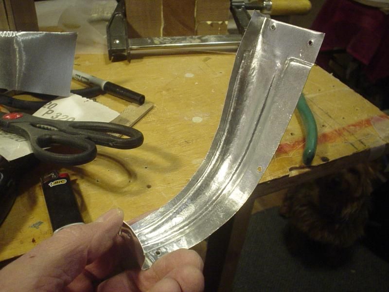

I think you miss my question my friend, I was wondering what did you use to attach the round stock to the other round stock on the front cross member. It looks like super glue, but was wanting to make sure though.

I misunderstood your question, sorry.  :)
Thanks, Tom.
I stuck it together with super glue before removing it from the assembly jig.
I use a product that I get from my lutherie supply house that I'm quite impressed with.
My plan, from early on, after watching a guy tig weld a .003" coca cola can with no blow through, is to tig the thing together.
I don't use credit cards, so until I accumulate the cash for a welder I'm using this.
After having done several strength tests on aluminum, I feel confident that It will allow me to proceed with shaping & fitting all of the parts without everying falling apart in my lap.
Acetone is an excellent de-bonder for this glue, so when the welder shows up, simple matter to prep the parts for welding.
I'm keeping all of my jigs intact to simplify the weld up at that time.

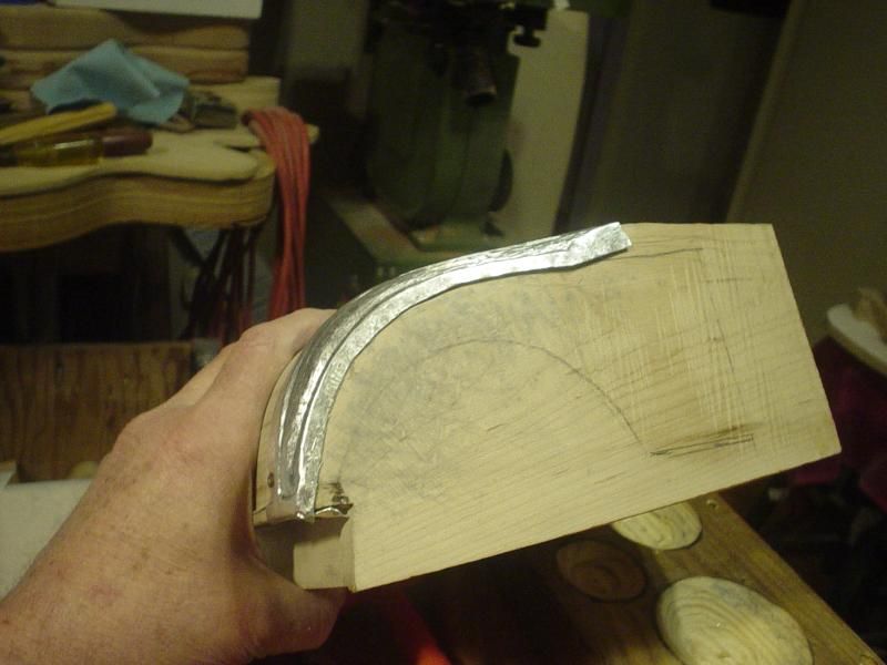

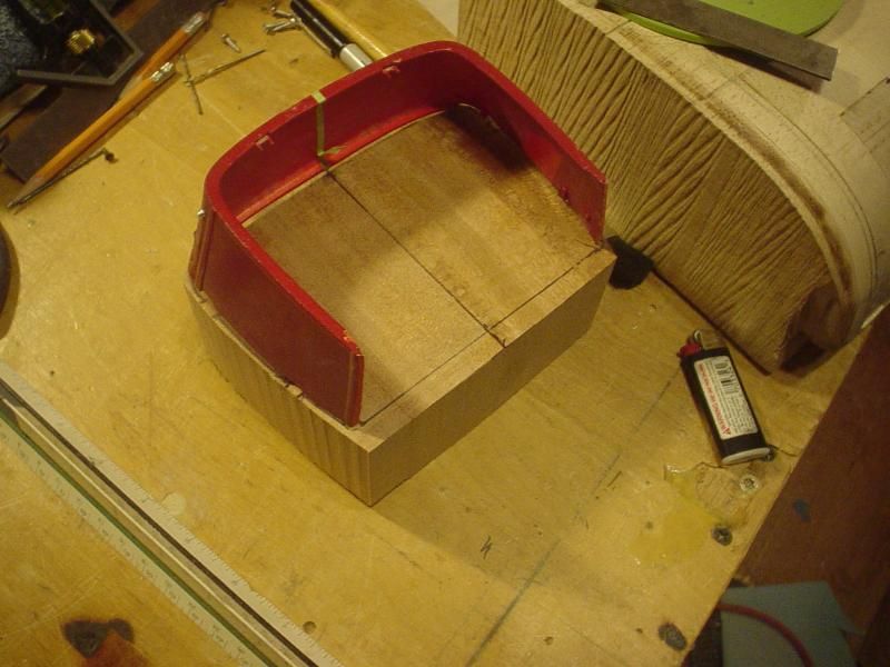

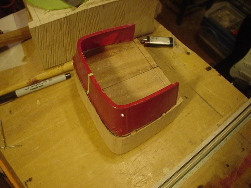

Ok, got it figured out.
This is my hard maple block for development as a hammer form, in shaping body skins.
The centerline template was shaped previously from the kit body.

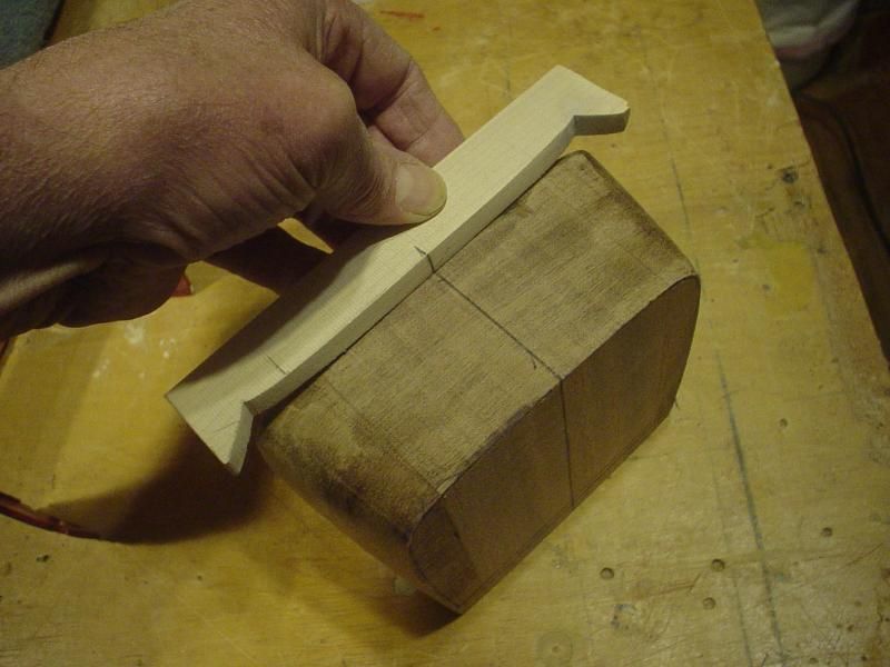

#254 Ognib
Ognib
  • PipPipPipPipPip
  • 441 posts
  • Location:kc,mo.
  • Full Name:Ray Haines

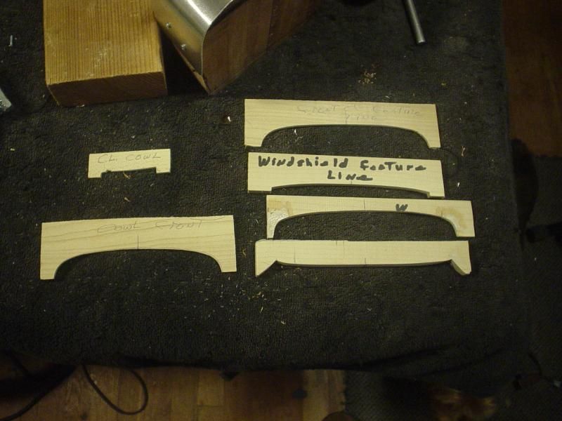

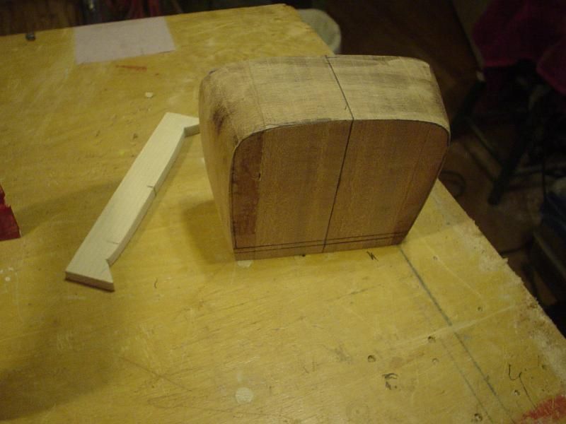

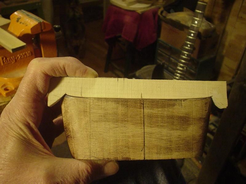

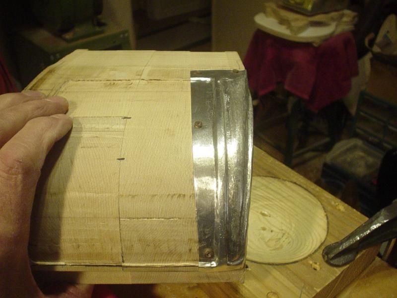

Posted 04 February 2015 - 01:30 PM
Cut a template to fit the rear of the cockpit & transferred it to the buck, using the centerline template for location.

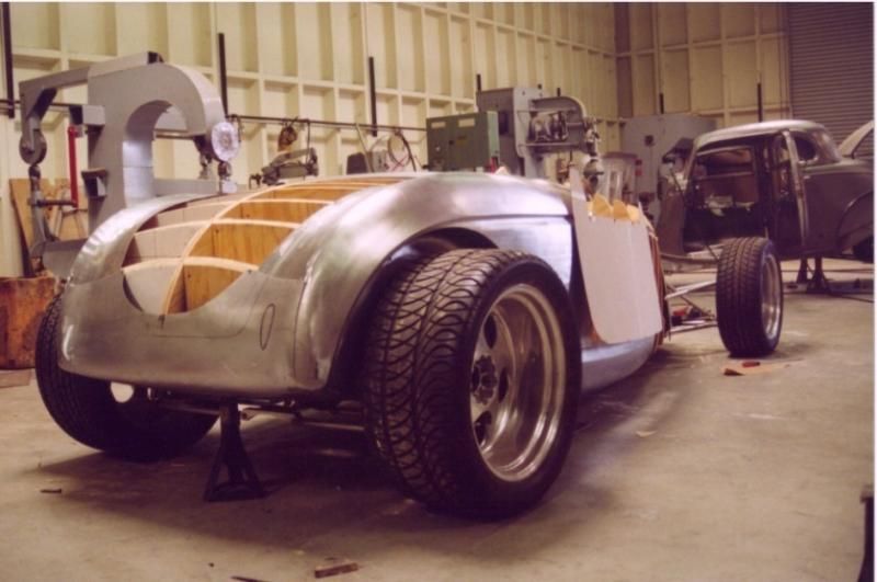

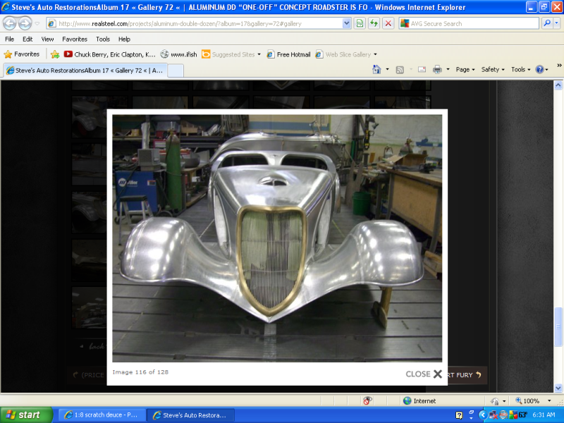

Posted 06 February 2015 - 07:49 AM
My inspiration for scratch built body panels.
About 1/4 of the way down the page are some excellent shots of his body buck & his brass panel work.
Also some good shots of his body build jig.
http://blog.hemmings...uilding-skills/

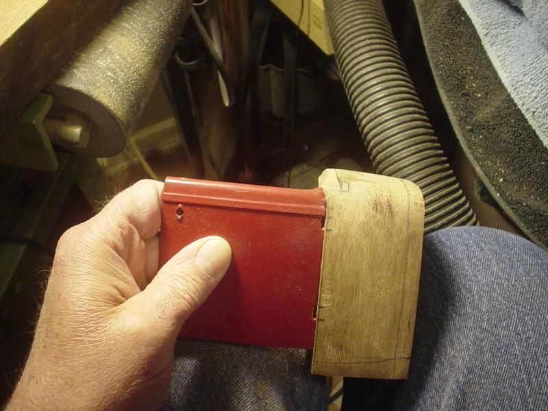

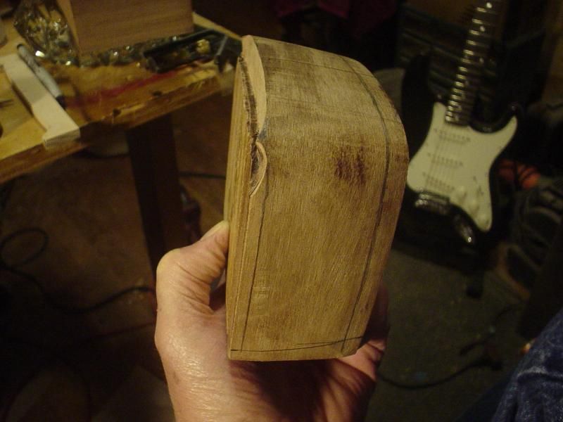

Posted 07 February 2015 - 10:31 AM
 Going to begin on the body buck by taking the area inside the feature lines on either side of the deck lid down 1/16", across the deck lid on to the lower body panel.
 I've already cut a line for the deck lid perimeter.
I'll continue to keep this line intact as I work, preserving the layout work previously done.
 Chisels & a round gouge will allow me to establish a definitive edge along the feature lines.
 I use pencil to provide a guide coat so I can see where I'm working.
 My collection of rifler files & rasps.

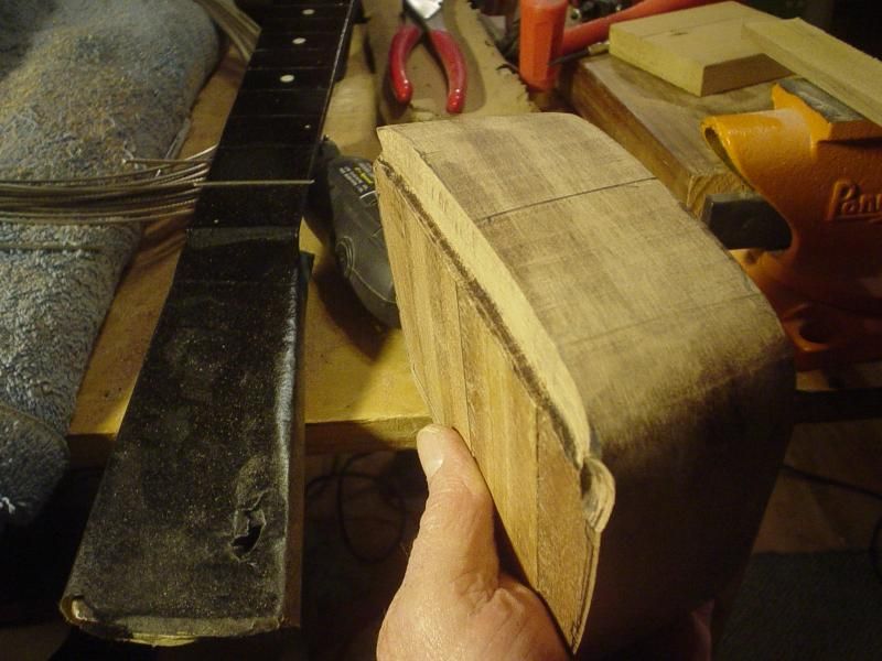

#258 Ognib
Ognib
  • PipPipPipPipPip
  • 441 posts

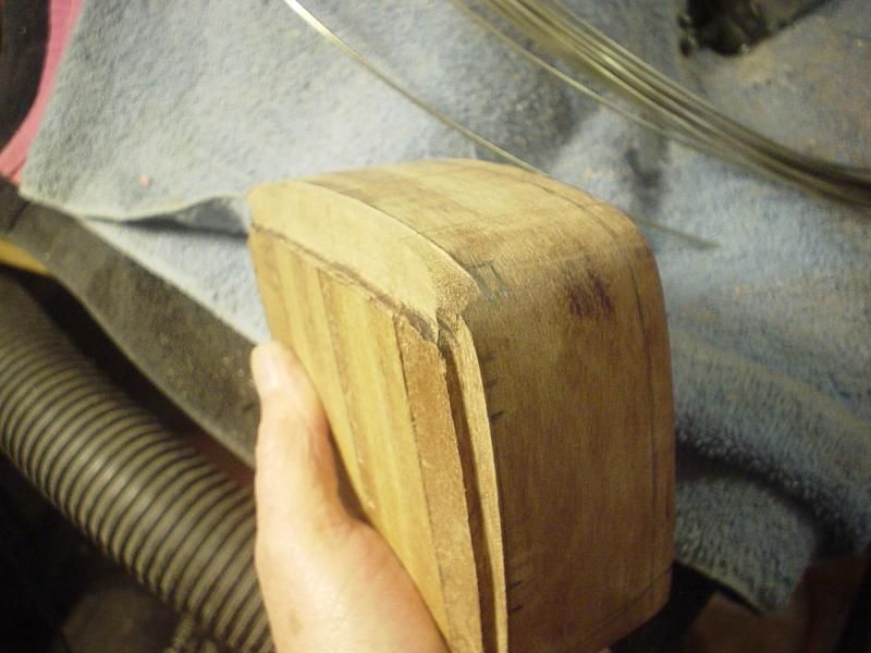

#259 Ognib
Ognib
  • PipPipPipPipPip
  • 441 posts
  • Location:kc,mo.

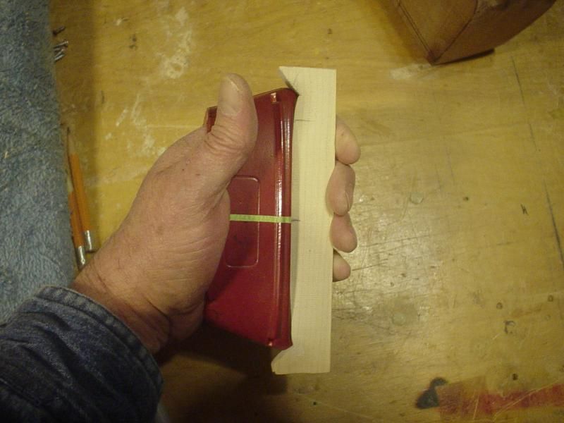

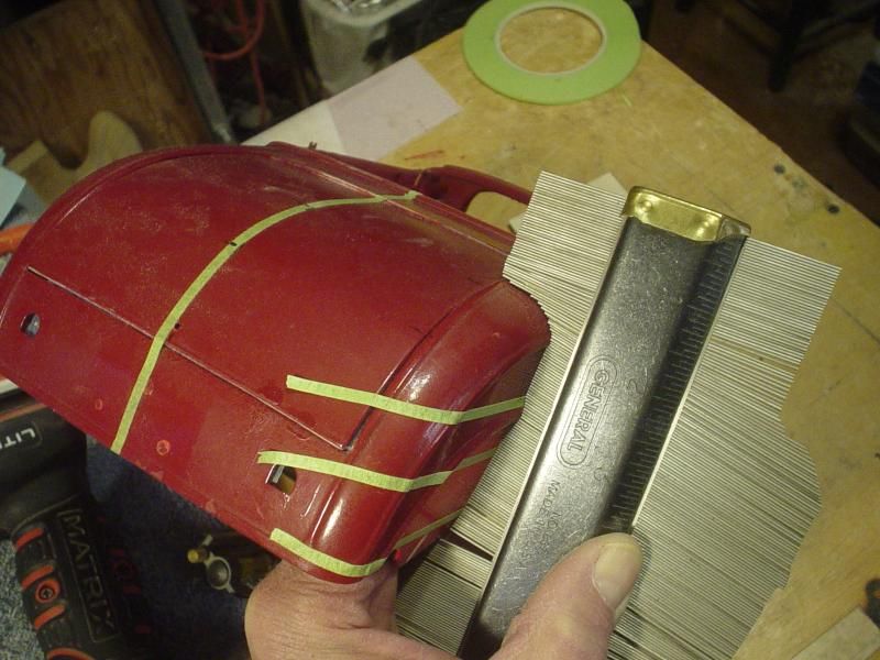

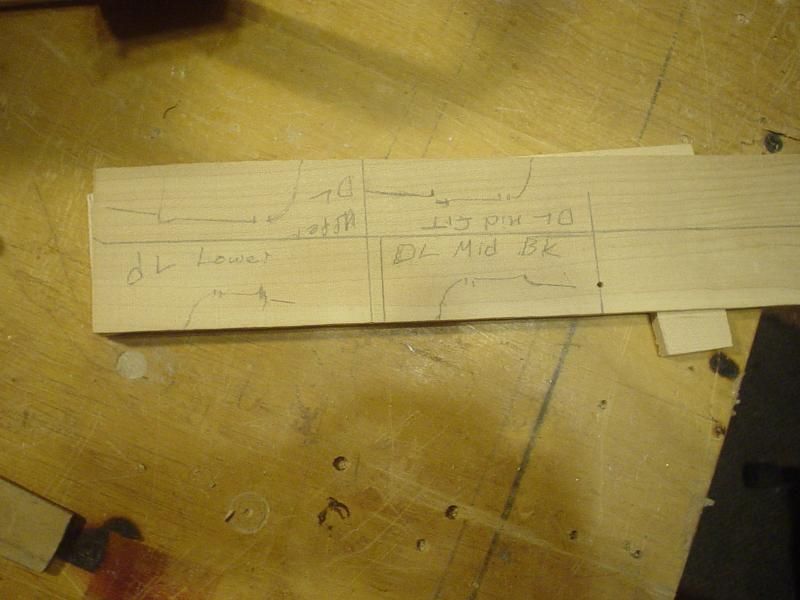

Posted 07 February 2015 - 03:49 PM
 The rim around the back of the cockpit is 1/8", with the outer feature line being about half that.
 Little at a time.
 Pulled a template off the upper body for crown radius.
 Get it established here, early on.
Edited by Ognib, 07 February 2015 - 03:50 PM.
