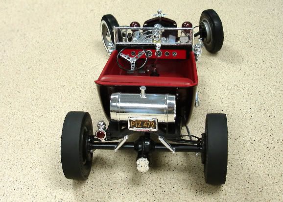

Much easier–and more predictable results–using a razor saw and miter box, as Ace pointed out. You can slice off extremely thin rings without distortion, then smooth the face of the rings with very fine sandpaper. I lay the sandpaper down on my work surface, lay the ring on the sandpaper, and then use a fingertip to slide the ring back and forth until it's perfectly smooth. Aluminum is soft; it doesn't take much time or pressure to get a perfect surface. They're kind of hard to see in this photo, but all the gauge bezels on this dash were made that way:
