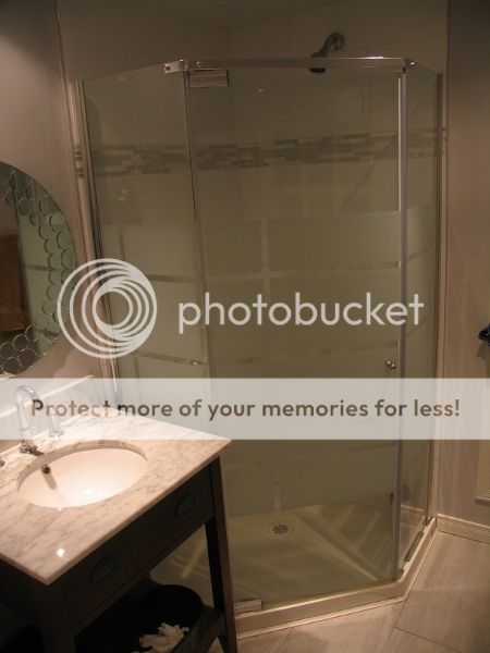

If your doing a bathroom reno...
Like this one I did for a client,..
this shower base comes with two 3' x 6' sheets of 1/16" thick white Styrene
which look cheap as shower walls,...
So set the base and tile the walls,...two free sheets of styrene !! and get paid while your doing it :lol:  :lol:  :lol:
I love doing these showers
