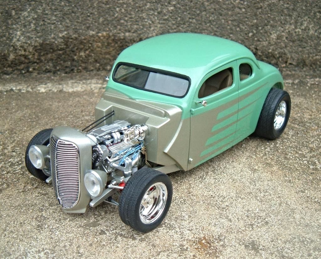

here's an example of some simple line that were done with a combination of tapes mentioned above in 1/4",1/8",1/16",1/32", and 1/64".
Wow, that is really cool, awesome job on that one
