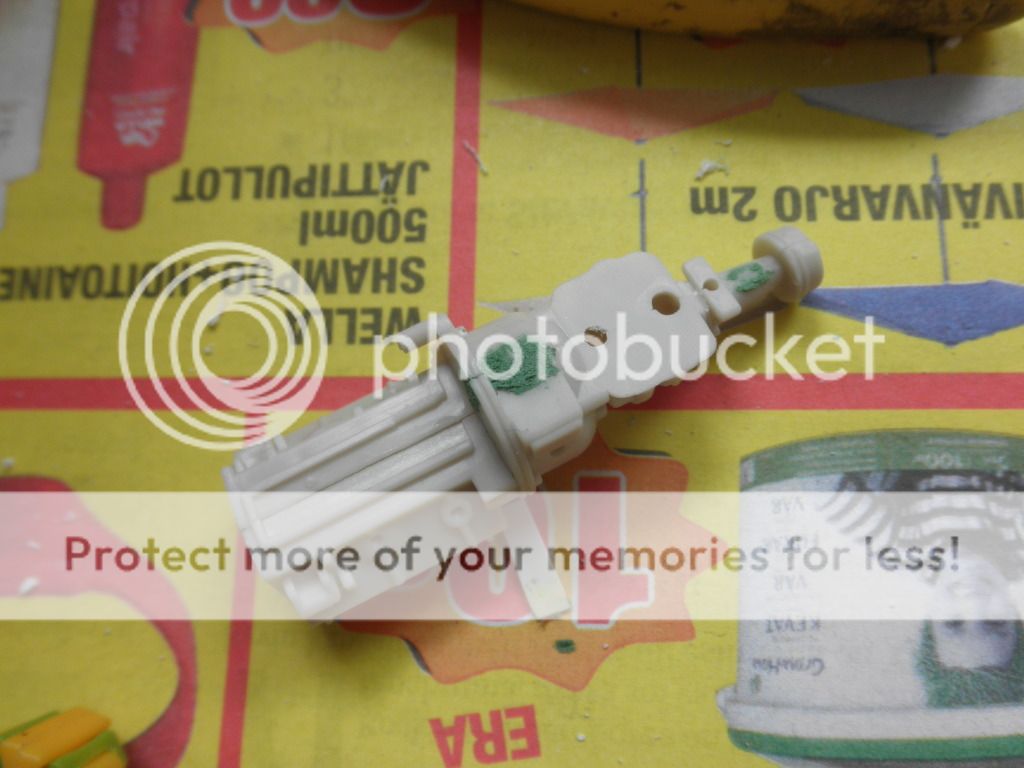

Well anyway, I started from the Engine. Those Engine Halves fitted really nicely together and only little putty was needed. Actually it would have been possible to do this job without putty, but I thought that was the easiest way to remove that seam. Also I removed those huge Mold Trashes or what they are called from Cylinder Heads and sanded the Engine block smooth where those heads will be attached.

Oh well, to the Build Progress... Here are the Engine Block Halves glued together and seams filled with putty. Waiting for sanding.

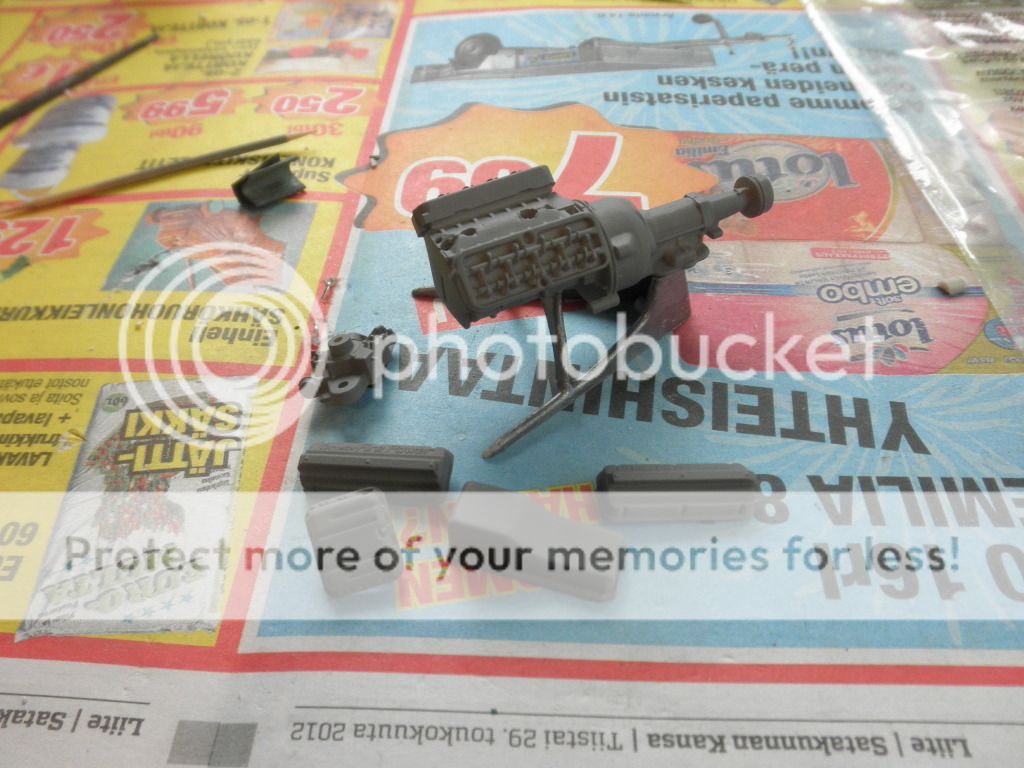

The Cylinder Heads Needed some Cleanup...
Much Better:
Then I sanded the Engine Block from that area, so the Heads will fit nicely.

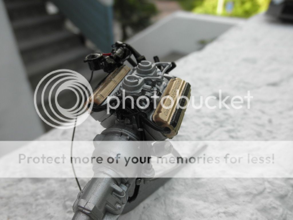

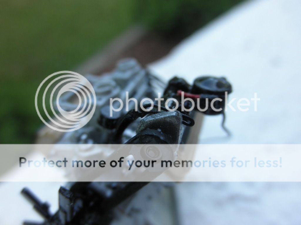

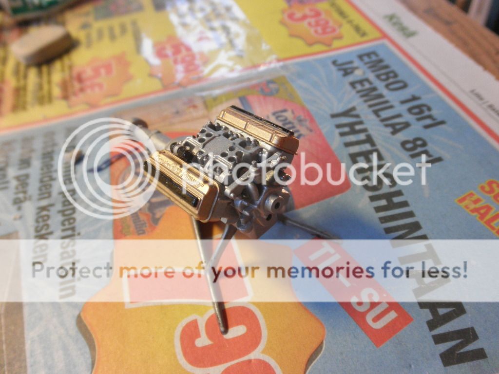

Now the engine is painted. I used Maston Silver from Spray Can and then Gold for the valve covers. I painted the black parts of the Covers by brush. Ingnition coil got some black paint on it, also. So far I have found no problems with the assembly.

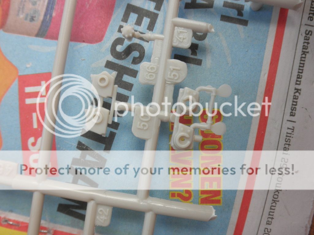

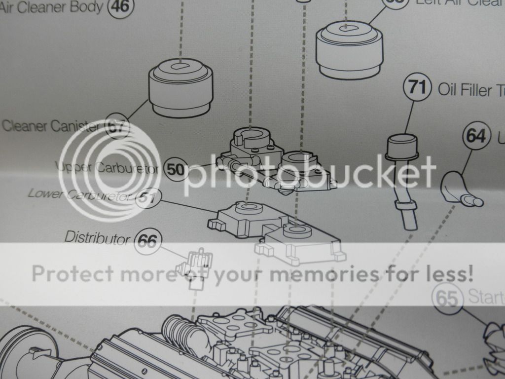

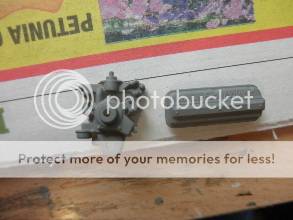

And when I decided to glue those Carburetor-parts together, I found out that (At least in my kit) the Instructions have a mistake. The Instructions show, that Lower Carburetor is number 51, and Upper 50 but actually they are just other way, so that 50 would be Lower Carburetor and 51 Upper Carburetor.

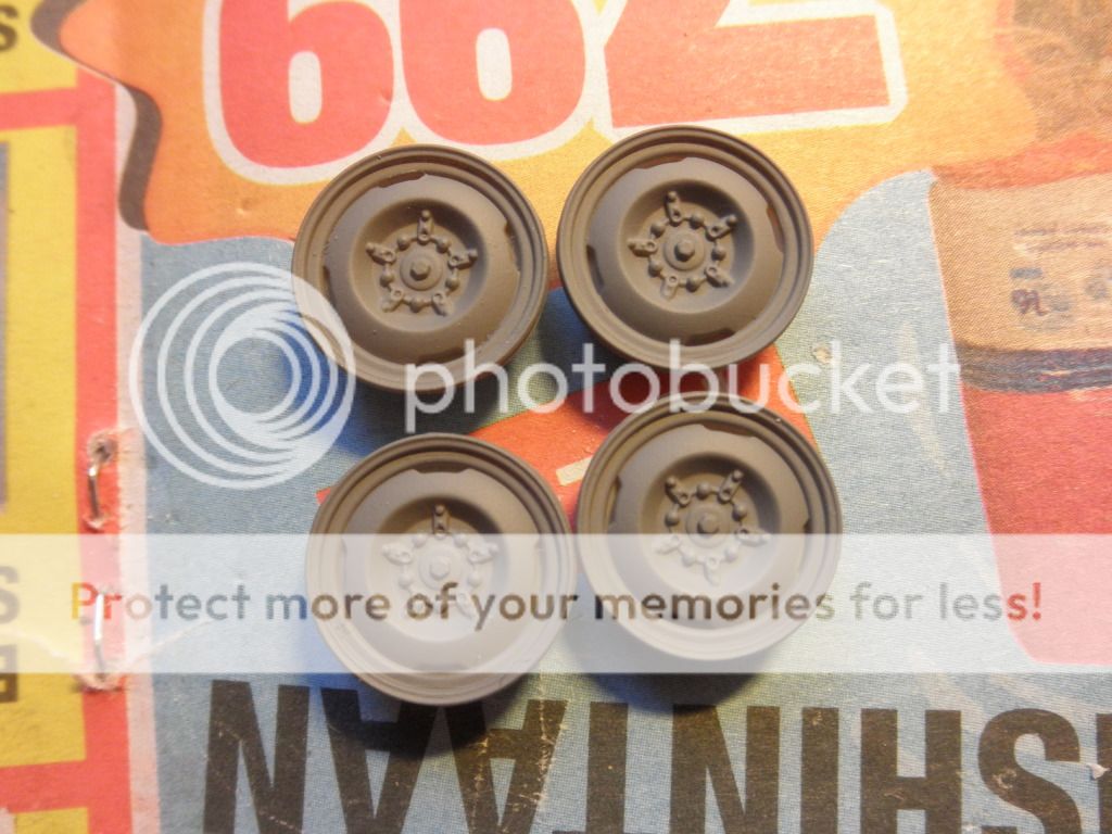

And then I primered the Wheels.

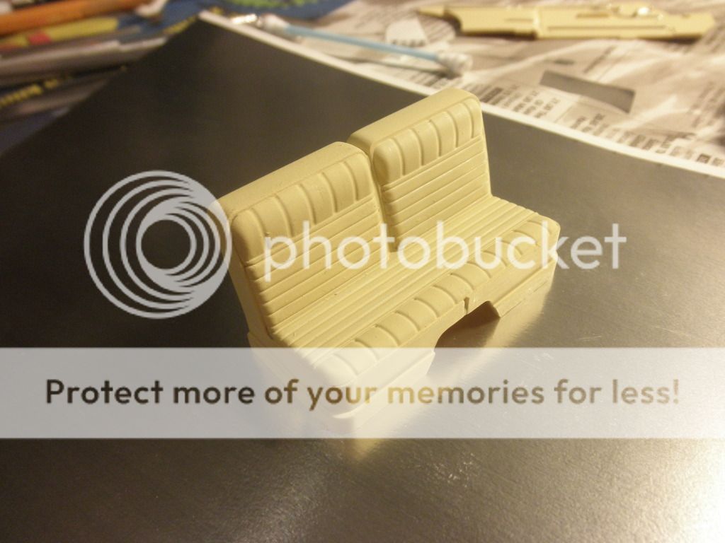

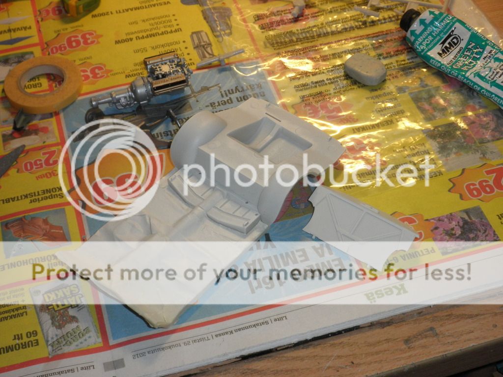

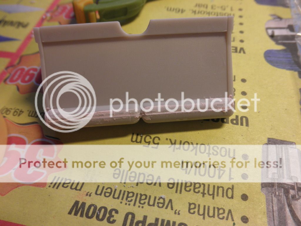

I glued the Bench Seat halves together, and then I started wondering that how much of the seam I need to fill with bondo. Many times there goes some kind of a seam on the Upholstery too, so I don't fill away something that doesn't need to be filled. And After some Google Searching, I came across this picture, and I could fill the correct part from that seam away.

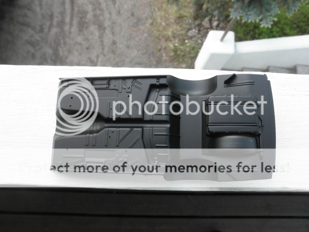

Then I masked the Carpet away from the interior, so I could paint the sheetmetal parts with primer, and then Gloss White. Once those were dry, I masked them and sprayed some Flat Black for the carpet and Flocked that area. A little paint came off from the other wheel well as you can see, but I fixed that later.
At the same time, I painted the underside of the same part Flat Black right after I had sanded the Molded In letters away.

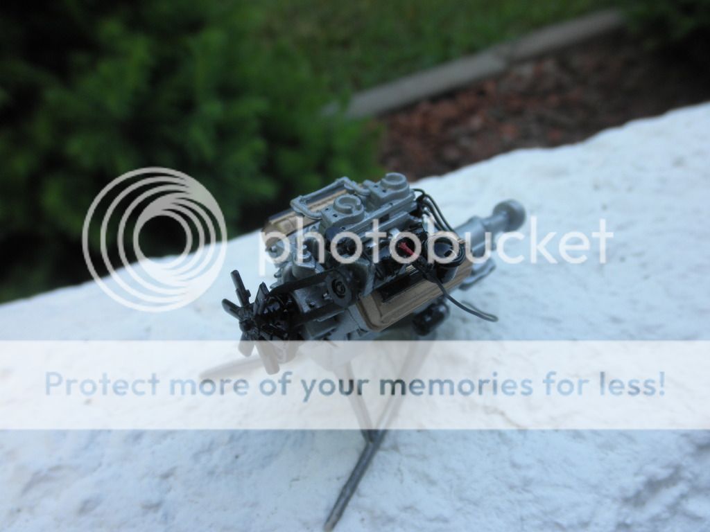

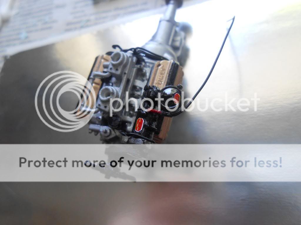

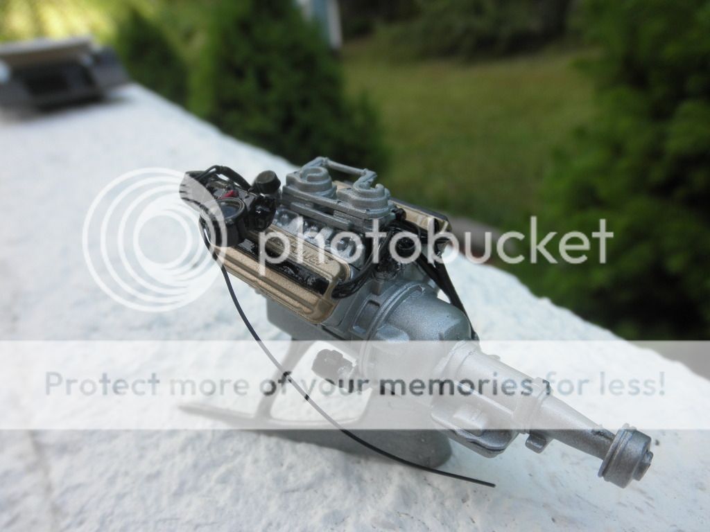

Engine is getting there. Still some little details are missing, but it's starting to look like an engine. I have found absolutely no fit issues, great job Moebius on this one! I have added the Spark Plug Wires and Generator wires for it. Oh and the Generator Bracket is scratchbuilt also.

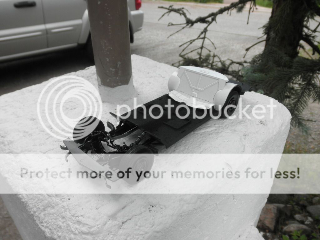

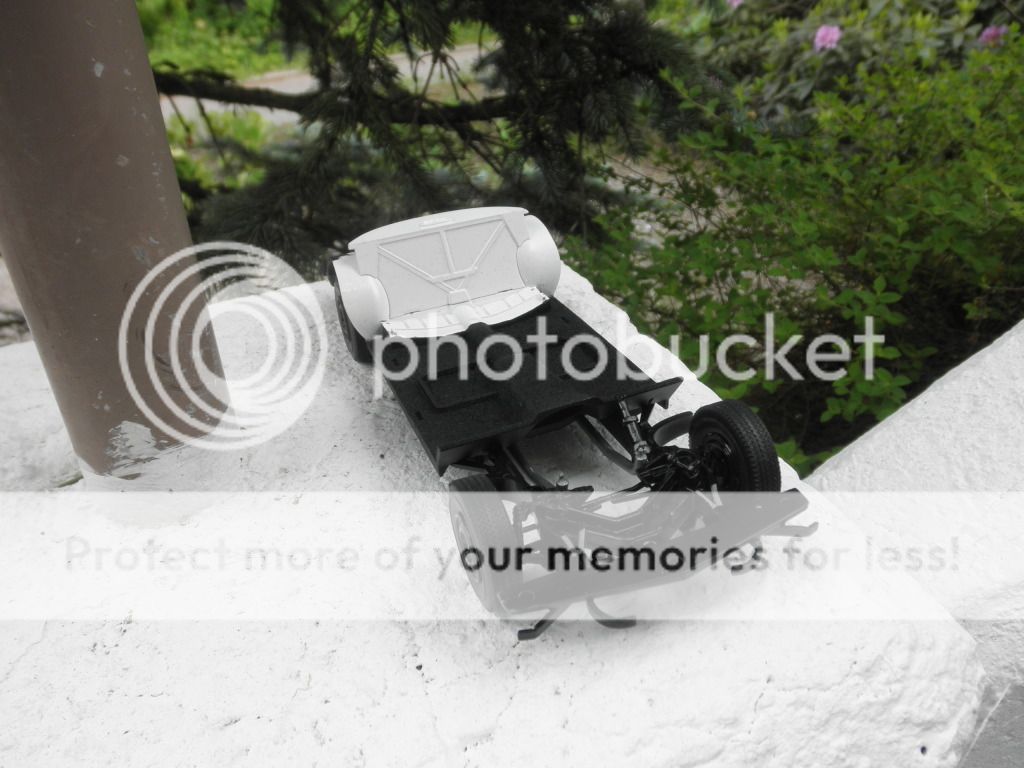

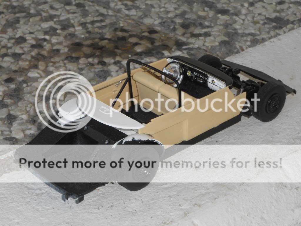

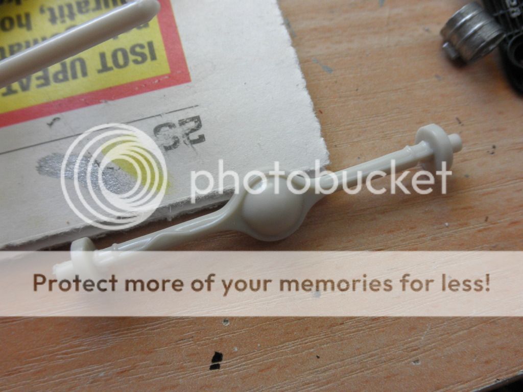

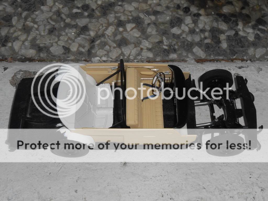

We are moving on to the Chassis! Kit's Rear Axle had Molded In brake line on it. I removed it and after I had painted the Axle, I made new one from Metal Wire. I don't have a picture of that, though, but it's there.

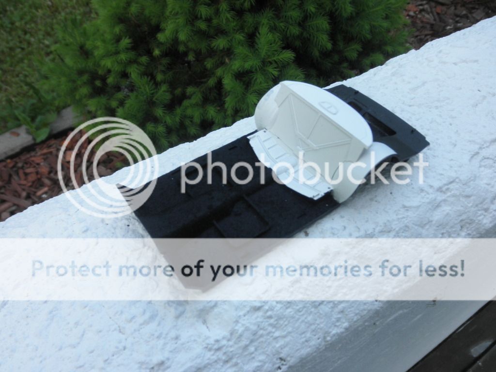

The whole chassis had only minor problems with the Front Axle installation, and I had to drill some holes bigger and do some other small things. Overall everything fit nicely together, and especially the Frame to floor pan was very easy to do. Also the wheels and tires fitted perfectly, no glue was needed and they went straight immediately.

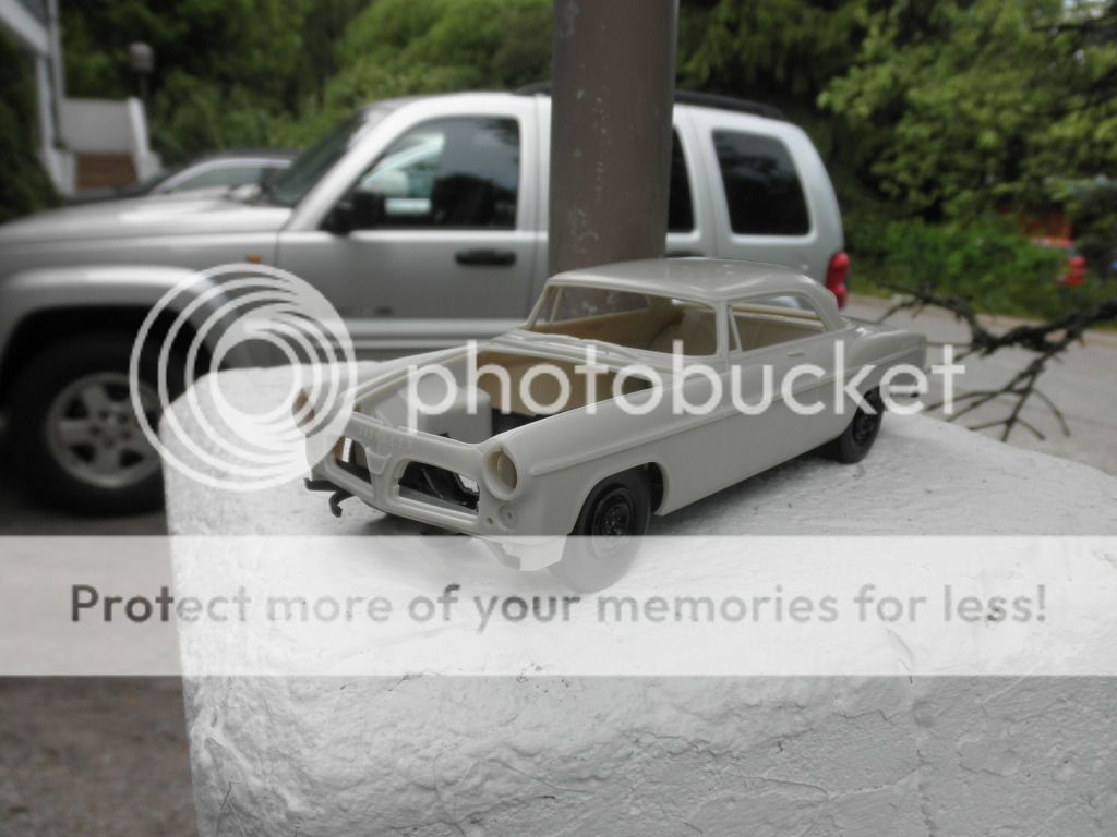

I had to test fit the Body too....
Two More.

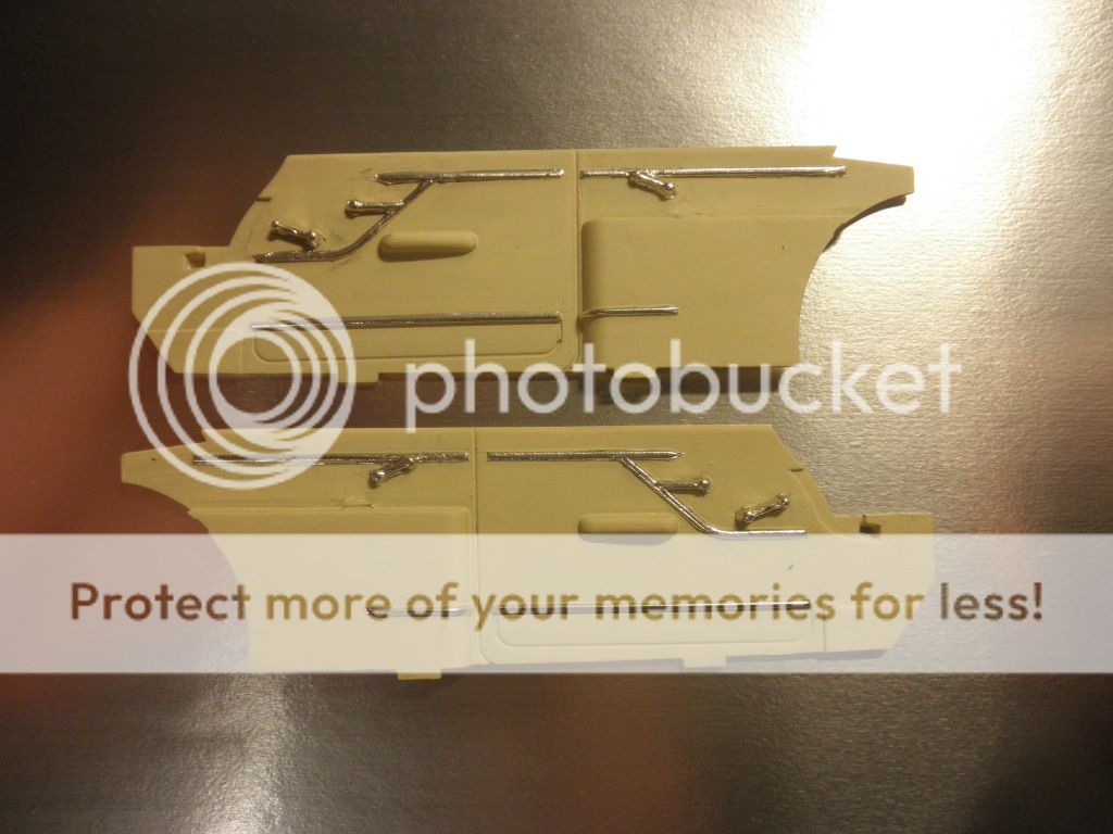

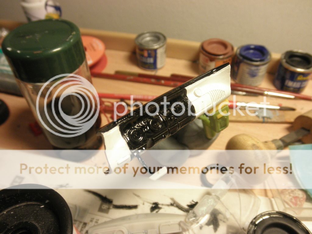

Then I moved to the Interior again. The Seat and Door Panels were painted by Humbroll's Radome Tan paint and then I Foiled the Door Panels... Somehow there came those black marks on the other panel, and I couldn't get them off. Well since I have already put the interior together, I can tell you that luckily they can't be seen well after it's all together.

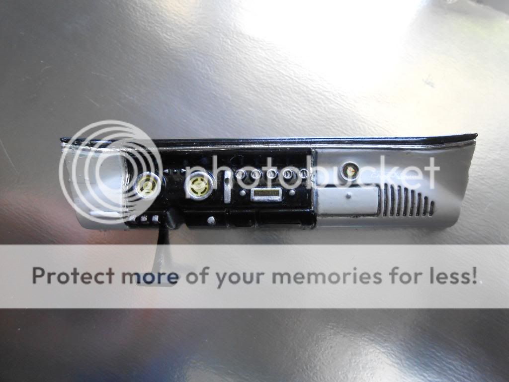

Then I painted the Dashboard. I used Black and White, as the Instructions show. Here I still need to paint some of the details and use BMF for the rest of them...

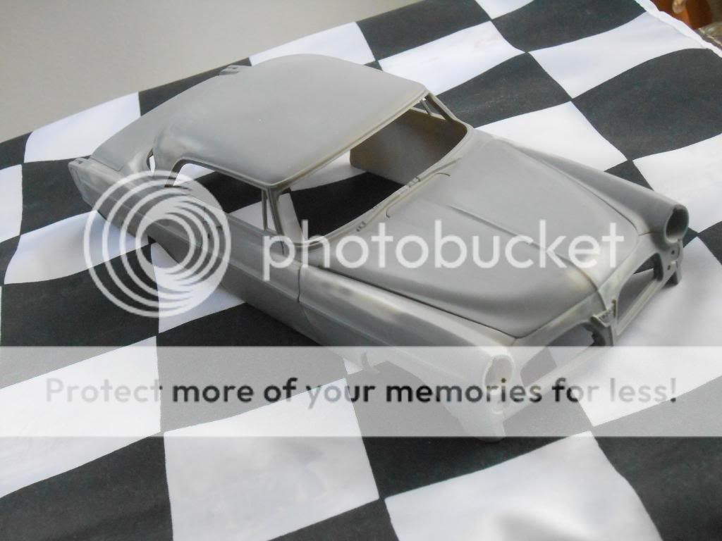

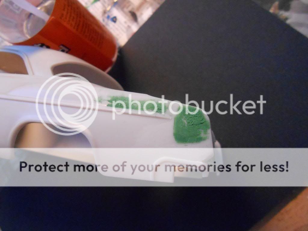

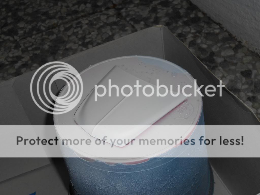

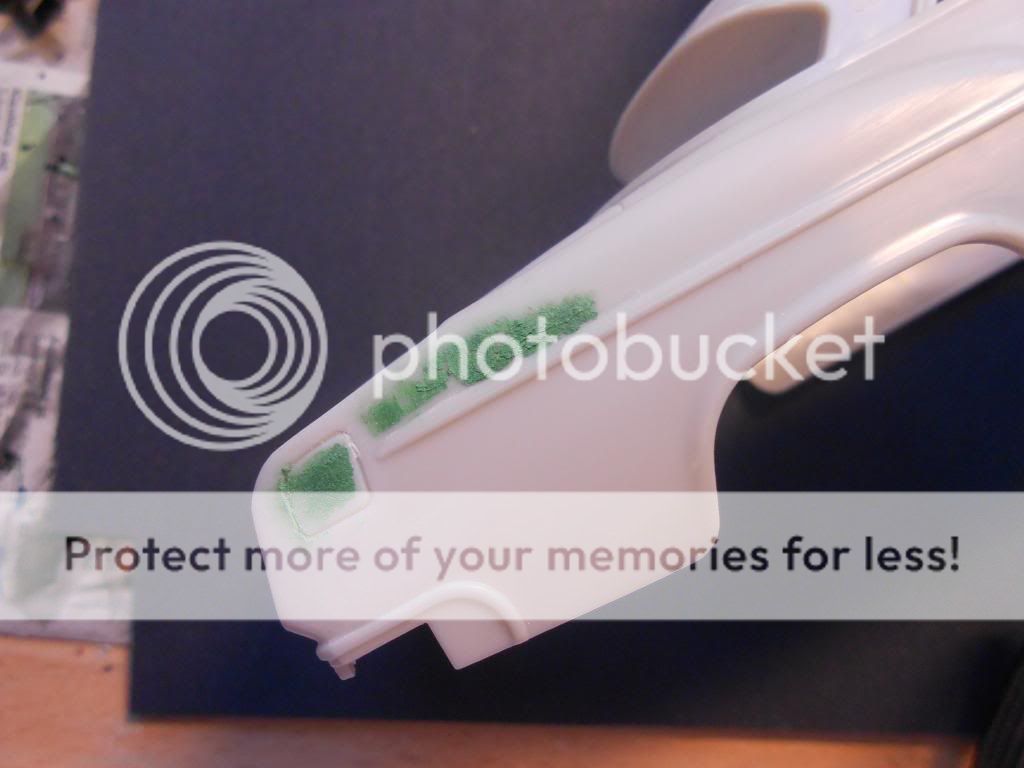

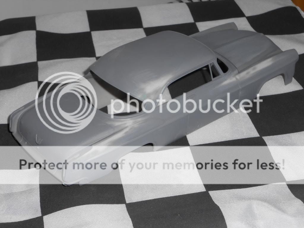

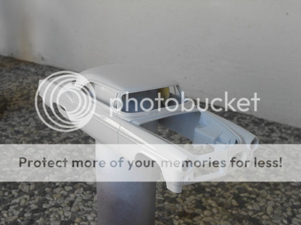

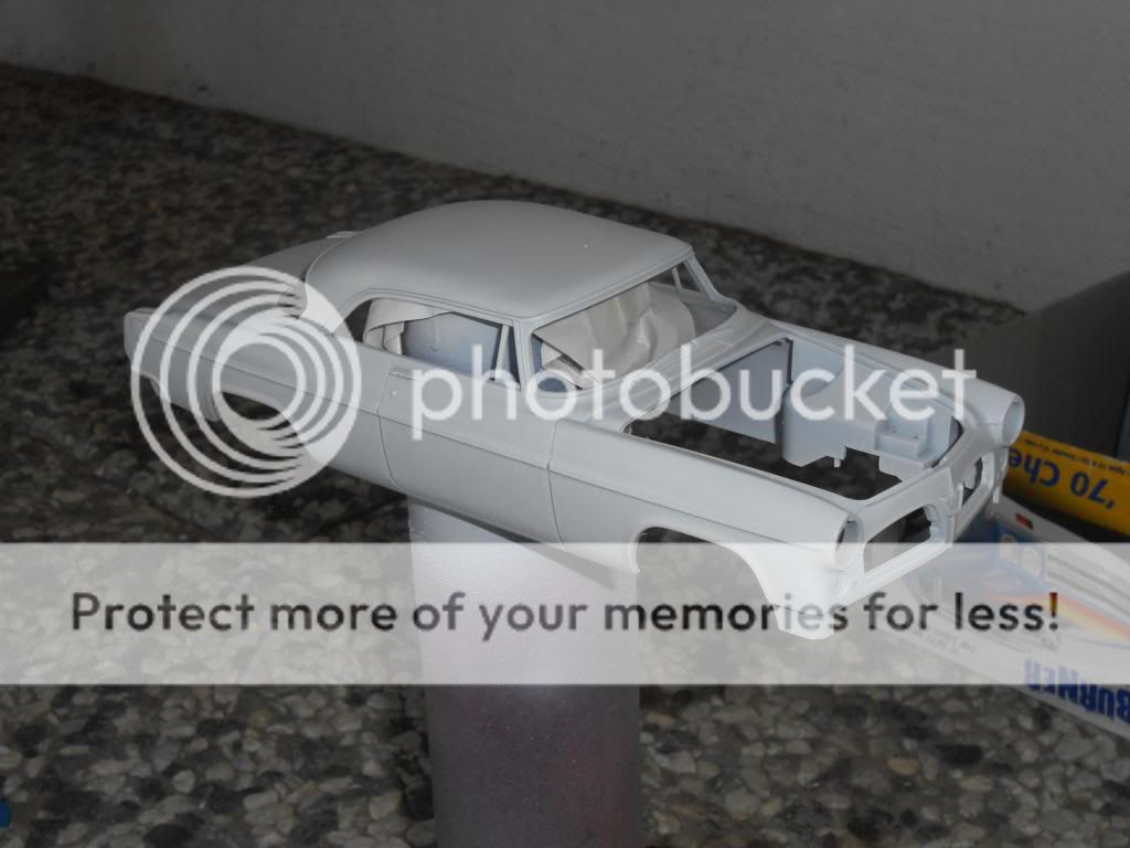

Okay next up was the bodywork. Looking on the decal sheet, I noticed Chrysler textes and pair of 300 Emblems there, so I decided to sand these letterings away from the body, to get the decals fit on those places better. I used some putty to smooth those places out. But the real pain was to get rid of the Mold Lines. Especially those what go on the side of that roof, were really hard to hide. A few times of putty didn't work, but luckily I managed to smooth them out with some bondo that's used on car bodies. Then I sprayed the final white primer over that grey primer.

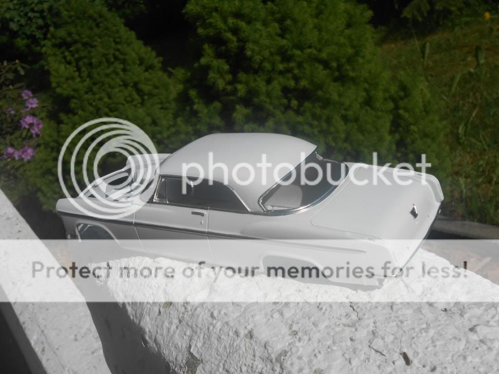

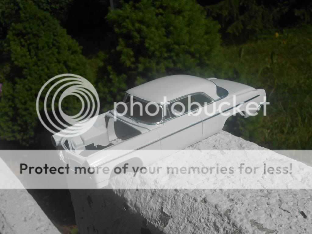

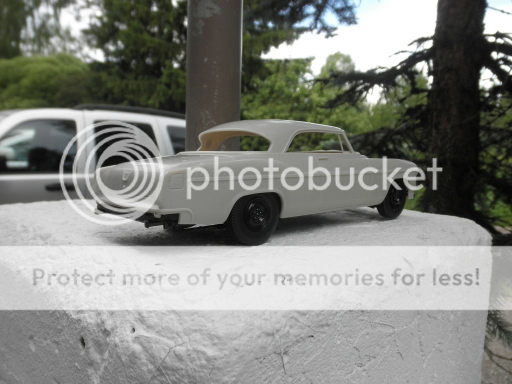

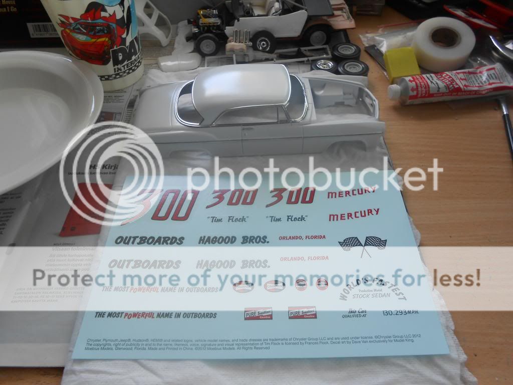

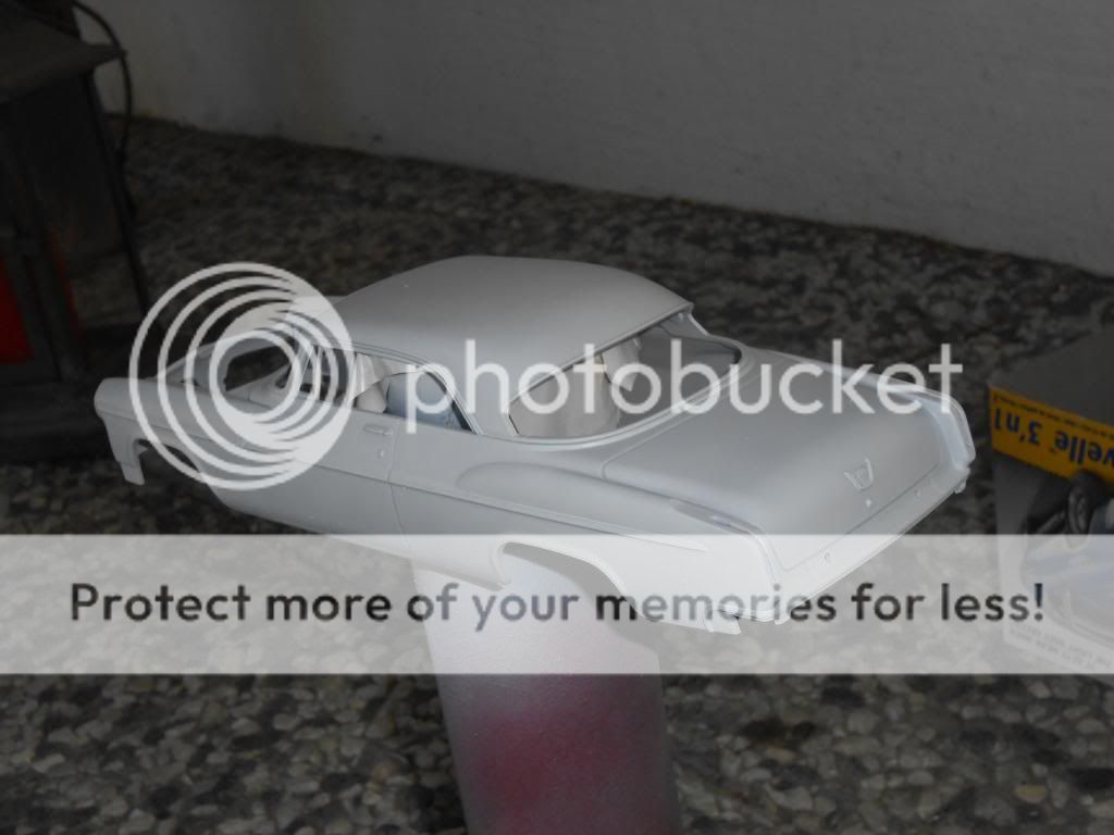

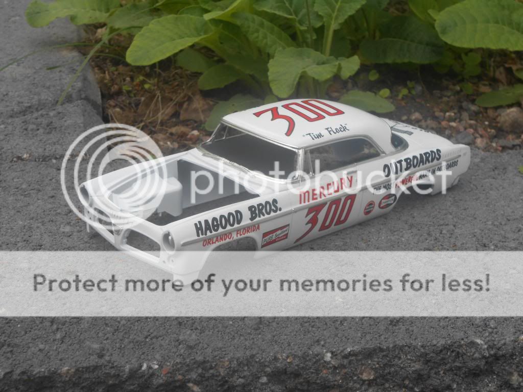

Then I sprayed the body with Maston White paint straight from the Spray Can. It turned out pretty good, and my plan was to do BMF and Decals both before clear coating. We'll see how that turns out in the future, I haven't cleared the body yet, but I have assembled BMF and decals....Pics of them coming later, though.
I also put BMF to the Dashboard that I had painted earlier. I also installed the kit decals on it, and they fit really nicely. Also I added some decals to the engine.

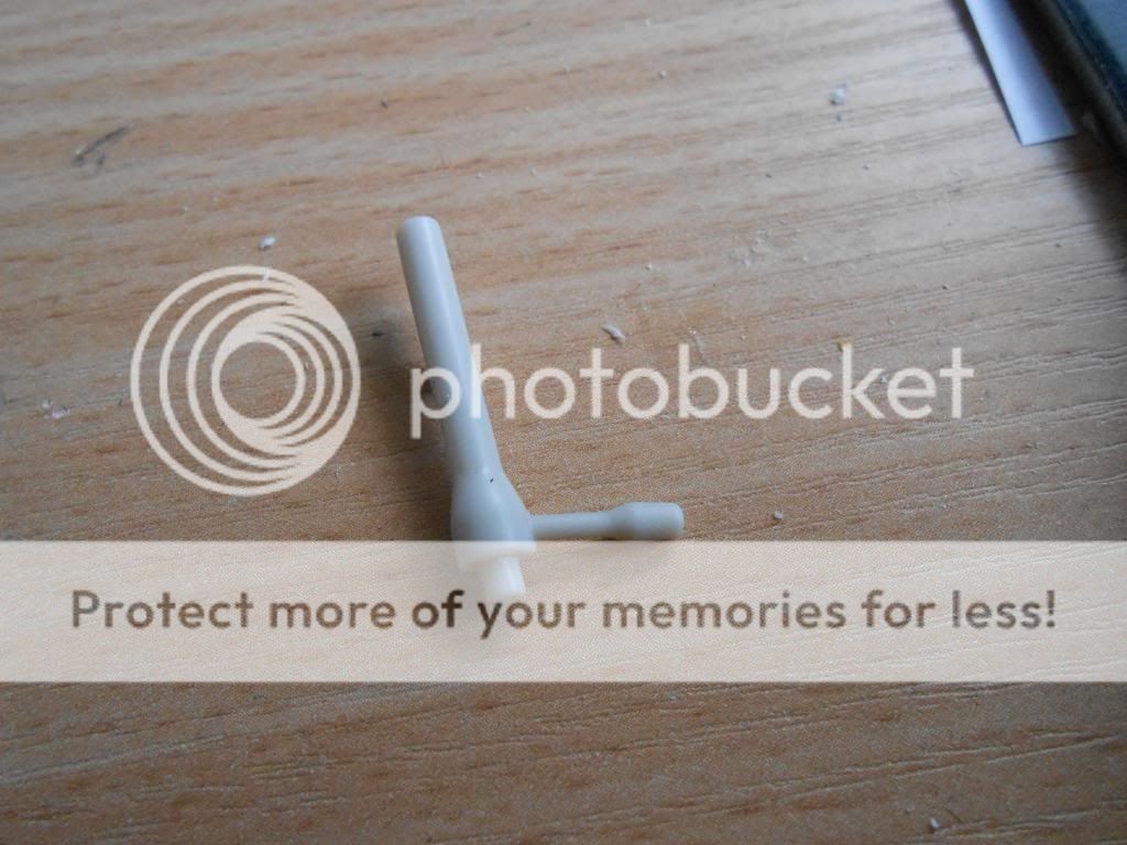

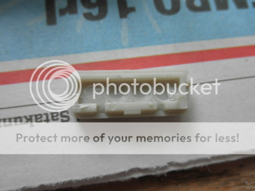

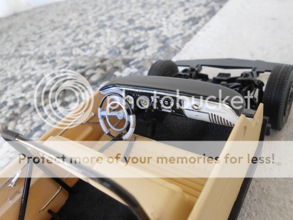

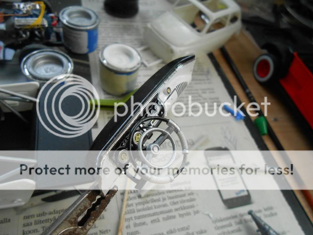

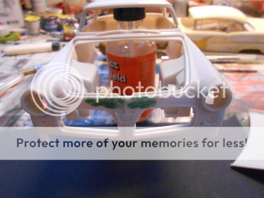

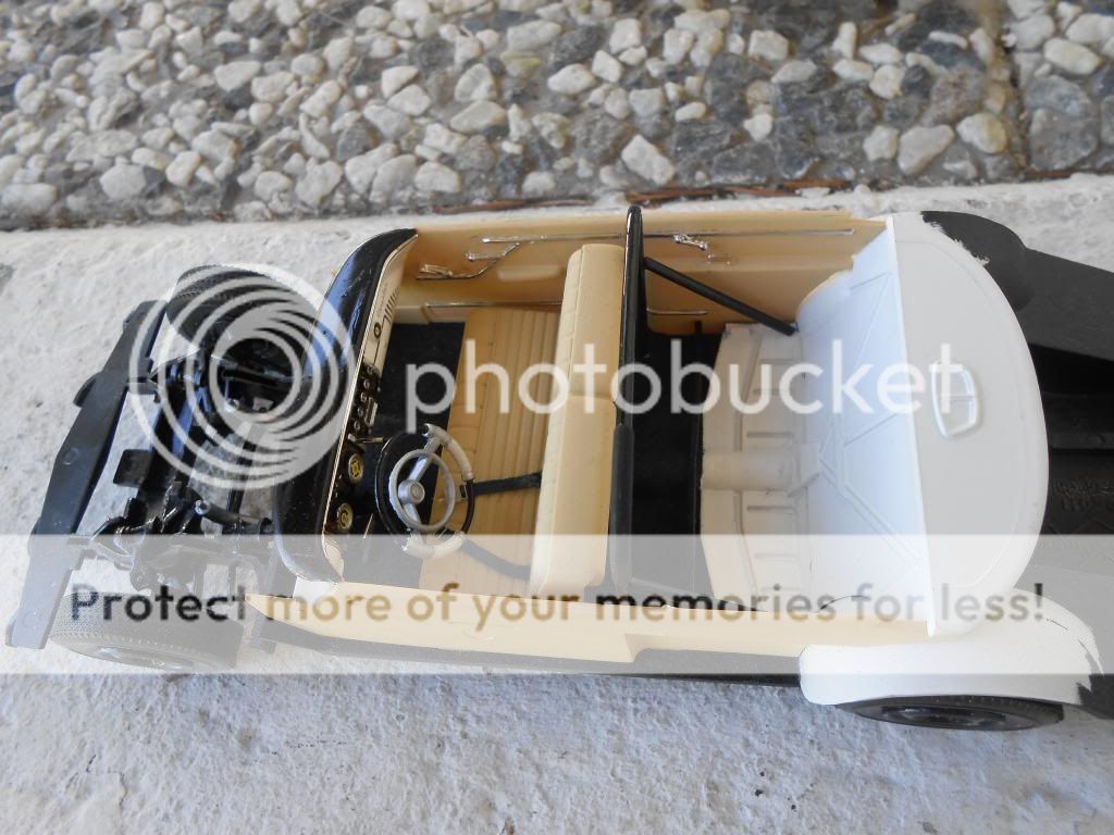

Interior work this time. First the Turn Signal visor caught my attention, and not as a positive thing. That looked way too thick, so I cut it off and then I drilled a little hole for new, thinner visor. That is made from metal wire, but I didn't find a good looking knob for the visor, so I just had to paint it black from the end. Though I believe that it looks better than the original did, and I'm quite happy about it.

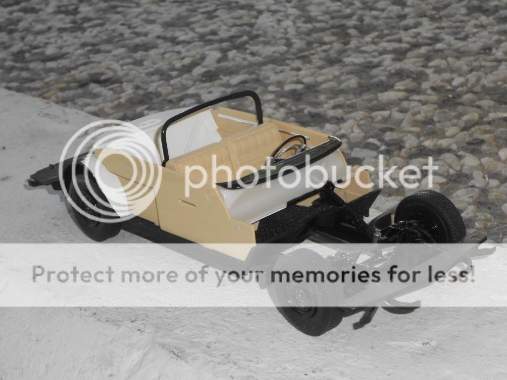

Then I painted the Steering wheel as the reference pictures showed. And since I had now all of the interior parts painted and ready to be installed, I decided to throw the whole interior together. It went together really nicely, without any problems. Next step is to do some more detailing on it and a few touchups. I will post another update very soon, since I have done some more work done on it already.

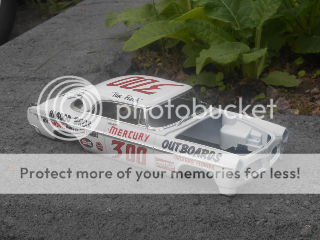

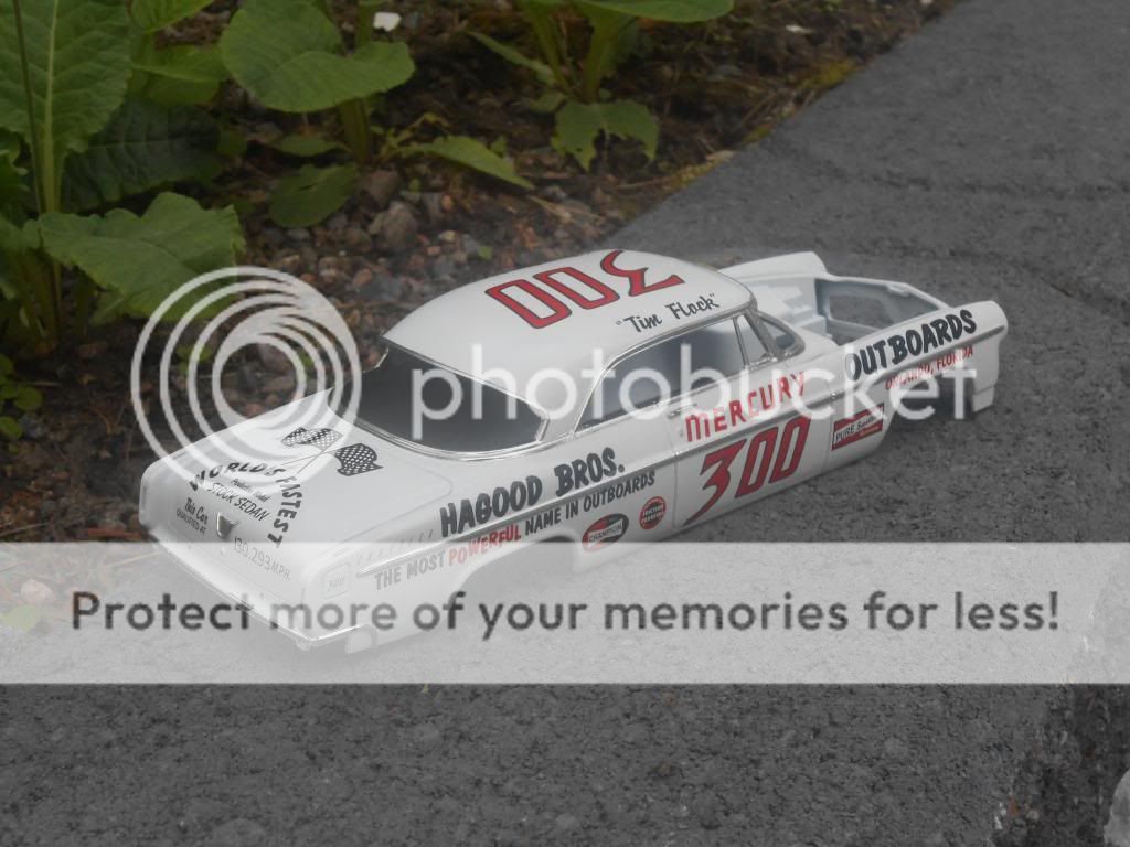

Thanks guys. Regarding to Tom's question, I have to say that I don't know. The reference that I've found is very minimal, so it's hard to say anything. That's why I'm keeping this pretty basic Box Stock Model with just some added details. B)

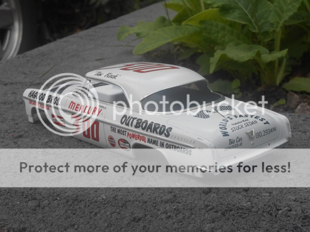

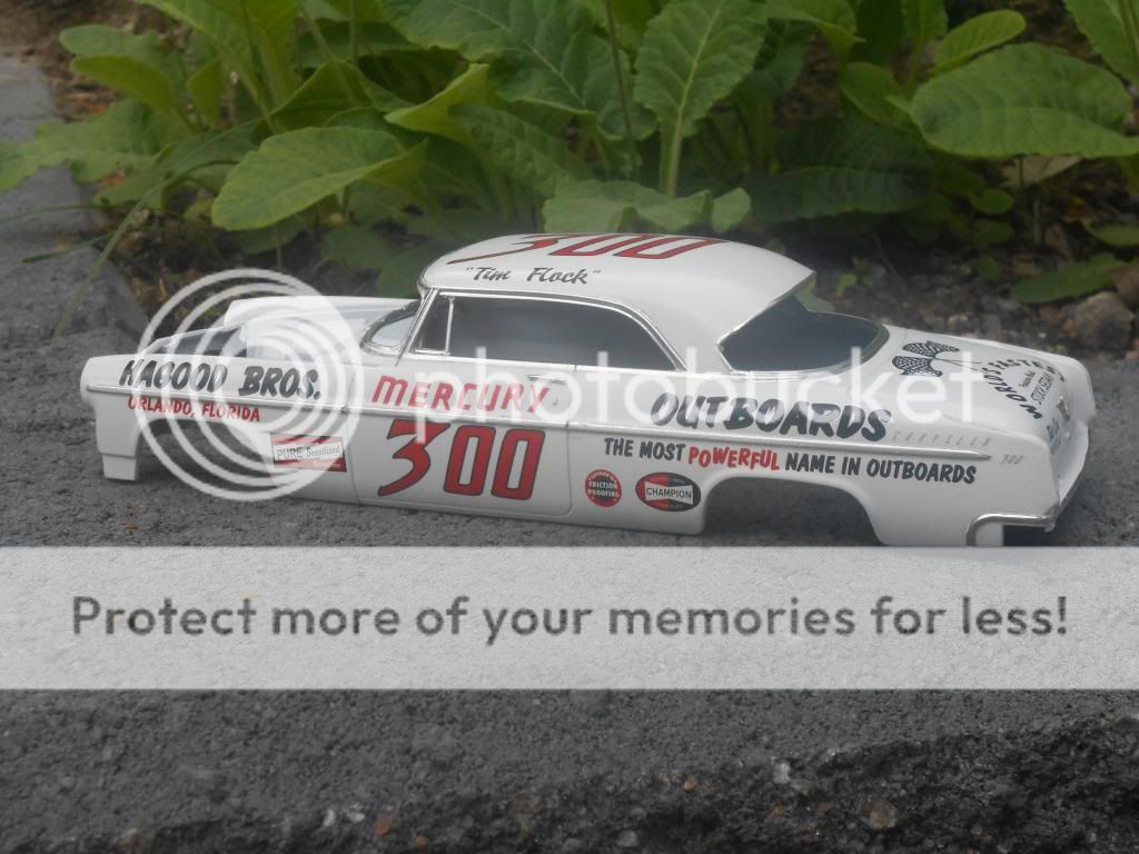

It was time to put BMF on the body. Man there are a lot of Chrome trims that need to be Foiled. But I think it turned out okay. After the Hudson and this, there is not much left of my BMF sheet. :rolleyes:
