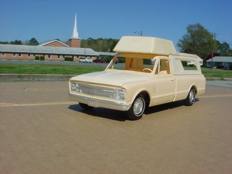

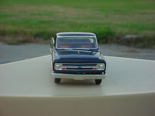

here are my 2.
Original;
and resin conversion;
Fit is not 100%, but will do the job quickly. and is easier than trying to scratch-fill that area!!
