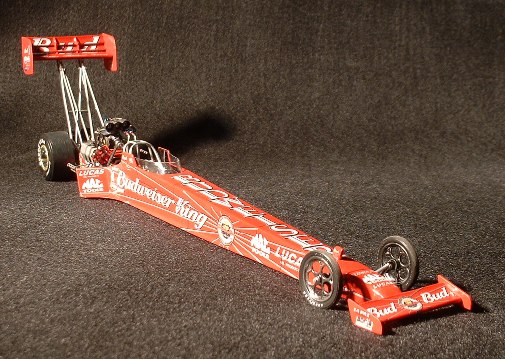

I want to build Melanie Troxels Top Fuel dragster she raced in 2006 from one of Revell's latest Top Fuel dragster kits.
I have the decal from Slixx, Competition Resin goodies, etc to complete the task. Also have a few reference photos from Sears Point (Infineon), but I'm lacking information where all the fuel lines and electrical wiring comes and goes.
Building one of these beasts requires attention to adding these componets...but again, I'm not looking for every little bitty wire that goes everywhere.
Hope to document as I start building, no guarantees though, cuz the camera and model bench never seem to communicate with each other.
