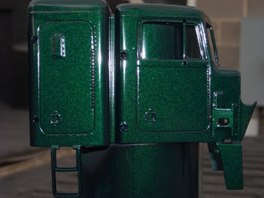

Kit Basher Posted December 20, 2012 Share Posted December 20, 2012 Joe, I don't think you have to use any undercoat, but the color under it does make some difference. Here it is over black primer. It's actually darker than this pic shows. As you can see, it's metallic on its own, but you can make it darker or lighter by what's under it. Hope that helps. Quote Link to comment Share on other sites More sharing options...
