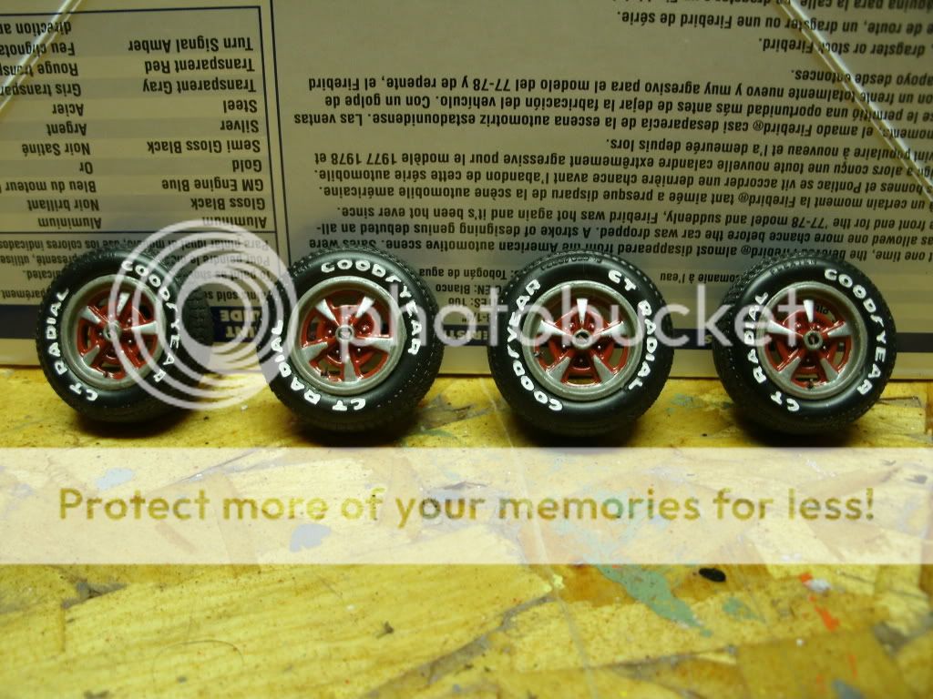

Nick Winter Posted April 22, 2012 Author Share Posted April 22, 2012 (edited) Well, here's my update on the wheels & tires being done. I actually like them a lot more as Painted Rallye II's. Nick Edited April 22, 2012 by Nick Winter Quote Link to comment Share on other sites More sharing options...
CorvairJim Posted April 22, 2012 Share Posted April 22, 2012 You're right about the Rally II's. Pontiac never chromed them, so I can't figure out why the model companies always do. Even the factory trim rings (when ordered - they didn't always have them!) had a brushed aluminum finish, not bright chrome. I recently had to strip and paint a set for a '77 Firebird Esprit replica that I built on commission. They look a whole lot better painted than they do chromed, whether stock charcoal gray or body color like you painted yours. Nice job! Quote Link to comment Share on other sites More sharing options...
Nick Winter Posted April 22, 2012 Author Share Posted April 22, 2012 Thanks Jim, I had them the Charcol color but they just weren't doing it for me. Quote Link to comment Share on other sites More sharing options...

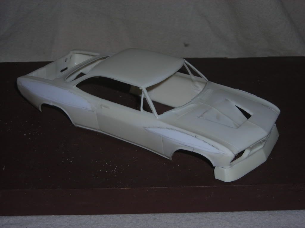

CorvairJim Posted April 30, 2012 Share Posted April 30, 2012 I FINALLY got cracking on my mid-engined V-8 Corvair. I'll warn you guys now: I'm planning Corvette ZR-1 power for this bad boy! Starting with a body from the "Prestige" release of the AMT 1969 Corvair Monza coupe kit, I removed the Monza emblems to clean it up a little and the side marker lights to backdate the body to a 1966 model. I used masking tape to show me where to scribe the cuts for the radiator air outlet, using the back of an X-Acto blade (I used this older body because it's molded in a harder plastic than the more recent one from about 2006. That one is in the newer AMT gray plastic that I find more difficult to do bodywork on): Now that the outlet is cut in and bent down, I've taped out the cutline for scribing the horizontal cut for widening the fenders. I warped the plastic in the outlet by using too much heat when bending it down, but it isn't so bad that I can't putty it back into shape. Once that's done, I'll install the sides of the outlet: I scribed the horizontal line with the back of an X-Acto blade, then cut vertically from the center of the wheel arches to meet the horizontal cut with a razor saw. Then I carefully bent the plastic out to the new shape I wanted. First I bent it outward from the ends, then back in at the wheel arches. That left a small gap in the middle, but that will be easy to patch up later on: Here I show the filler pieces that go at the top of the horizontal cuts. These are basically just to give the fenders form; they won't be visible in the final build: Here the filler pieces are installed and sanded down to conform to the new shape I want for the sides of the car: More filler pieces. These will go between the fillers that I put on in the last step and the tops of the fenders. they are curved top and bottom and chamfered from behind to be mounted at the correct angle to blend in with the body: This makes what I was describing above a little more clear. I didn't want a flared fender look for this one; I thought a widened fender look would fit the lines of the Corvair body better: And finally, I cut off the front pan to mount a custom spoiler, made from a section of the custom nosepiece from the kit. It will eventually have an air intake in the center and covered driving lights beneath the stock headlight location. Those headlights will have flush covers too. Finally, the spoiler will have a aero splitter at the bottom to keep as much air as possible from going under the car and direct it through the radiator. Also, the car will have a full belly pan, and I'm even thinking about building in a ground effect tunnel in back! Quote Link to comment Share on other sites More sharing options...

CorvairJim Posted May 1, 2012 Share Posted May 1, 2012 About 6 hours down and a hundred to go! You know how it is. It doesn't take all that loing to rough the mods in; The time goes into making it all blend together seamlessly. Now add in the time it's going to take to build the chassis to accept the mid-mounted Corvette engine and front suspension, finish the "Trunk" with the whompin' huge fuel cell, re-do the interior so that it will be comfortable at that sort of speed for that long, modifying the dash for the extra gauges, CB radio, GPS, and radar/laser detector. I'm going all-out to build this for the theme: To me, it has to be a car fully capable of not only winning this race but setting the coast-to-coast record in the process. My goal is one day FLAT! A 140 mph average should do it... (I'm still considering chopping the top and laying the windshield back some for extra aerodynamics!) Quote Link to comment Share on other sites More sharing options...

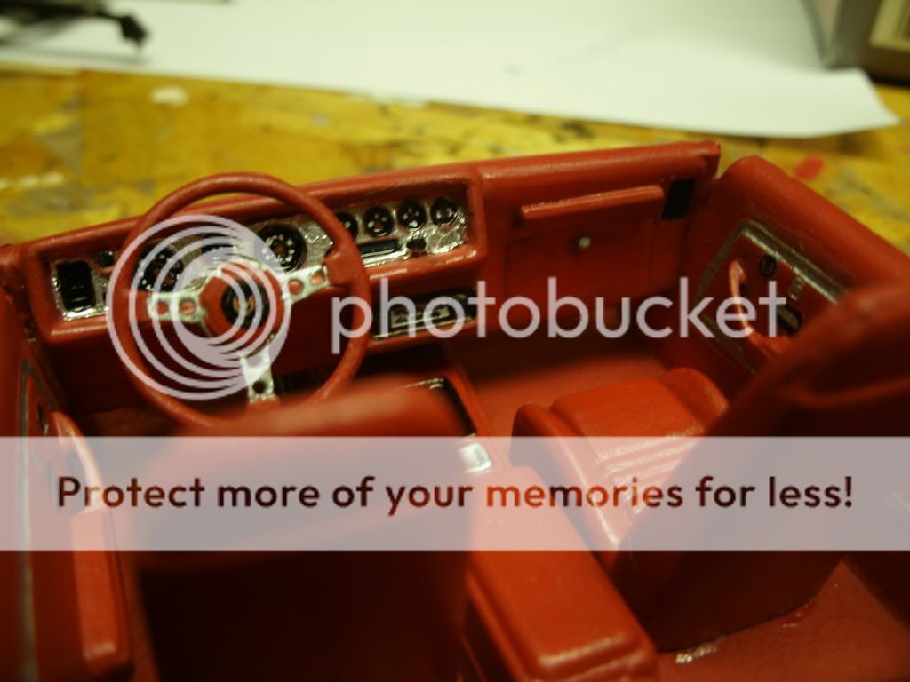

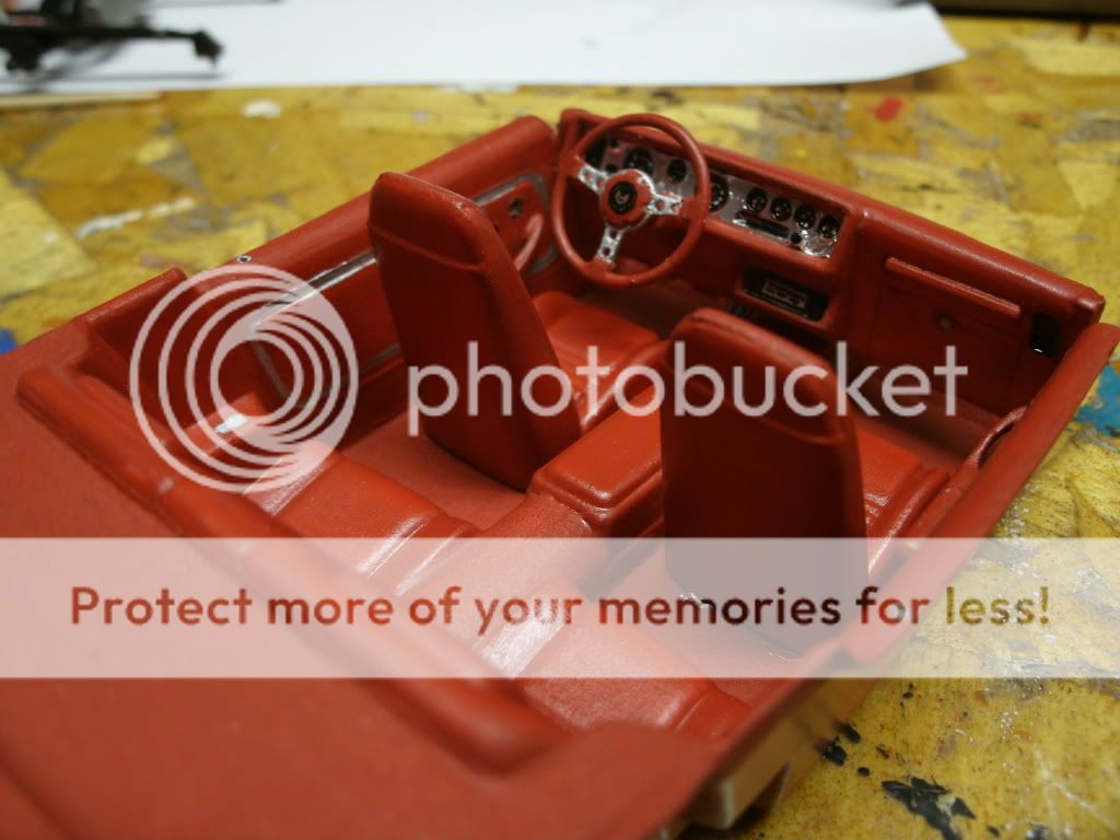

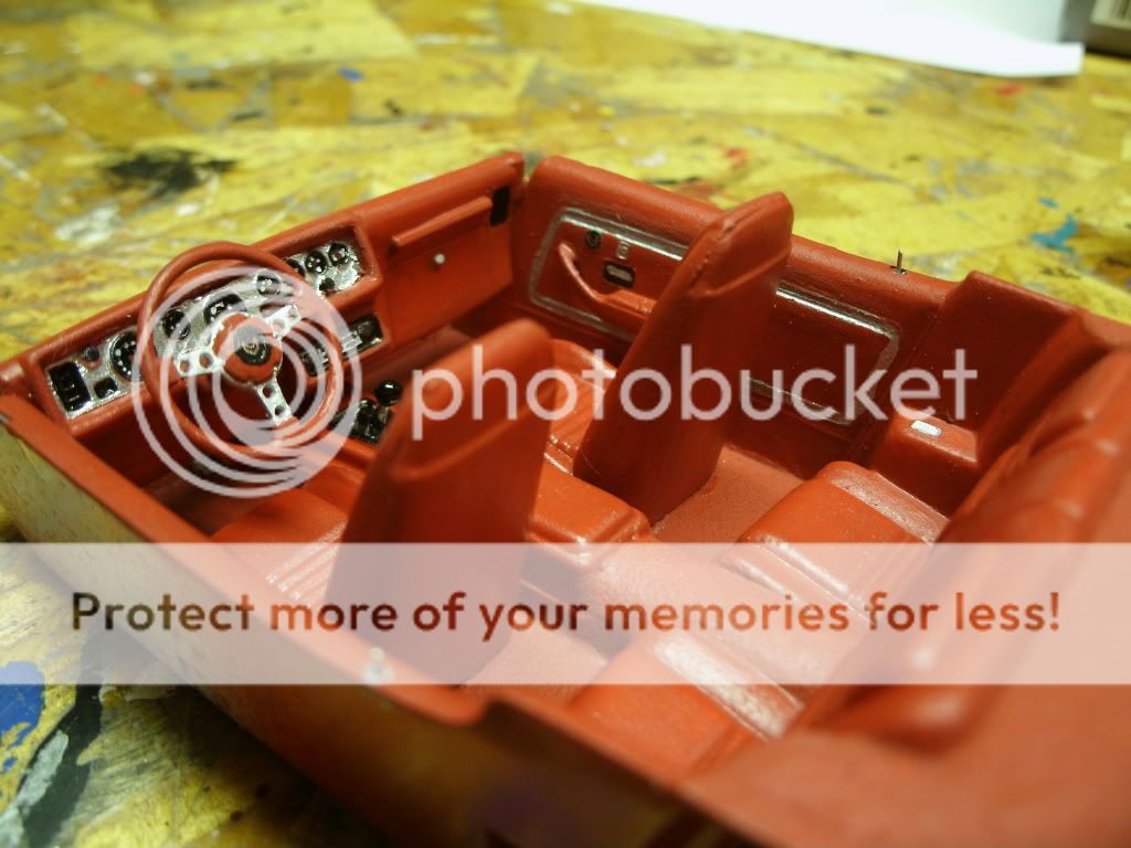

Nick Winter Posted May 8, 2012 Author Share Posted May 8, 2012 Finished interior. Quote Link to comment Share on other sites More sharing options...

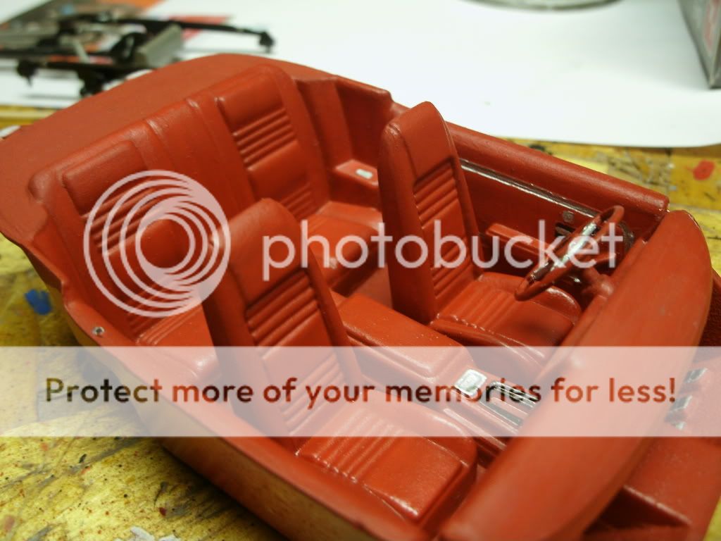

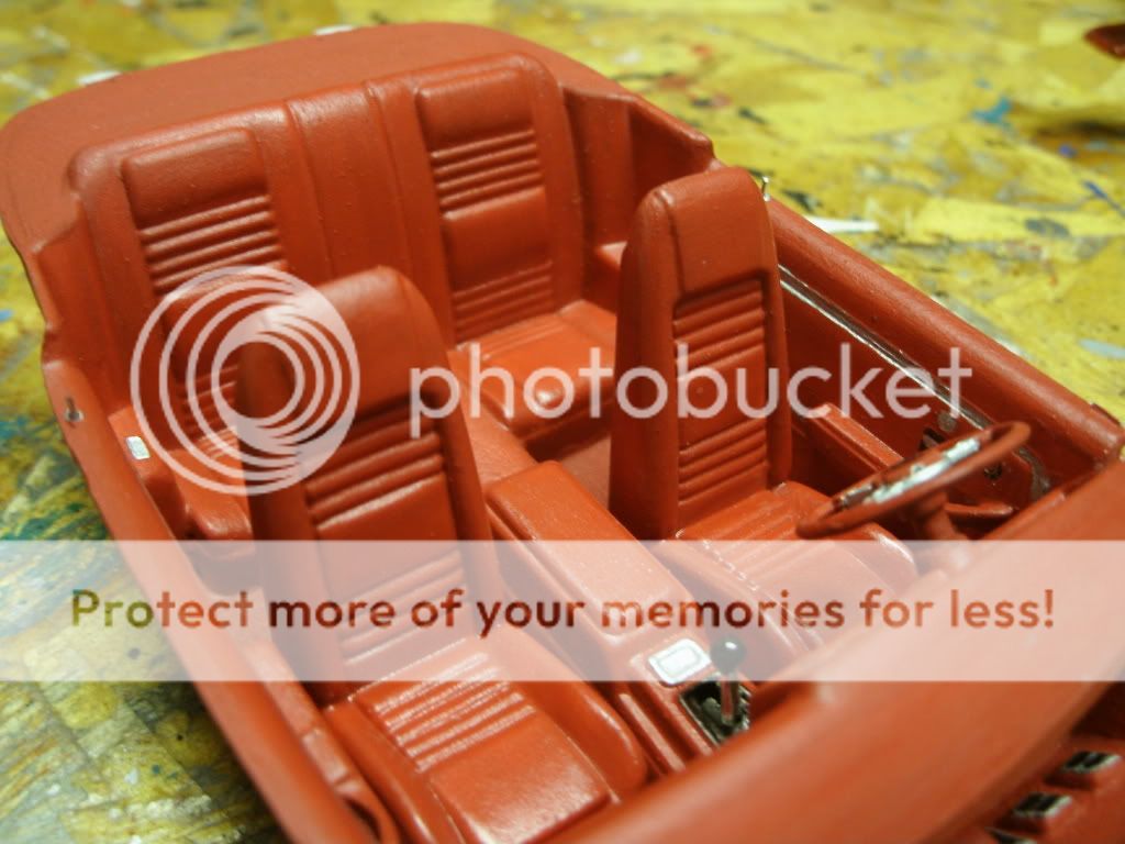

ChevyCoupe41 Posted May 12, 2012 Share Posted May 12, 2012 Nick, your Firebird looks very Good! Its been a long time since i put any updates here but Rambler is getting closer and closer to get finished. Only things what i had to do is paint hood,put ignition coil and lots of small details on it. Here's some progress pics and couple of pics whats is going now. Finished interior And what is going now. Quote Link to comment Share on other sites More sharing options...

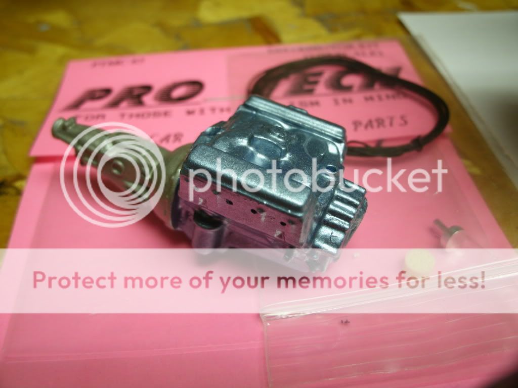

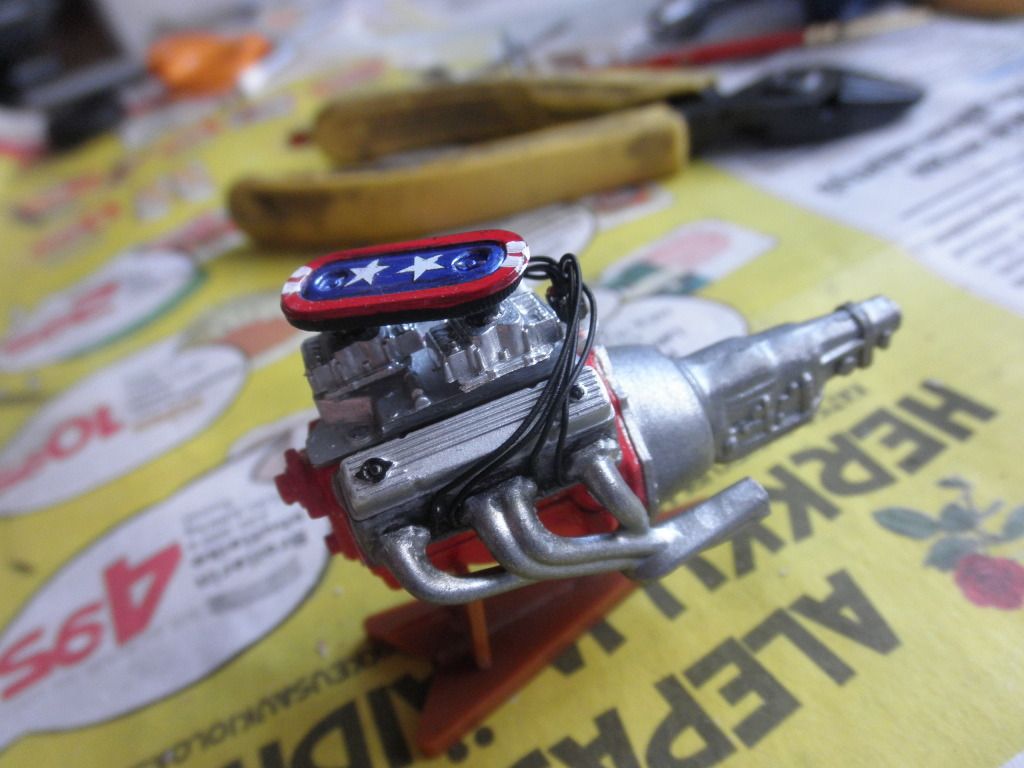

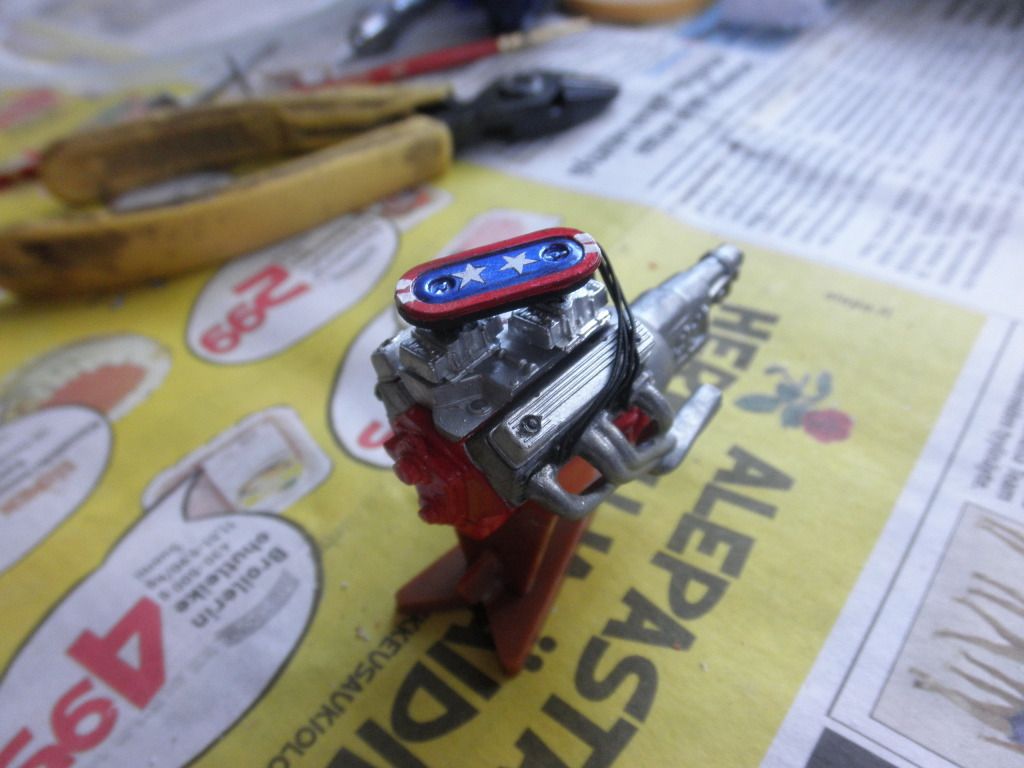

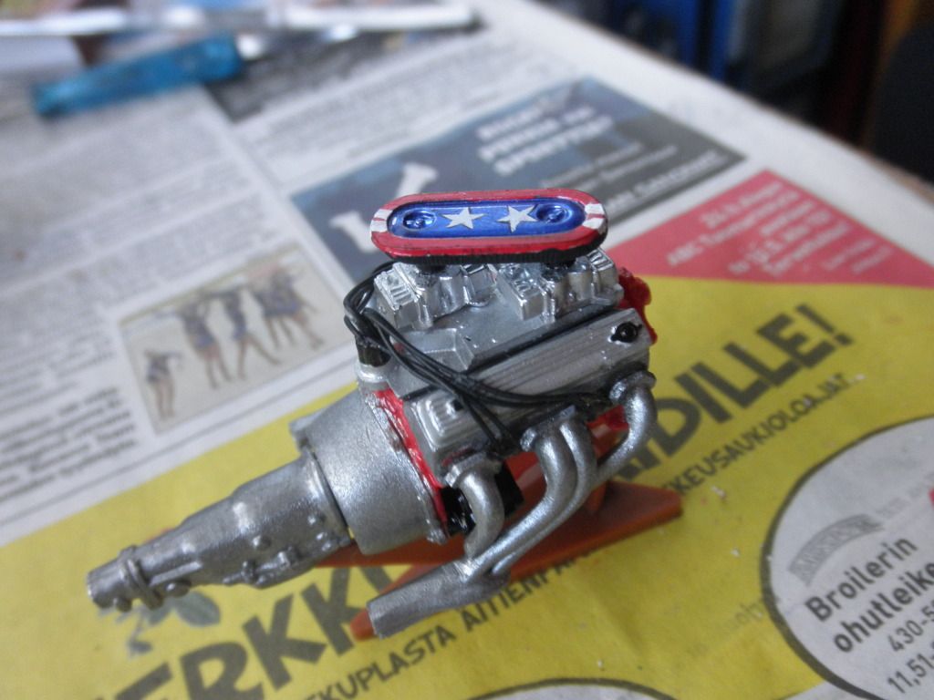

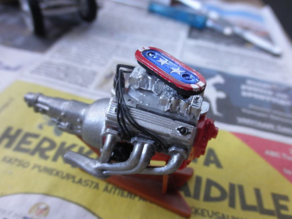

W-409 Posted May 15, 2012 Share Posted May 15, 2012 Little update for the Camaro, so I can get it done when the race starts... Ignition wires are installed and I found those headers too, finally. Air Cleaner is installed also, I painted it to match USA Flag colors, stars are just decals. Next step is body work and interior, of course that engine isn't finished either... Quote Link to comment Share on other sites More sharing options...
Nick Winter Posted May 16, 2012 Author Share Posted May 16, 2012 Engine looks good. Quote Link to comment Share on other sites More sharing options...

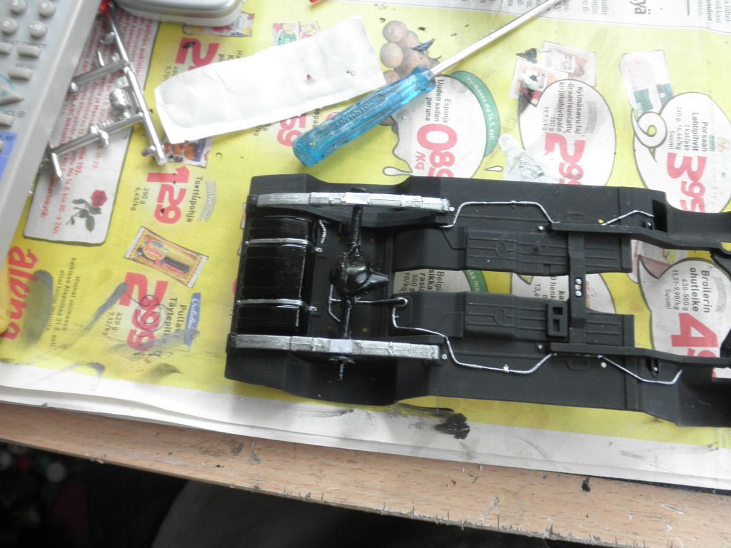

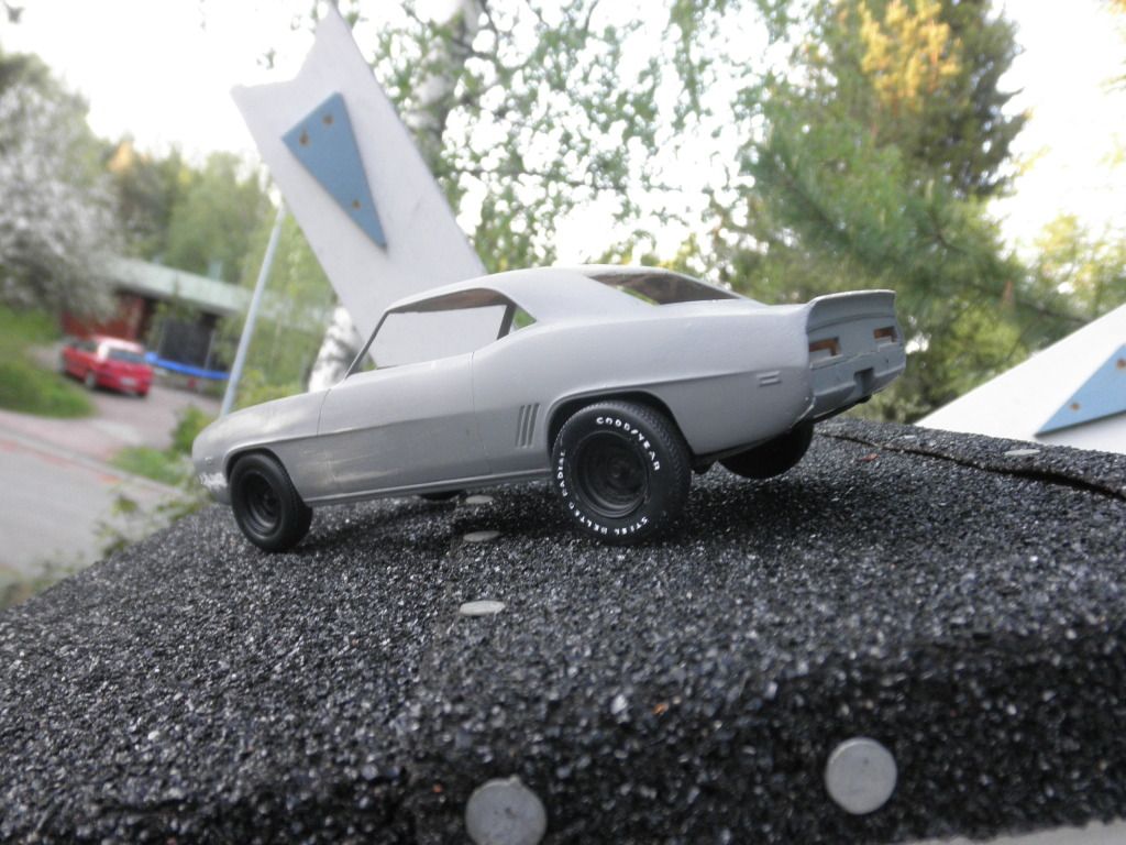

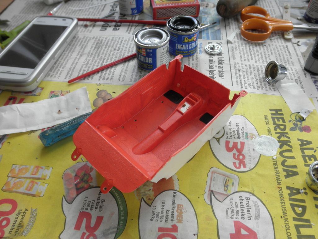

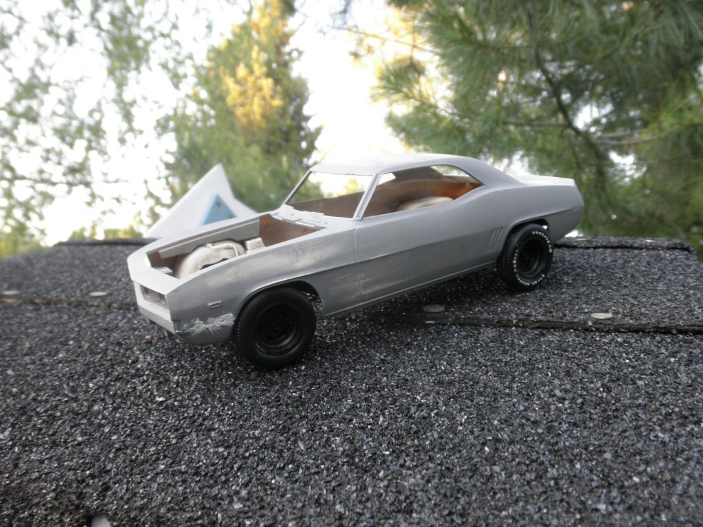

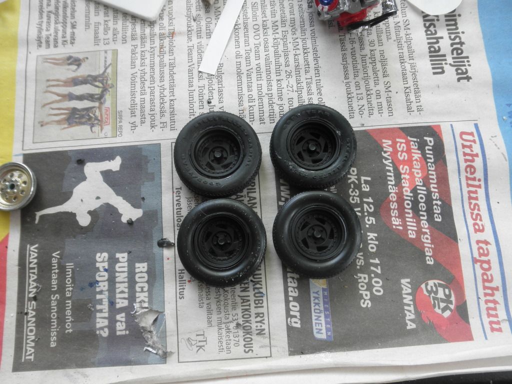

W-409 Posted May 25, 2012 Share Posted May 25, 2012 (edited) Thanks! I'm back on the Camaro. I painted Gas Tank gloss black and few details from the chassis are silver now. Also I found correct wheels for this, stripped the chrome plating and painted wheels flat black. Tires needed some work before I fitted those wheels on, but now they fit fine. I painted interior base color too and installed rear axle, but leaf springs need some work still before I can call them done. Edited May 25, 2012 by W-409 Quote Link to comment Share on other sites More sharing options...

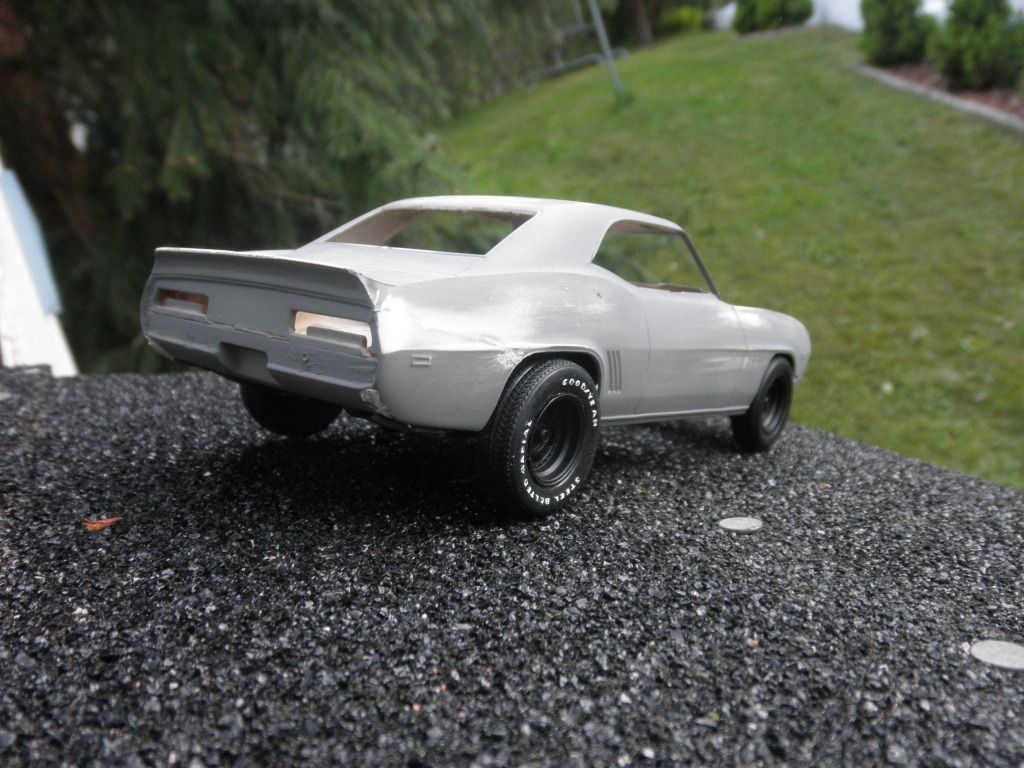

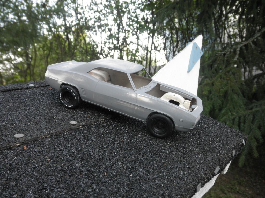

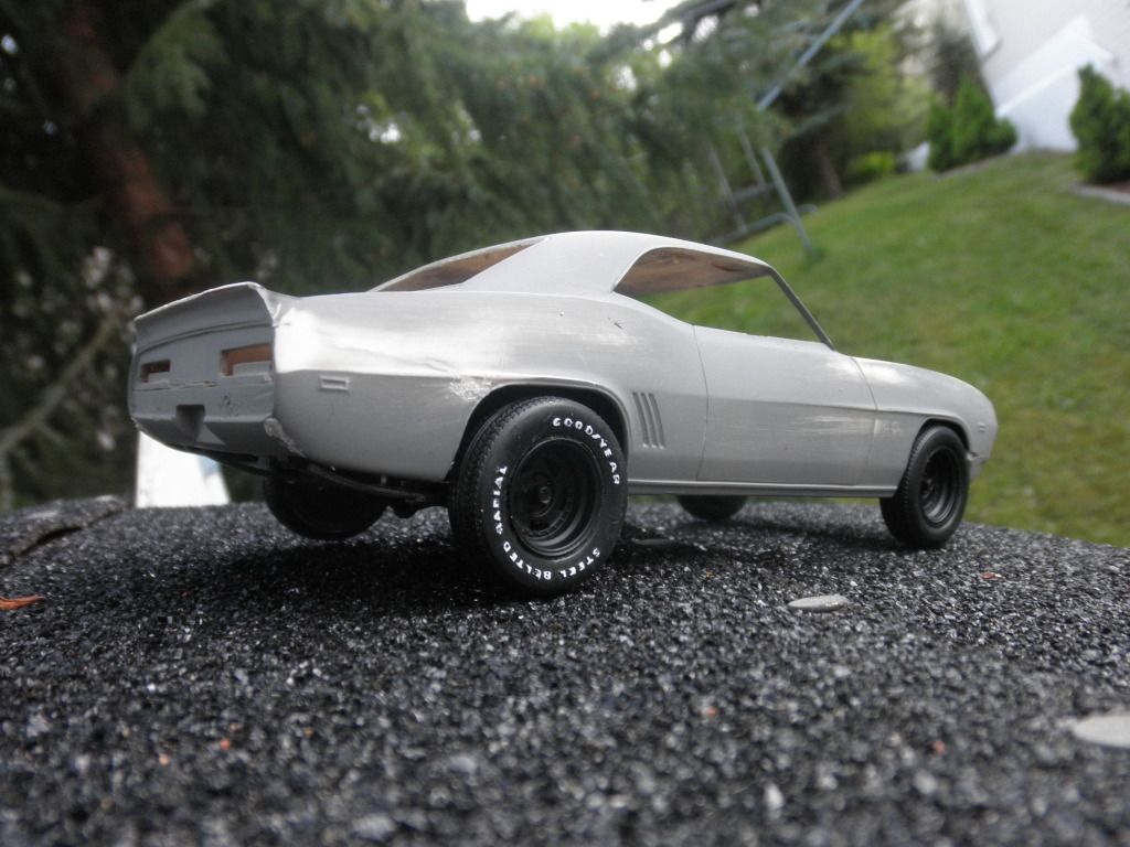

W-409 Posted May 26, 2012 Share Posted May 26, 2012 Front Axle System is assembled, now for the Camaro and I found good wheel backs from my spare parts box. They needed bit work before I could glue them on but now they fit fine. I had to paint textes from rear tires too before gluing them. Stance is pretty good now. Quote Link to comment Share on other sites More sharing options...
