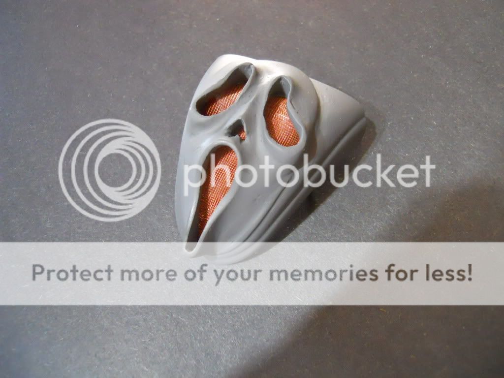

Oh my, looks like I'm getting close to what I want this grille to look like.
I just knew it was hiding in that clay & putty somewhere. Still have a little touch up to do around the nose & eye openings but I'll soon be able to add the hood/cloak and call it done.

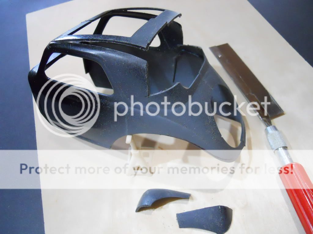

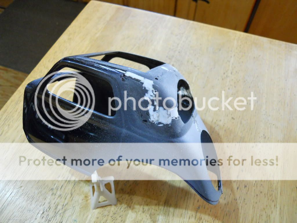

Lets see if we can fix some the uglies this Lindy body came with........

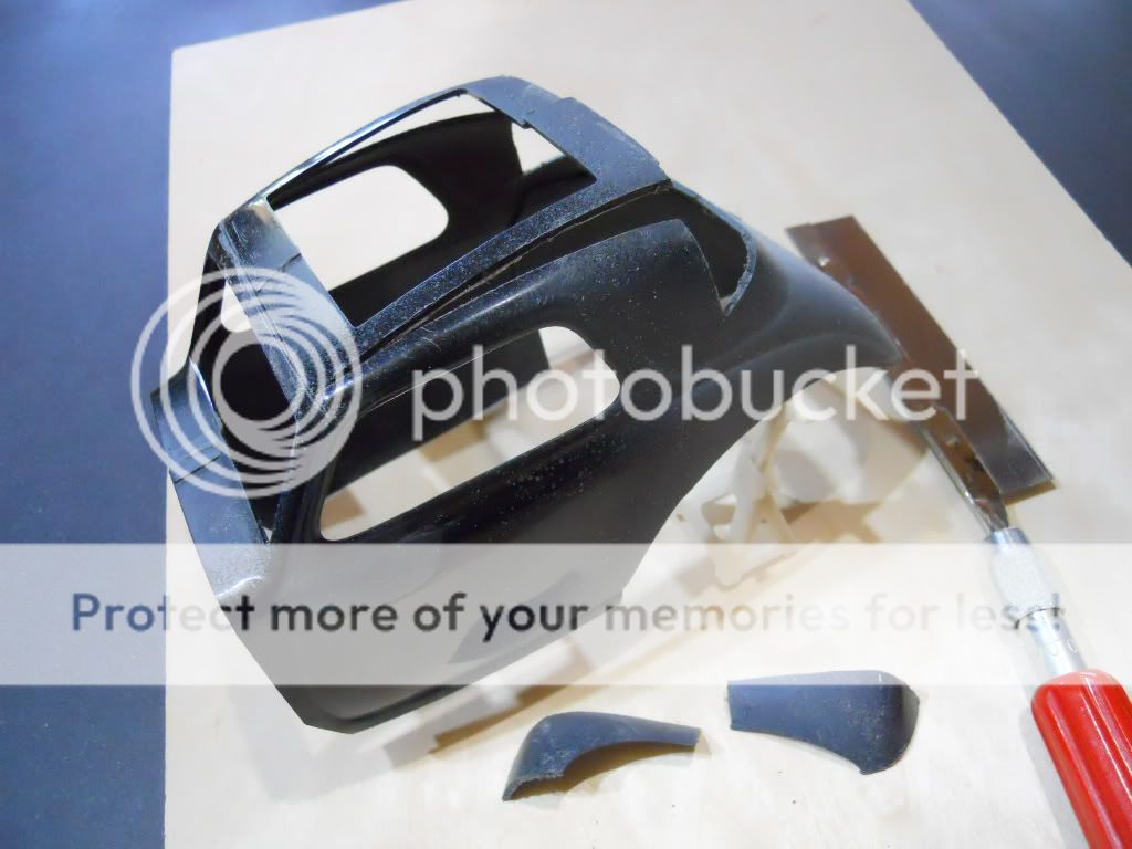

Here's the 2 piece body glued together out of the box.
I opened up the wheel well to accommodate the big rubber and started tapering the back of of the body so that it wouldn't look quite as clunky.
Just a little more trimming should give it the "look" I'm after.

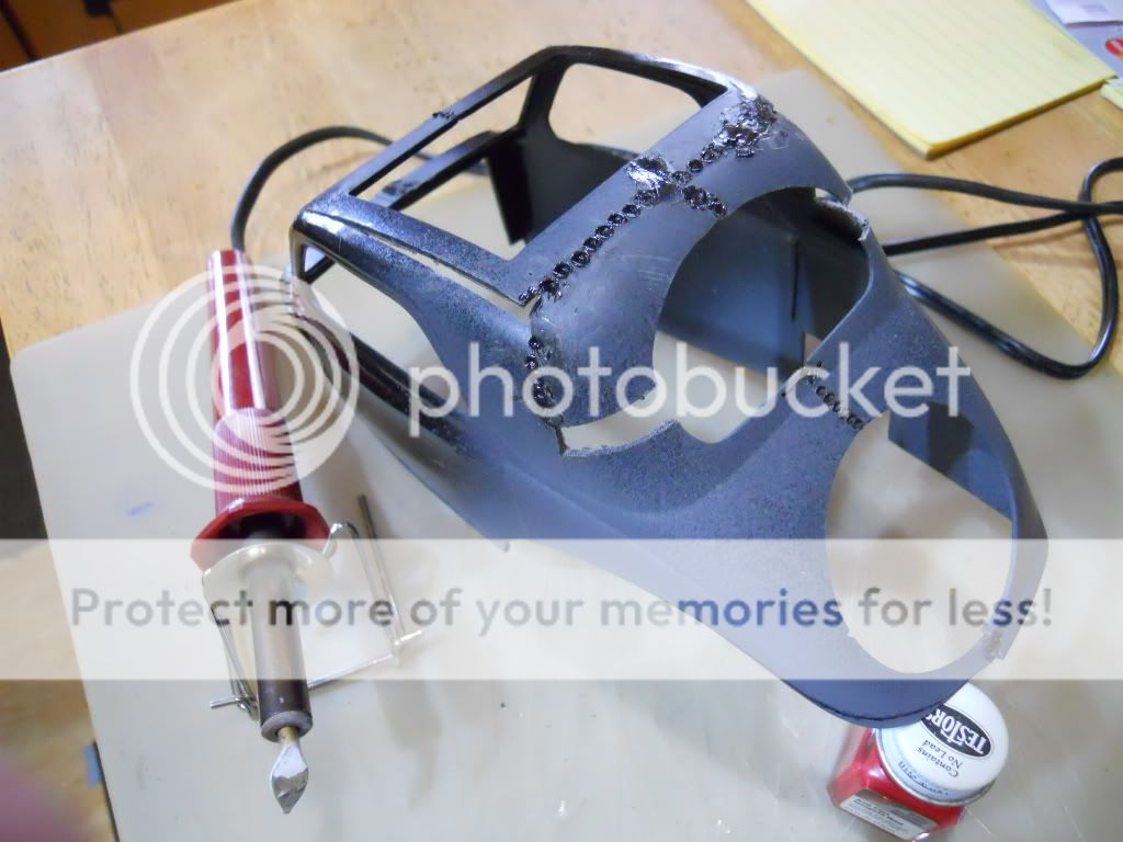

I don't like to use any more filler than I have to....shrinkage, ghost lines and so on over time can spoil an otherwise great paint job. Glued butt joints are weak and prone to crack with any sort of handling even when backed up with sheet plastic glued on the back side. Fillers are usually softer or harder than the surrounding material and don't sand/finish at the same rate........more problems.
Sooooo...I "plastic weld" the joints, fill & build up areas with the same plastic that the body is made of. NO glue or filler!
What I'll wind up with is a body that's one piece and all plastic.

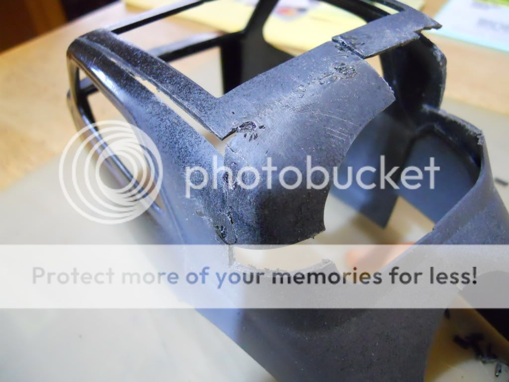

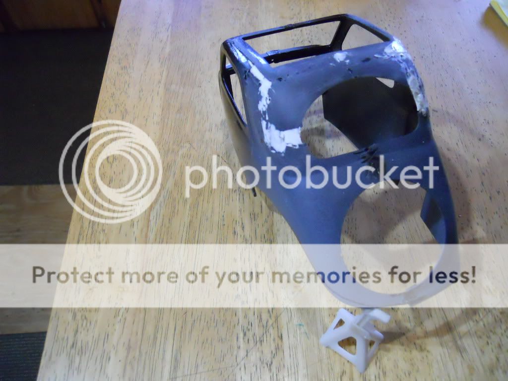

Here's a couple of pics showing the spot welds to hold sections in position and I'll post more photos using scrap plastic from the kit as filler.
I'll also show how I fuse fine copper or brass mesh to the inside of the body to add even more strength to the shell.
Be warned...melting plastic stinks and the fumes are probably bad for you. It's also very easy to warp or ruin a body if you don't take your time and apply too much heat in one area...not for everybody, but it allows me to do things would be darn near impossible simply gluing chunks together.
Link to comment

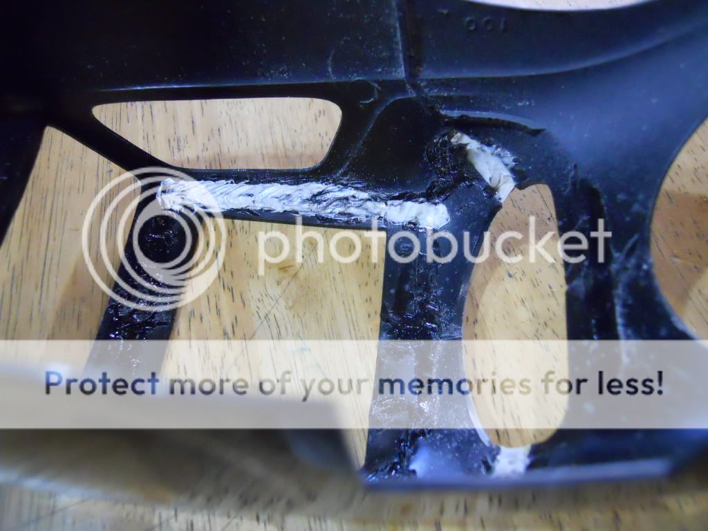

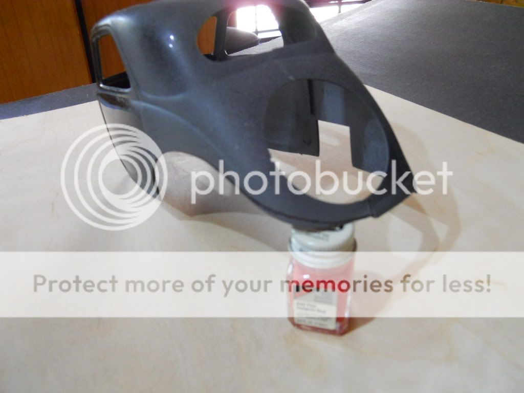

I started "welding" with scrap black plastic but it was difficult to see & and photograph, so I switched to white.
Here's a shot of the inside before any clean-up.
The left side has been rough sanded, the right has not...
I'll melt a little more plastic into voids and then sand again...

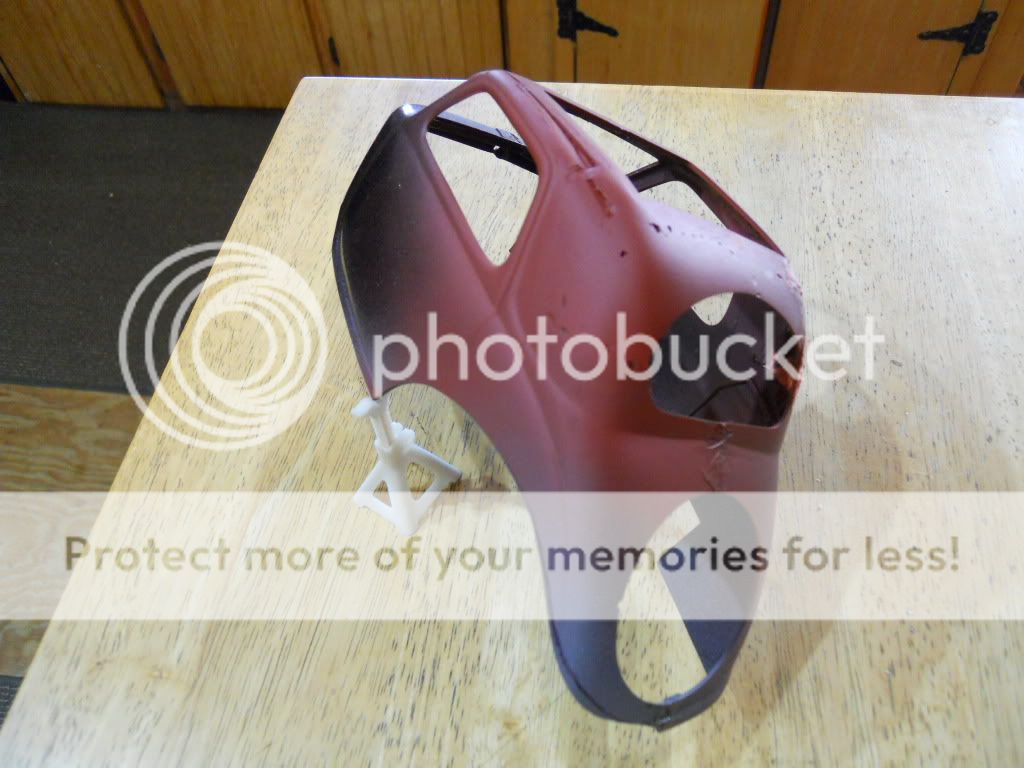

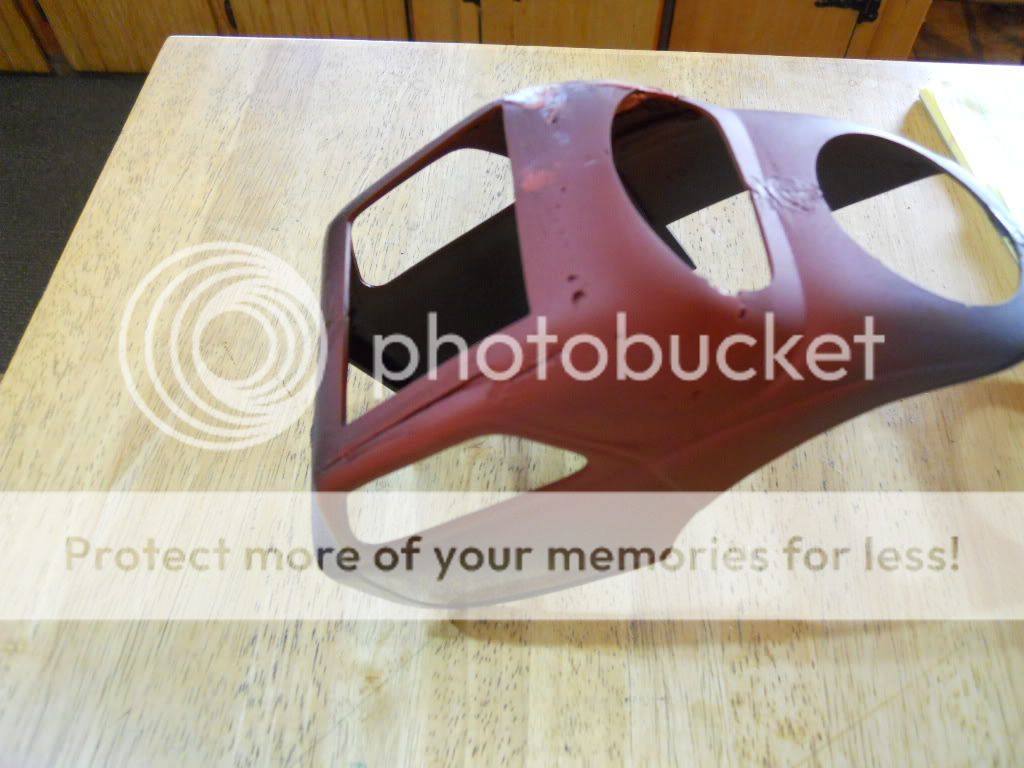

I sprayed a light coat of red primer/sealer over the gray for photo clarity and to use as a guide coat when I start the final sanding.
Even though the rear of the roof has been raised nearly 1/4" no filler or adhesive was used, it's all plastic and can be handled, sanded, drilled or whatever right after welding. No need to wait for adhesives to set-up or dry before working on it.
