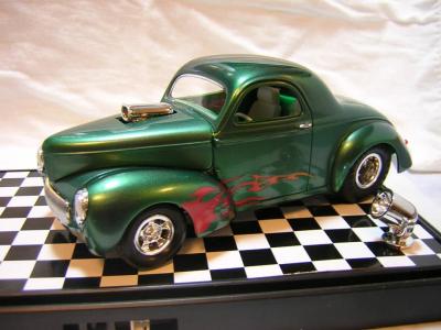

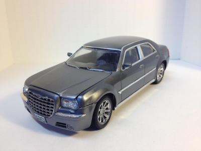

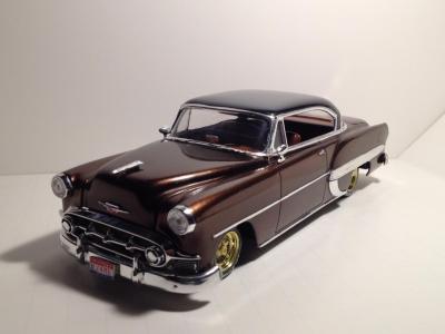

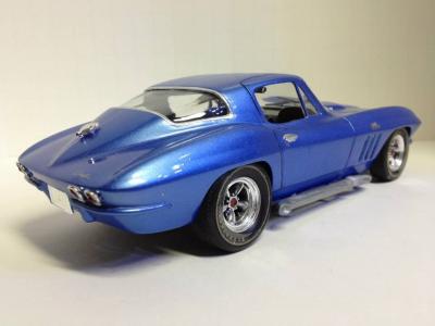

cchapman195 Posted July 10, 2014 Share Posted July 10, 2014 Ismael, I am wondering if you watched the video I did that happens to be at the top of the page? It will answer all the questions you have concerning Pledge floor care. It was formally future floor care. I Use LA's Totally awesome mop and shine in the video as it is the same stuff only cheaper. So to begin with question #1: It will give a quality show car shine. #2 It dries quick so put a few light mist coats on and wait ten minutes and repeat. It will start out flat/dull but the more you put on the shinier it will get. #3 You can mask over it without any problems. #4 You can BMF over the top as a gloss is required for BMF to properly adhere. Another helpful hint is this is an acrylic based clear. I use Aqua Net hair spray and put a heavy coat on some models with a lot of pin striping. This puts a water proof barrier between your paint and clear that is clear. Then spray your Pledge over that until you get the shine you want. I do this in case I have a problem like dust I can easily wipe of the clear in the sink under hot water with out touching the paint underneath it. Here are models I have done with all acrylic paints with Future type floor polish for clear coats. Here is a link to my YouTube Channel tutorial playlist that may have some helpful tips that you can use. www.youtube.com/playlist?list=PLWmDDhf1nNnxvW9Jh_uNc9PkIUZm167M6 Quote Link to comment Share on other sites More sharing options...

408calirides Posted July 10, 2014 Share Posted July 10, 2014 Thanks for the info and pics, so will it go over any paints like duplicolor, rust oleum, model master, testors and Tamyia paints? Also I don't use airbrush so as applying coats is it the same time period as using a fan brush ? Quote Link to comment Share on other sites More sharing options...
