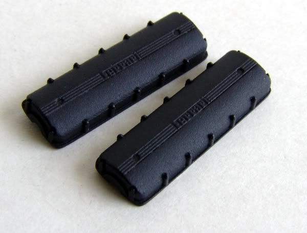

Custom Mike Posted May 11, 2013 Share Posted May 11, 2013 Dave, I'm sure you're already done with the Hemi you wanted to do this on, but just in case someone else wants to try this, I figured I'd chime in. I used the actual Crinkle Black paint for full-size cars, it's not the easiest to do, but it can work. It's not as convincing as what Alex did, but I think it looks better than a flat black with no texture. Here's a pair of pics of the results I got, it took three tries to get it right, but it did finally work! Quote Link to comment Share on other sites More sharing options...
