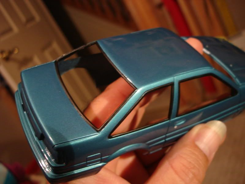

I too use the Tamiya tape method.
My GTO was taped off and single stroked one way with Testors Semi Gloss Black:
My Nissan was taped off completely(entire body) and sprayed with Tamiya Semi Gloss black:
I have had good luck both ways. Just need to figure out what works best for you, but, Tamiya tape is a must!

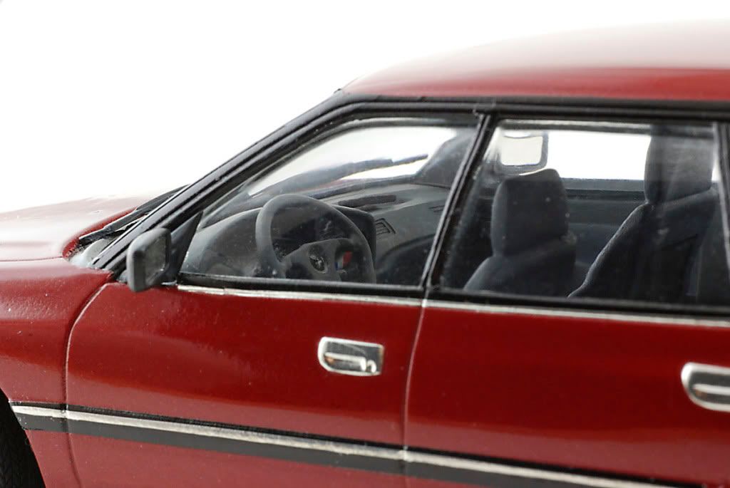

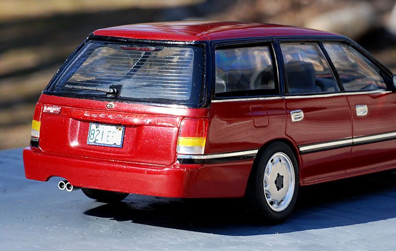

This popped up again so I'll put in a good word for black BMF. I used it for all the black trim on this Legacy almost 20 years ago and nothing has lifted or come unstuck. I didn't stick as well as chrome BMF but just needed more burnishing. It was also thicker. All in all, I'd use it again if needed.

It is different from the chrome .. thicker and therefore doesn't mold like chrome, but I find it does work ok. I find chrome rolls up coming off the sheet too ... I try to "bend" the opposite way to keep it straight. It doesn't seem to stick as well as the chrome but I have a 20 year old Subaru with the black bmf and it's fine.
