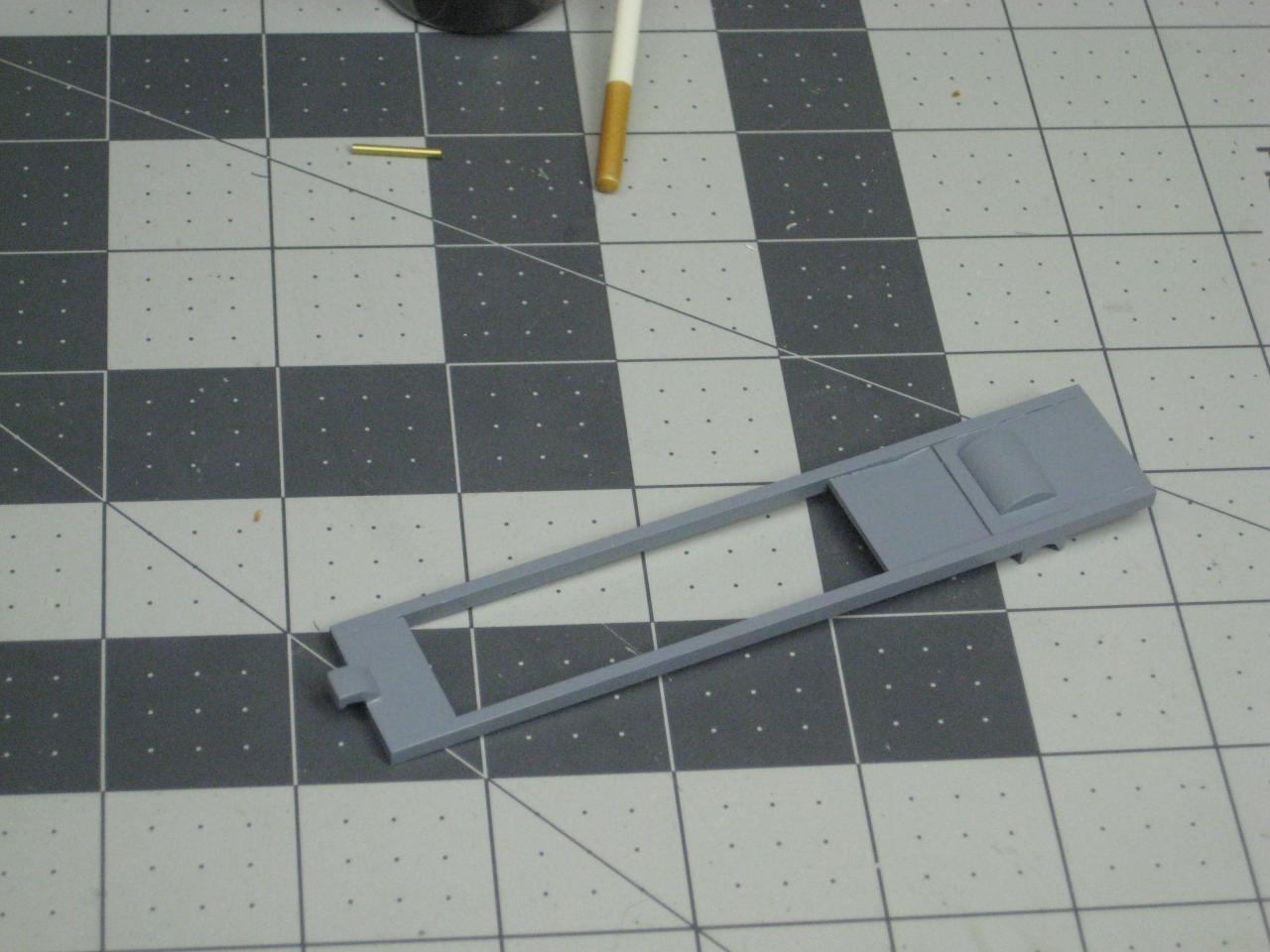

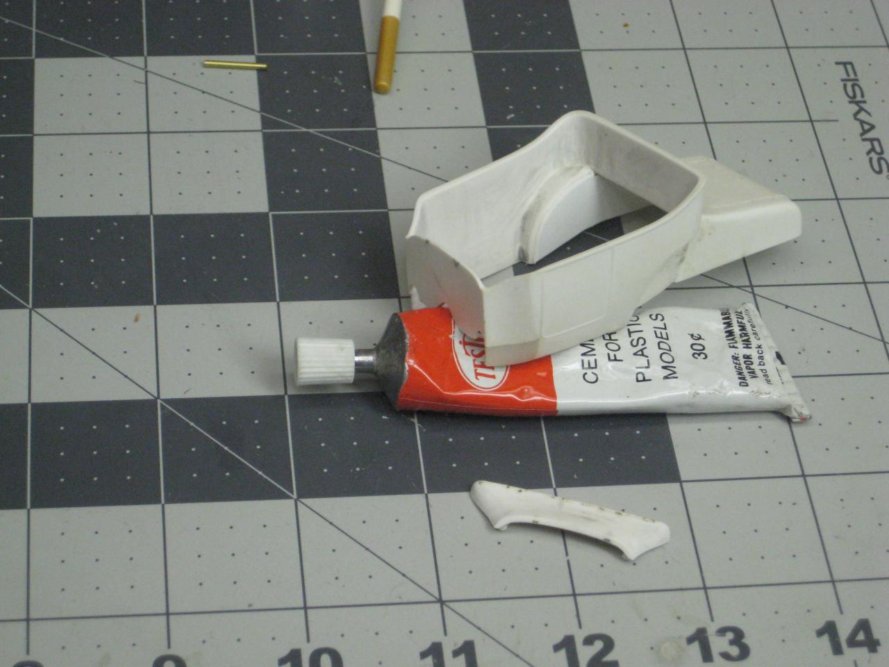

Anyway, I eventually coughed up the lawn care money, bought and made the T on a different frame (don’t remember what) back then, never saving the frame but did save the body (cuz it had an interesting paint job – Testors candy apple red over Pactra Hot Rod Primer (which nobody seems to make anymore).
Fast forward to a few years ago - after having bought many old Double Dragster kits and parts - of many production dates and colors, many Blueprinter versions with hideously incorrect wheels - I pulled out my old roadster body, sighed, gave it a swim in the purple pond and filled in where I had gouged it out for a Pittman arm and then let it sit……..
