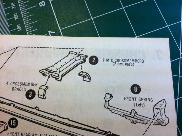

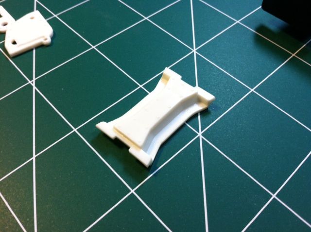

Goodwrench3 Posted March 22, 2015 Share Posted March 22, 2015 Hi all: I just started on an AMT "Pabst" beer wagon dual drive Freightliner COE this weekend myself -- interesting reading here ! There also seems to be a mis-print in the instruction sheet about the frame cross members ? Here is the section of the sheet I'm referring to: Note the instructions say "2 Mid crossmembers (2 pcs. each)". Well, I can locate the two cross members shown in the diagram - but only * 1 * piece for each of them (not including the brackets on either side that are glued to them). Here are the cross members in the kit -- note they are *1* piece each -- I don't see anything else that would go with them: Am I missing something ? Or is that a mis-print ? It also seems a bit strange there isn't a more "positive" cross member attachment in the frame -- there's only these 2 pieces and one in the very rear. Other than that there's only the from engine support. Thx Quote Link to comment Share on other sites More sharing options...
angelo7 Posted March 22, 2015 Share Posted March 22, 2015 (edited) They don't go together. They go like an inch apart from each other. And yes, they are one piece only each. Edited March 22, 2015 by angelo7 Quote Link to comment Share on other sites More sharing options...
Goodwrench3 Posted March 22, 2015 Share Posted March 22, 2015 Cool. Thanks. I just looked at the re-issued Freightliner DD on the Round 2 site and the posted instructions there -- looks like they corrected it in those instructions. Quote Link to comment Share on other sites More sharing options...

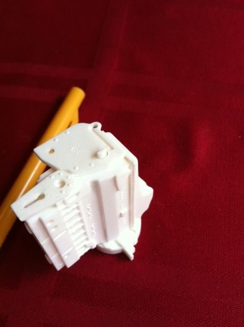

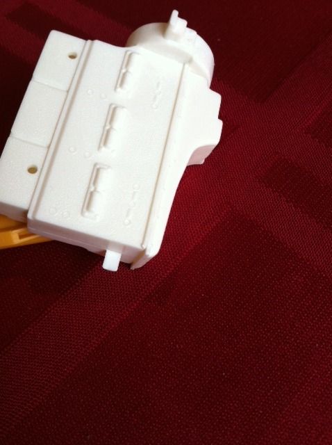

Goodwrench3 Posted March 22, 2015 Share Posted March 22, 2015 Hey -- Got another one for ya ... Assembling the Cummins engine -- the fit of the oil pan to the block seems funky. Note in the photo below how the front lip of the oil pan extends out past the front of the block a bit (yes I sanded the rear where it is against the bell housing so that the front of the pan would rest on the pin molded in the block): When I placed the front cover on the block (see photo below), the front lip of the oil pan is about flush with the front cover except for the area where the front cover doesn't extend to the side of the oil pan. You can still see the lip of the oil pan: Any help/advice much appreciated ! Thanks Quote Link to comment Share on other sites More sharing options...
angelo7 Posted March 22, 2015 Share Posted March 22, 2015 Looks ok to me. Mine is exactly like yours. Quote Link to comment Share on other sites More sharing options...
Petetrucker07 Posted March 22, 2015 Share Posted March 22, 2015 There's not much you can do about it. You probably never see it once it's in the truck. Quote Link to comment Share on other sites More sharing options...
Goodwrench3 Posted March 23, 2015 Share Posted March 23, 2015 10-4. Just wondered. Quote Link to comment Share on other sites More sharing options...
