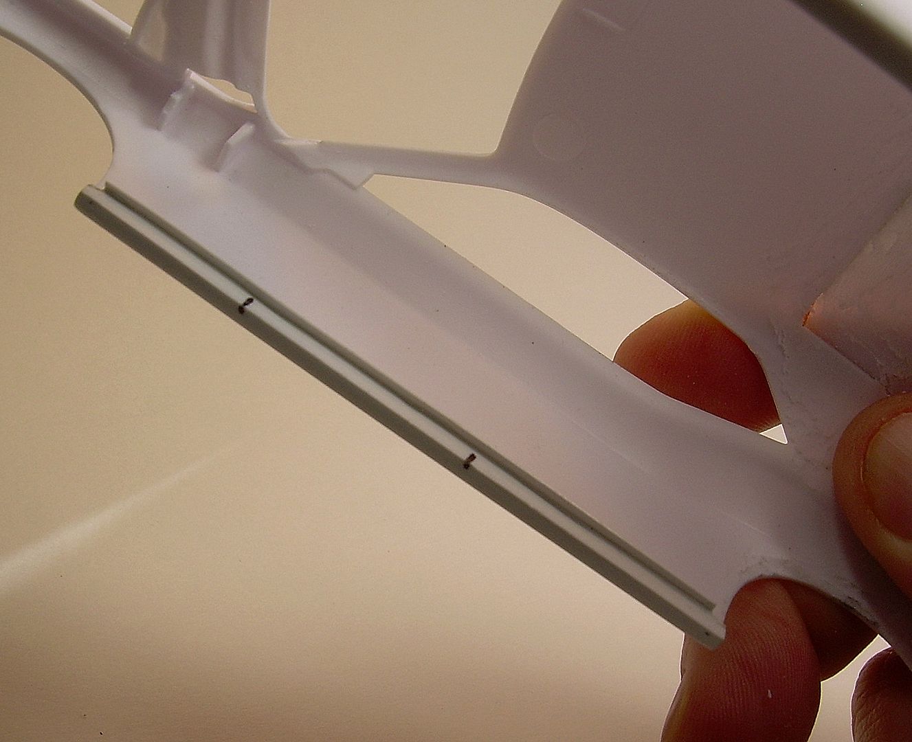

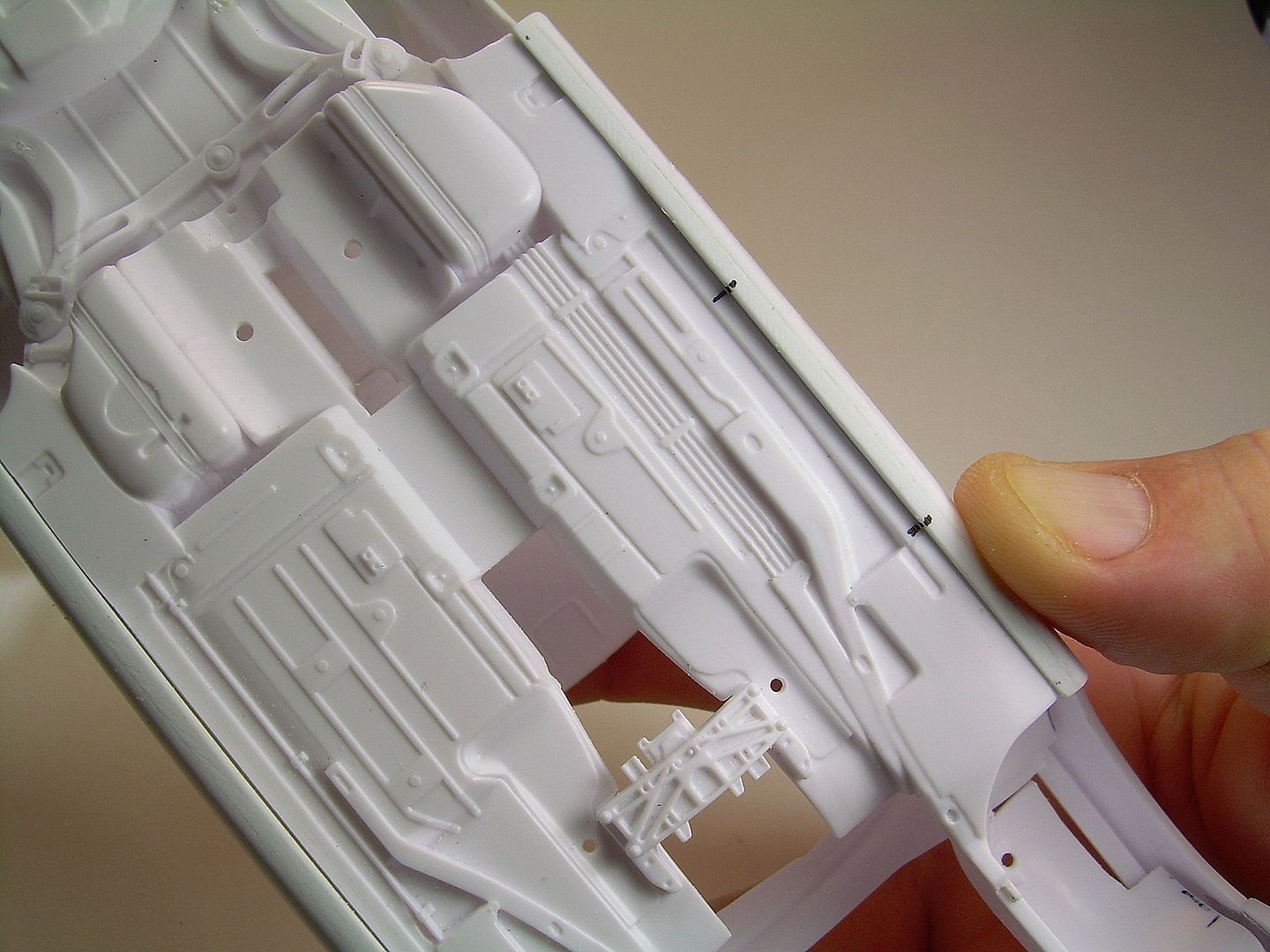

I mentioned above that I sectioned the body by removing the rocker panels and adding material to the insides of the body edges so new curved-under rockers could be formed. Then the lower door lines are scribed on the body in the new, raised locations. Here's the material added to the inside of the lower body edge, with a lip added at the top to positively locate the chassis height relative to the body.
Alignment marks insure the chassis will go in the right place to keep the wheels centered correctly in the wheel openings. You can also see how the added material has been shaped to curve under, like the original rockers did.

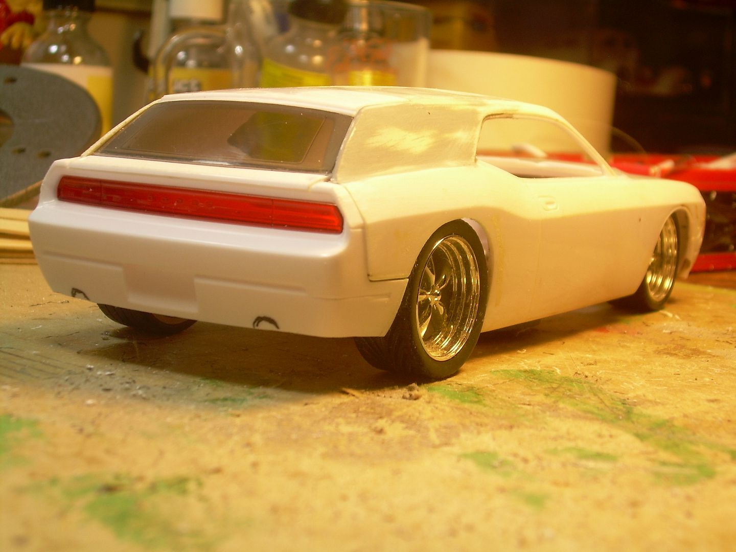

It's back. This is the first progress I've made on any model work since November, having been tied up with moving my home of 17 years (as well as my office, studio and 1:1 shop), health issues, and a host of other almost unbelievable problems.
I've put this one at the head of the list, because I owe a member here copies of 2 of the interim hoods I've made to get a "shaker" setup for this late-model Challenger (he graciously supplied styrene parts for me to work from, and has been very patient with all of my ongoing delays).
The pix speak for themselves. The donor for the roof, back glass and upper tailgate is the Revell Dodge Magnum kit, in case I failed to mention that before.
