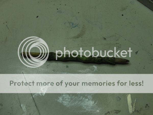

This one isn't too high tech, but it does do the trick,...
BMF / crevice / burnishing tool !
I made it from a bbq skewer (bamboo) sanded one end to a soft point and the other end is rounded smooth
I wound tape into a tight tube (think hockey stick) and wrapped it around the skewer
then wrapped the wrap with masking tape
This little buddy has gotten into some tight spaces to align plug wires etc. , etc.
The tape wrap helps to smooth foil around those pesky window openings and compound curve areas

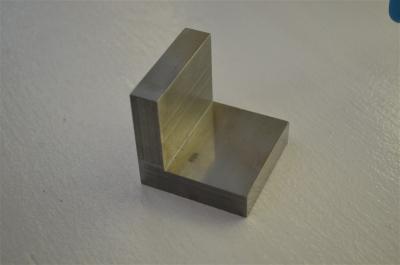

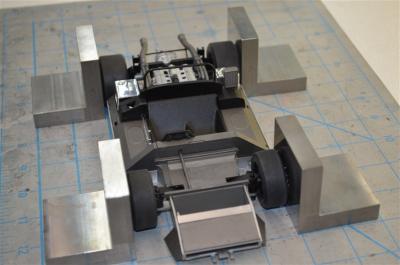

I can't say this was my idea. I got it from Dr. Cranky here on the forum. I'm lucky enough to have a son that's a CNC machinist so I asked him to make what I'd call alignment blocks. They're made from stainless steel, measure 2"x2"x1/2" thick and weigh about a pound each. I use them to align wheels/tires.

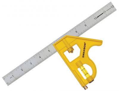

Someone on the forum did the same thing by taking two heads from one of those adjustable shop squares, putting them both on the same ruler. The tires clamp square between the sliding handles. Hard to describe and I don't have my camera handy.

I've seen that trick before. I think it's good to know how to do something different ways. circumstances can dictate the best one to use.
