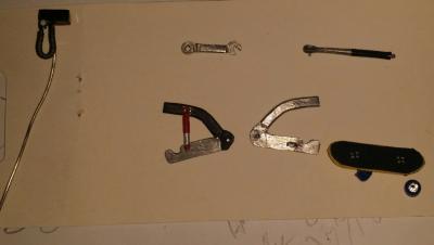

jacoballardtattoo Posted May 18, 2015 Share Posted May 18, 2015 Depending on the scale and your method some shocks from a truck kit may work for you. I am doing a Baja right now myself and this is my current attack at this problem. I may change it soon though. I created a new spring plate and frame work for the rear out of solder. I am kicking around a standard has shock (in the picture painted) a coil which will be made by wrapping jewelry wire (cheap stuff from Walmart) around a screw to get the coil. Or possibly doing a coil over by combining the two systems. Quote Link to comment Share on other sites More sharing options...

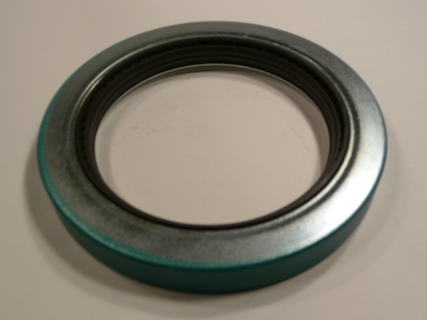

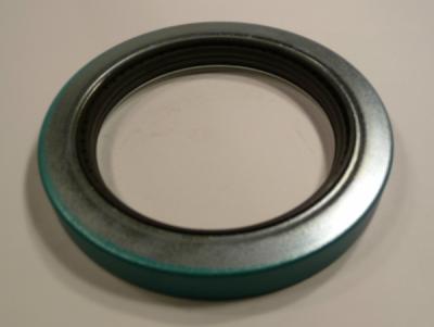

Brent Posted May 18, 2015 Share Posted May 18, 2015 I have done my share of scratch build suspensions including all sorts of shocks. I have used springs from pens which do work. I currently am working on a stadium truck with functional suspension. I used pen springs for this one and IMO are a little flimsy looking. Another approach is go with the Nitrogen filled shock look. I did this on a Baja I built. I used pen springs for the front and Nitrogen filled duals on the back. I recently came across something while working. I was replacing a huge seal (I am a service technician) and inside the seal is a spring. I brought this seal home removed the spring, cut it in half and stretchered it. It looks fantastic! Wheel seals will have the same spring. Different sized wheel seals will have different sized springs inside. Quote Link to comment Share on other sites More sharing options...

hjracing Posted May 20, 2015 Share Posted May 20, 2015 I have done my share of scratch build suspensions including all sorts of shocks. I have used springs from pens which do work. I currently am working on a stadium truck with functional suspension. I used pen springs for this one and IMO are a little flimsy looking. Another approach is go with the Nitrogen filled shock look. I did this on a Baja I built. I used pen springs for the front and Nitrogen filled duals on the back. I recently came across something while working. I was replacing a huge seal (I am a service technician) and inside the seal is a spring. I brought this seal home removed the spring, cut it in half and stretchered it. It looks fantastic! Wheel seals will have the same spring. Different sized wheel seals will have different sized springs inside. Just amaizing! I want to see the Stadium truck build pleaseeeeee! Quote Link to comment Share on other sites More sharing options...
