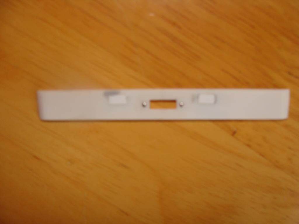

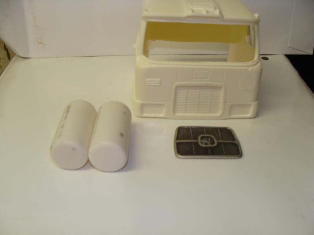

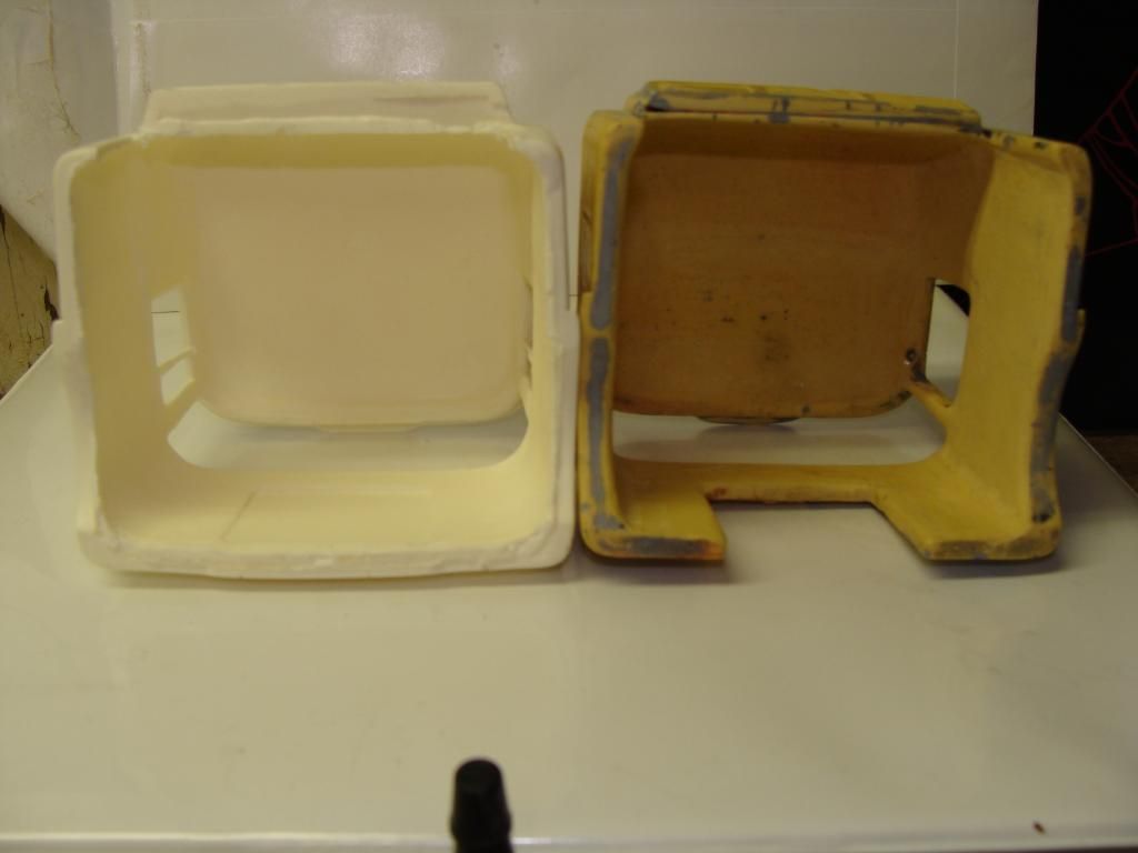

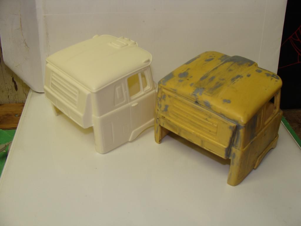

Modelmikey Posted February 1, 2015 Share Posted February 1, 2015 (edited) I started a in progress thread awhile ago, but got lost in that shuffle. I didn't repost until I got a bit more done. I'm building a model of a '72 Hayes COE my Dad drove, from a AITM F-Mack. Although he offers a Hayes, I went with the mack because it doesn't have molded in headlights or A/C. I sort of started this 15 years ago with a MTFAC cab, which was too much work for me at the time, see the side by side. From the 1:1 pics, I'm going for the black paint. So far, I chose the KW 123 as a donor, which adds a bit of a challege, but has most of what I need, spring suspention, cummins, etc. I have a Pewter grill from ????? but looks good to me. I've so far scrach built a battery box, modified a Diamon reo bumper, and for the tanks I used the K123 tanks with Diamond Reo end caps, the mounts are from a Frieghtliner COE & I took about 2mm off the top, and added a strip to to the top. The straps are .015" sheet plastic. Lots to do on this one, it will be a suprise hopfully by Aug, its hard to get info about it, since my dad sold it when I was 2. Edited February 2, 2015 by Modelmikey Quote Link to comment Share on other sites More sharing options...

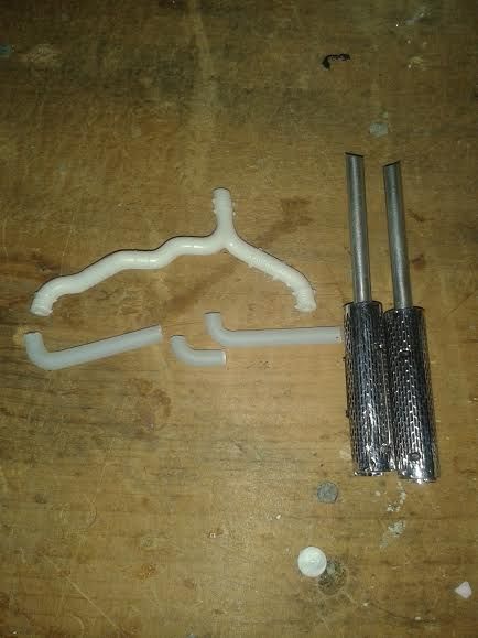

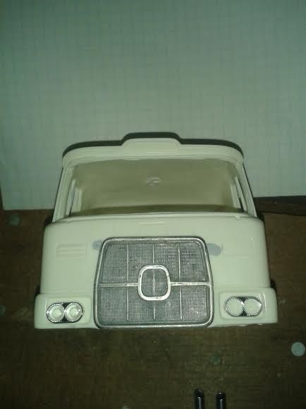

Modelmikey Posted February 1, 2015 Author Share Posted February 1, 2015 I snapped a few more pictures with my phone which turned out waaay better. Here are the Peterbilt mufflers, the elbows I made from 5mm rod and aluminum tube, and the KW 123 exhaust piping (I didn't like the KW elbows). Front shot of cab with Pewter grill, and headlights from a Revell KW COE kit, they are only .03" wider then the AMT round headlights found in several kits, but eyeball engineering to me looks better. Quote Link to comment Share on other sites More sharing options...

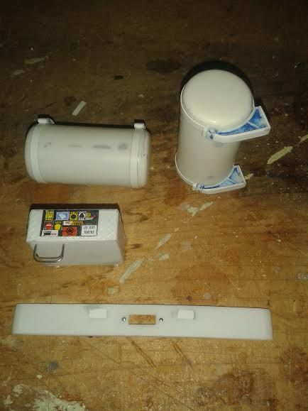

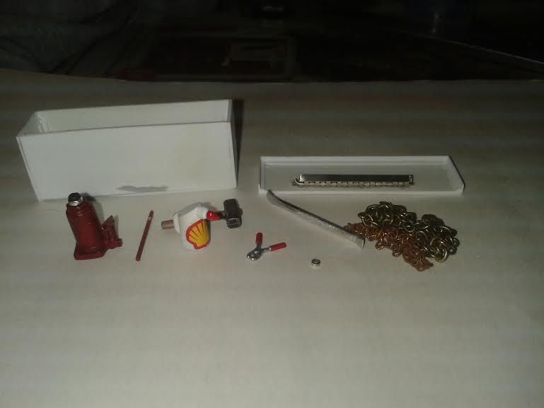

Modelmikey Posted February 21, 2015 Author Share Posted February 21, 2015 (edited) Small update, with so much snow I've spend more time shoveling then building. My dads truck had a toolbox behind the cab, so I scrach built this one, and here is some stuff to put in it, mostly from the Italeri accessories kit. The pry bar I made from 1/16" aluminum rod, and flattened the ends, then filed to suit.Thats a photo etch hinge, I'll put the top on after its painted Edited February 21, 2015 by Modelmikey Quote Link to comment Share on other sites More sharing options...
