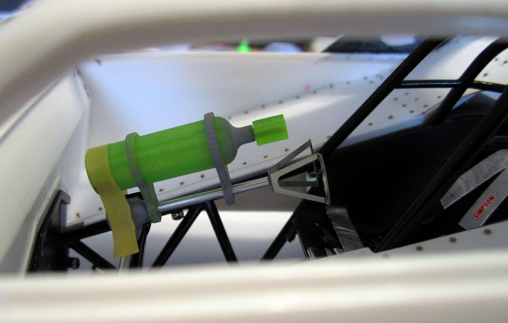

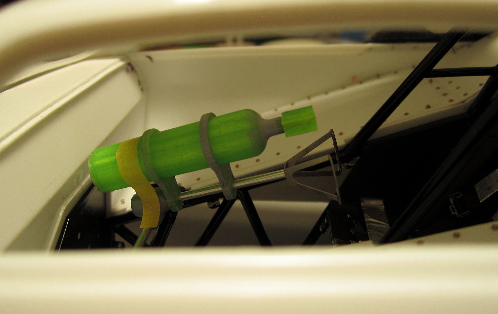

Mooneyzs Posted November 12, 2013 Author Share Posted November 12, 2013 Ok so a little update for everyone. I was able to get a little bench time in today and was going to work on it some more tonight but I wanted to share what I had done so far today. I had pulled out one of Futurattractions cockpit photo-etch details and bent the butterfly steering wheel into shape as well as getting the length from the steering gear box to steering wheel figured out. Then it was time to mock up both the 5lb and 10 lb bottles just to see how they looked. I did sand the bottles a little more and got them to fit on to the brackets. I actually chucked them up in my electric drill and used a sanding board to help sand them. I need to shoot some more primer on them to see how they turned out. Anywhere here is where I am at with it and you can let me know what you think. 5lb Bottle Mocked up: 5lb Bottle with body on: 10lb Bottle Mocked up: 10lb Bottle with body on: Quote Link to comment Share on other sites More sharing options...
gasser59 Posted November 12, 2013 Share Posted November 12, 2013 Great update Chris. I still say the 5lb bottle. Quote Link to comment Share on other sites More sharing options...
Mooneyzs Posted November 12, 2013 Author Share Posted November 12, 2013 Thanks Brad... I think i am going to cut the 10lb bottle down to the length I will be changing the 5lb one to see how it looks...LOL Quote Link to comment Share on other sites More sharing options...

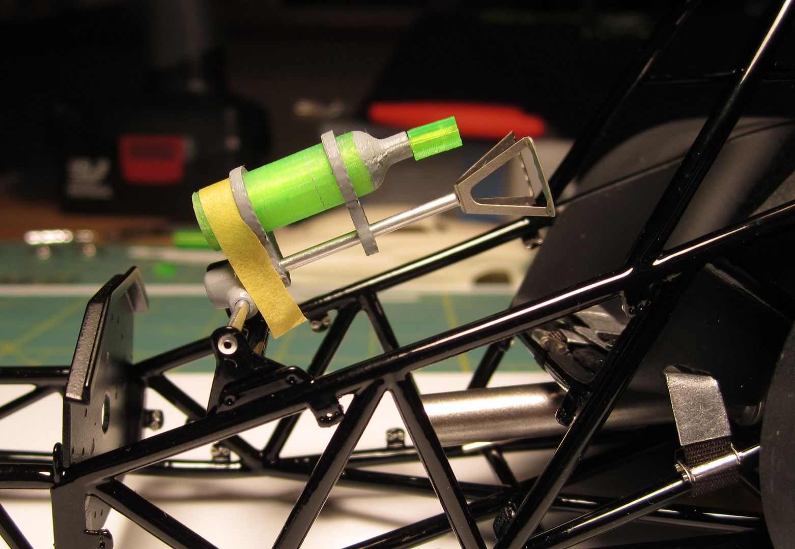

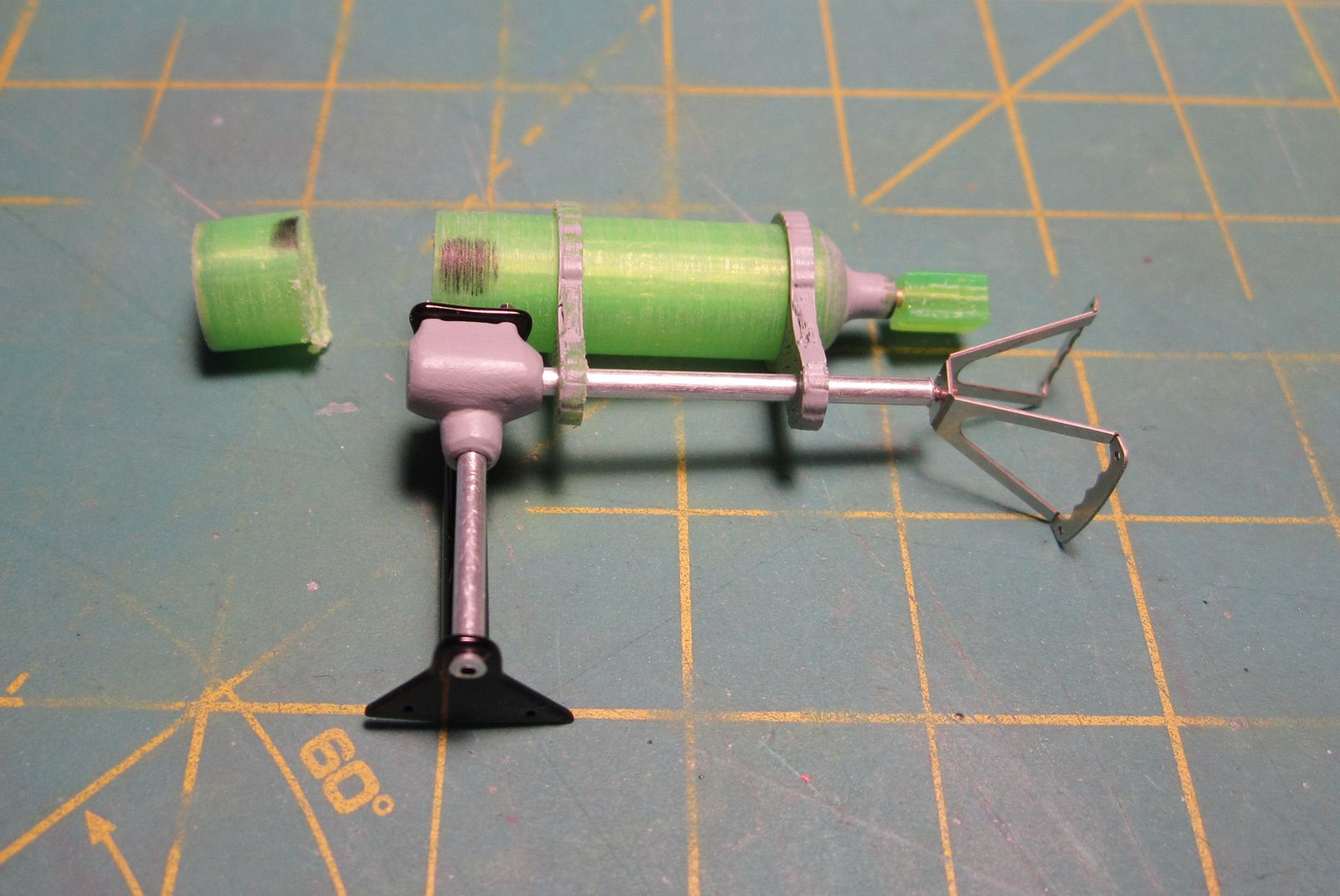

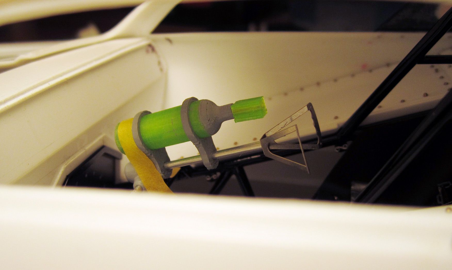

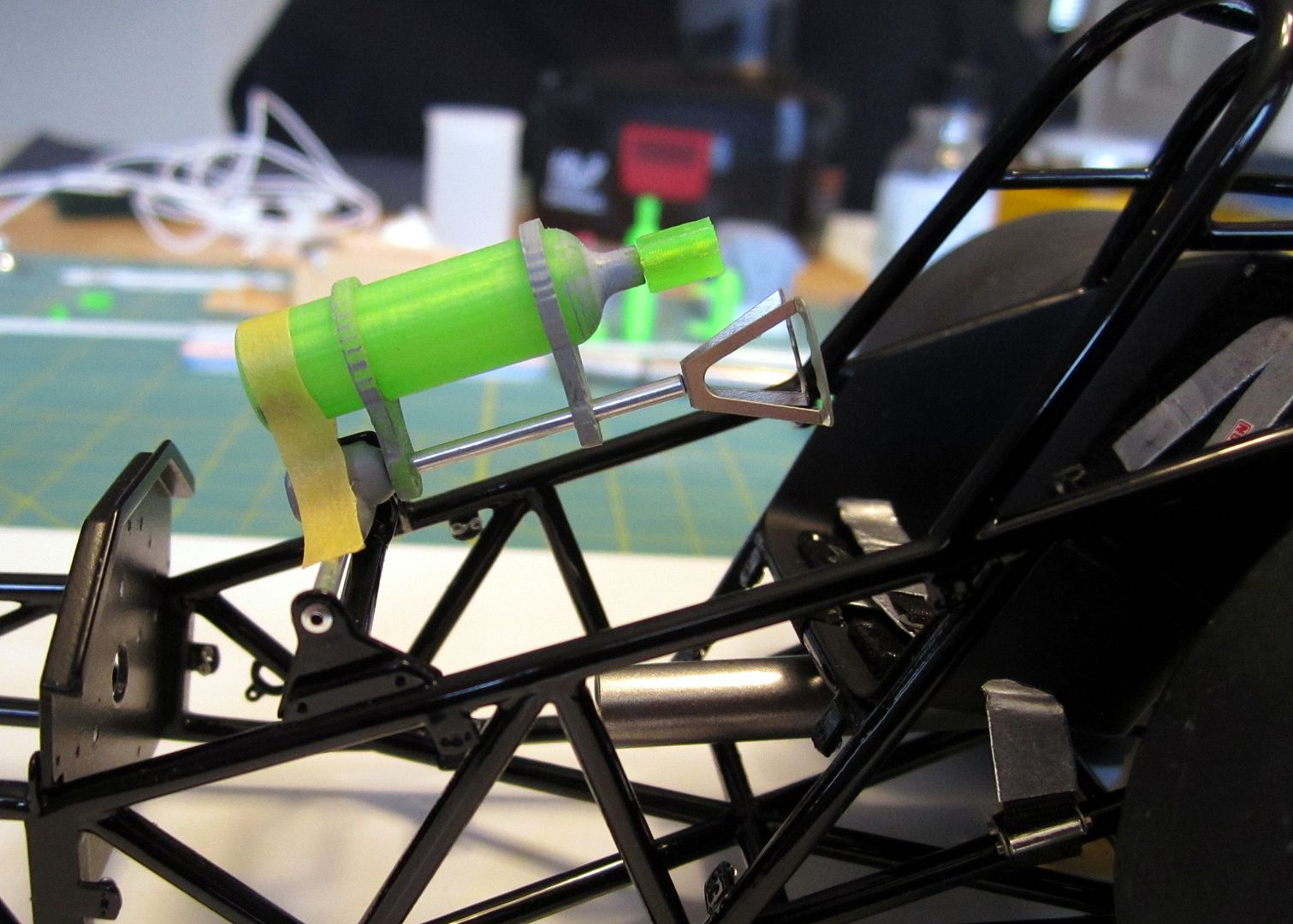

Mooneyzs Posted November 12, 2013 Author Share Posted November 12, 2013 Hello Fellas.... Well I was messing around this morning some more with this fire bottle and cut down the 10lb to the correct length to double check the size and I have resized my CAD models and going to have my buddy reprint these again. I had to mock this up one more time. I am really happy with the length now and the new printed pieces the diameter will be a tad smaller for the 5lb bottle. Now i am gonna jump back to the engine today in hopes of having it ready to paint this weekend. I have chopped part of the bottle off for the correct length of the 5lb bottle that I found new dimensions on: Mocked it up one last time to see how it would sit and look: Another shot with the body on, checking clearances: Quote Link to comment Share on other sites More sharing options...
Magic Photos Posted November 12, 2013 Share Posted November 12, 2013 Looks better Chris, I think this the right size. Quote Link to comment Share on other sites More sharing options...

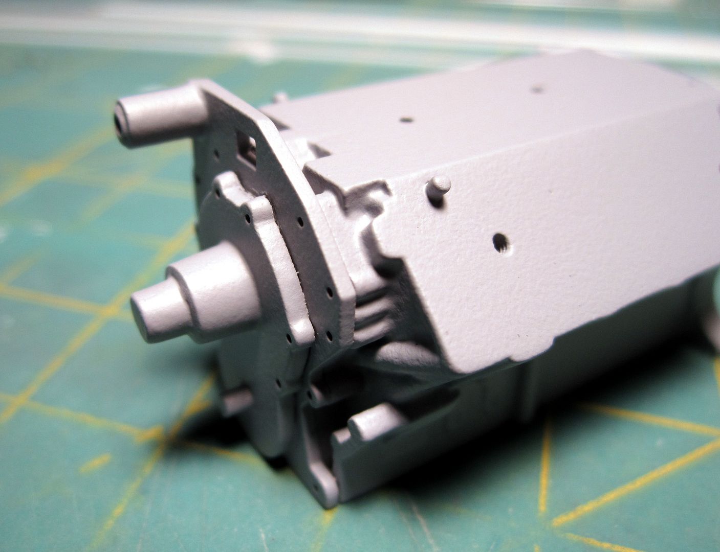

Mooneyzs Posted November 12, 2013 Author Share Posted November 12, 2013 Mike.... Thanks I am much happier with the length of the bottle now. It looks better as well. John... Thanks Brother!! It was great to talk with you earlier today and catch up. Thanks for being that inspiration. I am going to make sure and hit that bench every day even if its for a short time. Ray... Thank you for following along on this very long journey. Feels like I have been on it forever...lol I have started back on the engine. filling more pin holes and sanding and adding primer. Hoping to have the block completely prepped tonight and then it can be ready for paint. Quote Link to comment Share on other sites More sharing options...

bobthehobbyguy Posted November 13, 2013 Share Posted November 13, 2013 Chris, Keeps getting better. When I look at the mockup vs reference ohotos the bottke looks good but the brackets are twice the thickness of the actal parts. Is it oossible to have thinner parts printed. bobthehobbyguy Quote Link to comment Share on other sites More sharing options...
rv1963 Posted November 13, 2013 Share Posted November 13, 2013 Your entire build is amazing, the mods to the bottle look much better, well done. Quote Link to comment Share on other sites More sharing options...
Mooneyzs Posted November 13, 2013 Author Share Posted November 13, 2013 Aaron... Thanks man.... I am trying to make some good progress on it. Bob... Thanks man. Thank for the suggestion as well. I will change the thickness of the brackets and have thinner ones printed. I can't remember off the top of my head how thick I made them. I will have to double check them. Robert.... Thank you for the kind words on this build. Quote Link to comment Share on other sites More sharing options...
gasser59 Posted November 13, 2013 Share Posted November 13, 2013 Once you the the brackets thinner, it will look spot on. Nicely done. Looking forward to more updates. Keep at it bro, you'll get there. How soon are you planning on needing the decals? I've found a great new printer who does fantastic work. Quote Link to comment Share on other sites More sharing options...

Mooneyzs Posted November 13, 2013 Author Share Posted November 13, 2013 (edited) Brad…….he needs them now ………you go Brother. HAHAHA..... LMAO.... Umm I take it that some people are ready to see this thing painted and decaled? haha John can I borrow some of your little mini me's?? I need to learn to build at Teresi speed and I will have this sucker done in 2 weeks ... .... Brad...Honestly I am not sure when I exactly need them. I still have body work that needs to be done before I even get to primering the body. I need to hurry up and get this engine painted and start assembling it so I can jump back to the body. Last night I had done more work to the block and I am almost to the point of calling it ready for paint. I need to glue the timing cover on and then shoot one last coat of primer. going to be working on it this afternoon. I also went back and changed the thickness of the bottle brackets to .03125" which is equal to 1/2" in 1:1. Going to email those files to my buddy here shortly. And in the mean time I was farting around drawing this up that I am going to have him print as well..... *Edited - Made changes to Jack Ramps, I realized I made a mistake in the over all length of them when I drew them up. Edited November 14, 2013 by Mooneyzs Quote Link to comment Share on other sites More sharing options...

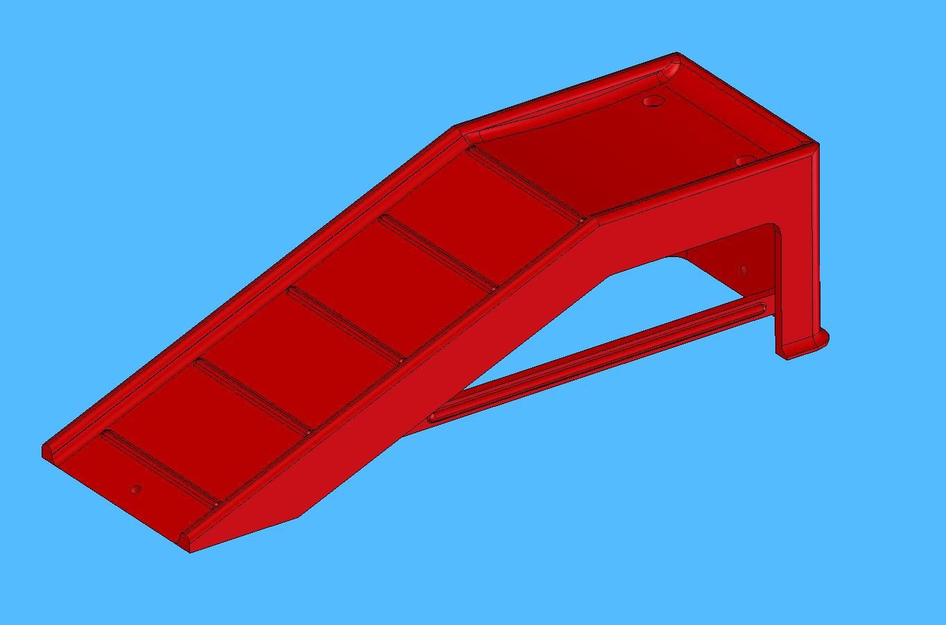

gasser59 Posted November 13, 2013 Share Posted November 13, 2013 That is so cool Chris. Is this in 1/16th scale or 1/24th? Either way, I want a set. Be interesting to see how these come out. Quote Link to comment Share on other sites More sharing options...

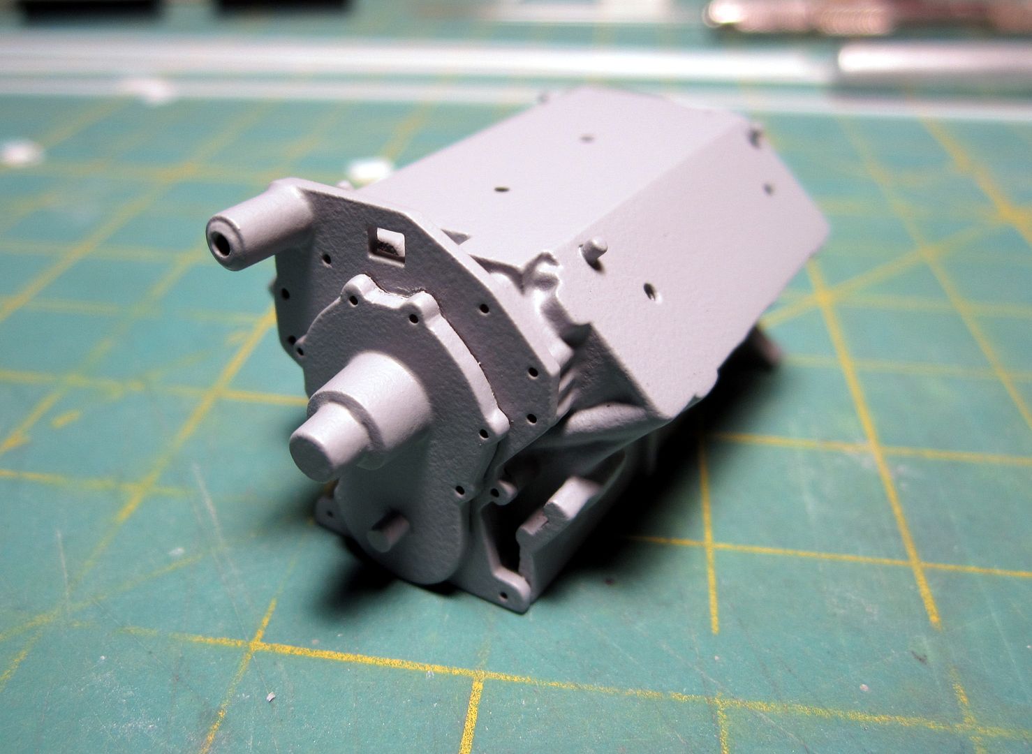

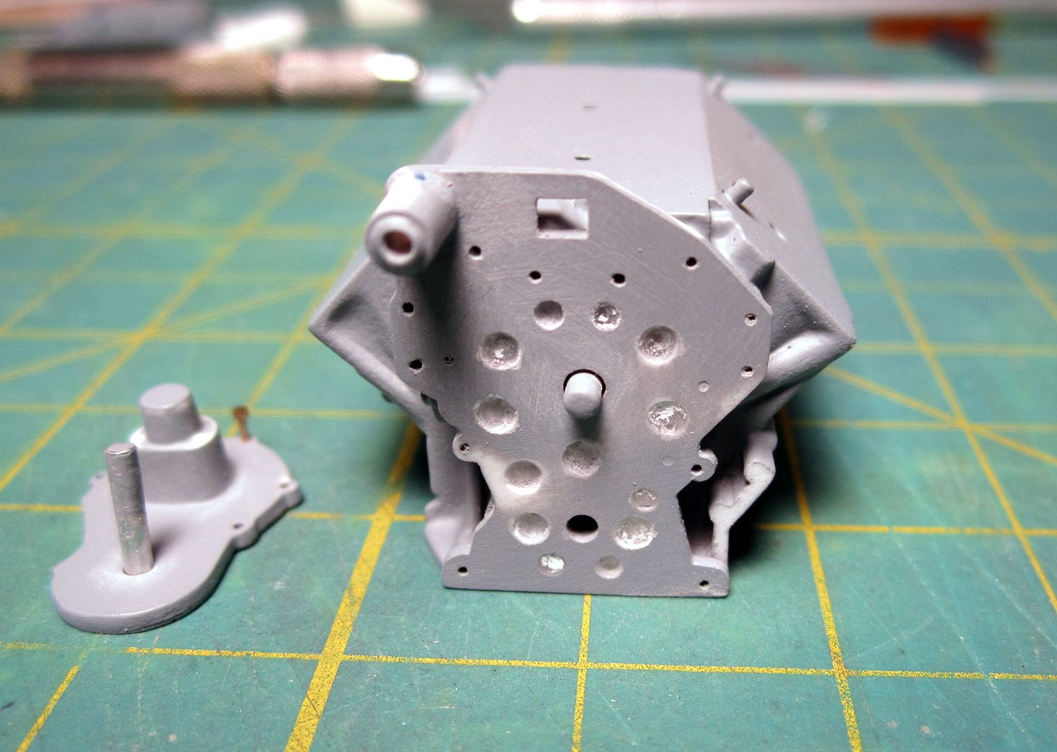

Mooneyzs Posted November 14, 2013 Author Share Posted November 14, 2013 Brad.... I drew these up in 1/16th Scale. It would not be a problem for me to draw them up in 1/24th scale. Darryl... Thanks Man!! So I got a little more done on the engine block today. Got the timing cover glued in place and shot another coat of primer. Time to work on the valve covers to fill a few pin holes and and prep for final primer. Here is the first portion of the timing cover. I drilled multiple holes for spots that I would add glue. I glued with CA and used kicker on it to set it in place. I wanted to make sure that my bolt holes lined up and I stuck the bolts in to locate it and then added glue in the swiss cheese holes I drilled into the plate, knowing that the other portion of the engine would cover these glue holes: Here is the 2nd part of the plated glued in place and after Primer was shot onto the block: Now here is where I would like feedback from my fellow modelers. So after gluing these plates on to the block I have noticed I have a small gap and wasn't sure when I was spraying primer if it would fill it in a little or not. Now I am debating if I should try to fill with a little CA glue to bridge the gab or if I should try to fill with some bondo or maybe add some other type of glue like white glue but not sure if a lacquer based primer would attack the white glue. Let me know your thoughts on what you would do. Thanks: Quote Link to comment Share on other sites More sharing options...
GoatGuy Posted November 14, 2013 Share Posted November 14, 2013 Looks right Chris. Can't wait for more. Quote Link to comment Share on other sites More sharing options...
