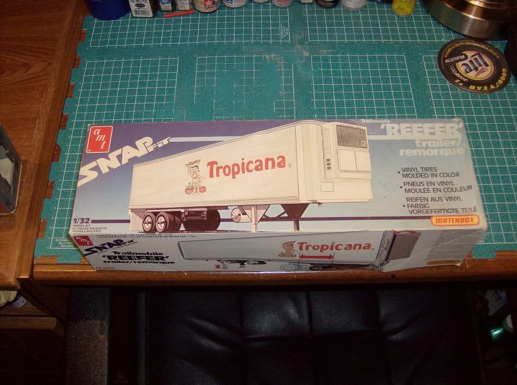

highway Posted December 7, 2010 Share Posted December 7, 2010 I'm pretty sure someone makes the correct stripes for the double sleeper version, though. The sleeper "spears" are longer and the sleeper stripes need to be longer to wrap around. I've got the AMT "BJ and the Bear" model, and the AMT "generic" version. The first noticeable problem is that the frame is way too long on both versions. The other obvious problem is the decals. Seriously...Dry transfer???...lol. I'm hoping there's a better set of decals for this one, too... Frank Frank, I'll start with the decals, since that's the easiest part of you're questions, JBOT decals offers correct decals for both trucks. JBOT Movin On Decals JBOT BJ & the Bear Tractor Decals JBOT BJ & the Bear Trailer Decals They are offered in multiple scales, and with the mention of the dry transfers from the AMT, I would guess the AMT with those is a 1/32 scale snap kit, as I have this old Tropicana reefer that has dry transfer decals, too. Jerry, who posts here as "phoneguy", at Modeltruckin.com also offers the BJ & the Bear decals, again in 1/25 and 1/32 scales (at least), and offers them as truck only or trailer only, but he also has a complete truck and trailer set as well. Modeltruckin BJ & the Bear Trcuk and Trailer decal set Quote Link to comment Share on other sites More sharing options...

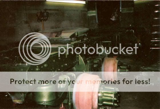

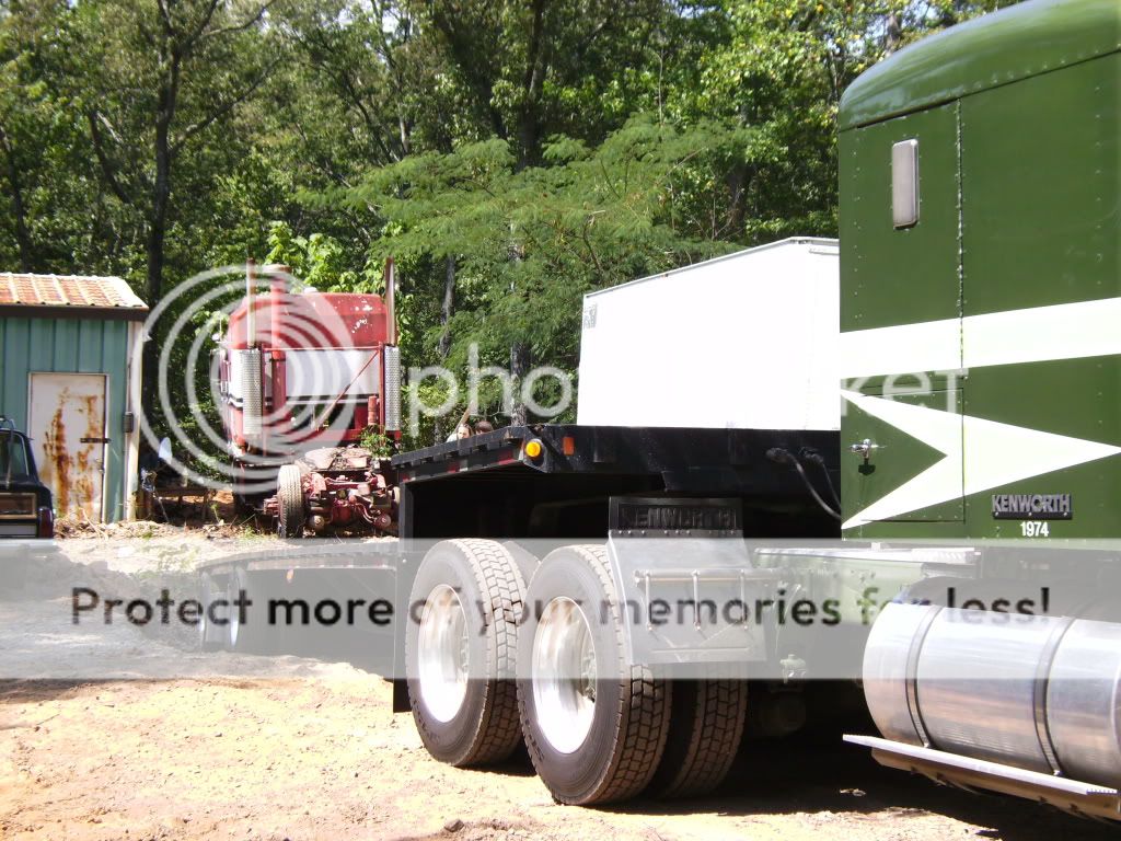

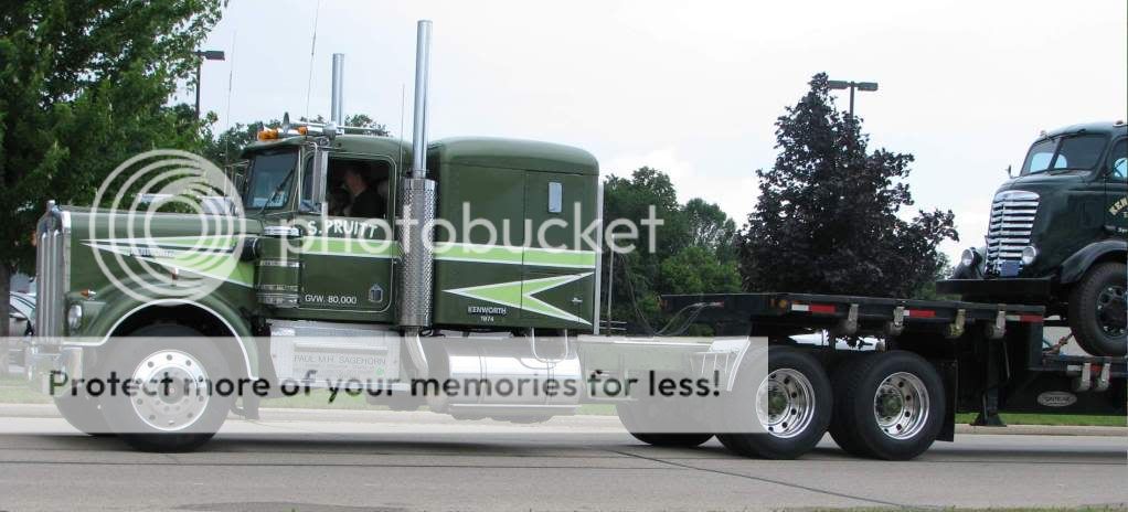

highway Posted December 7, 2010 Share Posted December 7, 2010 I'm just curious to see what everyone else has built for either of these trucks. I've got the original AMT "Movin On" model. As most of us know it's not accurate for either the series or the pilot (In Tandem). The kit is a cross between the 2. I'm using the Revell W-800 kit which has the correct double sleeper, and is the correct model W-800 vs. W-925. The w-800 kit has a few things that aren't accurate, but the truck is still a better starting point. The Revell kit has the wrong rear suspension and it has a V-8 instead of the NTC 350 Cummins the actual truck had. I've got the AMT "BJ and the Bear" model, and the AMT "generic" version. The first noticeable problem is that the frame is way too long on both versions. Frank Ok, now on to the trucks themselves. As you said, the Kenworth kits from AMT and Revell of Germany can both contribute to building a "correct" truck, be neither on their own will build one straight from the box. The sleeper is the first issue, the AMT will be correct for an early version, but the Revell is correct for a later in the series version. The Revell kit, as you said, is a better starting point for the later version, but has an incorrect engine. One thing you might try is use the AMT Cummins in the Revell kit or one of Revell of Germany's Peterbilt trucks as an engine donor, since they have Cummins power in them also. As for the rear suspension, I'm not sure what suspension was used on the original TV trucks, but here is a possibility you might take in mind. You can use the Revell kit to build a replica of the TV truck and just keep the suspension that is in the kit. I found these pics online, and I can't remember the site where I found the in progress pics, but I think I remember this 1:1 replica has a Peterbilt rear suspension in the rear. This is a pic of the finished truck. Now on to the BJ & the Bear truck, I know at least with the generic Kenworth cabover, since that is the only one I'm familiar with, the reason for the long frame is becasue of the original race truck haulers from the 70s, the "Papa Truck" and "Hideout Truck" haulers. The later issues are generally those trucks without the hauler beds, resulting in the mile long frame. The best solution I could say to do is just cut the frame to the proper looking length. If you need also, I have pics I've found online of replicas of both trucks, if you're interested, PM me and I'll email you what I have. I'll also try to find the site where I found the pic of the Movin On replica being built, because there was also a BJ & the Bear truck on the same site. Here's a pic of the Movin On truck picking up the BJ & the Bear rig! Quote Link to comment Share on other sites More sharing options...
