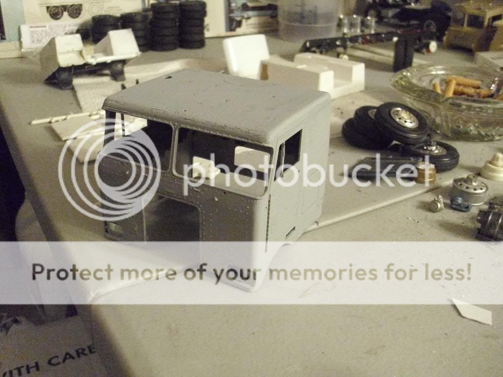

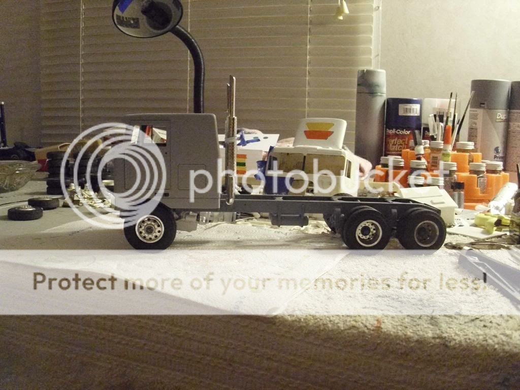

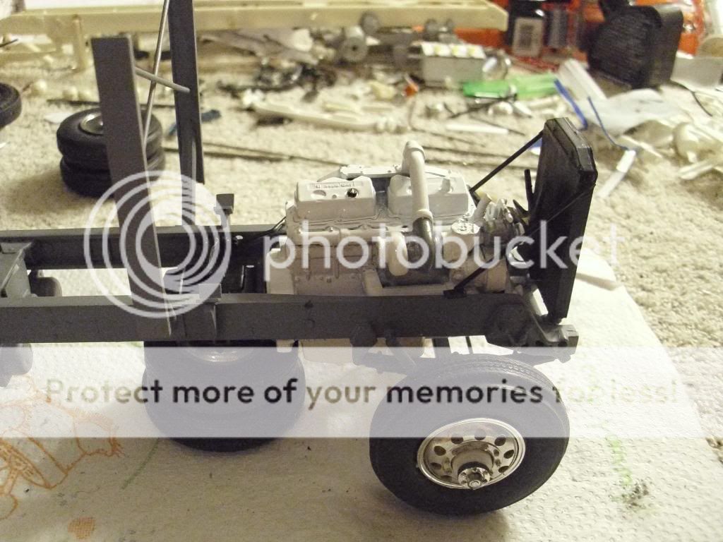

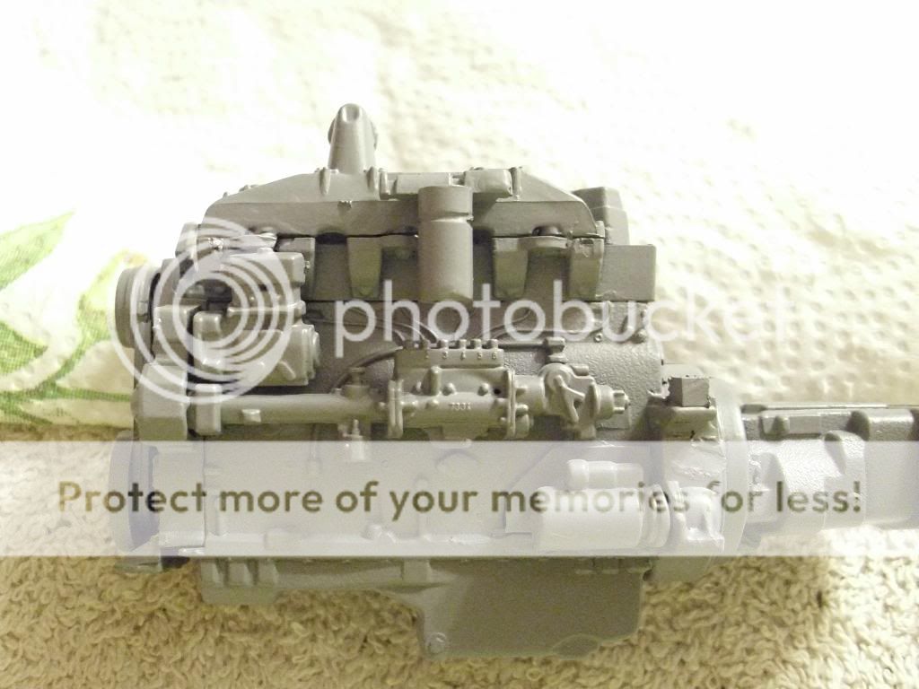

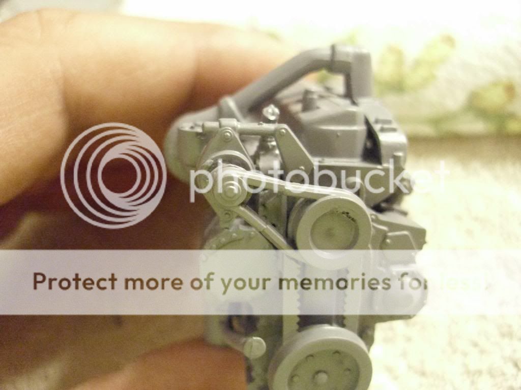

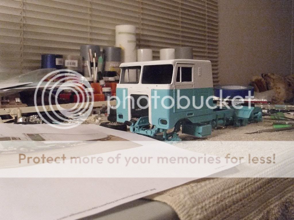

cowboysevens Posted January 19, 2011 Share Posted January 19, 2011 (edited) howdy yall i got this peterbilt 352 cabover off of ebay, it was a turnpiker turned pumper firetruck. so i decided to cleanit up and biuld a early 70's tom inman company truck out of it. my grandpa and dad drove for tom inman till he went out of biusiness around 1982. i am using a pete 359 frame, its a lil long but i think it will be just fine. any hints and reminders please let me know. thanks here is a picture i found on hanks site: i am using the 3406 cat out of the revell snap kit so i had to move the alternator, change the huge starter for a smaller one and make a new motor mount so it would fit i got the cab takin apart, paint off and the first coat of primer for body work. i also cut and made my own steerabal front end. remember ive been out of modeling almost 20 years so i could use some pointers and reminders, THANKS! Edited July 12, 2011 by cowboysevens Quote Link to comment Share on other sites More sharing options...

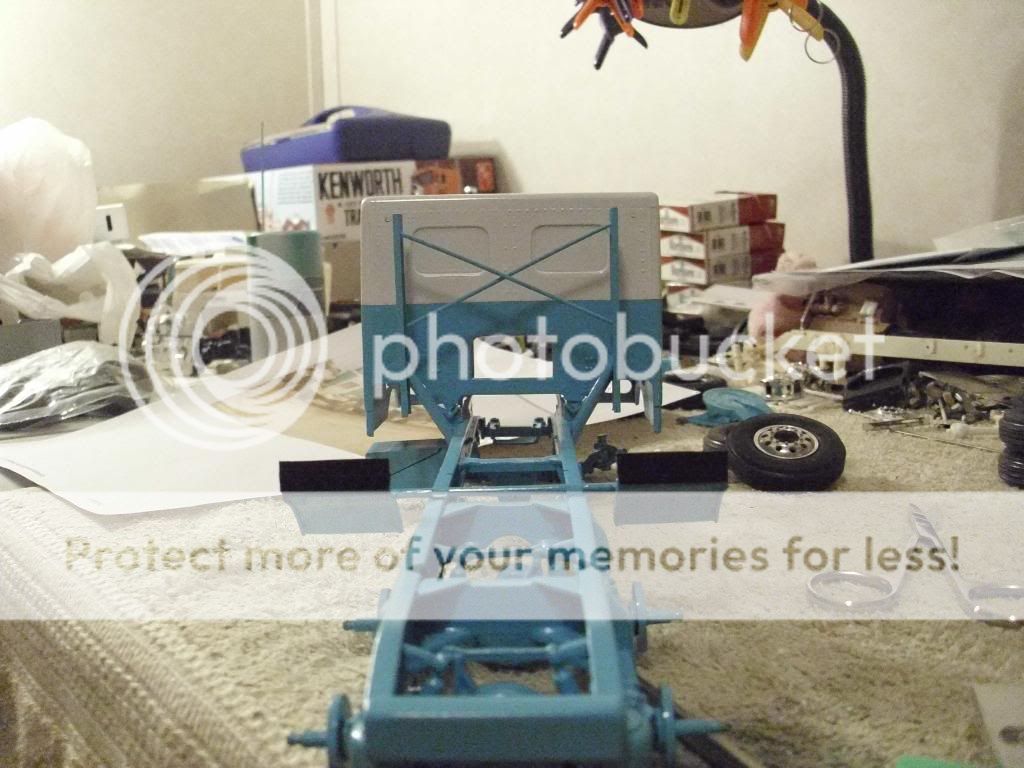

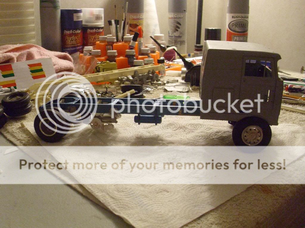

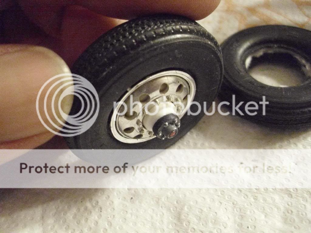

cowboysevens Posted January 19, 2011 Author Share Posted January 19, 2011 (edited) i got the motor all filed and filled and painted white. i made my own outer wheel seal style hubs, got the suspension and all the axles mounted, i had to make new cab mounts and got them on so the cab can rest on the frame now. Edited June 14, 2011 by cowboysevens Quote Link to comment Share on other sites More sharing options...

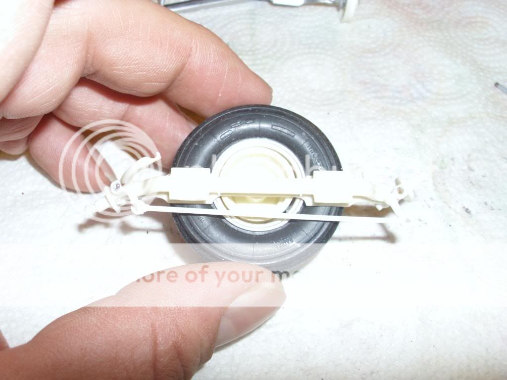

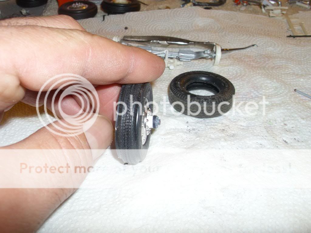

CDA Posted January 19, 2011 Share Posted January 19, 2011 Tose old style front hubs, looks like you just modified the rear ones correct? Did you narrow the front axle any? My Granddad drove an old Emeryville, it had a front axle like that. Quote Link to comment Share on other sites More sharing options...
cowboysevens Posted January 19, 2011 Author Share Posted January 19, 2011 Tose old style front hubs, looks like you just modified the rear ones correct? Did you narrow the front axle any? My Granddad drove an old Emeryville, it had a front axle like that. i used a shorter axle and i trimmed out some of the hub are inside of the brake drum so it will be more realestic. i used a front rim from the revell snap kit, cut out the hub oiler then took a trailer hub from amt and cut it down. i cut the face off of an amt rim and put the face of the revell rim on in, added the hub oiler to the hub and there it is. these style of hubs were used mostly on center steer axles if i remember right, with the wheels farther in it was easier to ster with out power steering. dennis Quote Link to comment Share on other sites More sharing options...

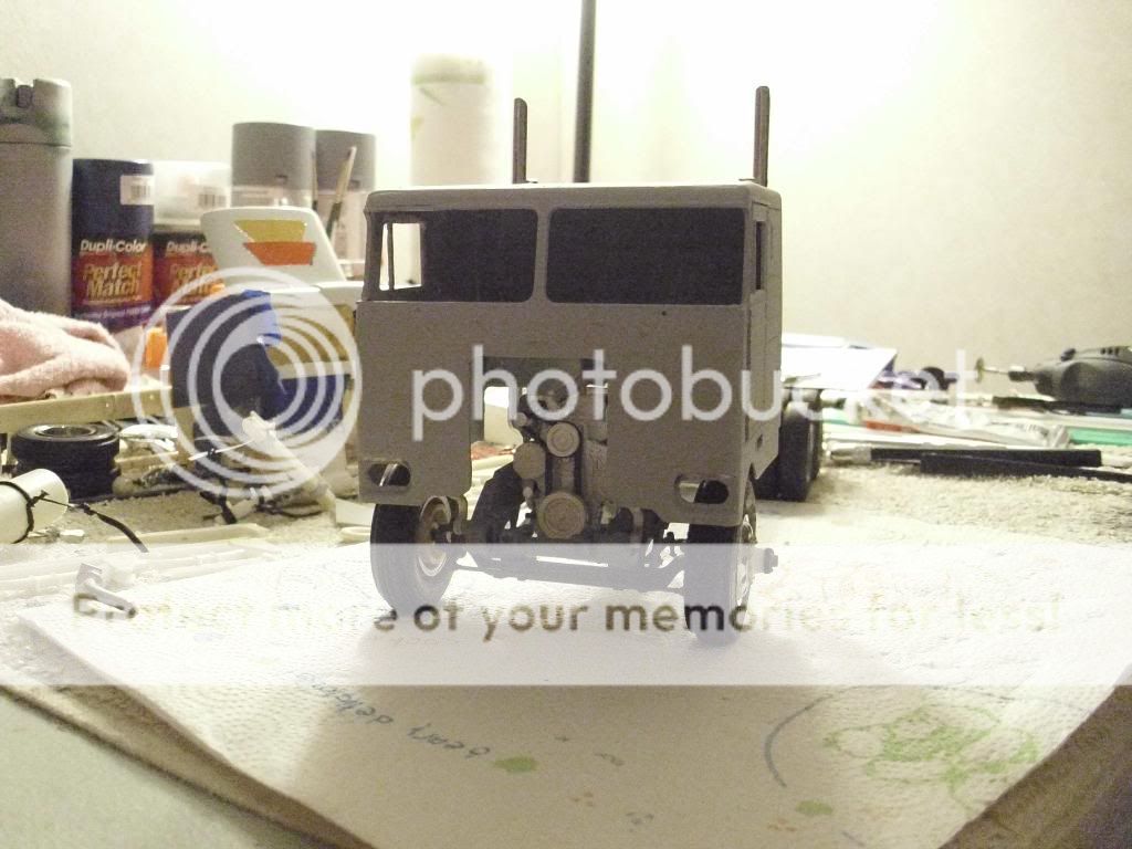

cowboysevens Posted January 19, 2011 Author Share Posted January 19, 2011 Looks like a cool project Dennis. Just something to be aware of you may have some fitment problems with the interior bucket over the Cat motor. I converted a 352 with that engine and did have some issues with the turbo side and intake piping. Leo you are right there leo, lol since i biult that 4300 and didnt find out the front axle set back to far untill the end....... well im pre fittin everything now. i allready made the adjustments , she is tight but she fits now lol. thanks Quote Link to comment Share on other sites More sharing options...

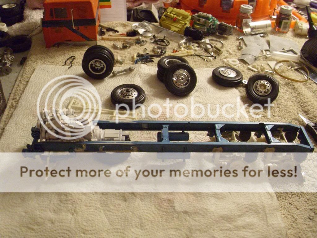

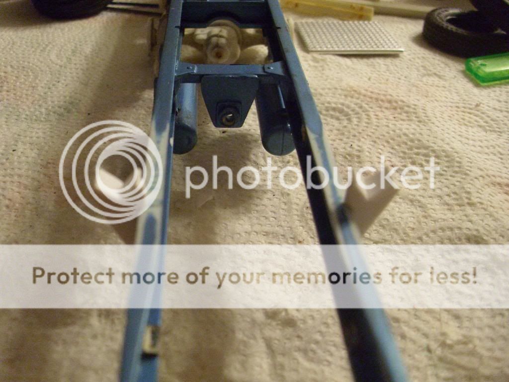

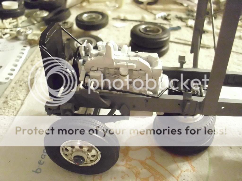

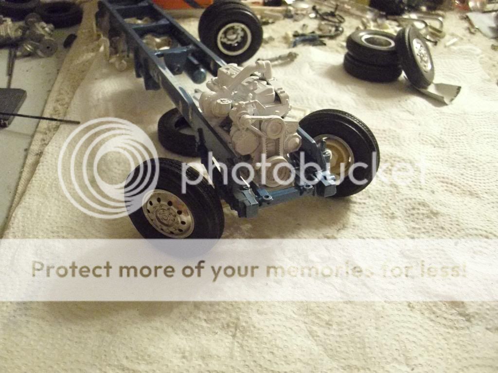

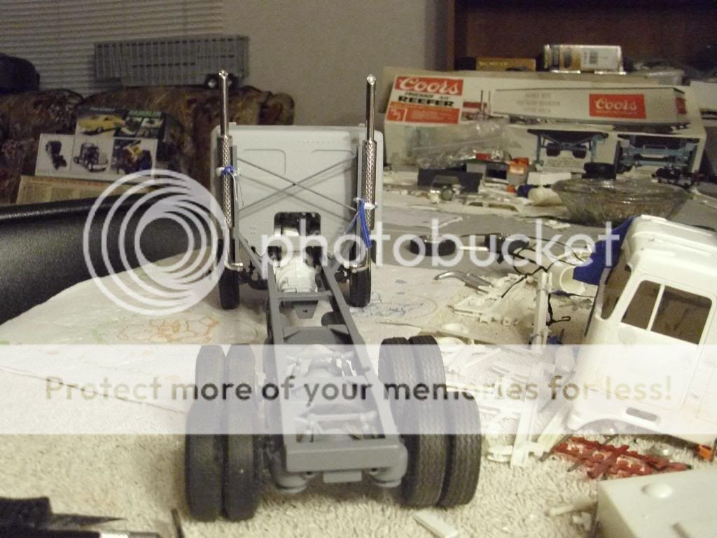

cowboysevens Posted January 21, 2011 Author Share Posted January 21, 2011 here is an update, i got the motor trimmed up and painted hit, the frame is all complete and primed for paint, i got primer on the cab and ready for a lil body work also made the "old school" exhaust rack. i also started the reefer , i will post some pics of it later after i get some primer on . Quote Link to comment Share on other sites More sharing options...
mackinac359 Posted January 22, 2011 Share Posted January 22, 2011 With the longer frame, you could fill the space with some longer fuel tanks. Or extra Pete style tanks. The AMT kit tanks might look too small with the long wheelbase. Tim Quote Link to comment Share on other sites More sharing options...
cowboysevens Posted January 22, 2011 Author Share Posted January 22, 2011 With the longer frame, you could fill the space with some longer fuel tanks. Or extra Pete style tanks. The AMT kit tanks might look too small with the long wheelbase. Tim i got a set of old white tanks im thinkin about using, i think they would fill the lil gap and look more like the ones in the picture. if they dont work out then its hello pvc lol Quote Link to comment Share on other sites More sharing options...

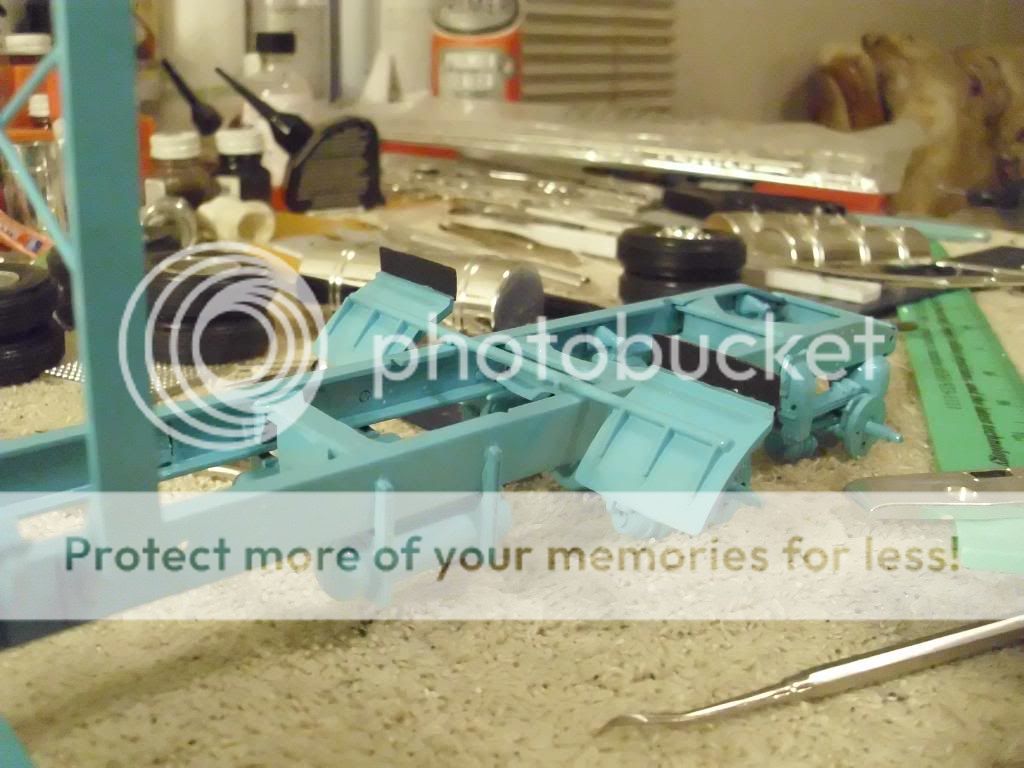

cowboysevens Posted February 18, 2011 Author Share Posted February 18, 2011 small update : i got the 3406 motor painted white and the radiator and scratch built radiator supports painted, also cut down the wheel hub a lil more. slowly but surely lol !! Quote Link to comment Share on other sites More sharing options...

Wagoneer81 Posted February 20, 2011 Share Posted February 20, 2011 Looking good, D! That's a nice wheel base, should make for a smooth ride! I'm looking forward to seeing more! Quote Link to comment Share on other sites More sharing options...
Mr mopar Posted February 20, 2011 Share Posted February 20, 2011 Nice work Dennis like the stack supports and the longer frame sweeeeeet. Doug Quote Link to comment Share on other sites More sharing options...

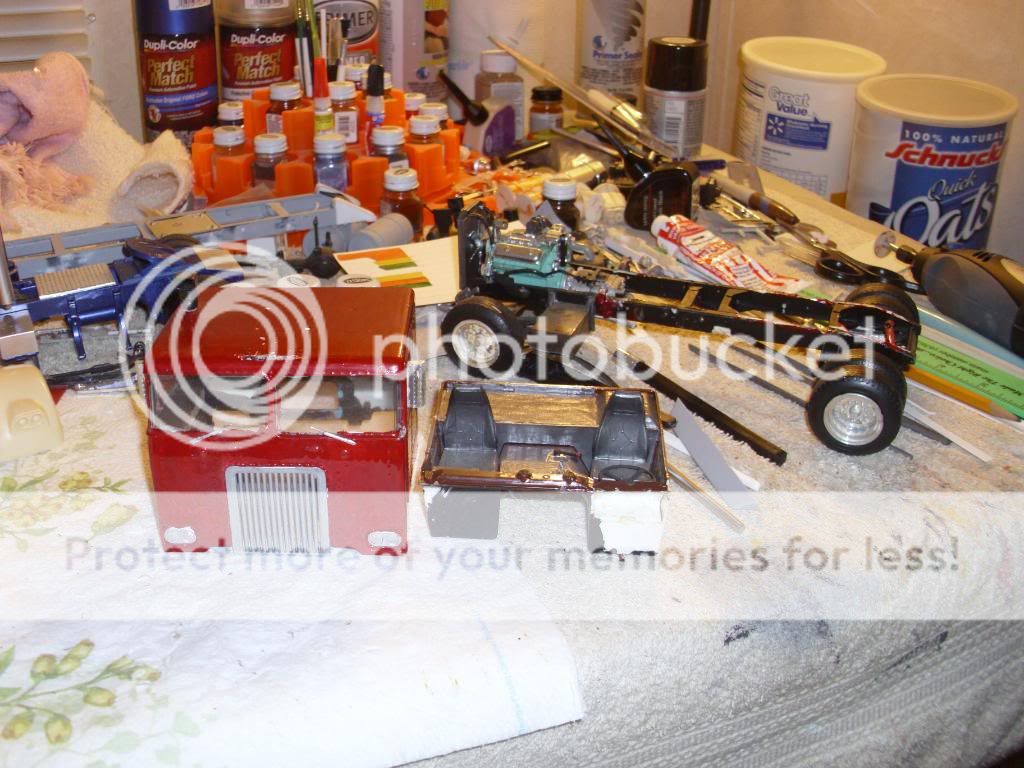

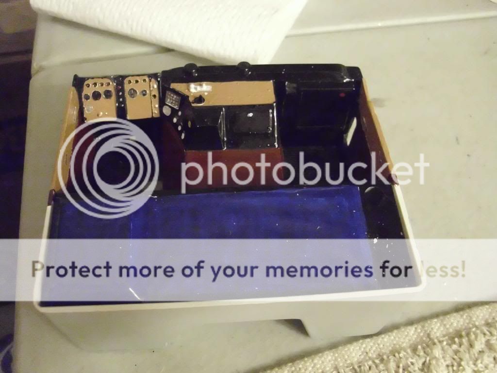

cowboysevens Posted March 5, 2011 Author Share Posted March 5, 2011 i got the interior bucket painted, still need to add the seats and steering whell and have some touchin up to do, i might change the color of the bedding Quote Link to comment Share on other sites More sharing options...
Kodiak Island Modeler Posted March 5, 2011 Share Posted March 5, 2011 It's looking good so far. Thanks for showing all the great detail shots. Quote Link to comment Share on other sites More sharing options...

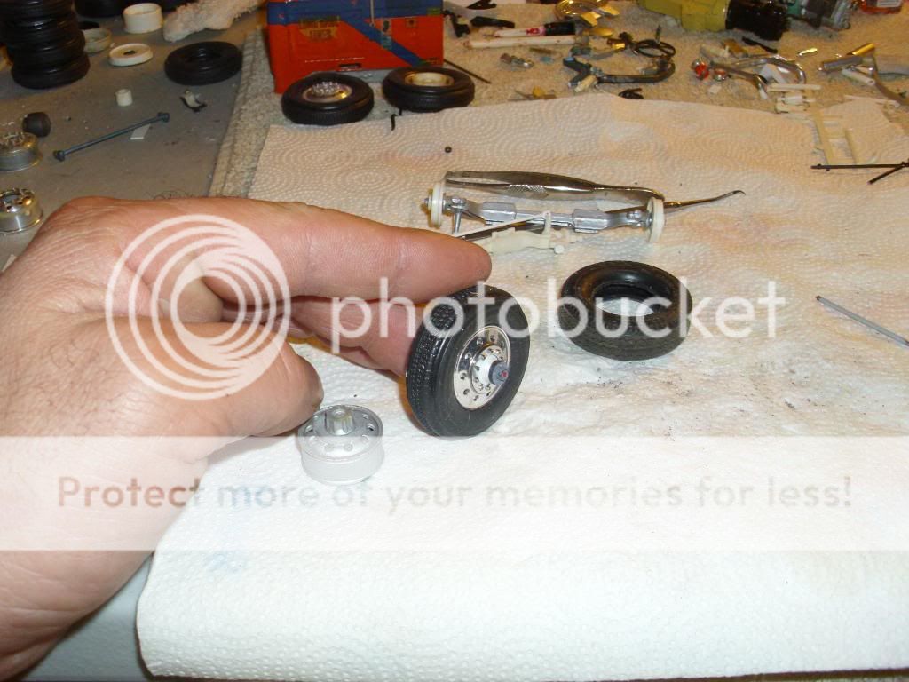

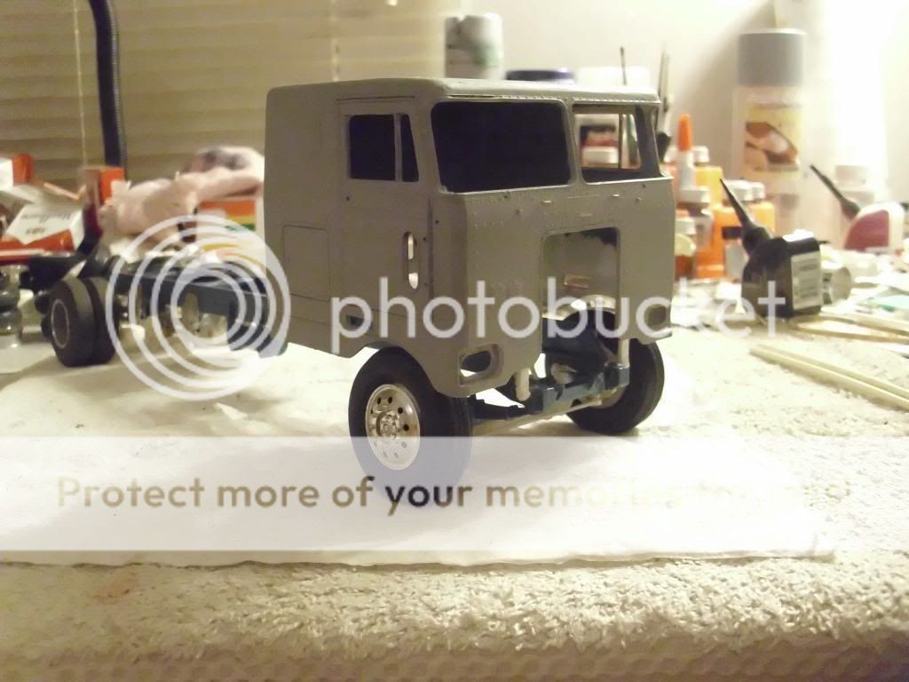

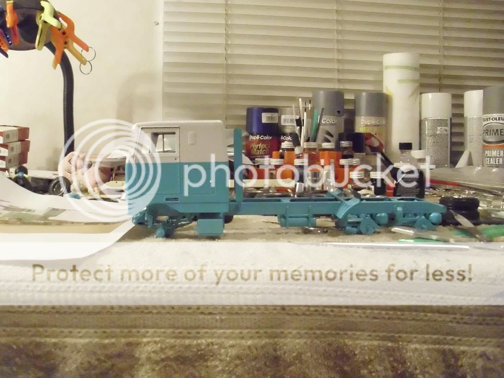

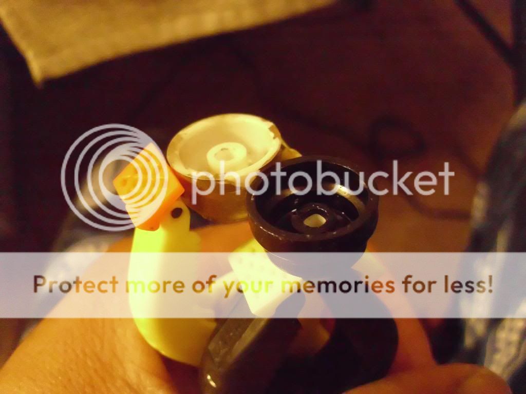

cowboysevens Posted May 29, 2011 Author Share Posted May 29, 2011 well i got a couple small things done today, a lil paint on the cab , mudflaps on the quarter fenders and the front drum inner mounts cut back and painted. lol slowly but surely ;D ;D ;D heres a pic of a stock front drum next to the modified one for the center steering look Quote Link to comment Share on other sites More sharing options...
