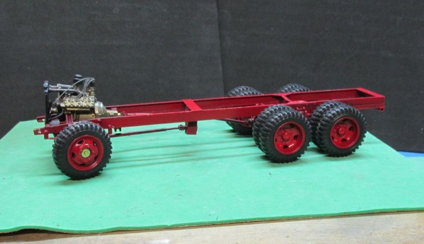

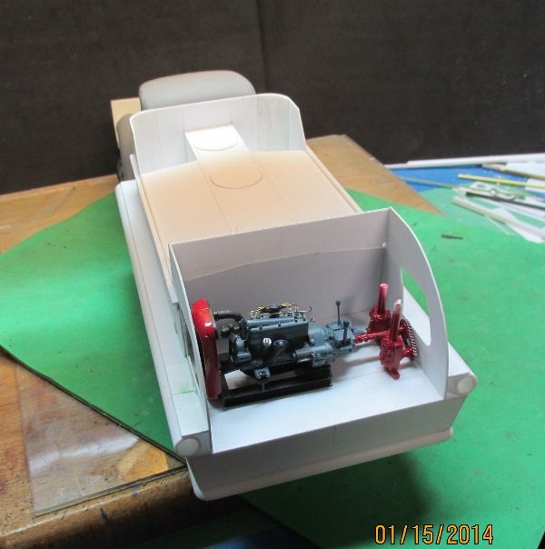

Chariots of Fire Posted January 15, 2014 Author Share Posted January 15, 2014 I got some work done on the engine and pumps for the rear also. This rig had two pumps, both powered by the Ford Model B engine. One from a direct shaft and sprocket and chain mechanism and the other from a takeoff unit attached to the side of the transmission. Lots of plumbing to be done on this rig! Quote Link to comment Share on other sites More sharing options...

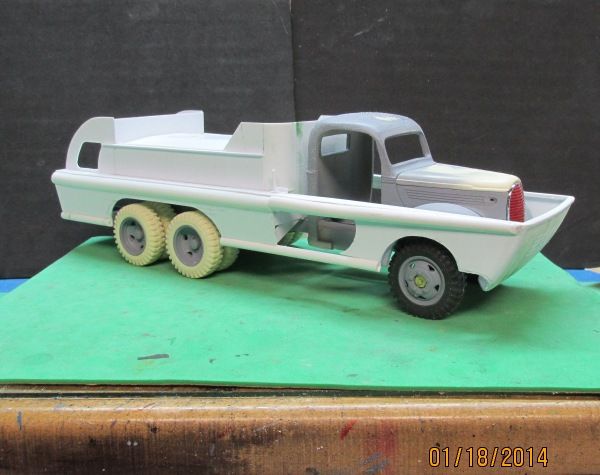

Chariots of Fire Posted January 19, 2014 Author Share Posted January 19, 2014 Here's an update on progress with the project. The front crowder plate has been mated to the sides temporarily. Once completed, the side rails opposite the doors will be cut free and will be hinged at the back end. For now things are just in place for fitting purposes. Quote Link to comment Share on other sites More sharing options...

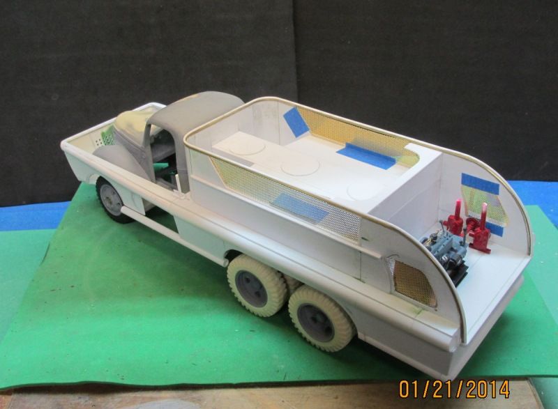

Chariots of Fire Posted January 22, 2014 Author Share Posted January 22, 2014 Now that KS has stopped providing brass mesh I needed to find a new supplier. I found one in England called Scale Link Limited that has sheets of diamond pattern, and square pattern in a variety of sizes. I chose the thin diamond mesh for this rig and cut some strips to add to the body sides. They will be painted separate from the body so that the primer coat and color coats won't fill in the holes. They are quite small. Anyway here is the rig with the mesh taped in place just to see how it looks. There is a douple pipe rail on top of the body, I suppose doubled up to give it more stiffness without the piping being oversized. I used brass for the first one to give the body sides stiffness as well and to provide better support for the brass mesh. Over that I glued a piece of plastic rod of the same diameter. Quote Link to comment Share on other sites More sharing options...

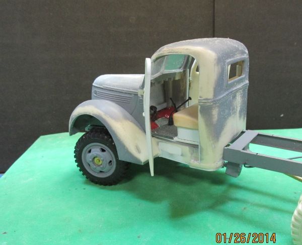

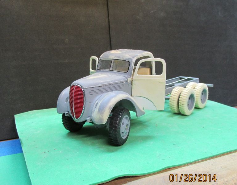

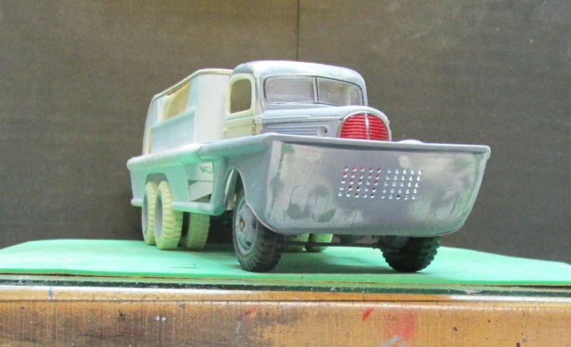

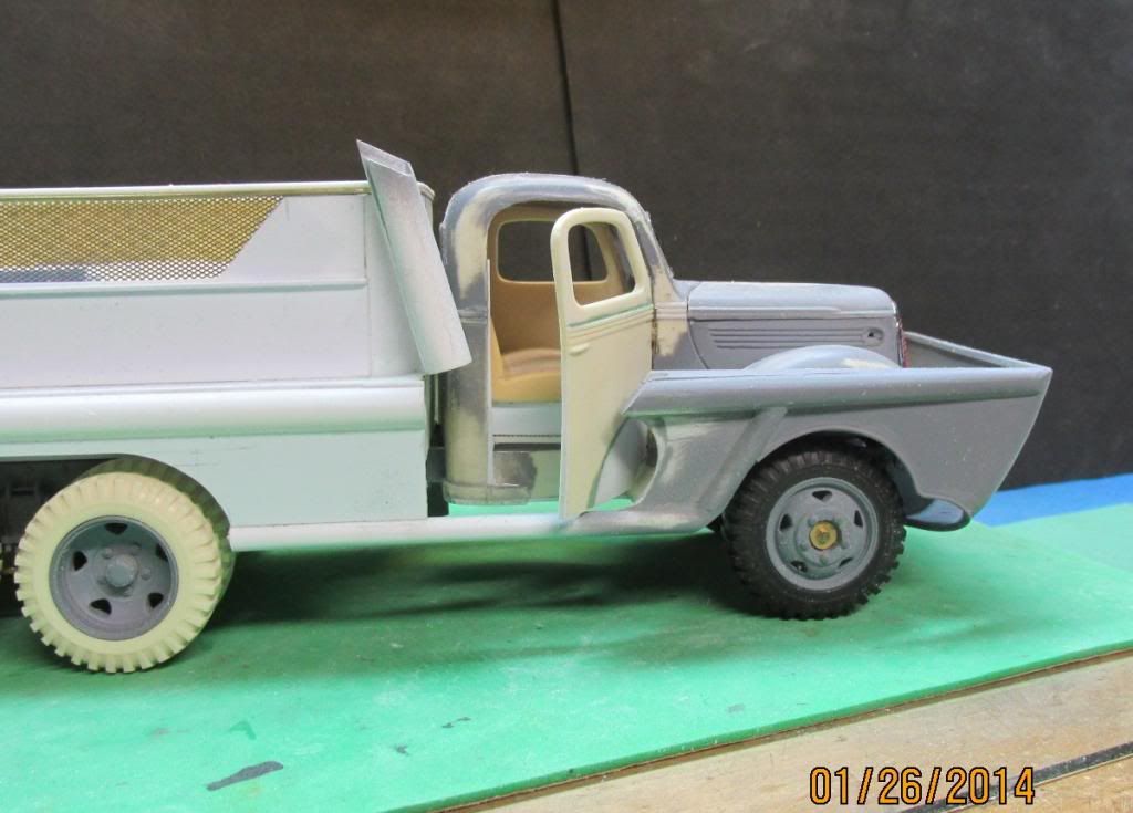

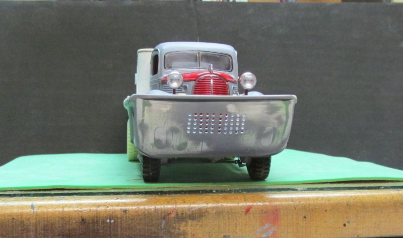

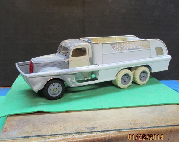

Chariots of Fire Posted January 26, 2014 Author Share Posted January 26, 2014 After much tinkering and fitting, I got the doors to open and close on the cab. I used small "H" hinges and superglued them in place. Small pins were pushed into the edges of the door to help hold them solid. The heads of the pins were ground down to make sure there was clearance and no binding when the doors are closed. Here's the body back on the truck with the side bar open and the door open. And with the door closed and the bar back down in position. And if you were a tree standing in the woods and the truck was coming at you to knock you over, this is the view you would get! Quote Link to comment Share on other sites More sharing options...

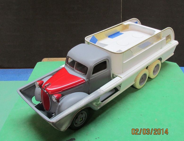

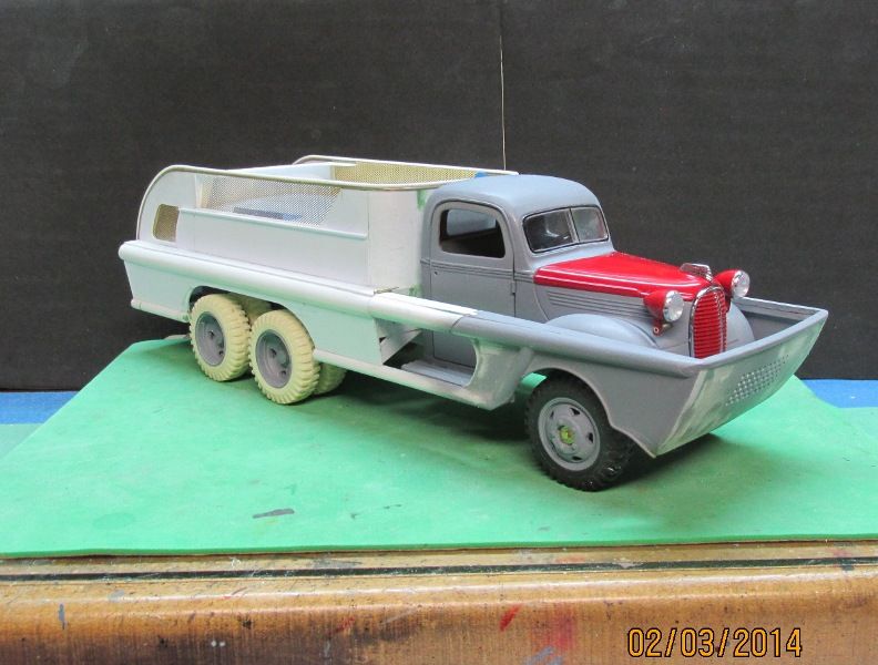

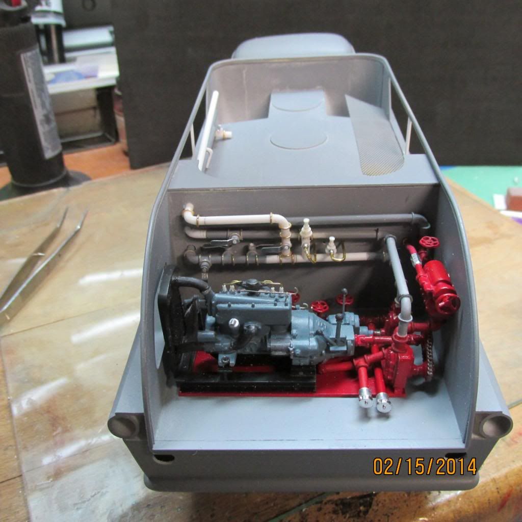

Chariots of Fire Posted February 4, 2014 Author Share Posted February 4, 2014 Since the last post I've been doing some cleanup and a bit of finish work. Now that the doors are done and fit some work on the interior was begun. The dashboard is complete, a seat was finished and weathered and the floorboards are done. The headlights came from a '37 Ford p/u kit. Instead of installing them on the fenders where they would be useless the builders of the actual truck mounted them high and on a pivot that would allow them to be tilted down out of the way when travelling in the woods. Not much good however, if you are chasing hot spots in the woods at night! Quote Link to comment Share on other sites More sharing options...

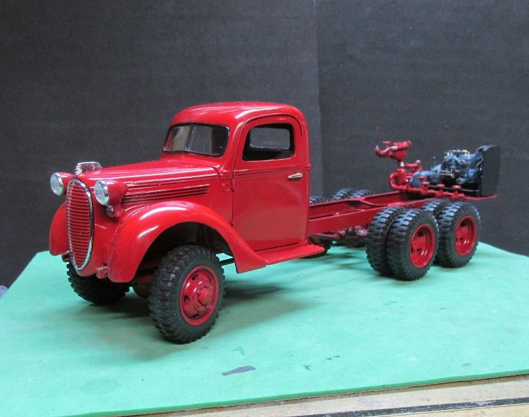

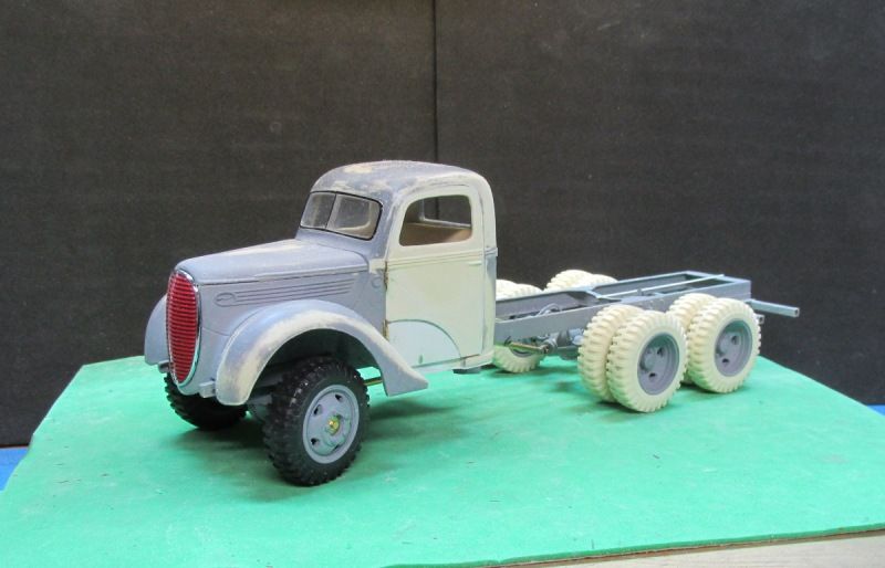

Chariots of Fire Posted February 19, 2014 Author Share Posted February 19, 2014 Got a bit more done on the rig. Chassis and cab now in paint. Still working on the body and some of the detail. But it's getting there! Quote Link to comment Share on other sites More sharing options...
