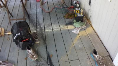

midnightsteele Posted October 1, 2014 Share Posted October 1, 2014 (edited) I am new to the decanting process but it sounded like a pretty simple task. I did my research and followed the instructions of a few videos and how-to's. Shake the bottle a little every fifteen or so minutes to aid in the decanting process they said. These bottles were only half full. Luckily I had enough common sense to make sure they weren't in direct line of fire of my face and I had eye pro on. If its important enough to do, its important enough to wait it out. Just let them sit... Edited October 1, 2014 by midnightsteele Quote Link to comment Share on other sites More sharing options...

midnightsteele Posted October 2, 2014 Author Share Posted October 2, 2014 I used the bendy straw method. This happened after the paint sat in the secondary container for 15 minutes. I had no issues getting the paint from the rattle can into the secondary containers. None at all. After the paint sat for 15 minutes, I gently shook the open container and that's when they spewed. I actually only shook one. When it started spinning like a loose rogue oxygen cylinder, it knocked the other one over. Quite an experience I must say. It hasn't deterred me from doing it again but I'm not touching them for about three hours the next time. Yes I left the containers open after transferring from the rattle can as per instructions. I just have BLAH_BLAH_BLAH_BLAH luck lol Quote Link to comment Share on other sites More sharing options...
midnightsteele Posted October 2, 2014 Author Share Posted October 2, 2014 OK I didn't type blah blah blah but didn't use swear words either. Strange... I checked the third bottle. Shook it in the yard and nooooooo issues. I will be retrying the other ones now. Total steep time was about two and a half hours. Quote Link to comment Share on other sites More sharing options...

935k3 Posted October 2, 2014 Share Posted October 2, 2014 (edited) I bet this was Tamiya TS paints. Some colors are worse then others of causing this. I let them sit an hour or so then gently insert(no stirring) a mixing stick slowly and see if it bubbles. If it does it needs more time. I found TS-13 clear to be the worst offender. I usually use the 1 oz Badger jar and hold it at an angle , I lightly push down on the paint nozzle and spray directly into the jar. Another way is to find a place that sells the paper cone drinking cups(see pic below) and use them as a funnel to spray into the jar. Edited October 2, 2014 by 935k3 Quote Link to comment Share on other sites More sharing options...

midnightsteele Posted October 2, 2014 Author Share Posted October 2, 2014 The paint was Krylon gold. This incident happened after I transferred the paint from the rattle can to the open bottle. I taped a bendy straw to the spray nozzle and used cellophane to cover the top of the bottle. I stopped when my bottle was half full. I let it sit for about 15 minutes while I occupied my time trying to smoke a cigarette and chasing my weenie dog around the front yard because he didn't want to go back in the house. When I picked up my half full bottle of gold and gently shook it, it literally shot out of my hand and straight into the other half bottle of Krylon flat black I was also decanting. That one, once struck by the bottle of gold, also wanted to go projectile lol. Luckily neither of them hit the bottle of primer I had sitting. After two and a half hours, the primer was good to go and is now closed. It was quite the hoodoo and my landlord (lives right next door mind you) is going to be upset to say the least. I will have to paint the whole porch and part of the front of the house. Tomorrow I'm gonna do it again lol... Quote Link to comment Share on other sites More sharing options...
Mike Kucaba Posted October 2, 2014 Share Posted October 2, 2014 I always tape off the area when I decant cans with plastic. I also cut a hole in a large plastic bag and pull it over myself in case of a miscue Before pouring the paint into a bottle let them sit a while then pour into a glass jar and lightly put the cap on and gently shake bottle then release the cap. There is alot of propellant in those paints! The safest way to get paint out of spray cans though is to get those tubes that are nozzle extenders and drill out the tip so the tube fits, then epoxy in place. I have some tips set-up for a Testor's type valve and some for Tamiya's. Happy de-canting Quote Link to comment Share on other sites More sharing options...
midnightsteele Posted October 2, 2014 Author Share Posted October 2, 2014 Yeah I learned a valuable lesson today. First time out of the shoot. Next time I'm just going to let them steep for a couple hours. I was just going off the advice of one of the videos I watched that said if you shake it a little every 15 minutes or so it would speed up the process. I'm just going to try a little more patience lol James Quote Link to comment Share on other sites More sharing options...

Pete J. Posted October 2, 2014 Share Posted October 2, 2014 (edited) Ah, now I see the problem. I always decant the paints in the evening and let it sit over night. There is often still gas dissolved in the paint even then. A friend of mine did a worse thing. He decanted the paint into a small glass paint jar and closed the lid tight. The next day he shook it to mix the paint and when he opened the jar he instantly painted his laundry room and himself a nice bright green! You have to let the dissolved propellant have a chance to get out of the paint. Edited October 2, 2014 by Pete J. Quote Link to comment Share on other sites More sharing options...
