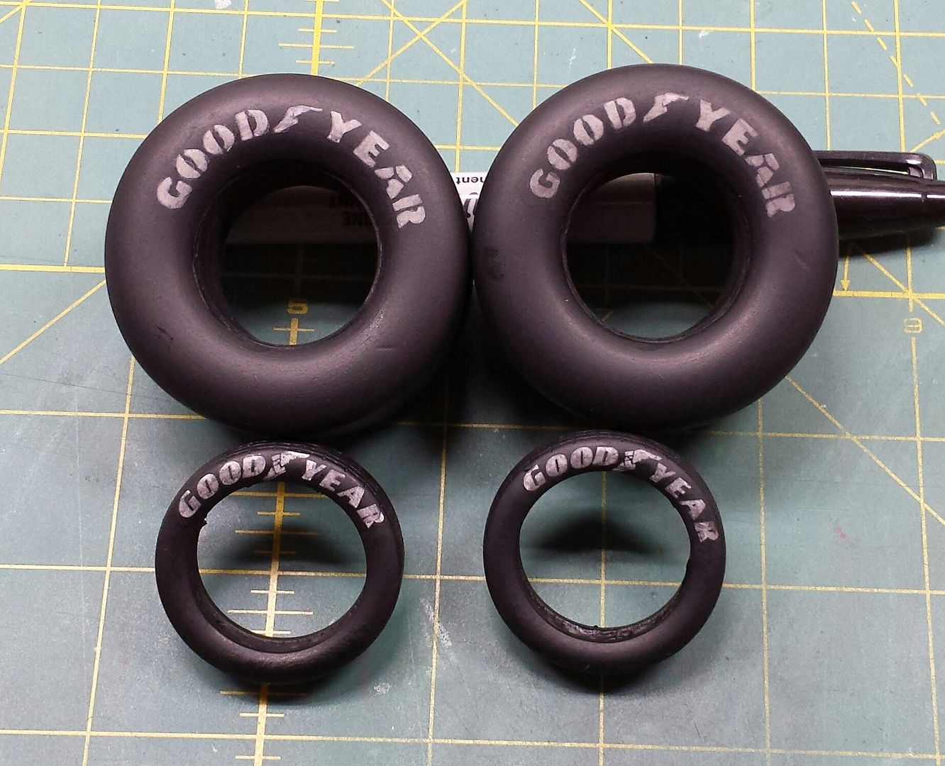

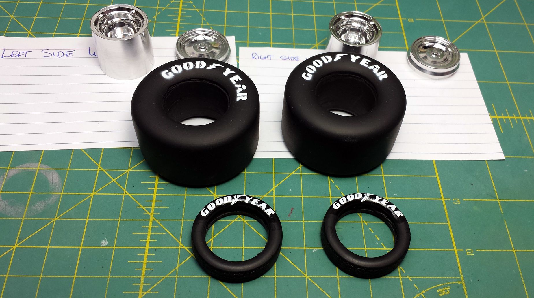

Mooneyzs Posted May 4, 2017 Author Share Posted May 4, 2017 (edited) Alright fellas... this should be a pretty big update with the multiple files I am going to be uploading. Again I am sorry about the quality of some of the pics... Let me get to uploading pics... So my adventure began with trying to finish this build starting with the wheels and tires, I polished the Aluminum rims that Jim from Micro Nitro made for me. Then the Tires I painted with the Technique that John Teresi taught me a while back using some Folk Art paints. After painting the rubber tires black, I used a stencil that I picked up and painted on the Goodyear using a white Folk Art Paint: I then added the goodyear deals to the front tire: Next, I weathered the tires: Then I got the tires mounted onto the rims: I then decided to work on the butterfly shaft for the injector hat, started by notching some tube that would lay flat against the Photo-Etch Butterflies I got from Scott at Future Attraction, after Notching the tube I took the butterflies and transfer drilled the holes into the shaft with a .016" drill bit for the mounting rivets: Edited May 4, 2017 by Mooneyzs Quote Link to comment Share on other sites More sharing options...

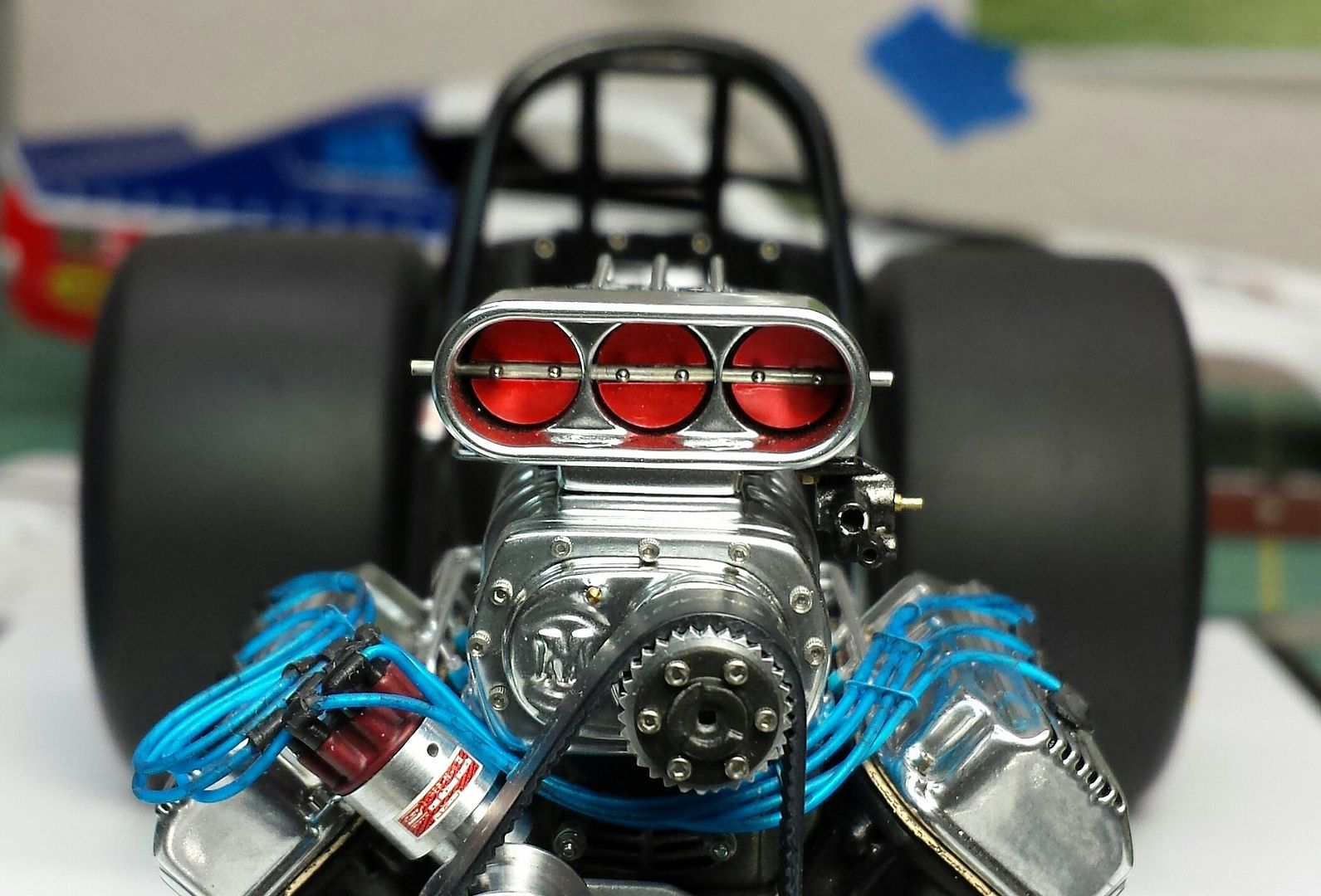

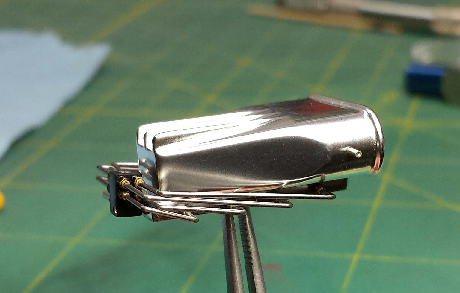

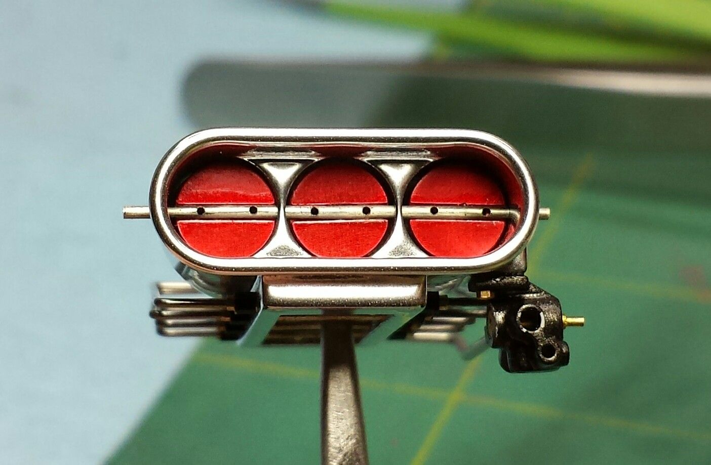

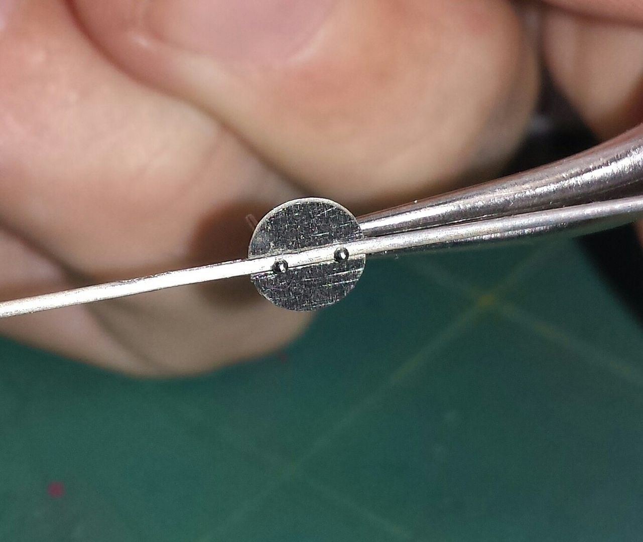

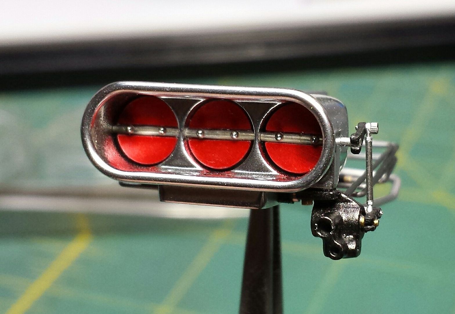

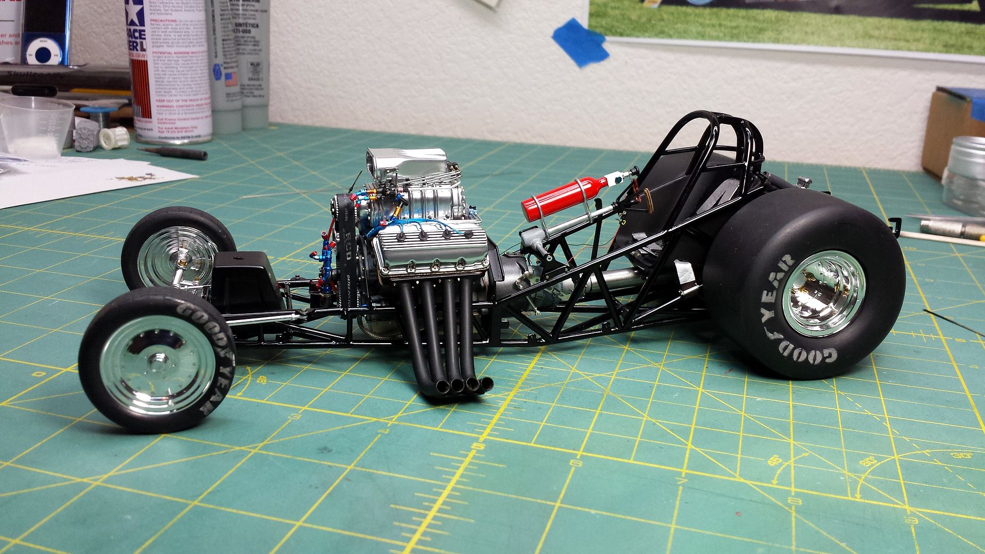

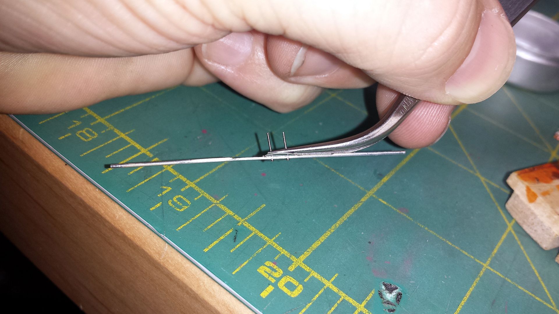

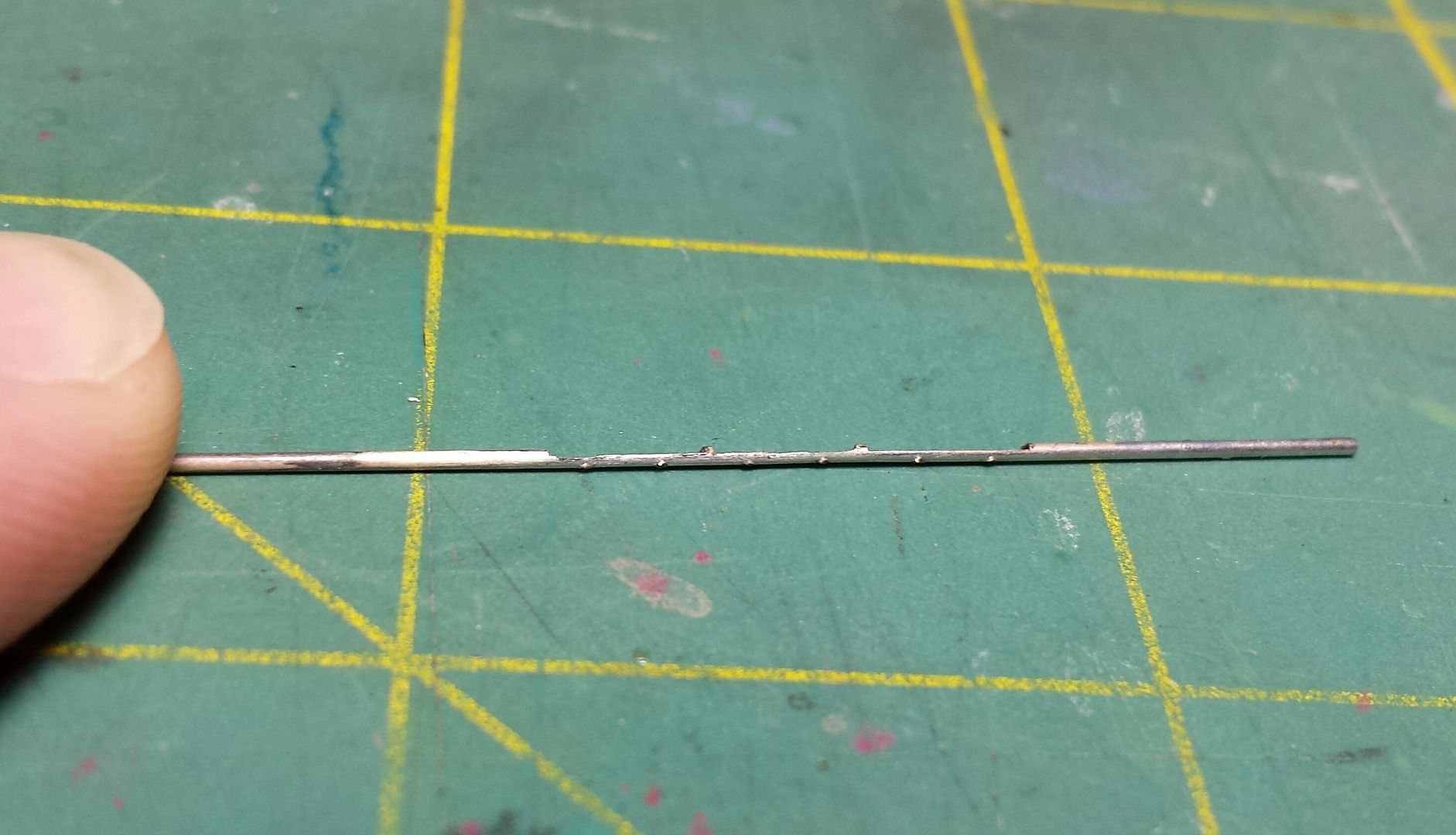

Mooneyzs Posted May 4, 2017 Author Share Posted May 4, 2017 After getting the notches into the butterfly shaft I had to check the fit with the butterfly: I decided that I wanted to see the tires mounted on the chassis to see what the rolling chassis would look like: I got the butterflies painted with Mr. Hobby clear red and mounted the butterflies into the injector hat that was painted with Alclad's Polished Aluminum I then added the rivets to the butterfly shaft: I had to mock the injector hat up on the engine to take a look and see how it looked sitting on the engine. I this pic you can also see the starter engagement the I designed and drew up with my CAD software and then had it 3D printed, painted and installed it with the hardware: Quote Link to comment Share on other sites More sharing options...

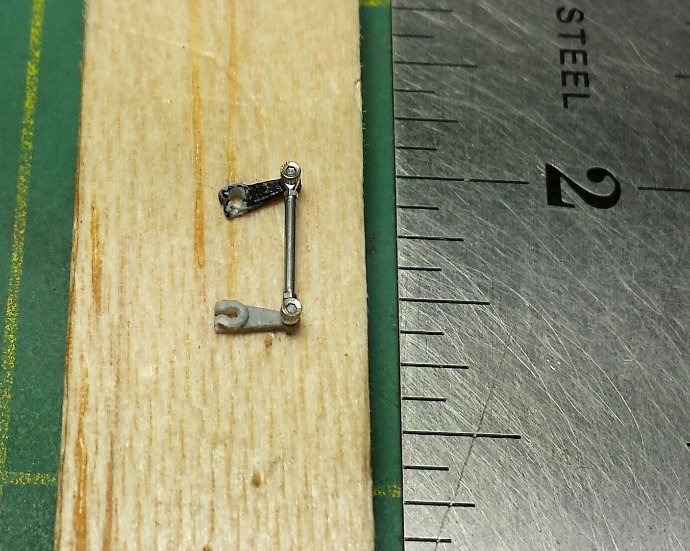

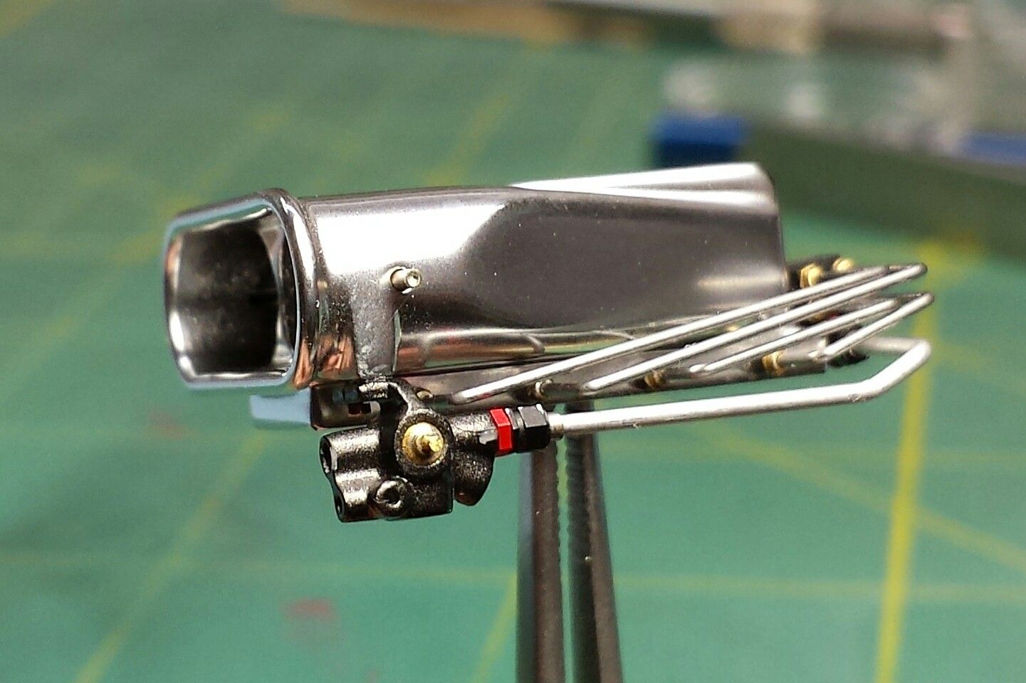

Mooneyzs Posted May 4, 2017 Author Share Posted May 4, 2017 It was time to tackle the plumbing nightmare on the injector hat. some of it fought me for a bit but I was able to get it completed. The K-Style Barrel Valve and Fuel Distribution Block were drawn up and 3D Printed. All of the injector lines were bent from .020" piano wire. All of the Black nuts were from RB Motion that I drilled out so they would slide over some .03125" brass tubing to represent the sleeve in a flared tube fitting: I made the linkages drawing them up and having them 3D printed, then I used RB Motions smallest (part #1500) Rod Ends to create the connecting linkages from the Barrel Valve to the Injector Hat: I attached the linkages to the Injector Hat: Quote Link to comment Share on other sites More sharing options...

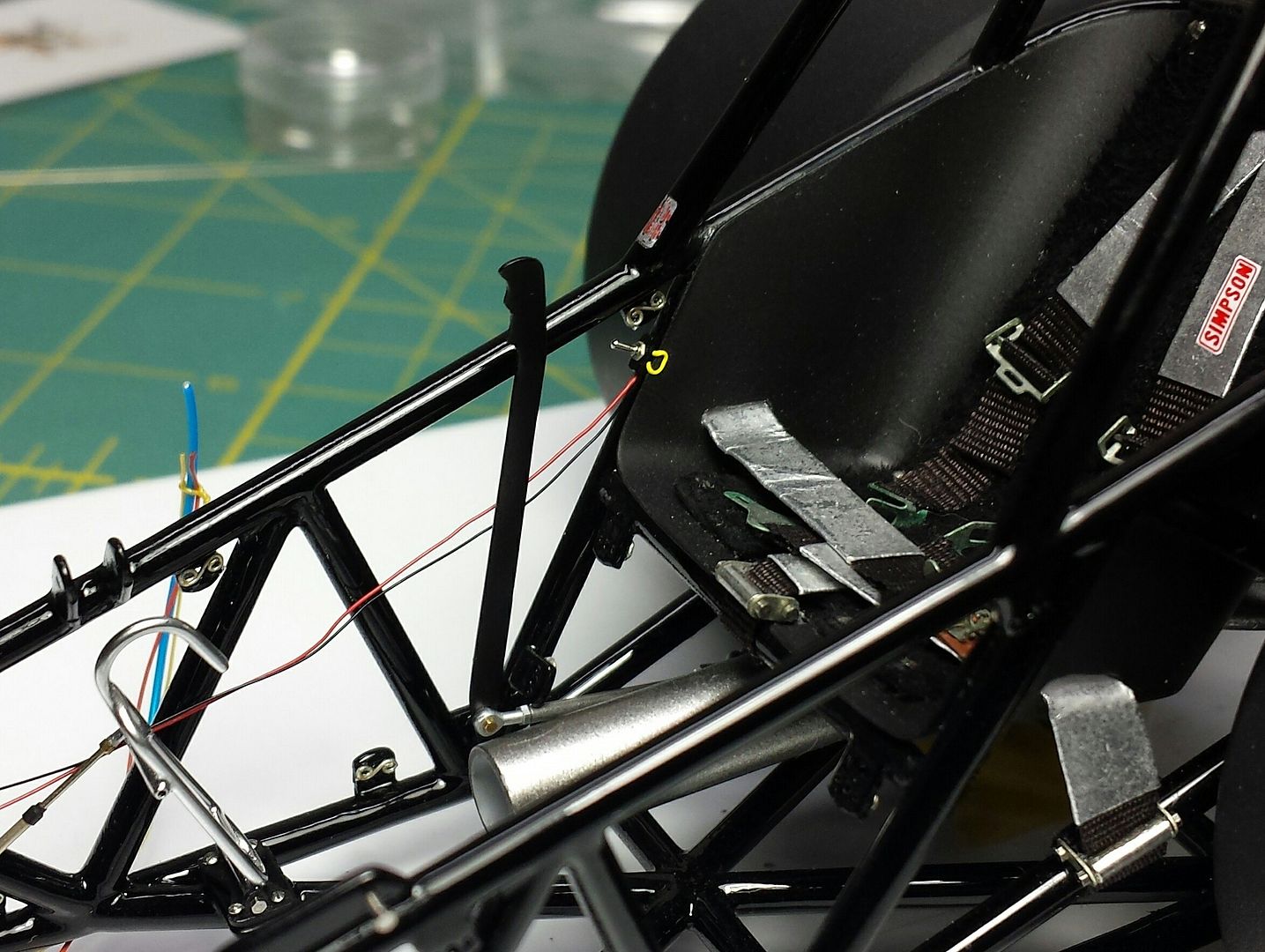

Mooneyzs Posted May 4, 2017 Author Share Posted May 4, 2017 (edited) I worked on getting the gas peddle mounted and installed. The gas pedal was painted with Alclad Chrome. I made the Morse throttle cable from some pvc tubing, tubing, rod and RB Motion distributor cap boots for 1/16th scale and 1/25th scale for the rubber boots. I also made a connecting link that attached to the gad peddle: I got the toggle switch glued in place that was fabricated a while back from scratch building the base and using a Top Studio Toggle Switch photo etch set. Along with getting the brake handle mounted in place: Here is a mock up of the car and how it went to GSL. As I mentioned before Time got the best of me and there just wasn't enough time in the days to get it done for the show, which was ok. I underestimated the amount of time that I would need to finish it: Edited May 4, 2017 by Mooneyzs Quote Link to comment Share on other sites More sharing options...

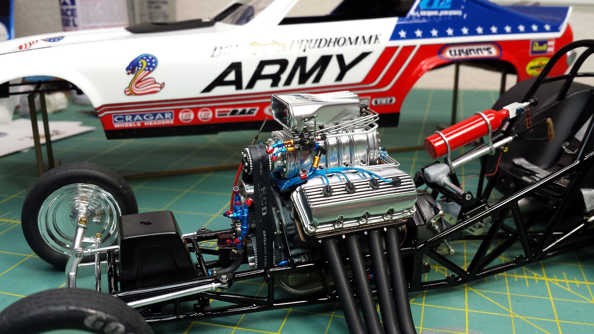

SteveV Posted May 5, 2017 Share Posted May 5, 2017 That last image, the one with the engine in full trim and the ARMY Vega shell in the background, made my eyes water, what a piece of art! I've quietly sat and watched this happen for years and years with you and everyone else here... bravo ! I'm an illustrator of anything automotive, and drag racing in particular, but I've never seen detail like that, and I do detail for a living. Quote Link to comment Share on other sites More sharing options...
