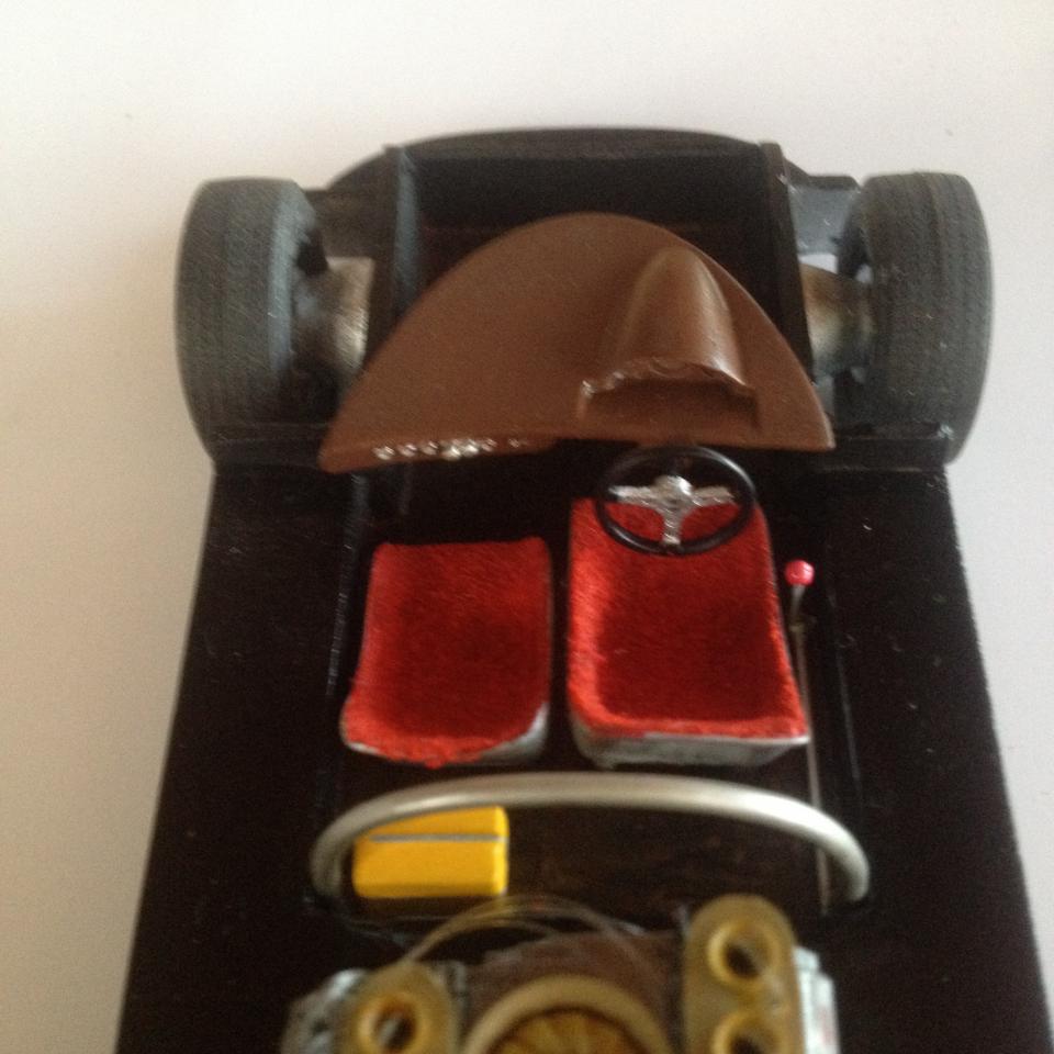

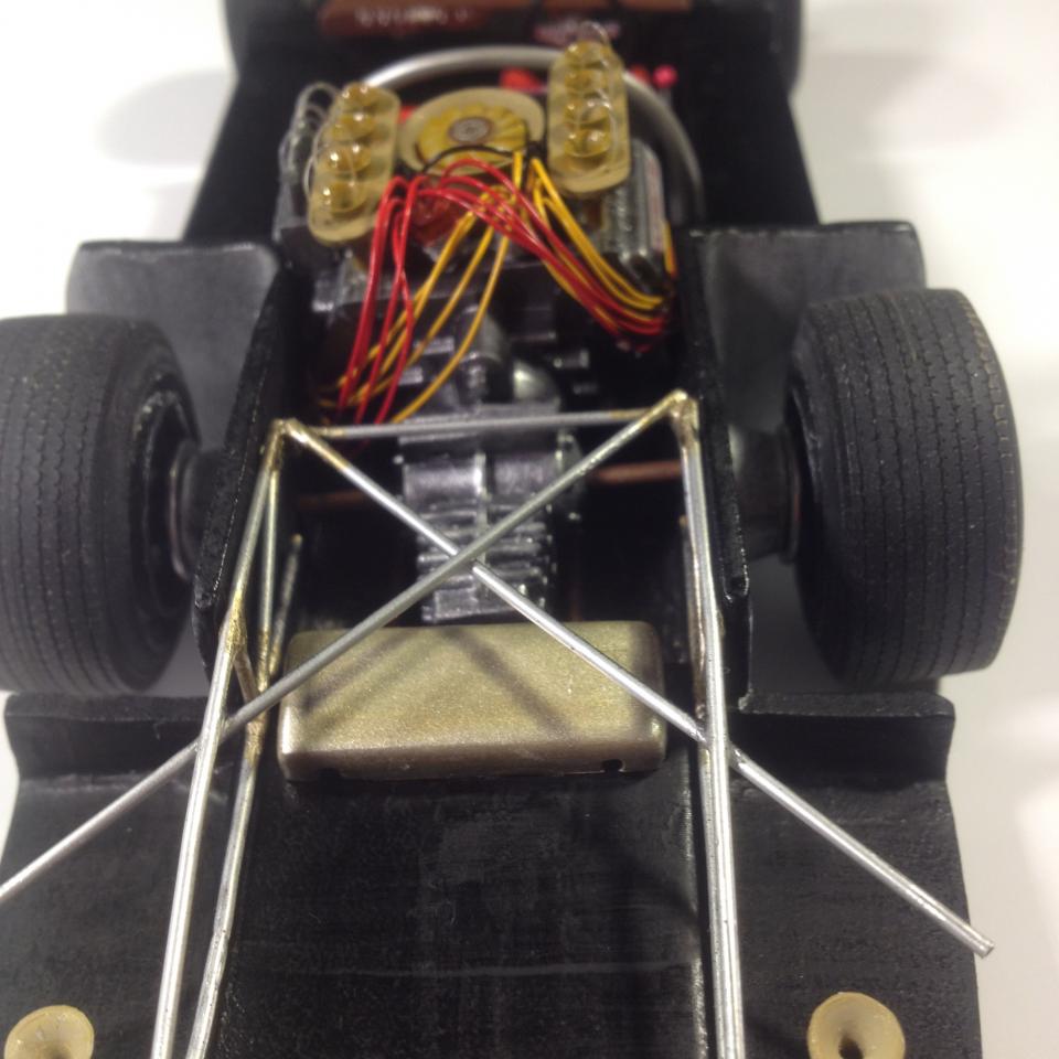

First, I'd like to apologize in advance to any one who may find offense with what I did to Paul's beautiful kit. I took way too many liberties and in short, bit off more then I could chew being my first build ever.
Boy did I learn a lot, felt and still feels like a crash course. All in all I'm happy with having both learnt alot and built this with my own hands.
Many thanks to just about every one here as I've found inspiration and gold nuggets in your posts.
I spent 3/4 of the time stripping, dissasembling and painting about 1/2 a dozen times. Had many melt downs and tragedies but I finally managed to get this far. I'm putting the model down for a bit and moving on as I'm burned out on it.
Things that stand out most in no particular order are;
1) Primer is very critical to an order of magnitude as it dictates how the paint will lay down, flow and look.
* I used cheap primer with disastrous results.
2) Be patient and let the paint fully cure.
* I smeared/pulled paint off before it fully dried.
3) Test fit everything and I mean everything before applying glue/paint.
* Speaks for itself.
4) NEW, don't mess with non hobby clear gloss coat unless its been used here with success.
Its funny, these things have been discussed ad nosium but I still repeated the mistakes. A poor student of history indeed.
Critisims and comments are very welcome.

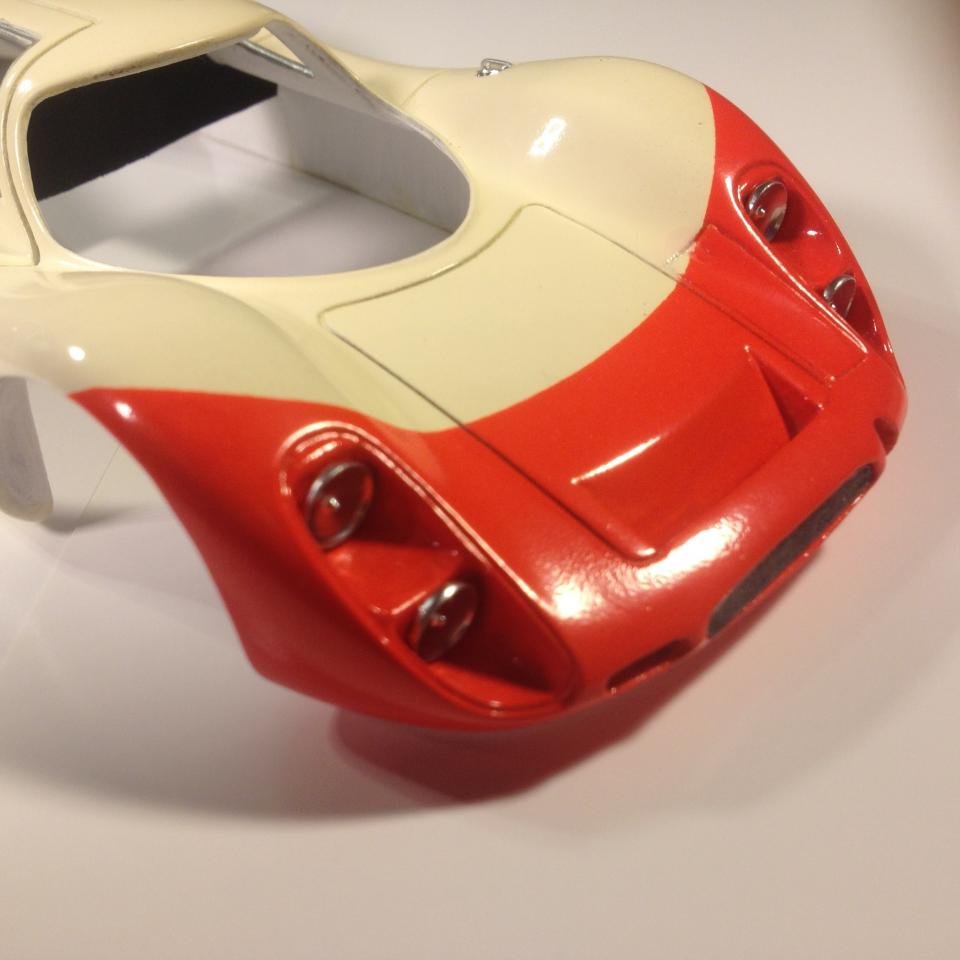

PS: UPDATE, I was going to apply decals today and read where I should spray a clear gloss. I tested the Americana Gloss Acrylic on some spare plastic and it looked great. However it orange peeled and started to remove paint from the body when I used it on there. It had a very poor reaction on lacquer based paints :(
So I'm stripping via Simple Green and having to start over :(
And it took me a while to get the paint looking like it was. Next time I'll use hobby based stuff like Mr Hobby Clear Gloss. Man I'm sooo upset!!!

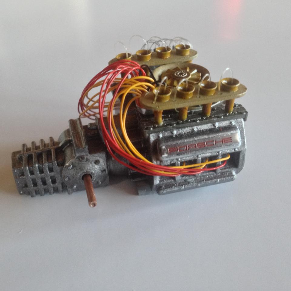

Plus I wanted to build an engine for it so I kit bashed from a Heller 907/8. I thought the fuel lines/thin fishing wire direct to the fuel trumpets was a bitchin detail!

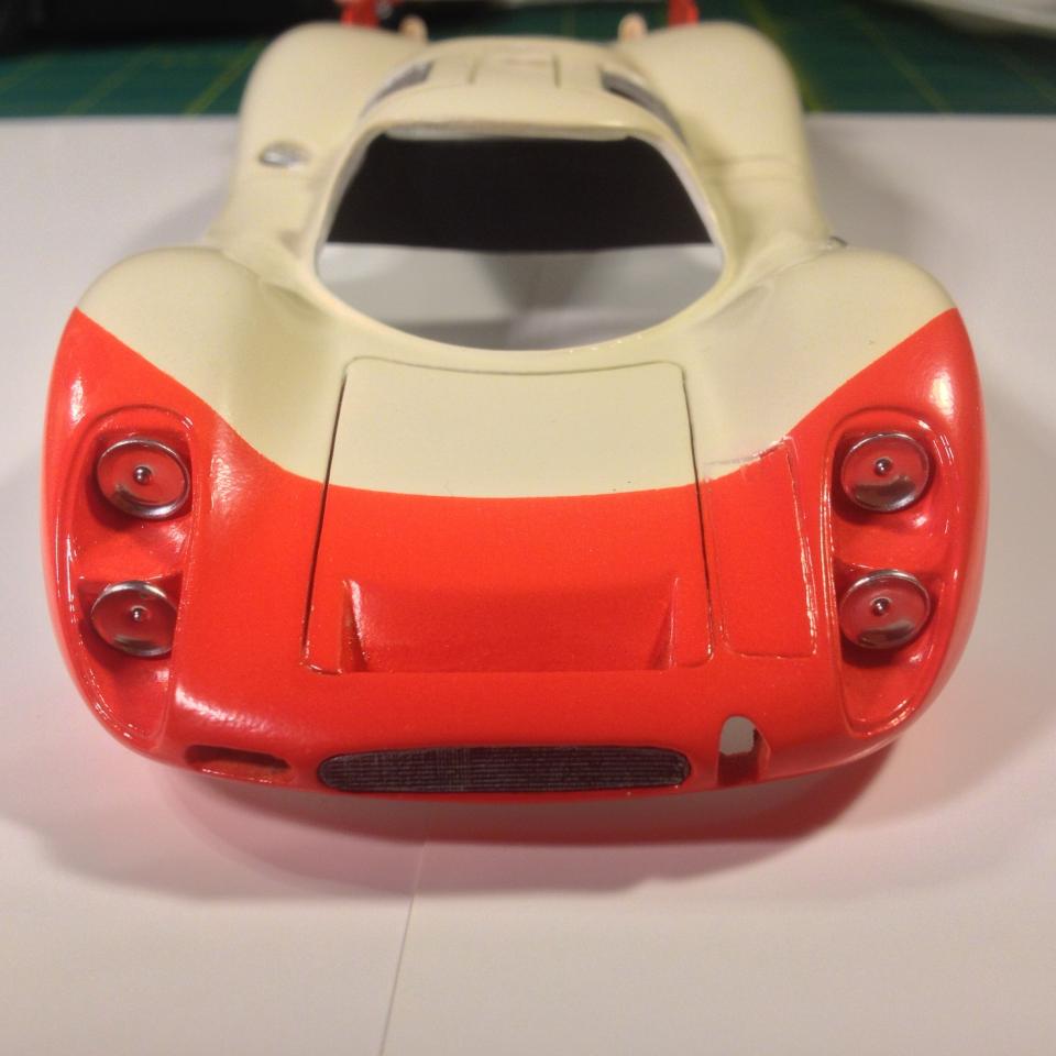

I like the paint.It has an aged Navajo white look that really fits a vintage racer.
Thanks dude, its being striped now, tragic! I'm about crying!
Its Tamiya Racing White.

that looks really pretty nice for a first build and of an expensive and difficult kit.
heres something though: be VERY careful what clear you spray over that white. many if not most will cause a yellow cast, if not immediately then with time (possible as little as weeks). if you are only clear coating to have a smooth finish to apply decals, work on getting your color coats smooth and skip the clear. or if you used clear I have found Tamiya gloss clear is pretty neutral, Future/Pledge/whateveritscalled airbrushed on even more so. but since you are having repeated issues with paint (its the hardest part most times so don't feel too bad) I would try to minimize them by using as little paint as possible, meaning, no clear coat.
you made some good points too, let me expand on them a bit:
especially on resin bodies it is essential. and honestly, cheap rarely works. Tamiya is the "go to" brand for good stuff
yeah man another problem especially in high humidity places or times. get a food dehydrator, you can find them for cheap on amazon or ebay, and they will allow you to fully cure your paint, even enamels, in one to two days instead of multiple weeks. you want it to cure to the point it doesn't smell or give off fumes.
one problem...that fit is going to close up when you paint it, so you will have to do a bunch of test fitting later in the process as well and also clearance checking and adjusting. forcing parts together after they have gained paint depth size will result in chipping the paint. perhaps you have experienced that already.
BINGO! even if its been reported to be used "with success" I would find some good clears and stick to them. again Tamiya is the goto, but Testors wet look lacquer works well too (beware of carp nozzles though and be careful laying on over enamel...Testors makes (or made, its hard to keep up) an enamel wet look clear too but it doesn't look as good as the lacquer to me).
great work on that model though, the engine is looking sweet and again don't get too bothered if your paint doesn't come up to your expectations, some of us spend our entire lives not looking forward to the next paint job
