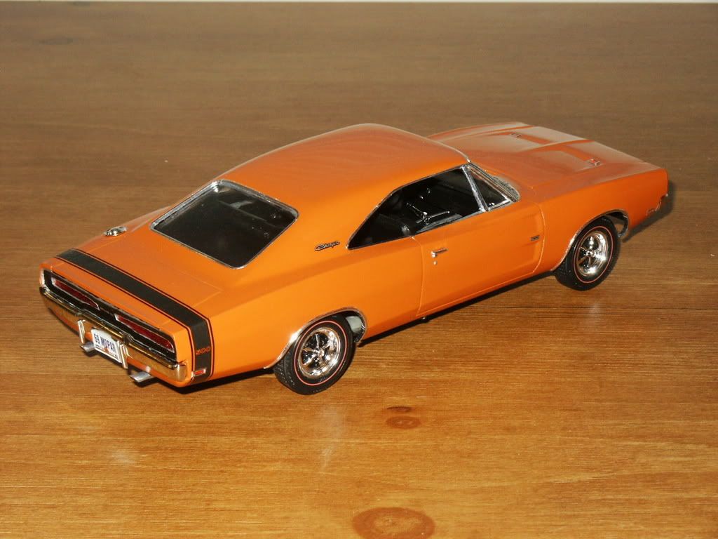

Sport Suburban Posted June 15, 2011 Share Posted June 15, 2011 I started one a few years ago just like what was stated above. I have the Revell 69 Charger fenders and nose grafted on the Daytona body. It was going very well and I need to finish it.I stopped when I realized that I needed to remove the trim over the a pillars that the Daytona uses. Another option is to use the AMT kit and fix the body. Then use the AMT 69 GTX chassis under that kit. Both ways creat a very nice Charger 500 but The Revell kits are now easier to find. Quote Link to comment Share on other sites More sharing options...

Sport Suburban Posted June 19, 2011 Share Posted June 19, 2011 (edited) Finish that one up, The 500 also had the same A-piller trim on them like the Daytona. I made sure to add them to the MPC 500 I need to finish up. Look up the real car on Google. Everyone I have seen has them. Thanks. I didn't realize that and I'm glad I didn't start sanding them off. Now to put it on top of the to do pyle and finish it. Here is my AMT version I built about 5 years ago. It's funny but I must have done my research as I foiled the A pillars. This was the last release that has a 70 hood on it. Edited June 19, 2011 by Sport Suburban Quote Link to comment Share on other sites More sharing options...
