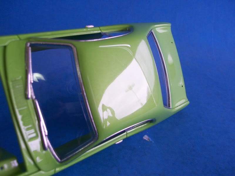

I've been trying to do a Viper for my best friend's 1:1 . He's the kinda guy that evryone want's to know ! Anyways I've been working on this model for well over a year because I'm having such a hard time laying down that perfect paint job . I know after numerous articles read that the perfect paint starts with a perfect base/primer . Well needless to say that I tried a couple of kits before attempting his and had decent results so I trekked forward. Started with preping the body then on to primer, well laid the first few mist coats to make sure no reaction to plastic. Feeling confident went on to apply more to only encouner some type of crazeing. Well anyways this happened again and again different primers always trying to change one thing everytime to narrow it down but no luck. Now getting very frustrated as to question selling my whole collection an give up this isn't any fun. Now fast forward to just recently cleaning my area I raised my height of my spray booth changed the flow of a few things and decided to get into some modeling and practise primer. Oh by the way I was soo frustrated with the Viper it was stripped 3 times bought an entire new kit that stripped twice. So here I am today starting with a 68 vette laying down primer thought hey not bad and kept going to what you see here. This isn't sanded and I think not too bad pretty smooth. Now I think I'll attempt the Viper next, oh this is a primer I get at the local autobody shop for 5.95 for 11 o/z or 311g , very happy with the primer I move on to what I think is a very nice result. Trust me guys not trying to be cocky or conceited but it has been a long time getting here and feel I have to pump myself up. Well let me know if I'm misleading myself but how do these look.

I'm sure no expert, but it looks darn good to me. I would only be concerned about the color paint. It is my understanding that some model paints don't get along to well with auto primers. Others here know a heck of a lot more about it than me, so maybe they will have suggestions.

Scott from this end it all looks good. One word of caution with the Viper in particular (and maybe the 'Vette) is that you've got to be really careful when putting on your color coats. You mentioned the crazing problem------that's because the plastic is very soft (especially the newest stuff) and doesn't take very well to hot automotive paints.
I highly recommend some type of barrier on the bare plastic before you do any painting, such as Future Floor wax, BIN, or some other brand of your choice. I've been doing this for quite some time now, and have had no problems with crazing and I've used hot lacquers.

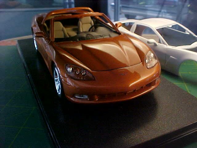

This is with out primer
