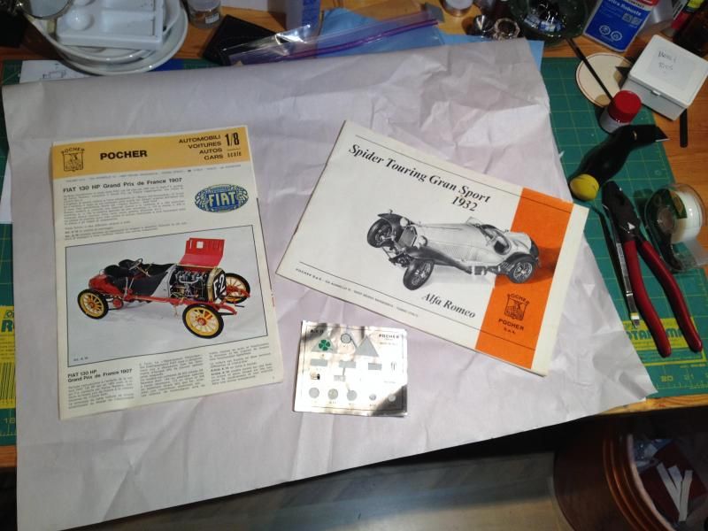

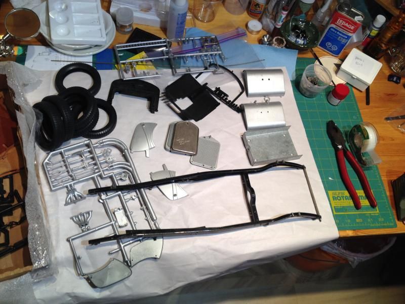

Twokidsnosleep Posted January 9, 2015 Author Share Posted January 9, 2015 (edited) A few pics of the "kit" I didn't post last night Instructions and old, old decals Strawberry flat that the parts were wrapped in for mailing...loose screws everywhere The frame rails, engine parts and radiator Edited October 4, 2015 by Twokidsnosleep Quote Link to comment Share on other sites More sharing options...

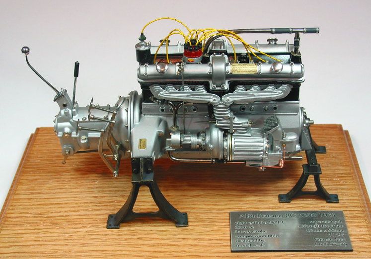

Twokidsnosleep Posted January 9, 2015 Author Share Posted January 9, 2015 (edited) This is my goal for step one, engine assembly. Beautiful machinery Not my work pictured here, just the inspiration. Edited October 4, 2015 by Twokidsnosleep Quote Link to comment Share on other sites More sharing options...
sjordan2 Posted January 9, 2015 Share Posted January 9, 2015 Looking excellent, though perhaps the exhaust manifold might look a bit more bronzed. Quote Link to comment Share on other sites More sharing options...
Twokidsnosleep Posted January 9, 2015 Author Share Posted January 9, 2015 Looking excellent, though perhaps the exhaust manifold might look a bit more bronzed. That is Paul Koo's motor advertising the engine kit sold here about halfway down the page http://www.modelmotorcars.com/alfa-romeo.html My engine is in 5,000 bits right now! I have seen a lot of variation on the engine block and valve cover paint...from bare metal to red,black Not sure what direction I will go, but I always like a contrast in colours. Quote Link to comment Share on other sites More sharing options...

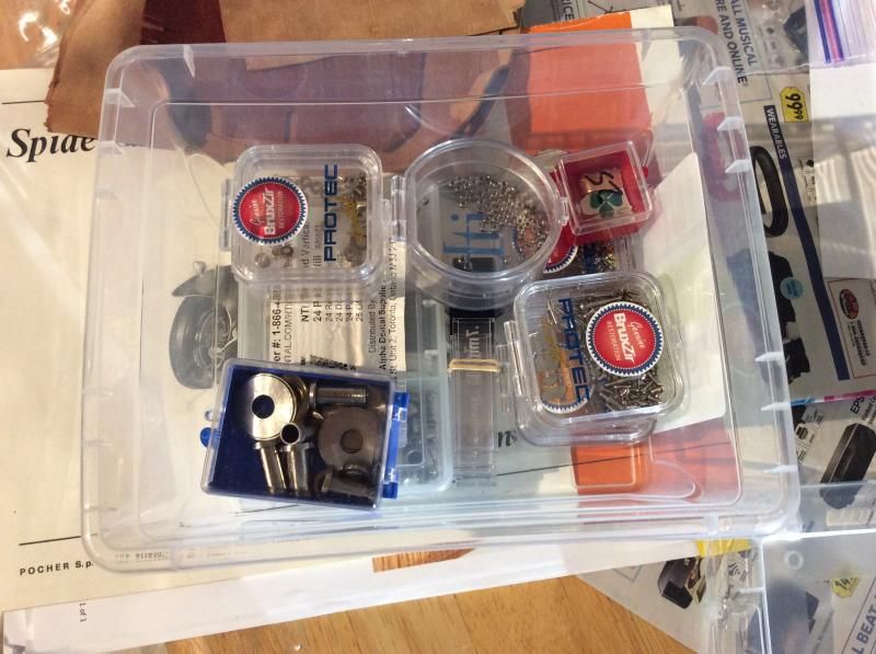

Twokidsnosleep Posted January 10, 2015 Author Share Posted January 10, 2015 (edited) Yes have Easy Off...old school smell of death stuff I have organized many of the metal bits into little clear dental crown boxes with lids...nuts, bolts etc As I worked though the plastic bag of many wonders, I was finding more dead bugs and then rodent feces (small so likely mice) Soooo all things metal in there got an IPA wash and then coated with thin layer of WD40 I am going to wash everything else in bleach and discard all shipped containers and original packaging. This kit has sat in the bowels of someone's home and it is kind of disgusting. I could actually steam autoclave the metal bits, but that would be a little too OCD...which I am not, really just a little CDO which puts it in correct alphabetical order....that is a joke folks, bada bing Time for a Friday night drink Edited January 10, 2015 by Twokidsnosleep Quote Link to comment Share on other sites More sharing options...

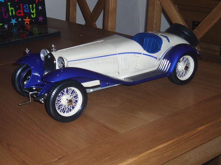

Twokidsnosleep Posted January 10, 2015 Author Share Posted January 10, 2015 (edited) Ok, all done Just kidding, this is a pic from Britmodeller site....gorgeous car, nice leather inside, great tips for the build Trying to figure out some colours Thanks Cato Edited October 4, 2015 by Twokidsnosleep Quote Link to comment Share on other sites More sharing options...
Twokidsnosleep Posted January 11, 2015 Author Share Posted January 11, 2015 (edited) Model is put to bed in a dog proof container.....Coco my Bernese tested it out Each Ziplock has different assembly steps gathered together....vs random parts chucked in a box of mouse poo. Dental boxes of small bits in separate plastic box....no more loose bits I have not itemize every nut, bolt and screw. The things I notice missing are the Alfa badges and all the decals are toast. There are sources for replacements and I will do that when it is time. I was impressed with how the assembled parts of this car came apart so well; I broke one plastic bit on the alternator that I will easily replace. Maybe getting an old built Pocher kit, disassembling and getting aftermarket parts is not a bad idea. I am $350 USD into this kit which seems ok by what I see them going for...lots of potential to customize her up. So I will tuck this away for now and finish the other kit Time for research, gather info and think Cheers, Scott Edited October 4, 2015 by Twokidsnosleep Quote Link to comment Share on other sites More sharing options...

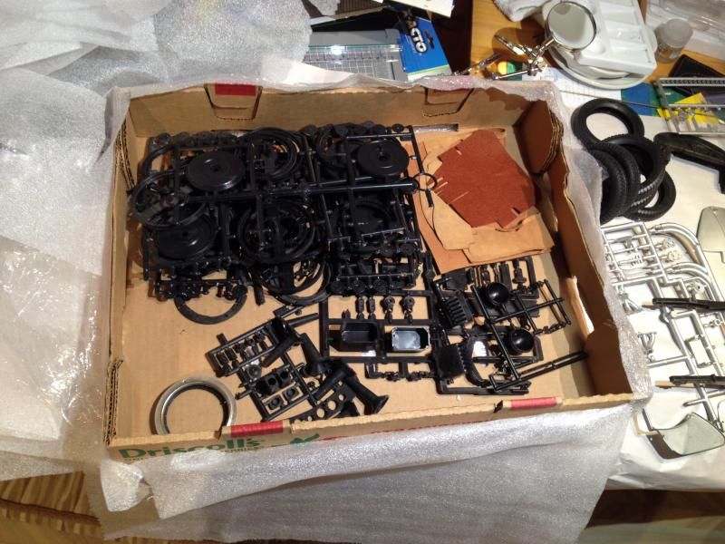

Twokidsnosleep Posted February 13, 2015 Author Share Posted February 13, 2015 (edited) I was poking through the kit reading the pamphlet on the left and found a spider egg nest stuck to the paper inside.Yikes! I squished them in a tissue and chucked it away. Think i will set that on fire tonight.That would have been an awesome colony of foreign spiders trapped in a plastic tub crawling all over this Gran Sport kitI must have missed it when I was disinfecting everything else. Edited October 6, 2015 by Twokidsnosleep Quote Link to comment Share on other sites More sharing options...
