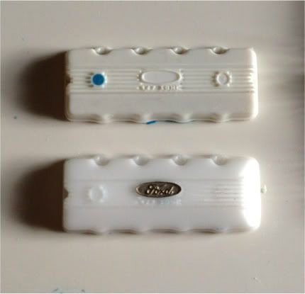

raisin27 Posted January 14, 2012 Share Posted January 14, 2012 Nice job on that. The Jo-Han one looks much better than any of AMT's efforts, but I see they still got the plugs in the wrong place on the passenger side. The covers are not symmetrical on the 1:1 The spark plug location is my biggest beef with the AMT CAMMERS. On some it has the front plug on the left side going directly into the timing chain. Quote Link to comment Share on other sites More sharing options...

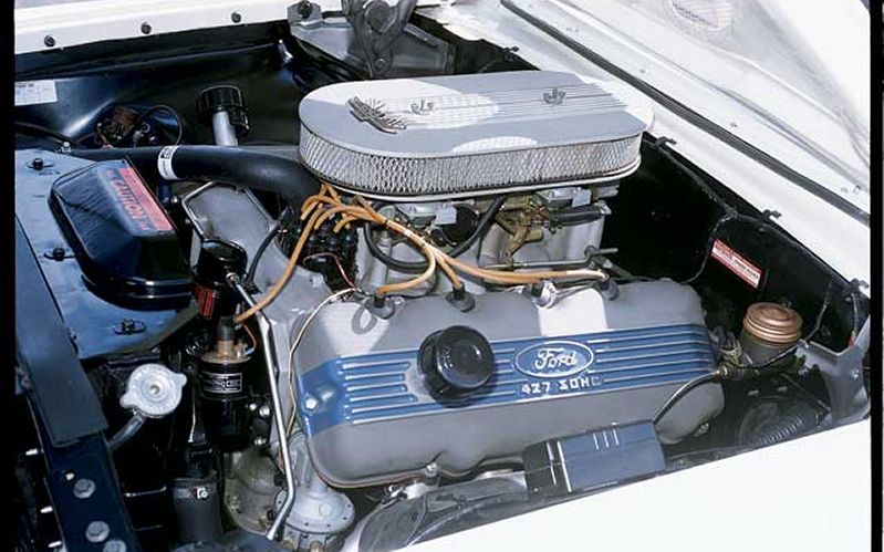

Casey Posted December 18, 2012 Share Posted December 18, 2012 Good reference pic of a Cammer. I like that this one is clean without any excess anything, and the blower belt tensioning pulley and bracket always seem to be left off of scale models...so no more excuse now! Quote Link to comment Share on other sites More sharing options...
Erik Smith Posted December 19, 2012 Share Posted December 19, 2012 I have been using my marginal skills to convert the old Johan Maverick covers to a more correct appearance. Driver's side is pretty much done: Johan part on top, modified part below. I have the other side to do - I have to move the plug locations to the proper offset... Quote Link to comment Share on other sites More sharing options...
tubbs Posted December 19, 2012 Share Posted December 19, 2012 boy, you guys are going thru a lot of trouble for a valve cover....... and i like it!! never did know about the covers not being symectrical, now every time i look at them, i will know they are wrong. was always satified with them, till now. thanks for the info. btw - i think there is a 69 torino kit that has a nascar version of this motor. Quote Link to comment Share on other sites More sharing options...
