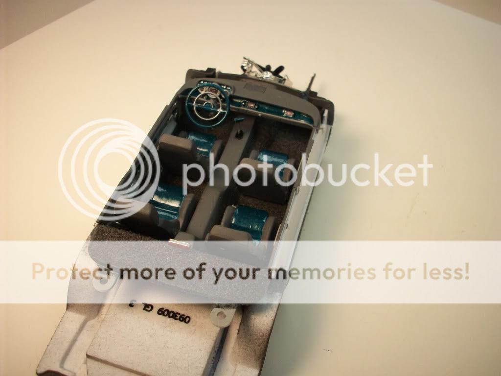

fractalign Posted May 10, 2013 Share Posted May 10, 2013 The 32 body is a roadster utility. Ford Australia started producing these back in the late 1920's. It comprised the front of a roadster joined to the back of a pickup. Quote Link to comment Share on other sites More sharing options...
southpier Posted May 10, 2013 Share Posted May 10, 2013 The 32 body is a roadster utility. Ford Australia started producing these back in the late 1920's. It comprised the front of a roadster joined to the back of a pickup. so a pickup box will slide into the cut out of the tub? I always liked the roadster pick up. the roadster that had the trunk lid cut out and a box slid in its place. downhome engineering. thanks Quote Link to comment Share on other sites More sharing options...

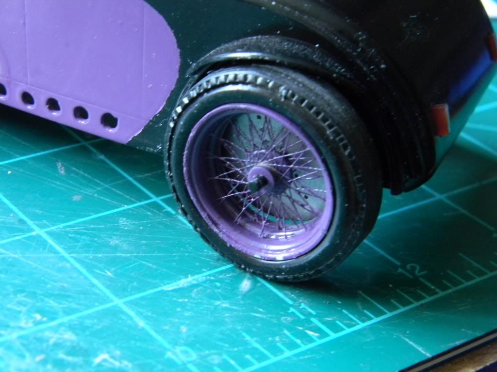

kennb Posted May 10, 2013 Share Posted May 10, 2013 this is a simple flat casting,,,the tire is the same half cast 2 timre and glued together,,,,,,the backs have been flat sanded for a better fit. The rims are a 3 part cast for the layered lacing on the wire wheels.the center is still a one off untill I learn how to cast a decent hub that works,,,, note,,the car is of course scratchbuilt Quote Link to comment Share on other sites More sharing options...
fractalign Posted May 11, 2013 Share Posted May 11, 2013 I am working on making the passenger floor and the pick up tray an integral unit. As a one piece unit it will slide in a lot easier. This is just one of a number of roadster and coupe utilities that i am working on so i am engineering the floor and the area to fit into all them. Quote Link to comment Share on other sites More sharing options...
southpier Posted May 11, 2013 Share Posted May 11, 2013 very cool. please post photos as this progresses. Quote Link to comment Share on other sites More sharing options...
fractalign Posted May 11, 2013 Share Posted May 11, 2013 Will do, once i have ironed out the bugs with this one. I am just in the middle of remastering the body at the moment, cleaning up the inside so that the passenger compartment slides in easily. I want to make sure there are no flaws in the body and that the top lines up properly with the windscreen frame before i remould all the components. Quote Link to comment Share on other sites More sharing options...
