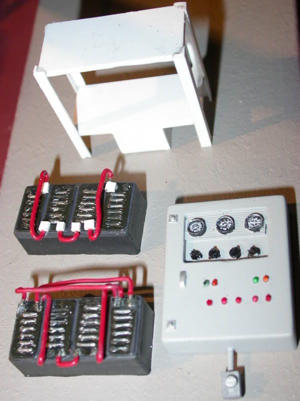

dptydawg Posted December 17, 2009 Author Share Posted December 17, 2009 Just a quick update. Spent a lot of time today making fiddely bits. I was starting to go crosseyed so I'm taking a break. I've put togeather the control box for the cooling tower. The guages are from the parts box, the handswitches and indicator lights are made from chunks of evergreen rod painted with Tamyia clear red, green or amber. The battery banks for starting the Cat engine came out of both my Western Star truck models. Each one has four 12 volt batteries (I'll have to glue the baterybox covers down tight on them now :ermm: I started to install cables to wire them up for 24 volt output but its not quite done yet. They will sit on the battery stand that I have still to paint. Each battery will supply one of the starter motors Thanks Carl Quote Link to comment Share on other sites More sharing options...

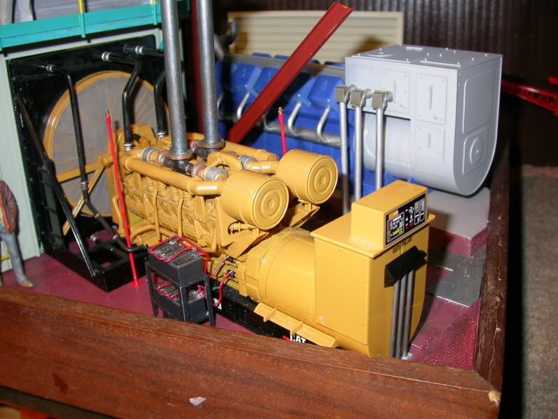

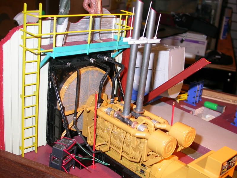

dptydawg Posted December 27, 2009 Author Share Posted December 27, 2009 I've been working on the Cat Genset over the holidays. Its now glued to the base. Ive added some fire sprinklers, a fuel supply line and exhaust stacks. Here are a few pics Thanksd Carl Quote Link to comment Share on other sites More sharing options...

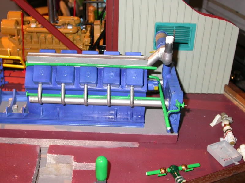

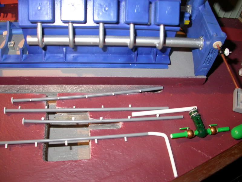

dptydawg Posted January 4, 2010 Author Share Posted January 4, 2010 Since the last update I have finished with the Cat genset. The battery rack is now glued in and the cables attached to the starter solenoids. I have been struggling with the cooling water plumbing for the big engine. Since this is a fictitious engine then there is no specific prototype to follow. I'm trying not to let the laws of heat and thermal or fluid mechanics get in the way of a good story. But I am trying to keep the final product believable (I hope) The biggest problem I have is finding wide radius elbows for the piping. This is a pic of the inlet and outlet headers before painting. Most industrial plants use colour coded piping to identify the contents. While there is no universal standard I'll be using the old Ontario Hydro standard colour coding. Red = fire suppression, Yellow = oil systems including diesel, Blue = air, Green = water. Black = waste water and silver = steam. Electrical conduits are normally natural metal colour. The cooling water outlet headers have been installed on the block along the top of the intake log manifold. The outlet of the intercooler is also tied into this header. The valves are made form plastic beads with handles added. The inlet pipes are maybe sitting in place along side the exhaust manifold. I'm still trying to decide how best to route these pipes. Thanks for looking Carl Quote Link to comment Share on other sites More sharing options...

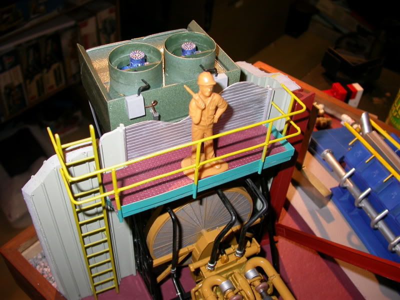

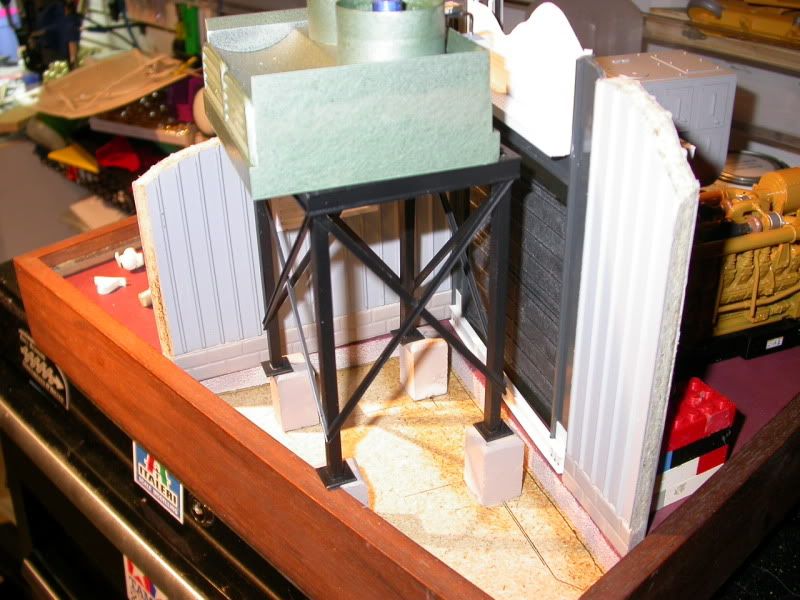

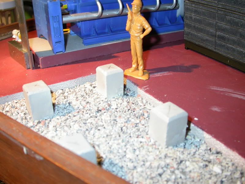

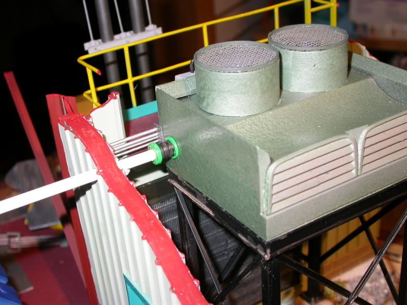

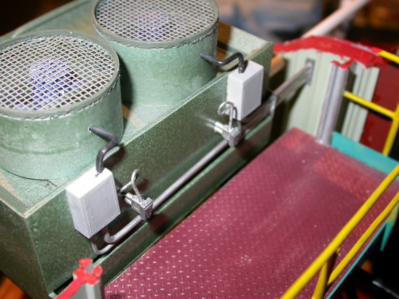

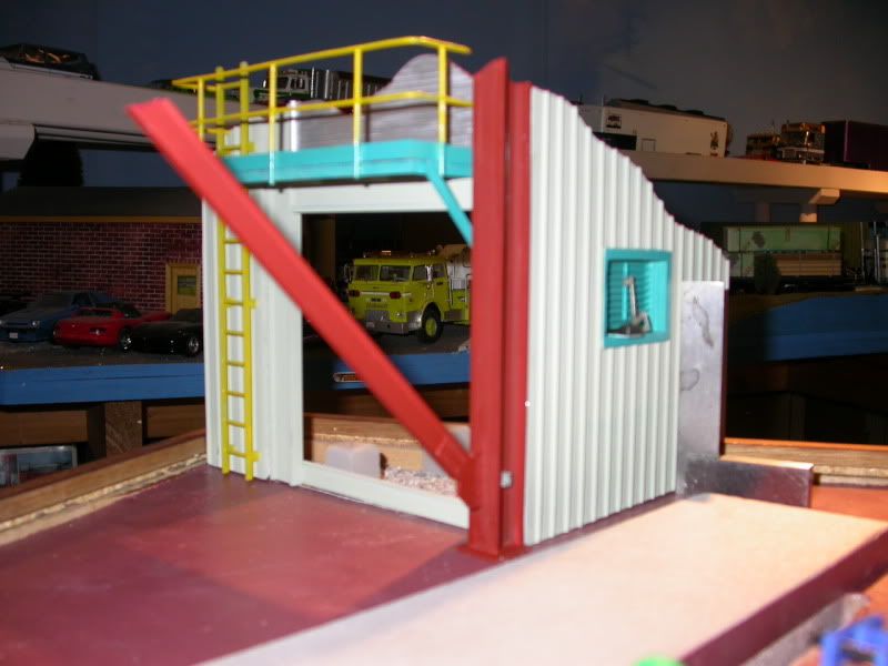

dptydawg Posted January 14, 2010 Author Share Posted January 14, 2010 A bit more work to show When I started to put the cooling water lines in for the genset I quickly realised that I had to install the cooling tower. I needed to have a reference point to run my piping from. So I finished up the yard under the tower and installed the suport structure. addded some hold down bolts and a little rust here and there. I added some power and control conduits to the cooling tower and installed some safety screens over the fans. The roll up door has done so for this shot. The expantion joint was machined form a plastic knitting needle (one of my favourite raw materials) The finished cooling tower. Thanks Carl Quote Link to comment Share on other sites More sharing options...

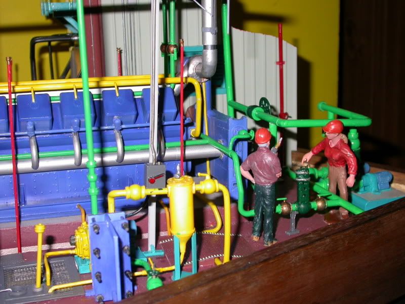

dptydawg Posted February 18, 2010 Author Share Posted February 18, 2010 Its been a month since I last did an update on my genset project. I have been making some progress on it. The cat is essentially complete. Most of my time has been adding details to the Silzer engine. The yellow piping coming out of the floor is the fuel supply. It goes into some filters and through scratch built injector pump to the blue (engine coloured) fuel system piping. The other yellow pipes (top and background) are for the lube oil system. The generator was then installed . I added power output and control cable conduits to the generator. The windings of this generator are water cooled. To ensure very pure low conductivity water the piping is all copper. The heat exchanger is a plate type and the purification ion exchange columns are under the gray control panel box. Some of the equipment is located off stage. The piping ends at the base's edge. The engine uses a drysump lube oil system. Oil drains via gravity from the bearings to a sub-floor storage tank. It is then pumped via a gear type pump through another plate HX to a filter then back to the engine and gen bearings. The filter is made from a Nascar fuel can. The green pipes are for the cooling water system. I still have to install the cooling water pumps in this are. Thanks Carl Quote Link to comment Share on other sites More sharing options...

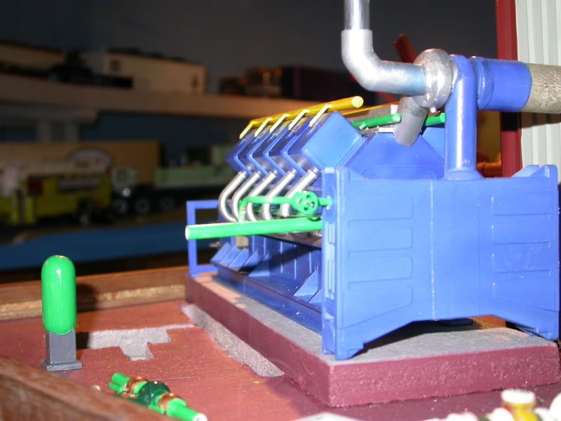

dptydawg Posted February 28, 2010 Author Share Posted February 28, 2010 I thinnk that the last of the plumbing has been run. I finished adding the pumps and control valves for the cooling water circuit. The painters still have to add some dirt to various places to make it loopk used. and the millwrights still have some pipehangers to install. The I&C techs have a bunch of control lines to run and some instrumentation to install. This power station is close to going on line. There is still more work to be done to the operators before they are ready for duty. Thanks Carl Quote Link to comment Share on other sites More sharing options...
