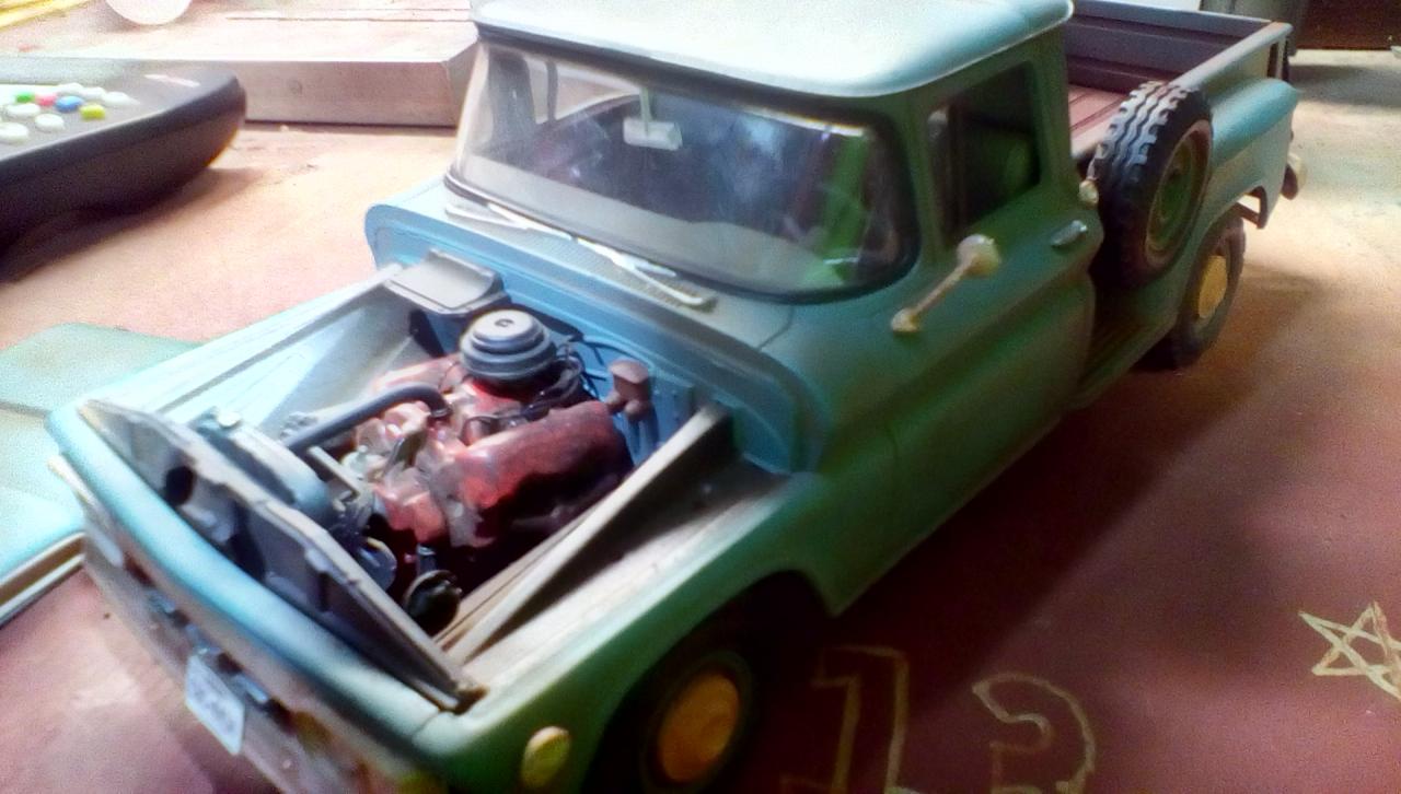

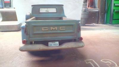

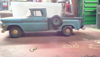

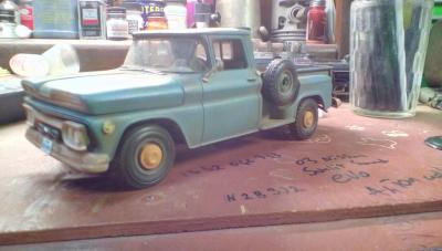

Well this is my first post I have Ben lurking around this site for a while.just finished my 60 gmc it was a short fleet chevy truck. I scratch built the bed sides used the finders, 2 sets of steps grafted together from revells 65 chevy truck, tail gate is from amt 70s gmc. Frame was stretched using 2 amt frames. The gmc 305 v6 was scratch built using 409 valve covers, a international engine block, timeng cover is a Oldsmobile,intake is from a NASCAR kit shortened to v6,used kits distributor and car,air cleaner,3speed Saginaw transmission. Hood filler and grill where given to me from a friend I pulled a mold so I could make more later also used the v6 emblem from a diecast to cast a mold to make resin copies. Dash was modified to the gmc version. Thanks for looking and reading.

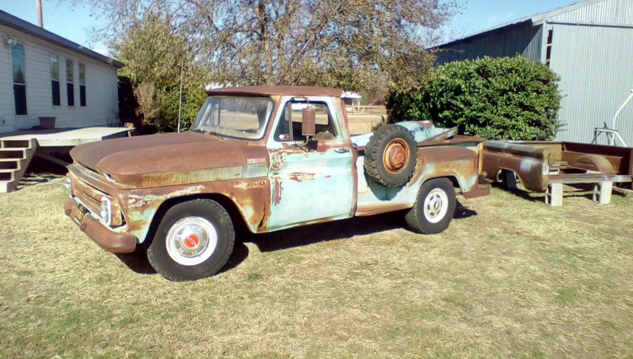

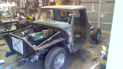

Thanks everyone! These trucks hold a special place in my heart. here are 2 of my real trucks that I have been working on 1 is a long step the other a short fleet. consequently don't finish as many models as I would like.it took me almost a year to build my little gmc.
