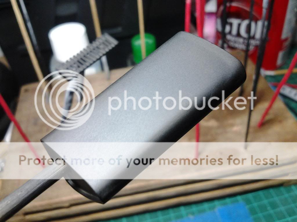

Cien1986 Posted May 13, 2014 Author Share Posted May 13, 2014 Some painted part Quote Link to comment Share on other sites More sharing options...

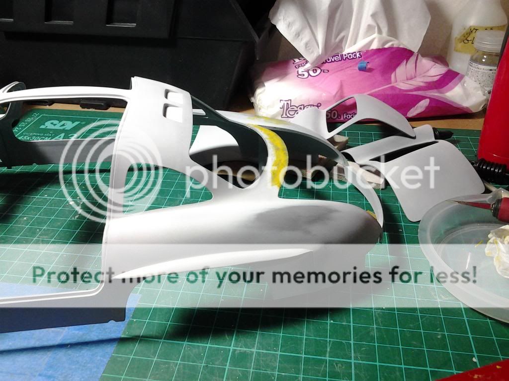

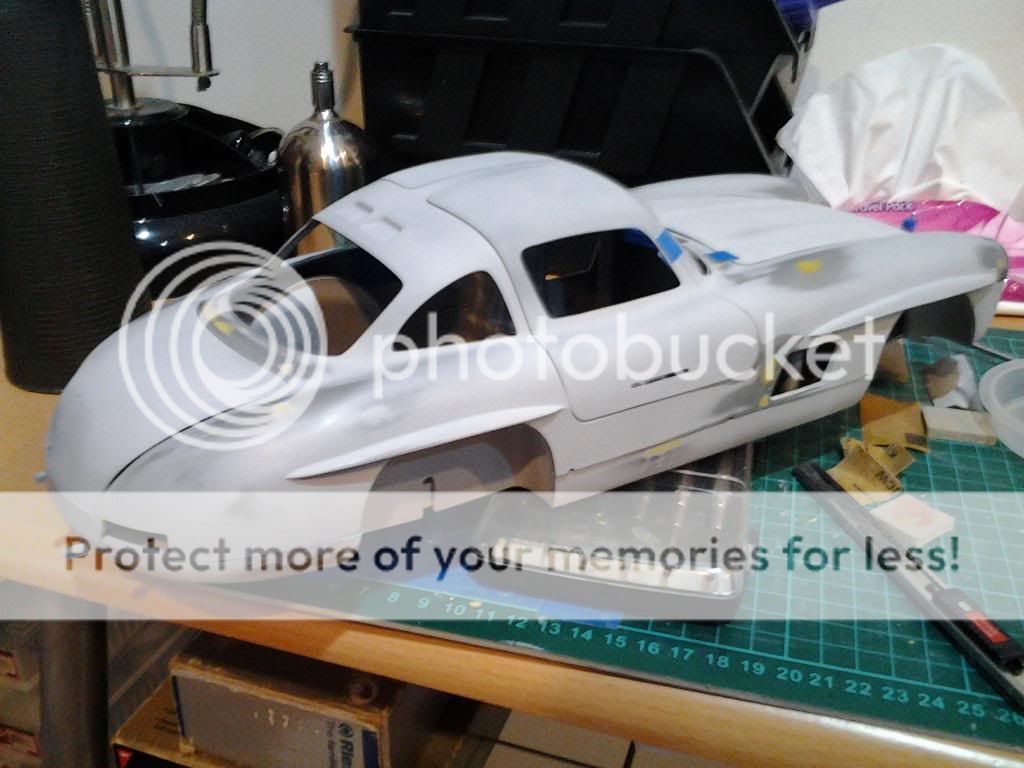

Cien1986 Posted May 13, 2014 Author Share Posted May 13, 2014 (edited) I finish the primer coating to the body... with this i can easily inspect the defect part like sink mark or other deep scratch.. so time to fix it... Edited May 14, 2014 by Cien1986 Quote Link to comment Share on other sites More sharing options...
sjordan2 Posted May 13, 2014 Share Posted May 13, 2014 (edited) Your bodywork is superb on the very uneven surfaces of this kit. Question: Why did you paint the entire vent grille on the cowling? The top bars need to be chrome. Edited May 13, 2014 by sjordan2 Quote Link to comment Share on other sites More sharing options...

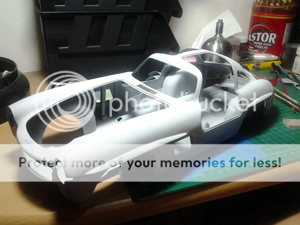

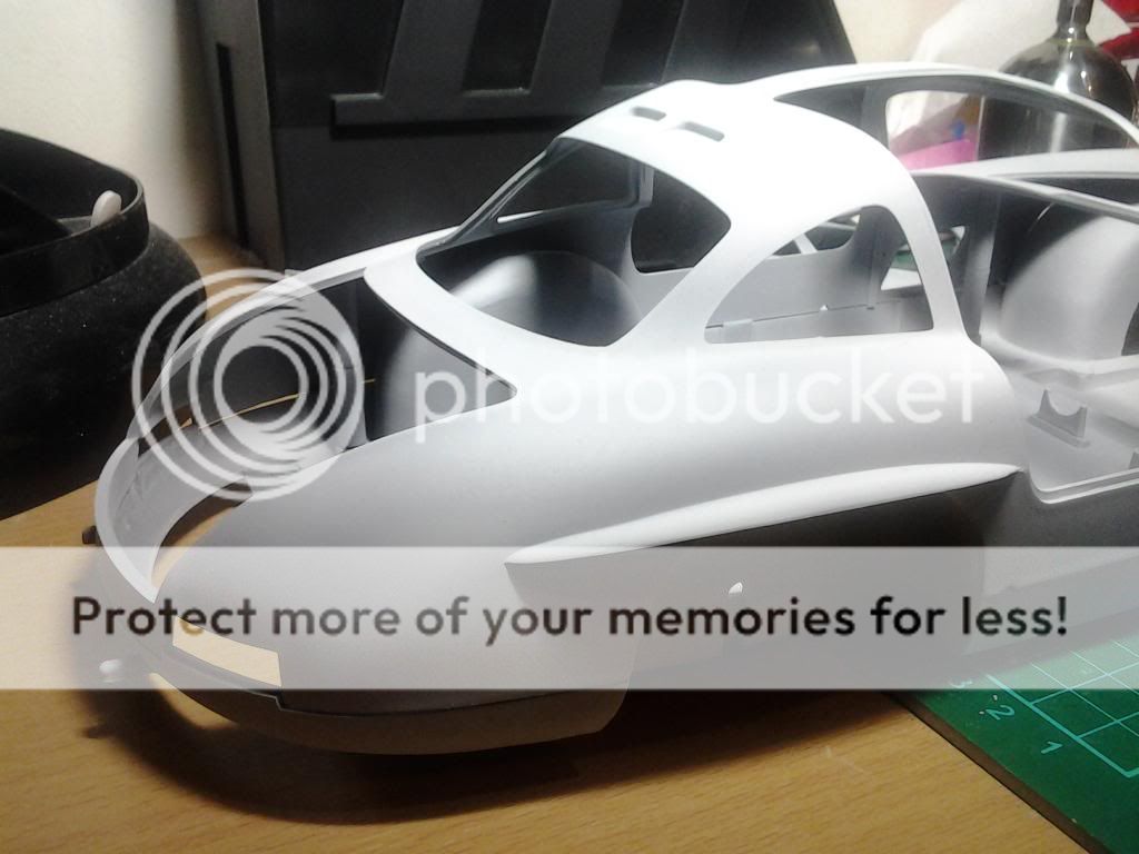

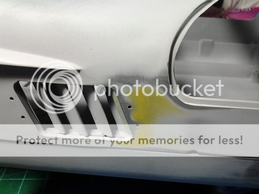

Cien1986 Posted May 14, 2014 Author Share Posted May 14, 2014 I fix the fender gap.. i looks bumpy on the gap and sinking on the upper side.. so i sand it and put some putty on the sink mark this is some progress on repairing the sink mark i let it dry overnight.... so now... time to sand it down.... Quote Link to comment Share on other sites More sharing options...
Cato Posted May 14, 2014 Share Posted May 14, 2014 i found the gap between the body and the trunk is a bit to far any idea how to fix this...? Glad you agree about the paint choice. You can cut styrene strips and glue from the inside edges of the trunk. Then fill with Bondo and sand to match trunk contours. Or do the same to the trunk instead if that's easier for you. Quote Link to comment Share on other sites More sharing options...

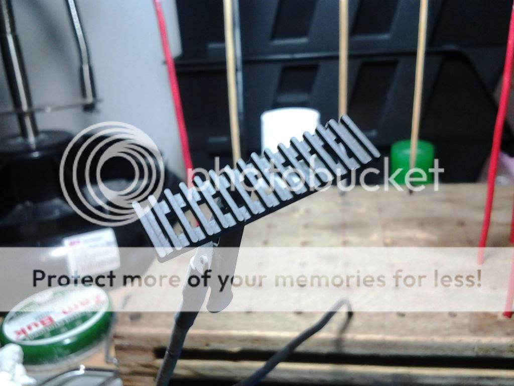

Cien1986 Posted May 15, 2014 Author Share Posted May 15, 2014 This is the shark fin on the fender... i am uncertain about somthing... is it work better if i glue it first then paint it or.. paint it separately then glue it? Quote Link to comment Share on other sites More sharing options...

sjordan2 Posted May 15, 2014 Share Posted May 15, 2014 For painting the louvers on the side, I would paint them twice -- before and after gluing them to the body, so you cover all the nooks and crannies. Quote Link to comment Share on other sites More sharing options...
Danno Posted May 15, 2014 Share Posted May 15, 2014 My two-cents worth: I'm with Skip . . . paint before and after installation. Quote Link to comment Share on other sites More sharing options...
Cien1986 Posted May 15, 2014 Author Share Posted May 15, 2014 For painting the louvers on the side, I would paint them twice -- before and after gluing them to the body, so you cover all the nooks and crannies. I see.... never think about it.... thanks for the great info... so its like pre shade before attachment then repaint it to make it looks connect... and it will not miss the blind spot... many thanks... Quote Link to comment Share on other sites More sharing options...

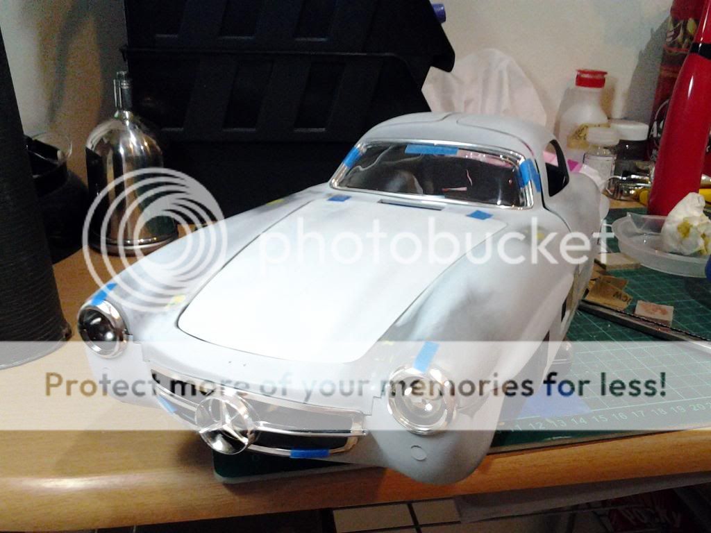

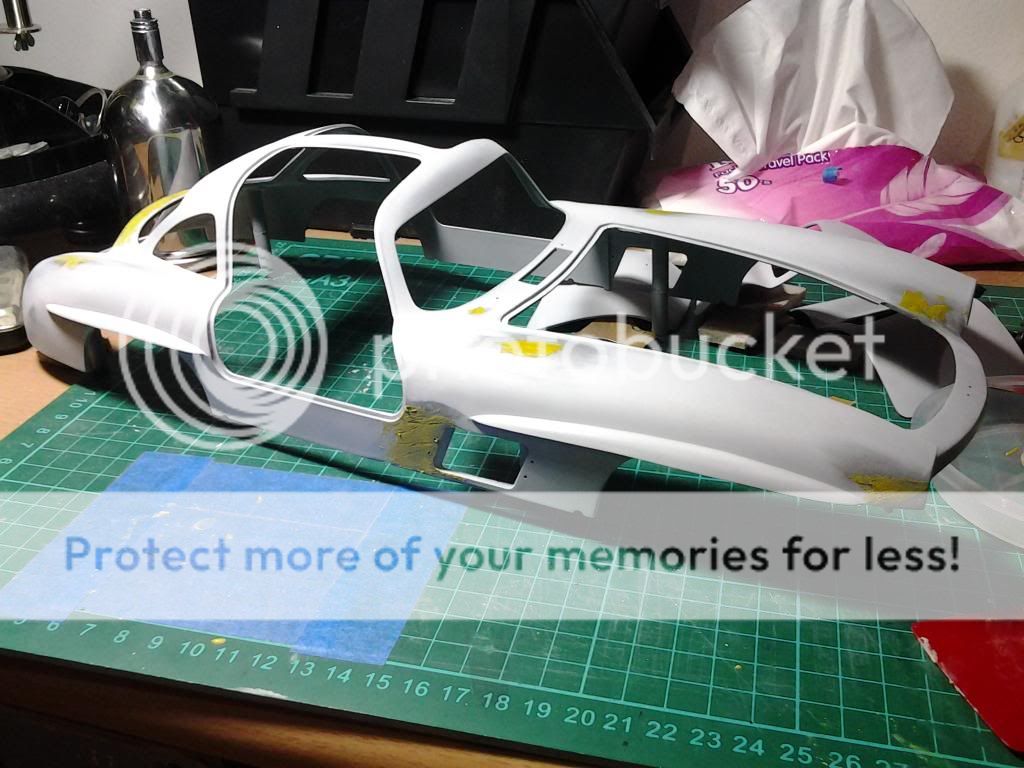

Cien1986 Posted May 15, 2014 Author Share Posted May 15, 2014 (edited) I finnished on repairing the body sink mark and scratch... here it is Edited May 15, 2014 by Cien1986 Quote Link to comment Share on other sites More sharing options...

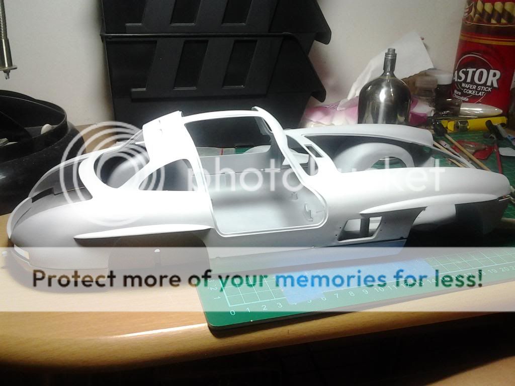

Cien1986 Posted May 15, 2014 Author Share Posted May 15, 2014 But when i am fitting the chrome part on the windhield... i found its really troublesome to put it in... And you can see the left door not 100% fit but its the best shot i can do.... but the right door is a bit better.... Quote Link to comment Share on other sites More sharing options...
