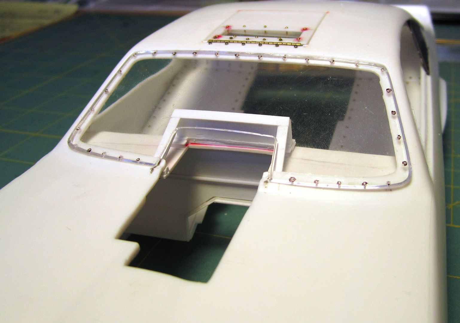

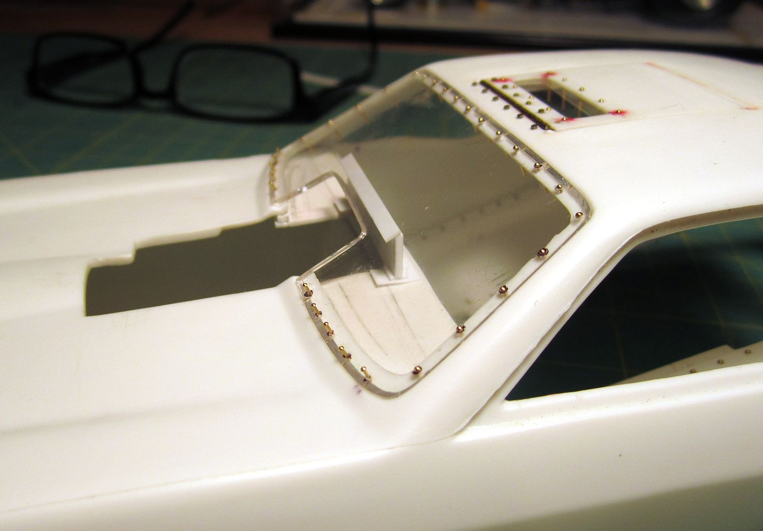

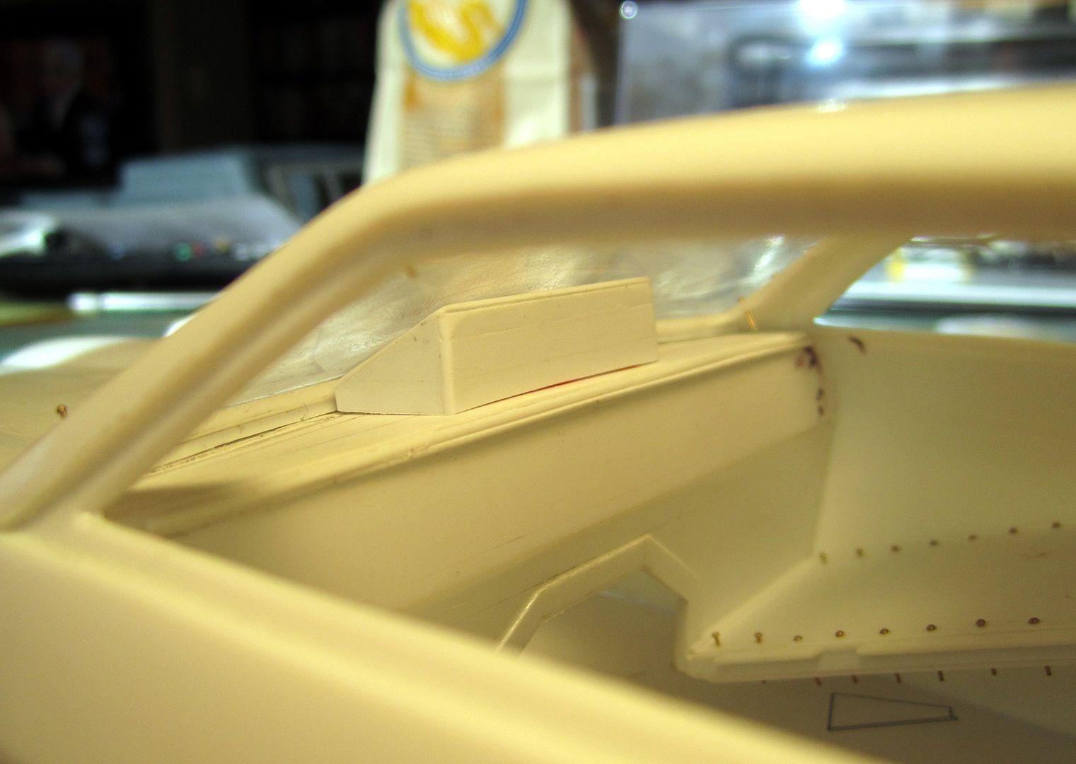

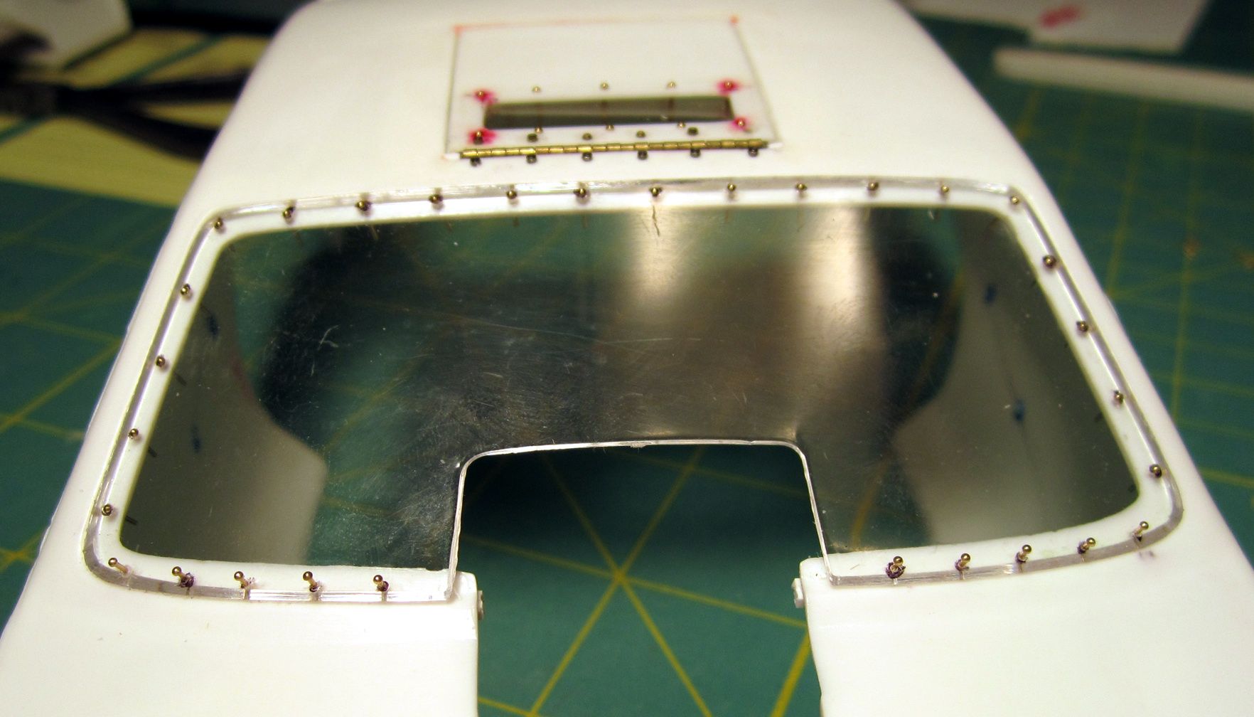

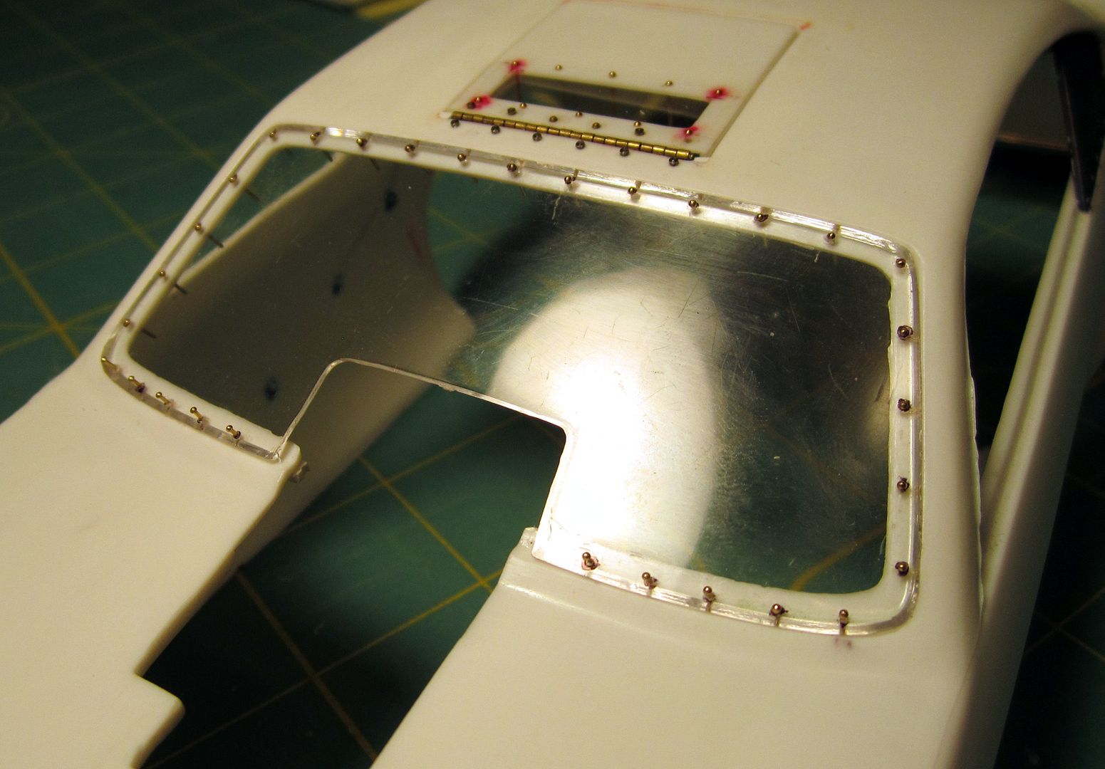

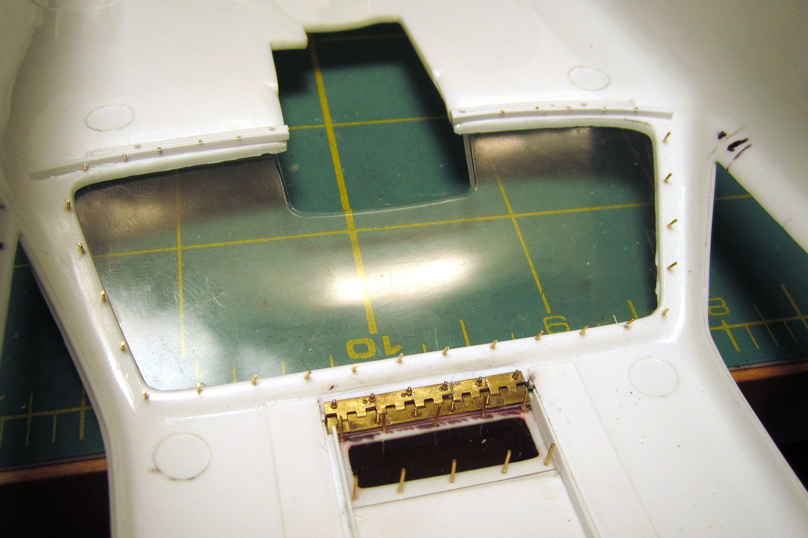

Mooneyzs Posted May 3, 2014 Author Share Posted May 3, 2014 Dave... Thank you Sir. Well Fellas.... I did some more work last night just was a little tired to download the pics off my camera and post last night. I was working on the front windshield, drilling out the rivets and transferring the holes to the body for the Rivets. Once I got that done I started to make a make shift template for the dog house that goes around the blower. I still have to make it and starting to make this gage to figure out the size of things. Here are a few shots, I know this update isn't too exciting and hopefully I will have some better updates soon. Here is the front windshield, I started by taking my xacto knife and cutting the rivet a little flat to give me starting point where to drill my holes and then I transferred them to the body and installed the rivets for fitment: Inside of the body, I will have to go back and cut the length down on all of these rivets but it will be done at a later time: Here is the start of what I am using as a gage/template for this dog house. I wanted to be able to get the fit right so that the lip on the dog house would meet up to the glass correct and since I couldn't really get a good way to get measurements so I started to build this as a starting point: Quote Link to comment Share on other sites More sharing options...

GoatGuy Posted May 3, 2014 Share Posted May 3, 2014 That also looks tricky getting the windshield off with all the rivets holding it in place. Looks like if you pull it from one side to get it started, it could bend rivets on the opposite side. How do you manage that? Push it out from the inside by pushing the center of the glass? Quote Link to comment Share on other sites More sharing options...

Mooneyzs Posted May 4, 2014 Author Share Posted May 4, 2014 Danno.... Thank you very much my friend. Brad.... You are right that it has been tricky. for such a small part one would not think it would take this long...lol I almost have it done though. I am at the stage of fitting it and sand a little more fit sand fit sand....lol Pain in the butt.. Dave.... Yeah that can be tricky as well to get the windshield off too. I pull the rivets out one by one. I will start by pushing them from behind (from the inside) typically will try to get all of them from the inside first and then I go back and slowly pull them out. I have learned a few trick since I did the back windshield the same way. Shaun.... Thank you sir for the kind comments. Mark... Thank you very much. I know I have been spending a lot of time on this tin work for the body. but I think in the end it will all pay off...Hopefully...lol Guys stay tuned I am downloading pics right now and will have some up in a few mins for an afternoon update to show where I am at with this. Quote Link to comment Share on other sites More sharing options...

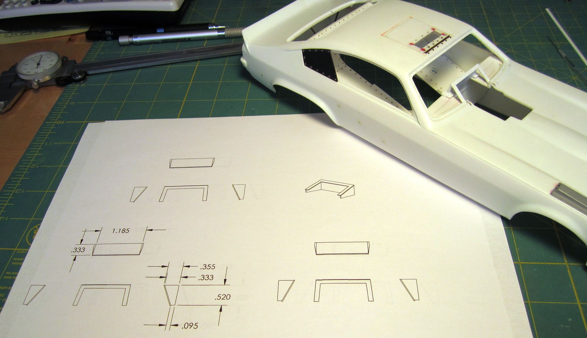

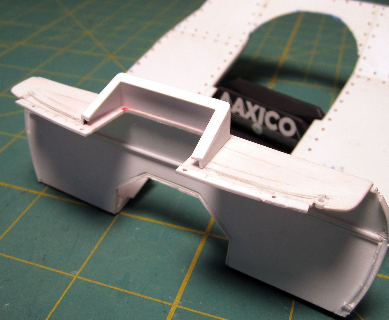

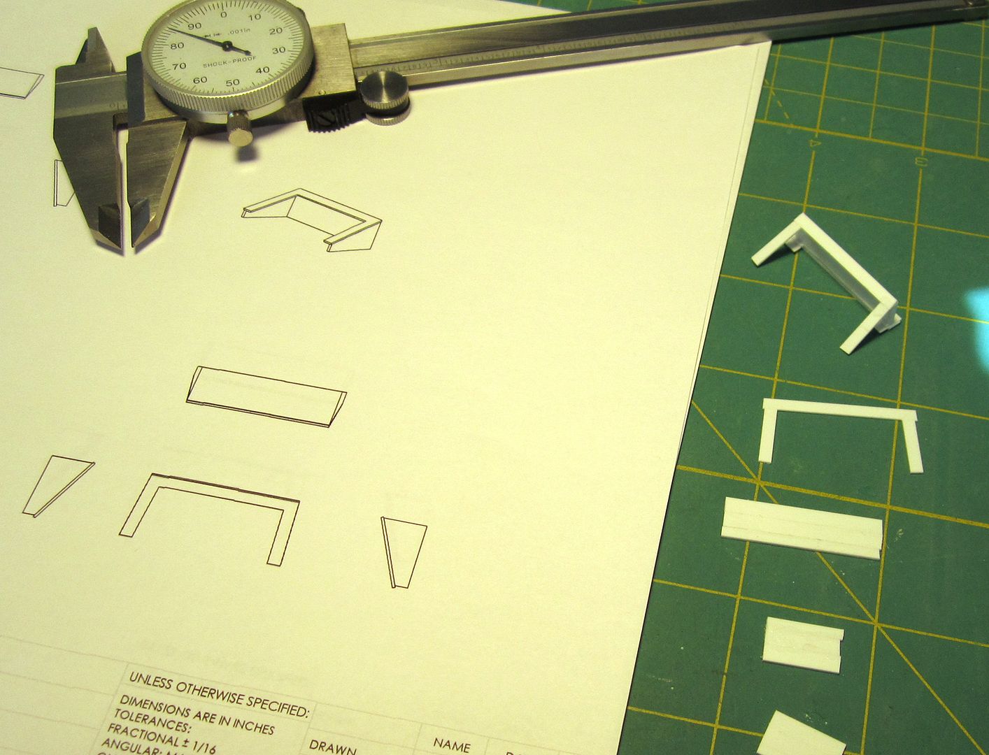

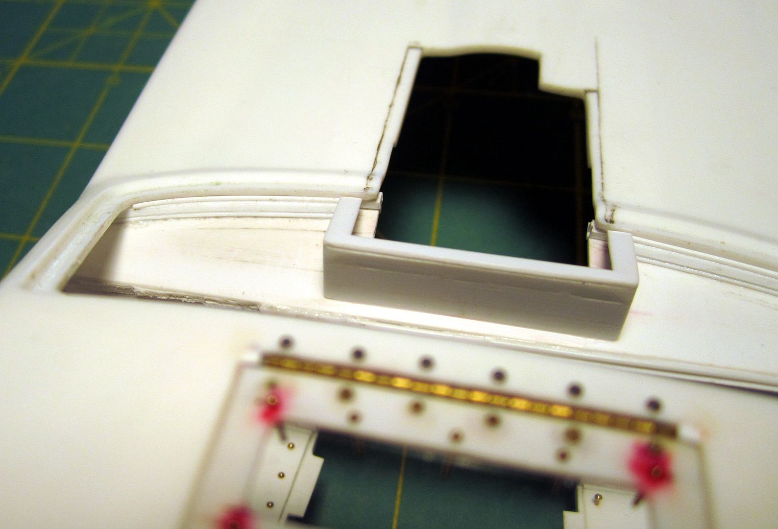

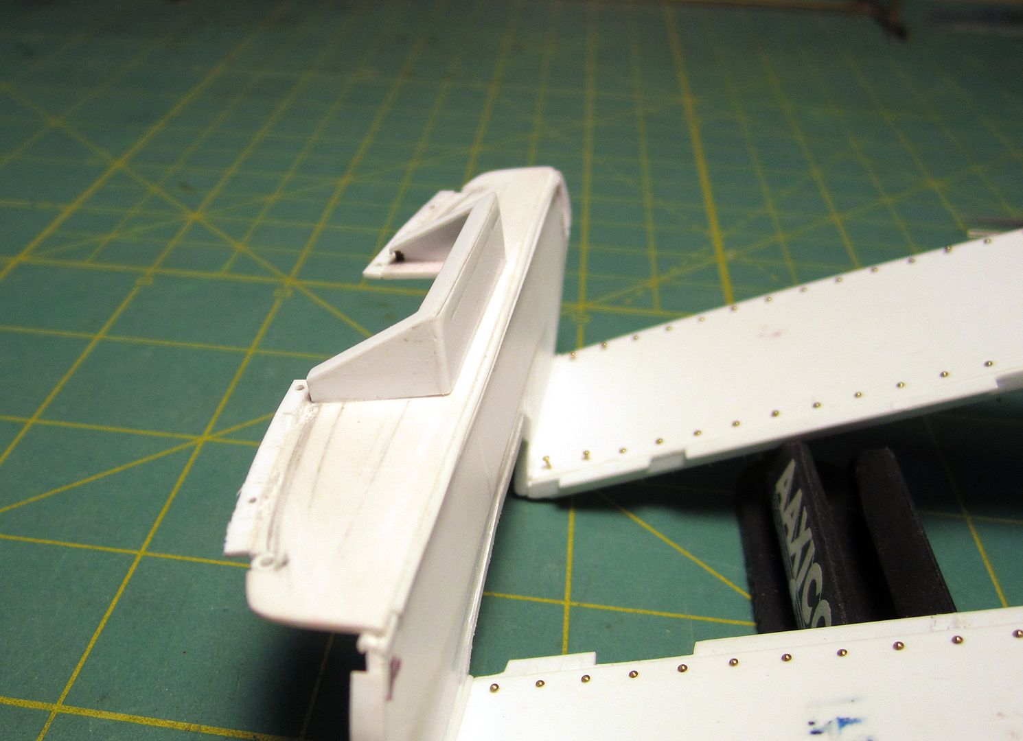

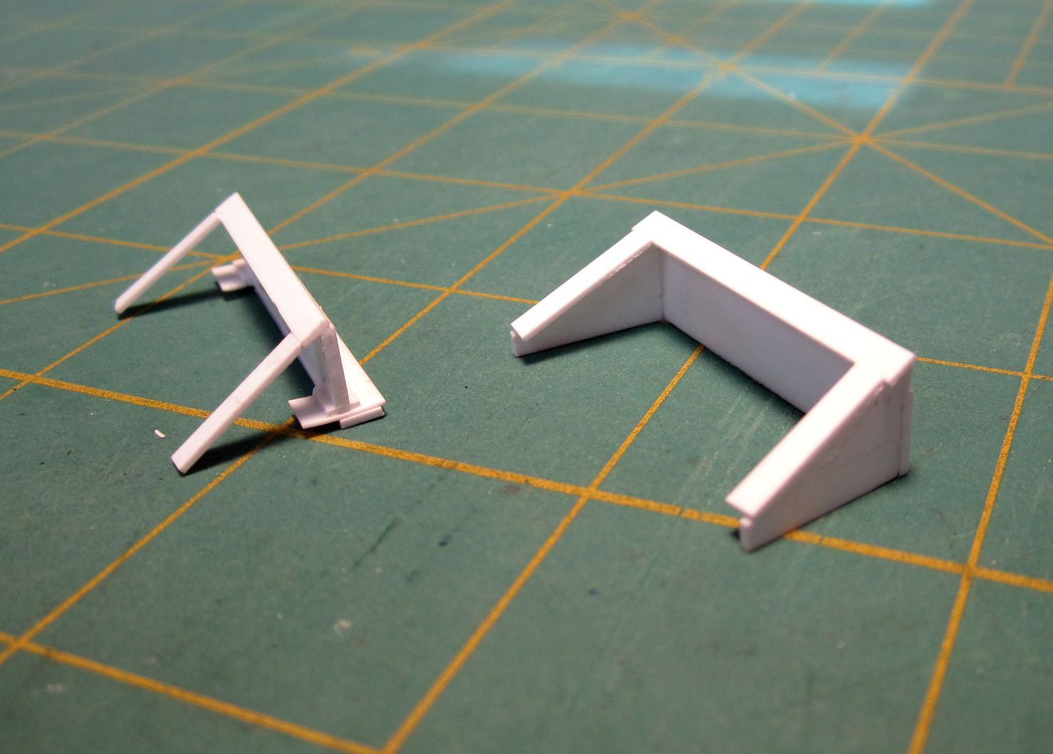

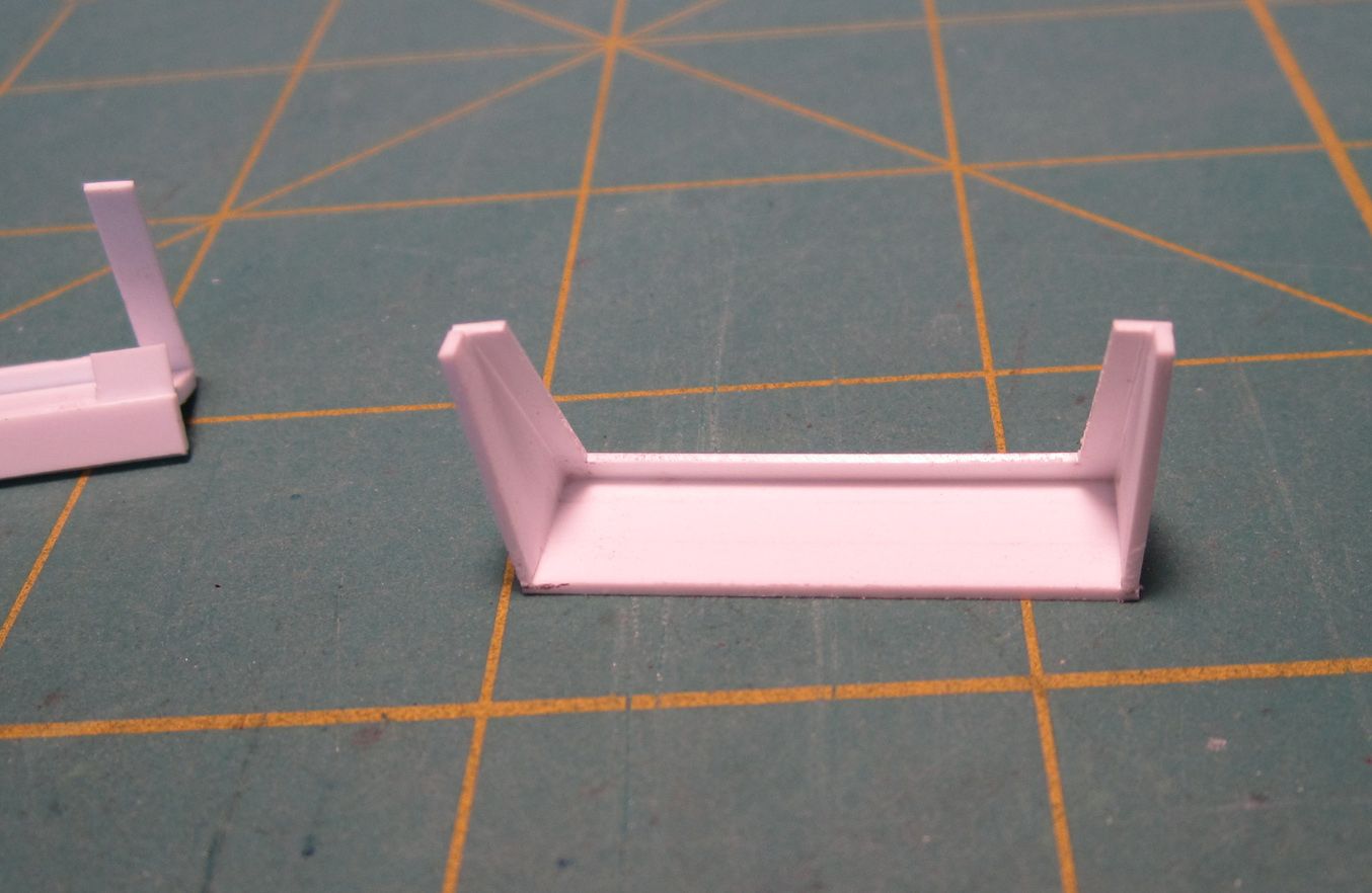

Mooneyzs Posted May 4, 2014 Author Share Posted May 4, 2014 Johnny .... Thanks my Big Brother!! I appreciate it!! Ok so here are some pics to show my progress so far for the day. I am not done at the bench just yet for the day. Will be working pretty much the rest of the night on it hopefully. But after I post these pics its time to cook some dinner. So I have started off by working more on my template piece trying to figure the right size for everything: Test fitting it with the windshield in place: So after I got my template made I decided to take some measurements of it and draw it up in Solidworks and print part of the drawing 1:1 that I could make my parts from it: Here are my main pieces to make the assembly. I had to glue 2 3 different sizes together because I didn't have the right size: More pics following.... Quote Link to comment Share on other sites More sharing options...

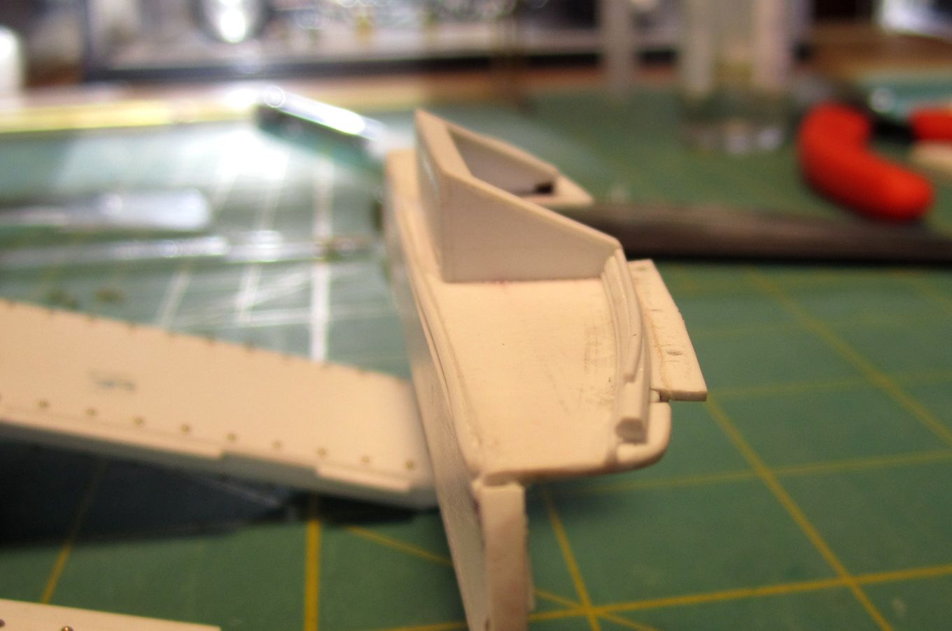

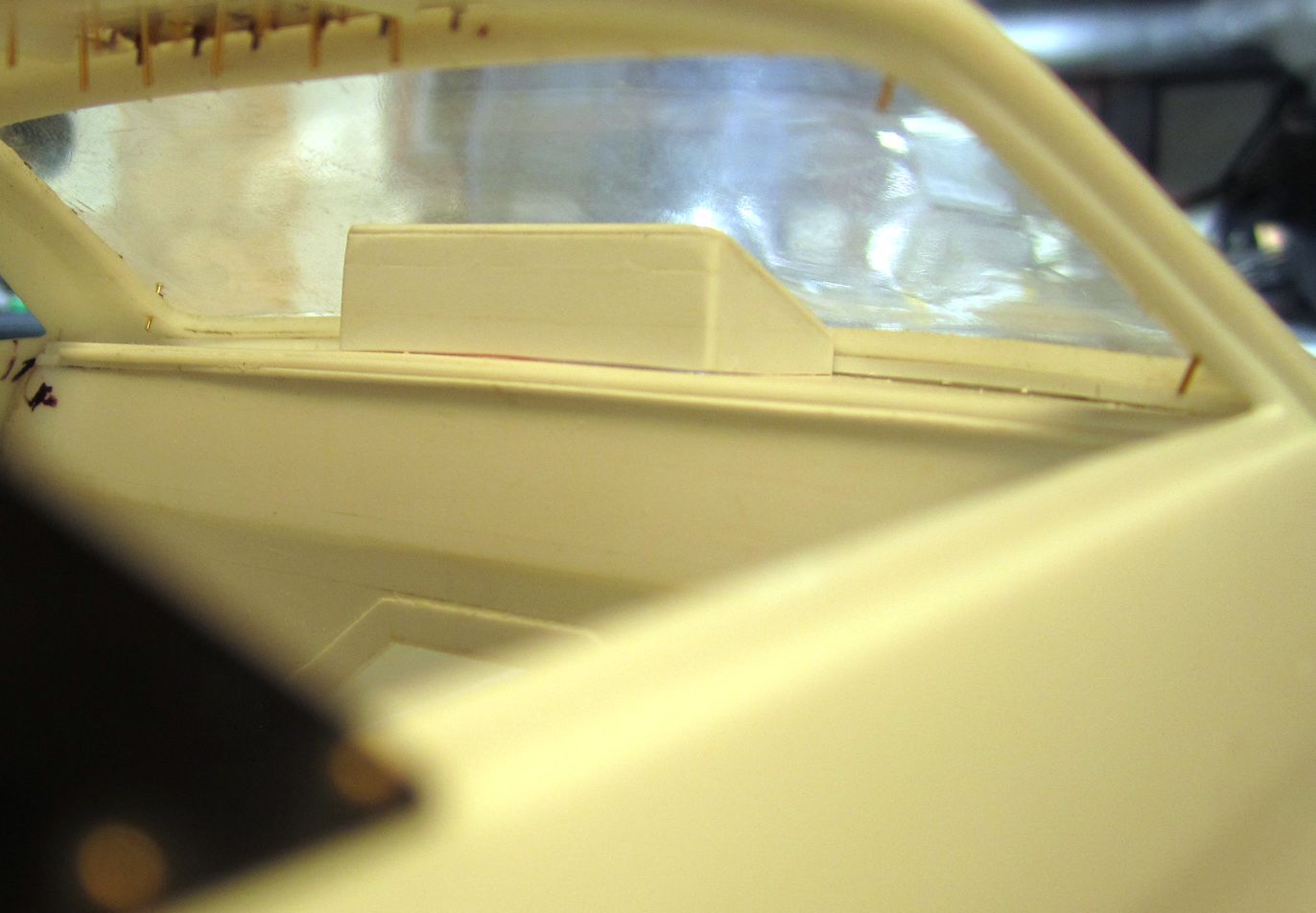

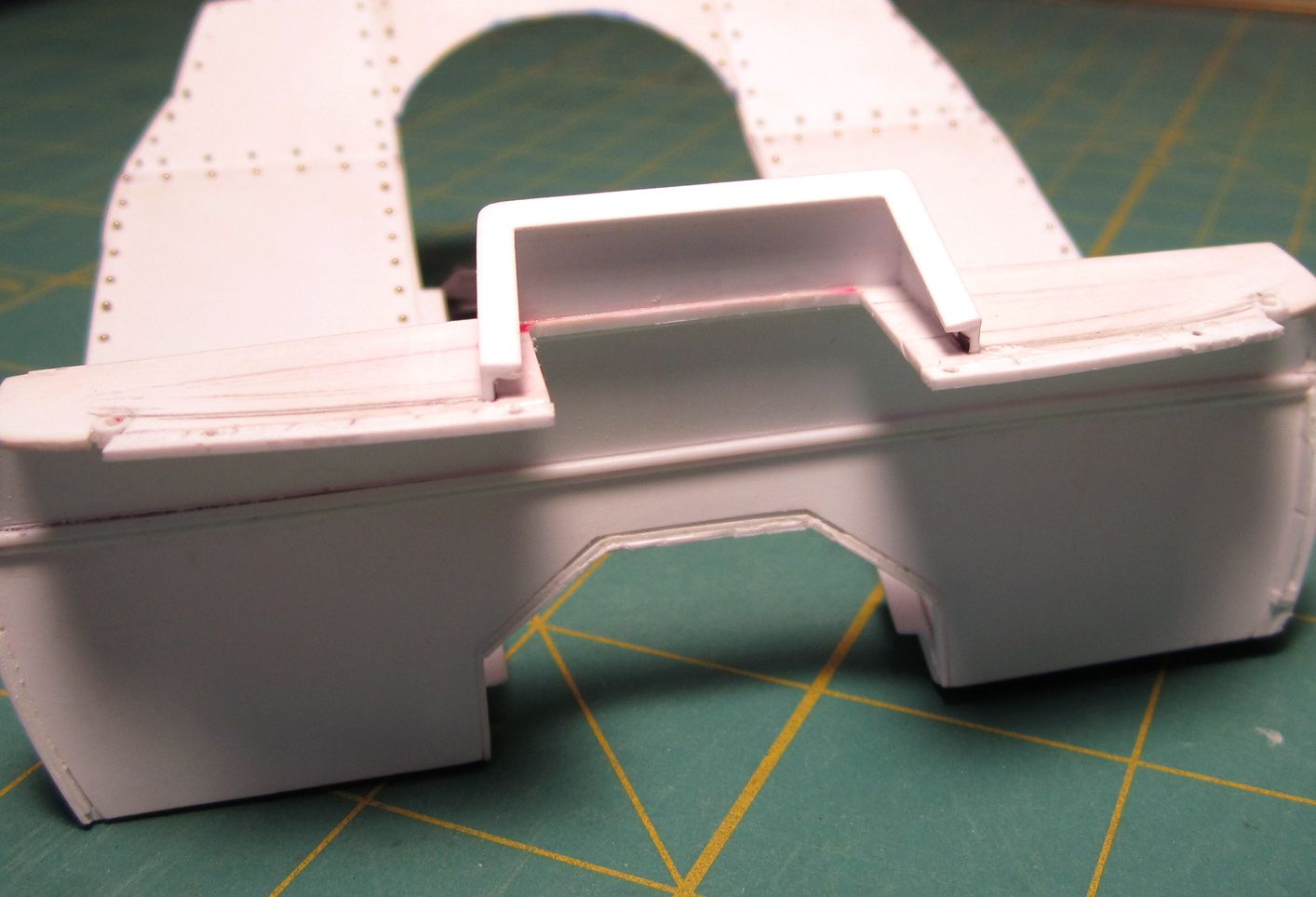

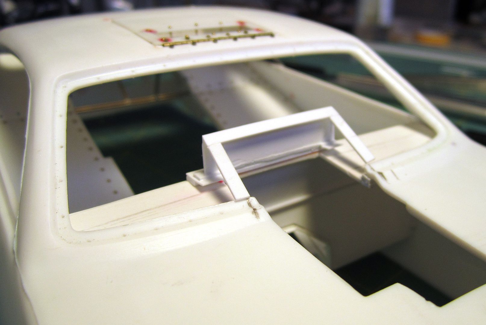

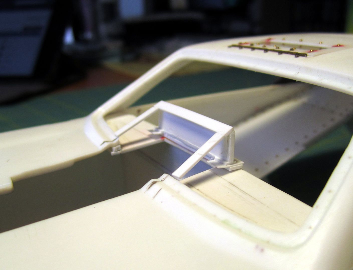

Mooneyzs Posted May 4, 2014 Author Share Posted May 4, 2014 (edited) Here is the part next to the make shift template I made up: Here is the underside of the Dog House: And as always I had to test fit it in place, Its not glued in yet but making the final fitments before I decided to pull the trigger and glue it permanently: Opposite side: Well I am heading back to the bench. Hopefully I will have another update with pics for you later this evening. Edited May 4, 2014 by Mooneyzs Quote Link to comment Share on other sites More sharing options...

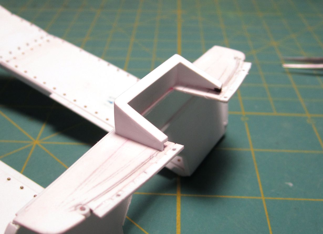

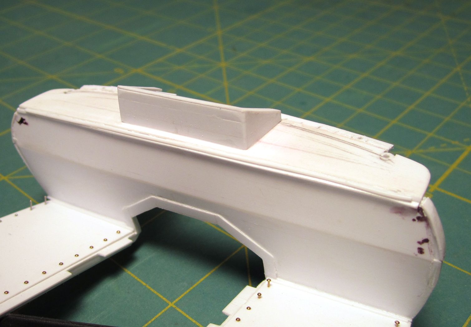

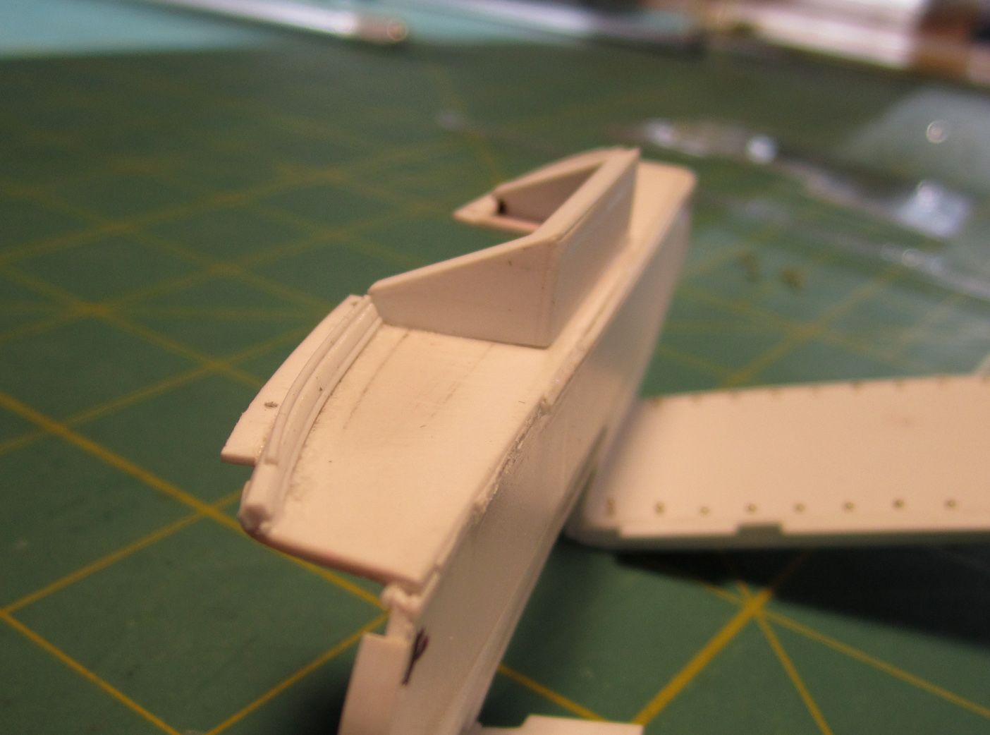

Mooneyzs Posted May 4, 2014 Author Share Posted May 4, 2014 Here is an early morning update of what I finished last night. I still have more work to do but its getting closer to having this done. Here are a few more pics to share with you. Here is the dog house glued to the dash: Here is a front view of the dog house, I still need to sand and trim the dash back to the inside of the dog house to make it flush on the inside: Here is a back view. I think I may be adding a small rod (.020" or so) to use as a filler piece. and then I will be adding another filler piece that will go from the dash to the body to make a smooth transition there Another view: Quote Link to comment Share on other sites More sharing options...

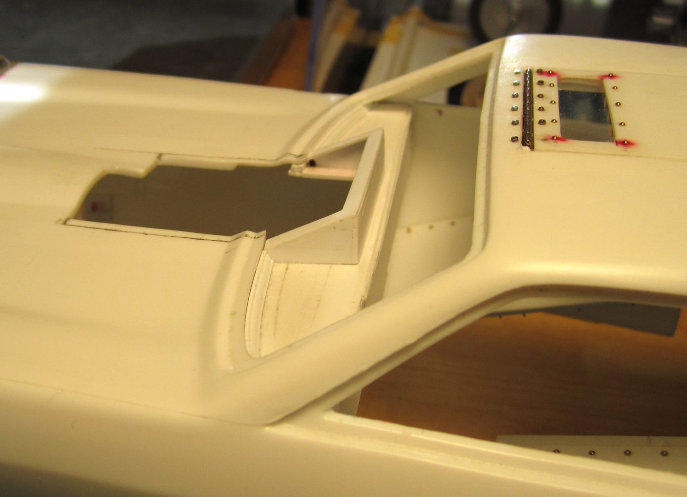

Mooneyzs Posted May 5, 2014 Author Share Posted May 5, 2014 So I was able to get a little more done to the interior tin. I ended up adding some material to the tin work to blend it into the body with a smoother transition. It will still need some final sanding and bond but here is what it looks like: I started out with some hex rod that was bent to shape to fit the body: Did the same on the other side: View from above: here is a side view with the tin into the body. It will look much better once I get some bondo on those pieces: Quote Link to comment Share on other sites More sharing options...
