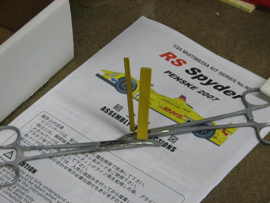

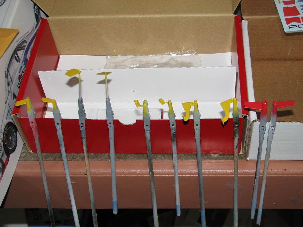

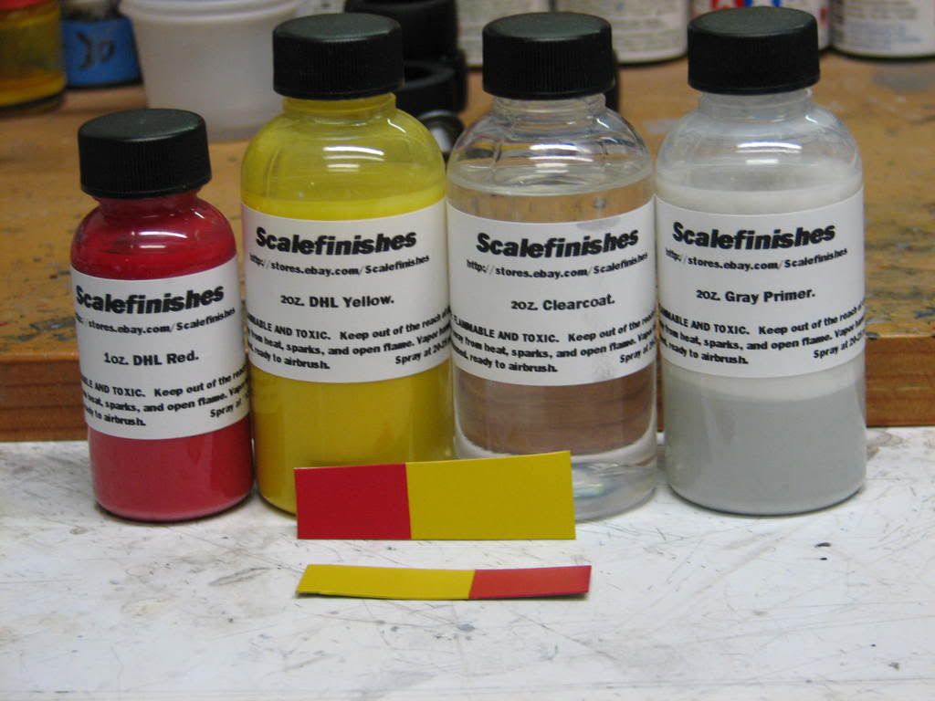

Brendan Posted July 17, 2008 Share Posted July 17, 2008 (edited) Started working on the Studio 27 kit. Looks like it's going to be a pretty easy build. I'm using Scalefinishes factory correct paint. First time using this product so I shot a test sample. The paint covers extremely well and lays down well. Very little orange peel if any. Easily sanded out. Was able to get some of the parts painted. Most of the stuff is in primer. Rims and other small parts painted with different shades of Alclad. Next step is the body itself. Fairly clean flashing wise, though there are some mold lines that stick out quite a bit so they'll have to be sanded. I'll update you when I get more done. Here's the Scalefinishes paint. The test piece lying up against the bottles has a clear coat on it. Scalefinishes paint was sprayed over their gray primer. Edited July 28, 2008 by Brendan Quote Link to comment Share on other sites More sharing options...

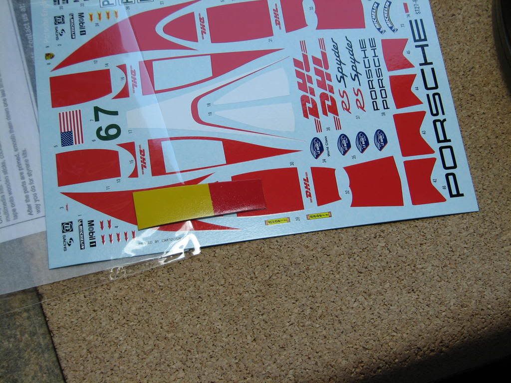

Scalefinishes Posted July 18, 2008 Share Posted July 18, 2008 How well does that DHL red match the decals? Looks good. Jameston Quote Link to comment Share on other sites More sharing options...

Brendan Posted July 18, 2008 Author Share Posted July 18, 2008 How well does that DHL red match the decals? Looks good. Jameston Unfortunately it does not match the decals that well. It's a dead-on match for all the photos I have, but the decals are more of a bright red like Tamiya's TS-49. I'm going to try shooting the red over some white to see if that lightens it up a little bit. Quote Link to comment Share on other sites More sharing options...

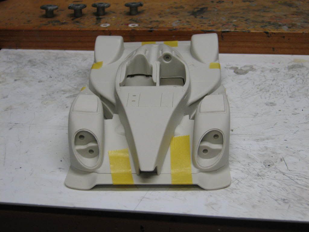

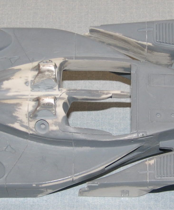

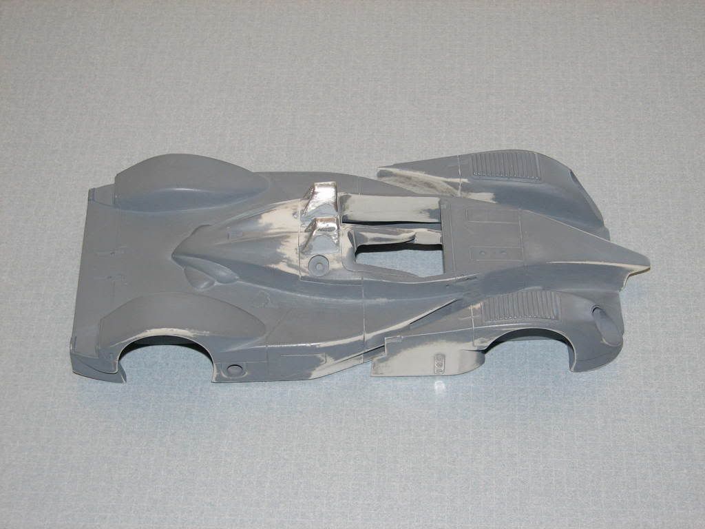

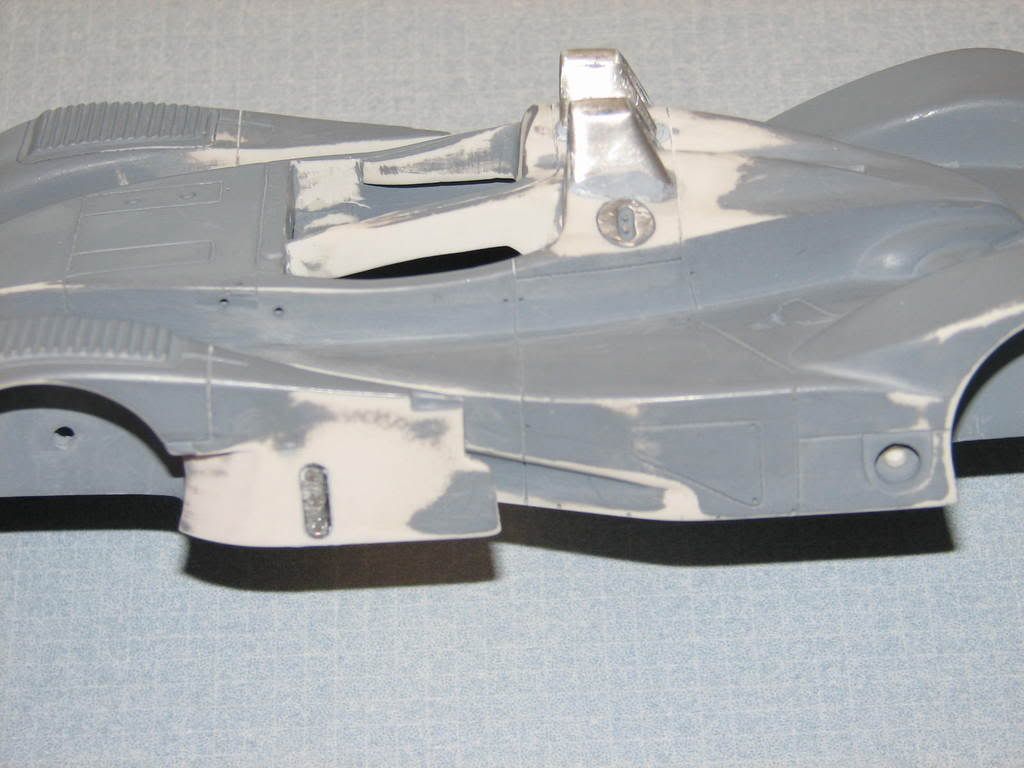

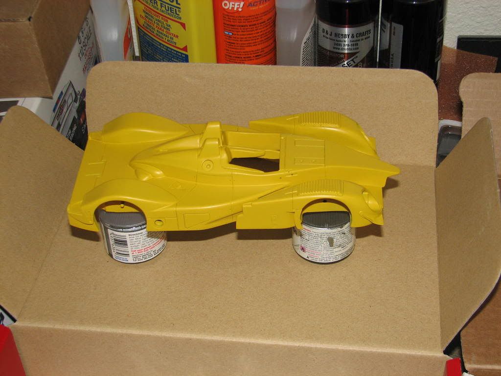

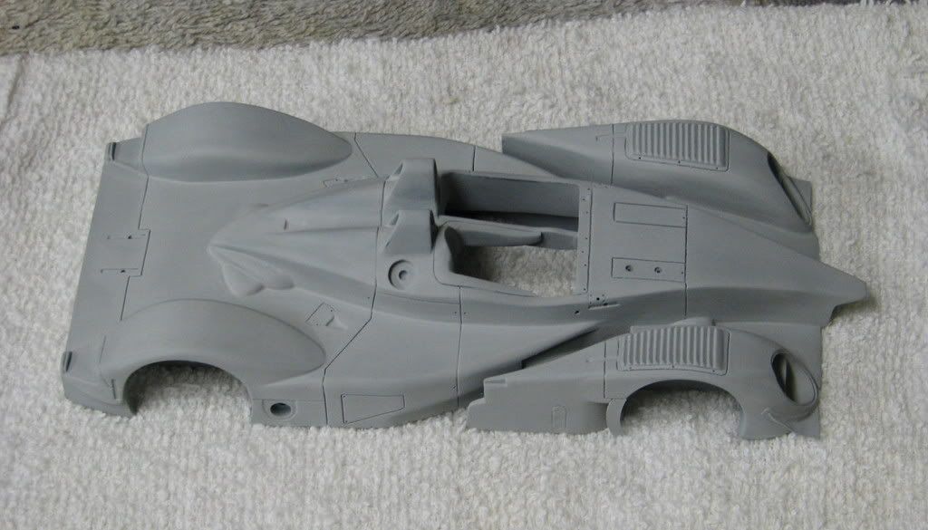

Brendan Posted July 19, 2008 Author Share Posted July 19, 2008 Got a little more work done. Roll hoops are glued in and puttied up. Little bit of a pain. The way they have the front pontoons already cast as one piece in the body. Had a hard time cleaning the inside of a very large seam line. There in the pictures where it shows sanding marks are the areas that needed a lot of work. Hopefully will have some of the body in primer. And should be ready to paint in a couple of days, that is if I don't run into any other little flaws. There were more pinholes than usual in this Studio 27 kit than the ones I've done previously. Easy to fix but just time consuming. Quote Link to comment Share on other sites More sharing options...
Nick F40 Posted July 19, 2008 Share Posted July 19, 2008 Sweet, great progress Brendan! What kind of putty do you use? Quote Link to comment Share on other sites More sharing options...
Brendan Posted July 19, 2008 Author Share Posted July 19, 2008 Sweet, great progress Brendan! What kind of putty do you use? I use Tamiya's basic putty. If you can still get it, it works really well. You can thin it out with alcohol and spread it on with a brush. The putty dries within 12 hours if you put is on thin. I usually sand the next day after putting it on. I also use thin CA to fill in small holes. Quote Link to comment Share on other sites More sharing options...

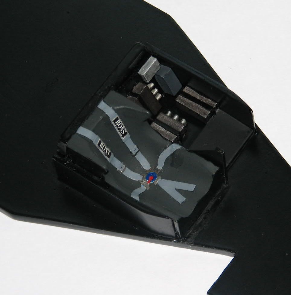

JHDrew Posted July 21, 2008 Share Posted July 21, 2008 Here are a couple modifications that I have made to help the kit out. I added the small half circles to the front of the undertray. This was done by adding a piece of plastic and puttying the recessed area. I also didn't like the three piece bottom so I glued it all together and filled in the screw holes. Here I have scribed out the louvers on the front right fender. I wanted you to see the difference from the right side before I scribed it too. It does give it depth and didn't take that long. I also went to Mid Ohio on Saturday so there are a few reference pictures from the race at my Fotki site. RS Spyder at Mid Ohio 08 I did notice the top headlamp is a decal for the sprint races. So if you want to be picky... Thanks for letting me post here Brendan Quote Link to comment Share on other sites More sharing options...
Brendan Posted July 21, 2008 Author Share Posted July 21, 2008 Jim, Very nice. I was looking at doing the same thing on the front lip. This kit seems like it's a combination of the 2006 and the 2007 car. There are a lot of little things that are not correct on the car, mainly aerodynamics. Thank you for the interior shots. I'll be putting those to use. Let me know when you start putting the front dive planes on. They are a bit tricky if you are using the bigger ones. A lot of sanding to make them fit. Quote Link to comment Share on other sites More sharing options...

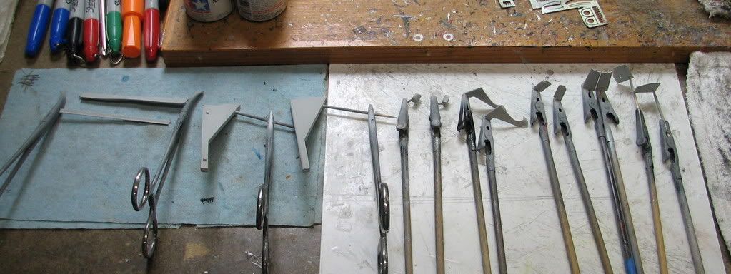

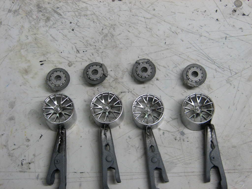

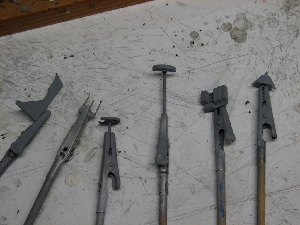

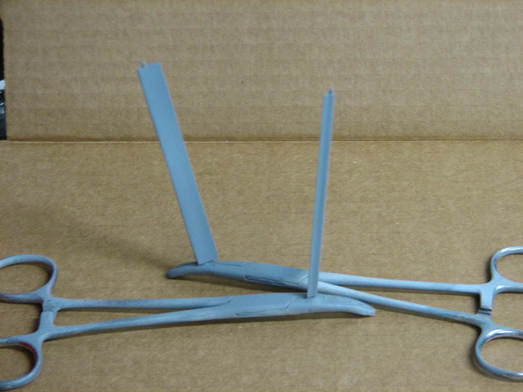

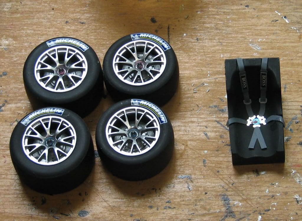

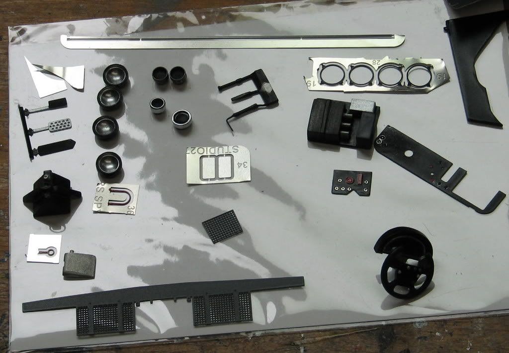

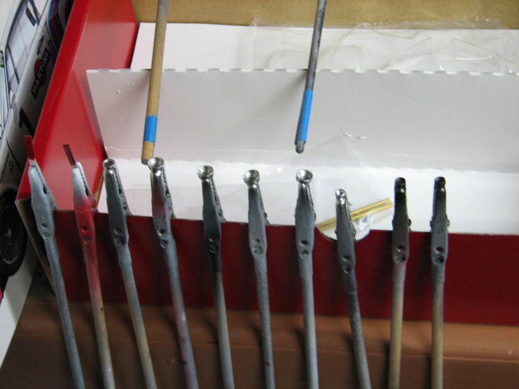

Brendan Posted July 22, 2008 Author Share Posted July 22, 2008 Got a little more work done. There really is not a whole lot to this kit. Most of the detail is in the photoetch. All the other little pieces are painted the body color. Here's a picture of all the pieces that attach to the body or belly pan. Pretty much all the same color, either red or yellow. They are in Scalefinishes primer, waiting to be painted. Picture of rims, tires and brake assembly together. Along with the seat belts and seat. All the P/E bits and pieces. Quote Link to comment Share on other sites More sharing options...
Raul_Perez Posted July 22, 2008 Share Posted July 22, 2008 Brendan, GREAT job on the tires and wheels!! Thanks for sharing, Quote Link to comment Share on other sites More sharing options...
Nick F40 Posted July 22, 2008 Share Posted July 22, 2008 those wheels and tires.......oh boy oh boy oh boy!! Quote Link to comment Share on other sites More sharing options...

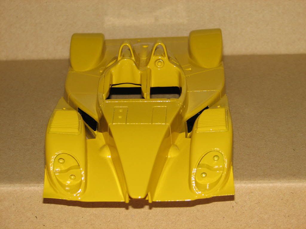

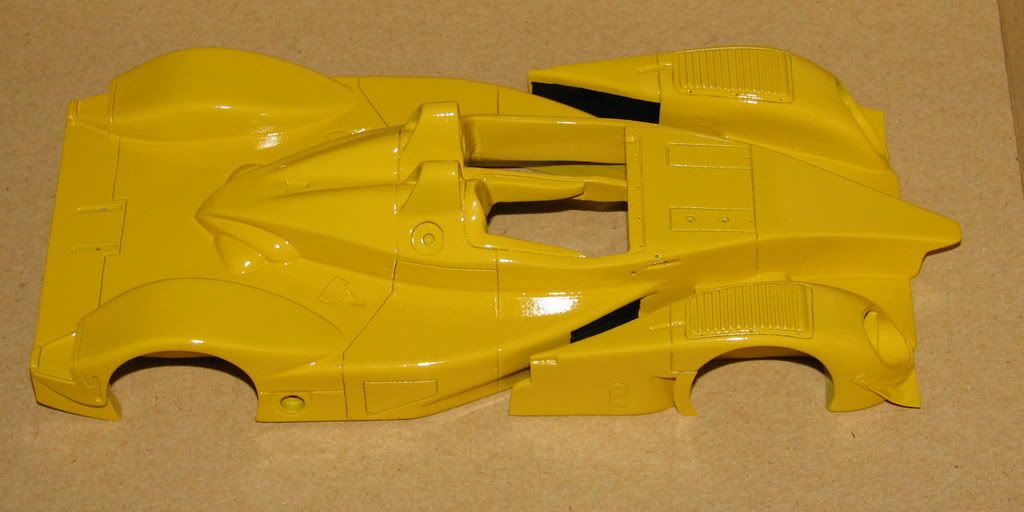

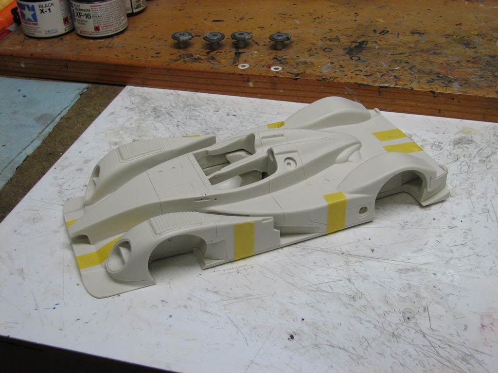

Brendan Posted July 22, 2008 Author Share Posted July 22, 2008 Thanks for everyone's comments. Just shot the yellow this afternoon (literally...just walked in the door). Paint went down extremely well. Will have to do some very very light sanding and then I'll shoot on the clear. I don't think I'll be using the red. It just isn't close enough to the red in the decal. I'll probably use Tamiya's TS-49 (bright red). The decals in this kit are not exact in color to all the reference photos that I have. They have a tendency to try to match it to a hobby paint. Will get pictures out soon. Quote Link to comment Share on other sites More sharing options...
Brendan Posted July 23, 2008 Author Share Posted July 23, 2008 Shot the yellow on yesterday. Went down really nice. I'll shoot on the clear today. I really like this paint. It dries very quickly and covers well. Here's some pictures of the body. Quote Link to comment Share on other sites More sharing options...
Nick F40 Posted July 23, 2008 Share Posted July 23, 2008 verwy pwitty! Quote Link to comment Share on other sites More sharing options...

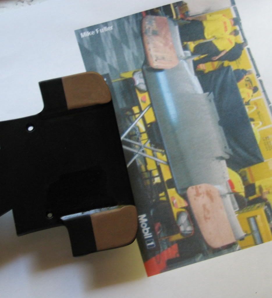

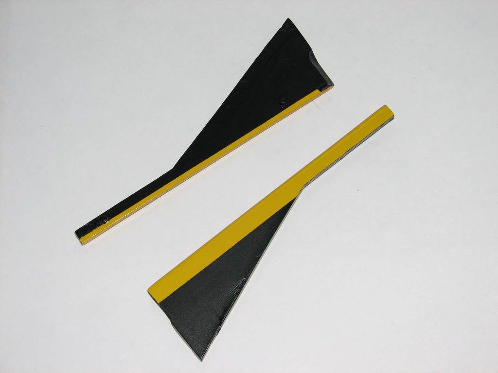

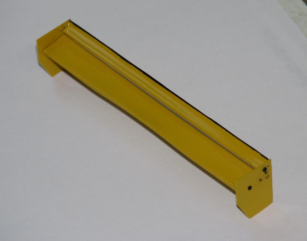

Brendan Posted July 24, 2008 Author Share Posted July 24, 2008 Shot the clear yesterday and got quite a bit of work done. Everything seems to be fitting fairly well. There are some issues with the P/E. Some pieces are too small and some are too big. But they are easy to fix. I ended up having to pin the wing together because the peg on the wings are too big for the P/E. Should be getting the decals on in the next couple of days. The skid plates are a mixture of Tamiya's XF-28 (dark copper) and XF-64 (red brown). It seems to work. The black areas on the side pods are from reference photos that I had. Some races they were yellow and in some races they were black on the inside. Quote Link to comment Share on other sites More sharing options...

Nick F40 Posted July 25, 2008 Share Posted July 25, 2008 What is the point of the copper/brown areas? Quote Link to comment Share on other sites More sharing options...
