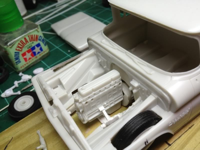

Fuel Coupe Posted December 27, 2011 Share Posted December 27, 2011 (edited) Not sure how far I will go with this one but I felt I definitely needed a break from the drag cars. Unfortunately my Panella willys will be on the back burner for a bit. I have always liked the look of the early 60's chevy truck and I really like the lowered look and fab skills it takes to get one of these trucks to sit so low I do plan on putting bags on this one and I'm looking for a set with the tanks from the AMT wagon rod (hint hint). Well on to the pics I have removed all the from suspension and plan on putting in a raised crossmember from the likes of Porterbuilt etc. I have already C'ed the frame in the back and cut the floor but as you can see the floor will have to be raised.. Small start but comments are always welcome.. Edited December 27, 2011 by Fuel Coupe Quote Link to comment Share on other sites More sharing options...

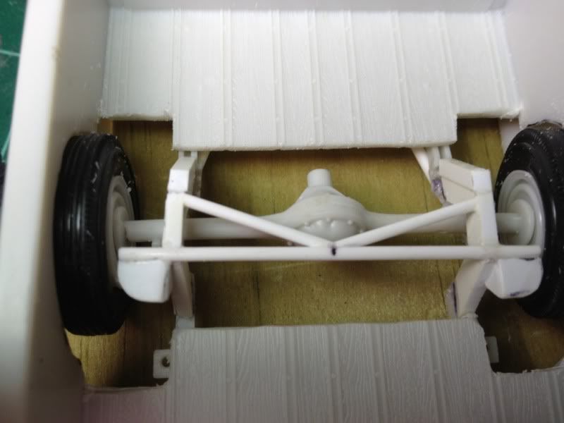

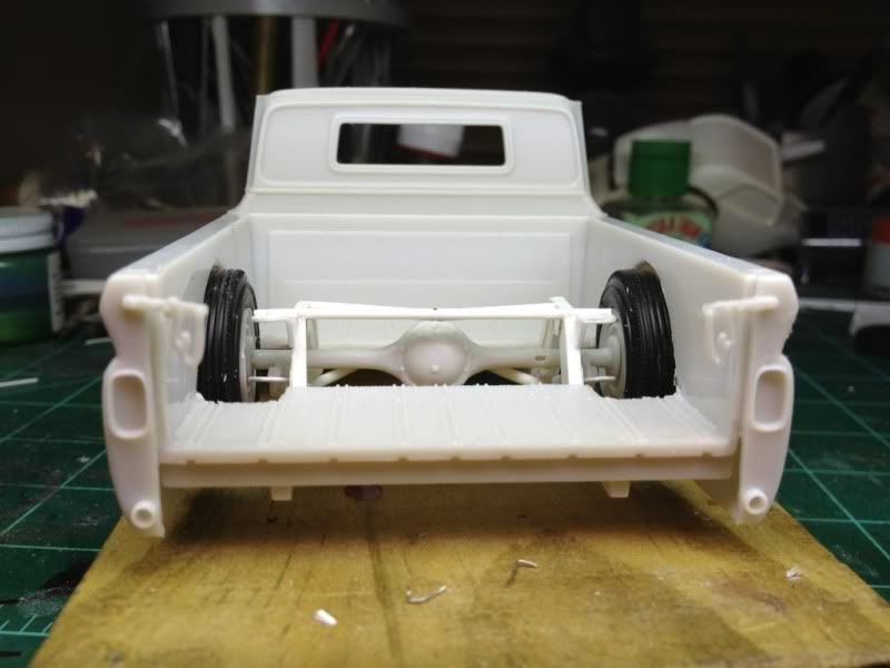

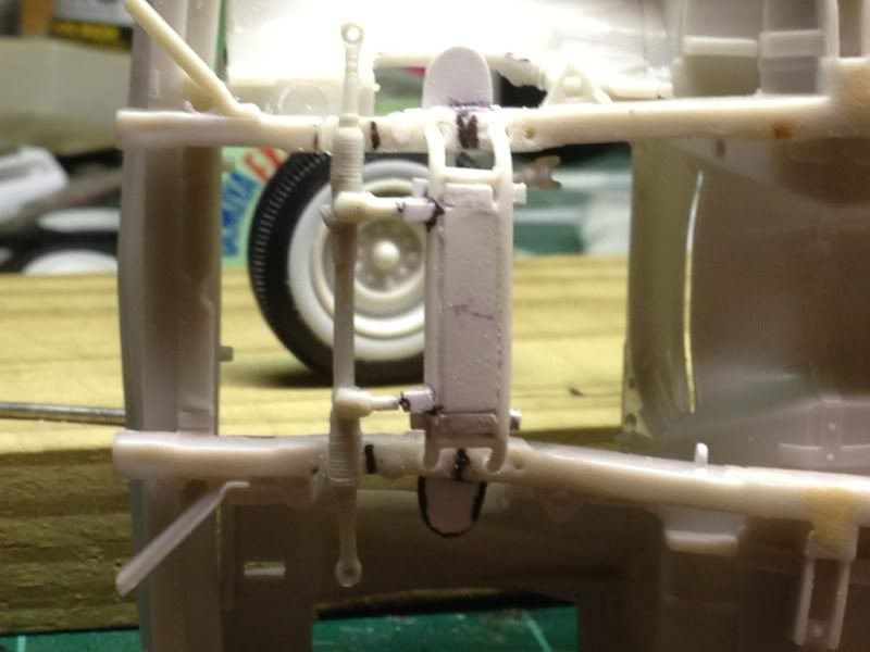

Fuel Coupe Posted December 29, 2011 Author Share Posted December 29, 2011 (edited) Heres the rear suspension minus the rear bags and the track bar. I flipped the trailing arm mount to gain a little more gound clearance. I scratch built the trailing arms and the bag mounts. Im looking for the front suspension from a wagon rod by AMT. Edited December 29, 2011 by Fuel Coupe Quote Link to comment Share on other sites More sharing options...
Nate Posted December 30, 2011 Share Posted December 30, 2011 Shane, you mentioned that you don't plan to use the stock wheels, so I have a suggestion; you might want to use the final wheel/tire combo to mock-up your suspensions. As the rear suspension currently sits, you might have some problems if you decide to go with a wider wheel/tire combo. Another question, what type of airbags do you plan to use, bag-over shock like Air Ride Tech's Shockwaves or a separate bag and shock? Just curious... Quote Link to comment Share on other sites More sharing options...

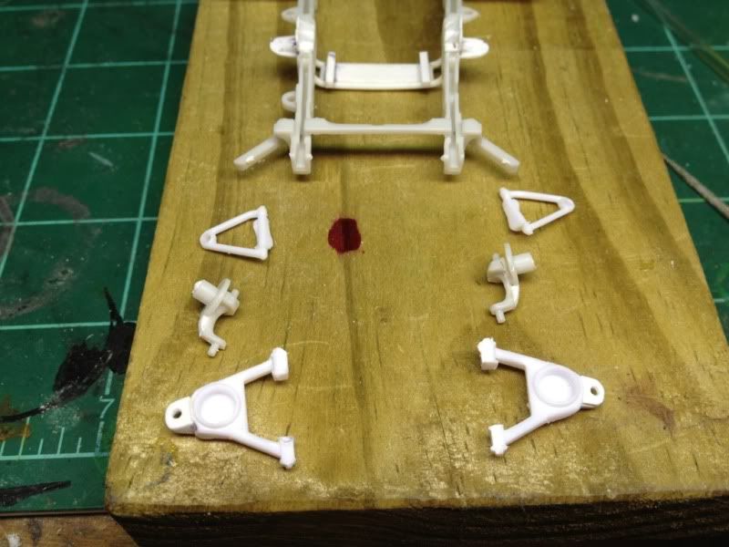

Fuel Coupe Posted December 30, 2011 Author Share Posted December 30, 2011 (edited) the custom version of the kit comes with a fuel injection set-up for the 6, but no turbo. have you considered using the front suspension from a Nascar kit? pretty easy to "clip" those onto a lot of other frames and get a nice drop in the process. you should be able to add some air bag detail to those pretty easily too I have been looking at this set up for at least the control arms. Ive been working on a version of the Porterbuilt front crossmember and I may try some nascar arms.. Shane, you mentioned that you don't plan to use the stock wheels, so I have a suggestion; you might want to use the final wheel/tire combo to mock-up your suspensions. As the rear suspension currently sits, you might have some problems if you decide to go with a wider wheel/tire combo. Another question, what type of airbags do you plan to use, bag-over shock like Air Ride Tech's Shockwaves or a separate bag and shock? Just curious... Actually what I said was I planned on using the stock wells and NOT using bigger wheels as Tom Staples commented that it looked like I had over cut the wheel wells, But thanks for looking out for me The "plan" is a seperate shock from bag. Edited December 30, 2011 by Fuel Coupe Quote Link to comment Share on other sites More sharing options...
01blueedge Posted December 30, 2011 Share Posted December 30, 2011 the custom version of the kit comes with a fuel injection set-up for the 6, but no turbo. have you considered using the front suspension from a Nascar kit? pretty easy to "clip" those onto a lot of other frames and get a nice drop in the process. you should be able to add some air bag detail to those pretty easily too I used the nascar front on mine and it will almost lay frame on this kit with that suspension Quote Link to comment Share on other sites More sharing options...

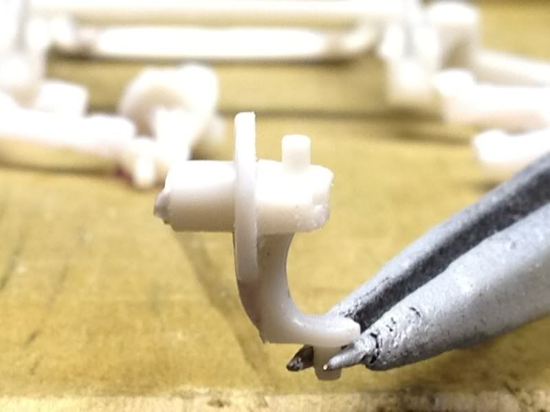

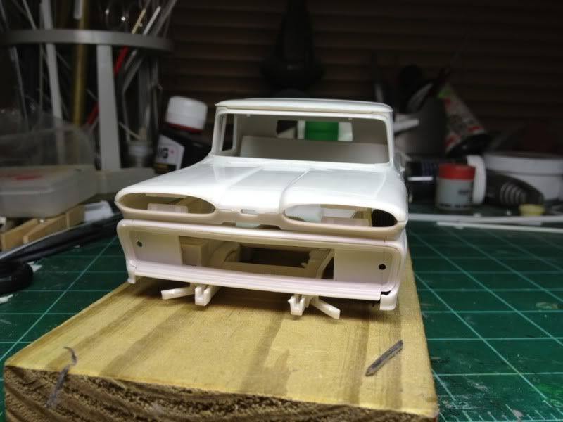

Fuel Coupe Posted January 2, 2012 Author Share Posted January 2, 2012 (edited) here's the latest on the 60, I used you guys advice on the nascar suspension and its working out perfectly. Basing my crossmember on a Porterbuilt unit I was able to get the arms from a nascar kit to to work and was able to get the frame to set down on the ground nicely. I wound up angling the lower control arm ball joint area to compensate for the extreme balljoint angle. I also took the stock truck spindles and put a scale 3" drop on those. Heres a few pics of the front roughed in. Edited January 2, 2012 by Fuel Coupe Quote Link to comment Share on other sites More sharing options...

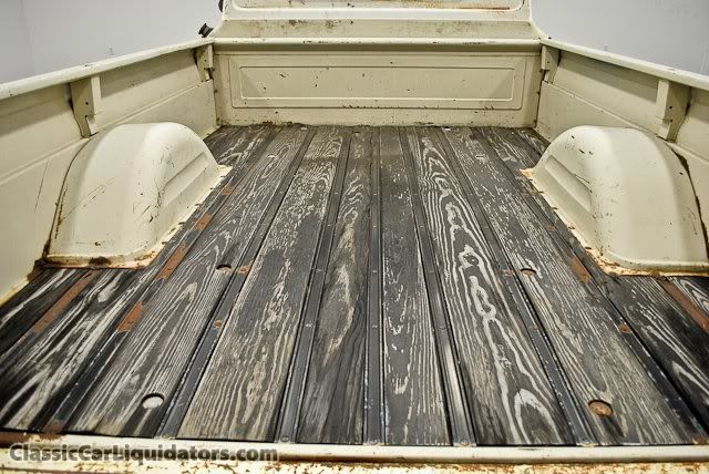

LAone Posted January 9, 2012 Share Posted January 9, 2012 sweet truck, i was about to ask why not raise the bed..lols keep up the great work and nah man, not boring anyone. some inspiration for the 2 trucks i have in my stash.. Quote Link to comment Share on other sites More sharing options...
