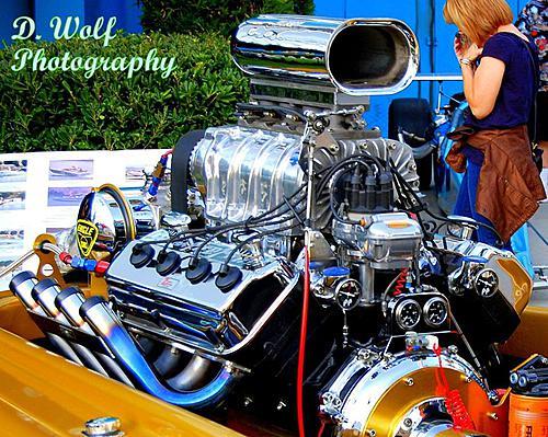

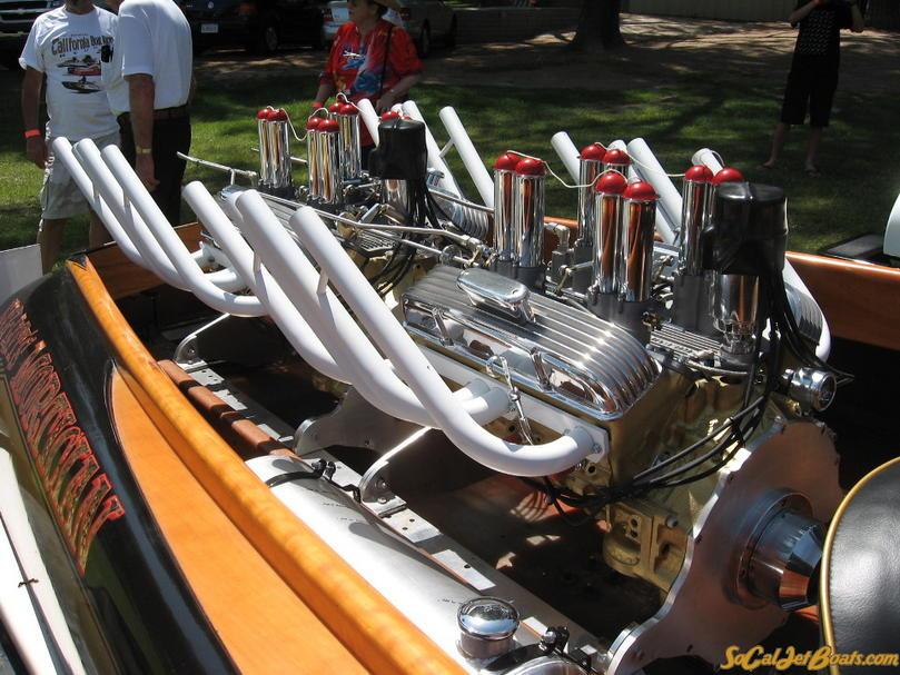

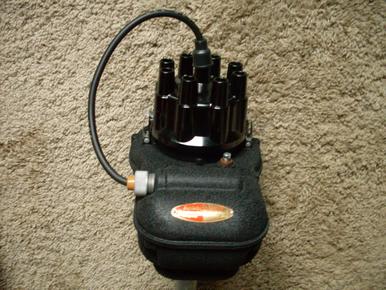

spike morelli Posted September 26, 2017 Share Posted September 26, 2017 (edited) ...Just for additional reference, and, to throw a slightly different slant into the conversation, I currently own two legitimate sixties drag boats....both originally built in '65...magnetos were standard faire by then on modified and racing engines. The double inline Chevy powered boat uses Joe Hunt converted Scintilla-Vertex mags, while the blown Hemi uses a Scheifer/Cirello style magneto. The Vertex mag caps were kind of a Rustoleum brown color back in the sixties, today, most Vertex caps are black, some are blue, but the brown caps are treasured by restorers for correctness of era on a sixties engine. The Scheifer/Cirello caps are black. My Chevy Vertex mags pictured have black vinyl waterproof covers over the caps in this instance. Edited September 26, 2017 by spike morelli Quote Link to comment Share on other sites More sharing options...
