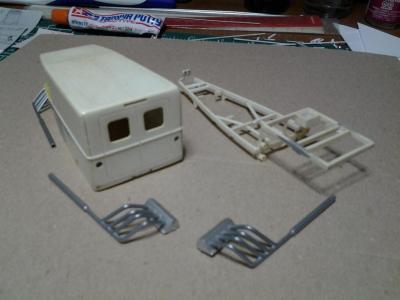

wayne swayze Posted August 8, 2014 Share Posted August 8, 2014 Using heat does the trick, but DON'T BURN YOURSELF. Keep the styrene rod far enough away from your heat source, and as soon as you feel the styrene "getting loose" ( before it shrivels up), bend it around a form to get the angles uniform, then let it cool down on it's own. Years ago, I used a lit cigarette to heat the styrene, but I don't smoke any more.....wished I never had started! Anyway, using that method, this is an example of uniform bends to make headers. These are 1/32 scale, so .060 in diameter. Quote Link to comment Share on other sites More sharing options...
